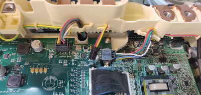

So maybe I have another incorrect component. I took a picture and was comparing components to the BOM and I noticed R21 wasn't a match. According to the BOM it is supposed to be 10 ohms. I haven't found it on the schematic yet. The resisters in question are near the top of the attached photo where there is glare.

The TMPHSMAX fault is when the inverter is getting too hot. It's a safety mechanism which stops the inverter from running to prevent something bad happening. The 'tmphsmax' parameter sets the temperature at which the TMPHSMAX fault triggers. If you're just testing on the bench it's usually OK to set the tmphsmax parameter to something fairly high like 100 or 110. As I understand it, the remaining Toyota bits of the inverter will still shut it down if things get too toasty anyway. So, setting a higher value for tmphsmax will get you past that fault.jwr813472 wrote: ↑Mon Nov 22, 2021 3:52 pm TMPHSMAX
Hi All. I've been trying to get my inverter to do something other then have some LEDs blink. My motor would sometimes jog or engage for a split second in MANUAL MODE. With nothing hooked up other than 12v and GND I get fault TMPHSMAX. Looking at spot values TMPHS it is reading 85.43 degrees C.During normal startup the precharge contactor would energise but the MAIN CONTACTOR would not with the start button. I measured the resistance of the coolant sensor and it does change from 2.86k and drops when briefly applying heat. My motor sensor is currently not connected Looking at the schematics I found on the WIKI, R22 is supposed to a 10K resistor. Is this correct? On my board the component is stamped with "2200" and with my meter is measuring 165.8 ohms.
Thanks in advance for your help.

Thanks for your post and insight. I will try adjusting the set-point later today when I get time to work on it. Currently it is at 85C. The inverter is room temperature. There is no heat in it at all.
My real questions are:
1. what is causing the fault?
2. is my board populated correctly? There seems to be a discrepancy between my board and the BOM.

Make sure you have the right sensor type selected. Set snshs to semikron for the Prius gen 3. Choosing the wrong sensor will give you wonky values.jwr813472 wrote: ↑Tue Nov 23, 2021 1:56 pm Christian

My advice is to get the heat sink temperature faults resolved first before going down the faulty/wrong parts rabbit hole. Trust me. I’ve gone down that rabbit hole

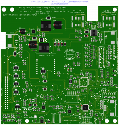

Some upgrades on the Gen 3 Prius logic board following feedback and contributions:
5V, -5V and 3v3 Supplies upgraded.
Double footprint to allow Olimex or Wemos wifi modules.
DCDC converter delayed startup on main contactor close.
DCDC 12V output control via STM32.
DCDC Sense permanently connected to +12V (avoids turn off overshoots)
Prototypes should arrive in the next week and should get a chance to test over Christmas. Design files will be released on Patreon at that stage.
All the non placed parts will be supplied in the kit but the STM32 will be fitted and programmed by me prior to dispatch.

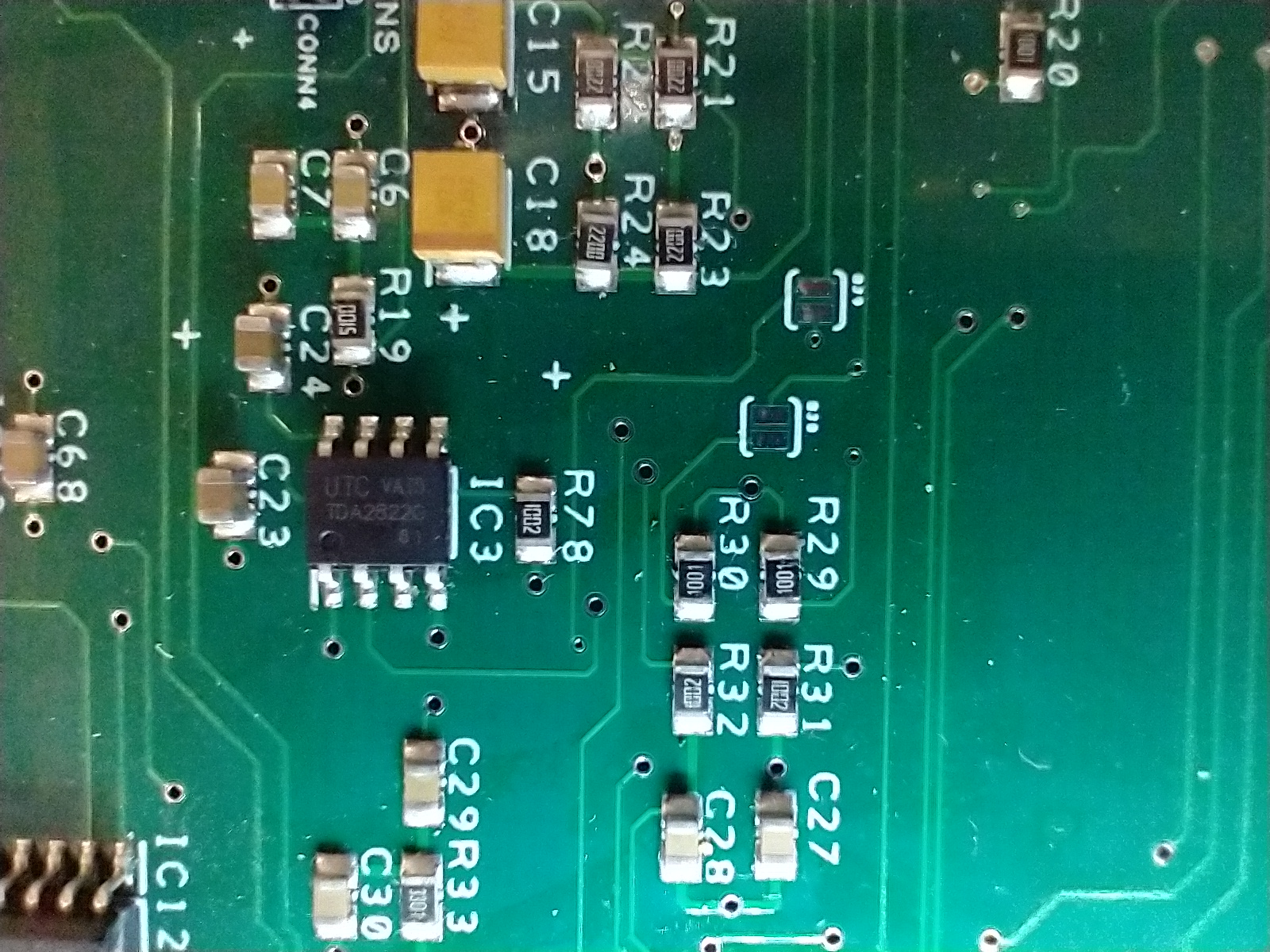

Good morning everyone. I have a HICUROFS1/2 error that I'm trying to figure out. It seems to happen as soon as the MG2 current sensor is connected. When I send 12v to the board I can hear it whine if MG1 is connected, but as soon as I connect MG2, the whine is barely audible and I get the error. Inverter whine is at different audible frequencies if sensors are connected individually.
If I start in manual mode, il1 il2 id and iq all fluctuate with very small values which I assume is noise since nothing is connected. As soon as I connect MG1, the inverter starts to whine but there is no change in spot values, they continue to fluctuate. When I connect MG2 the whine drops to barely audible, il1 il2 id and iq all spike momentarily to some very high number then drop to 0, and idc goes to -15.96. HV is not connected.
If I swap the connections, I get the same results which would suggest the problem is with the MG2 sensor connector.
UPDATE: While testing pins at the connector, I managed to short an alligator clip to the inverter case and now my 26v is only reading 11v with a 12.8v supply. Not fun. All voltages were correct before installing the board into the inverter.
2nd UPDATE: Measured capacitance of C4 = 548 microF, C16 = 548 microF, C31 = 317 microF. All measured on the board. I would assume this means I need to replace C4 and C16?
3rd UPDATE: Please pardon my noobness. Took C4 and C16 out of circuit and capacitance is fine. Of course, I managed to damage the solder pads in the process. Tested D1, D2, and D3. Forward bias shows 0.23v drop across all 3 but reverse bias showed 0.8v across D2 and OL at D1 and D3. Did I find the culprit at D2?

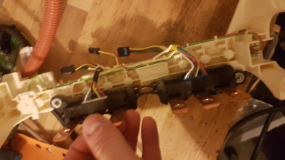

Random question: Does anyone know the size / threads foe the bolts that hook the 3 mg1 / mg2 cables to the inverter?
After searching around I have found the torque specs but not a size

Japanese are fans of putting M6 bolts everywhere. Also on said terminals

Thank you! My inveter has no hardware and I was dreading trying a bunch!

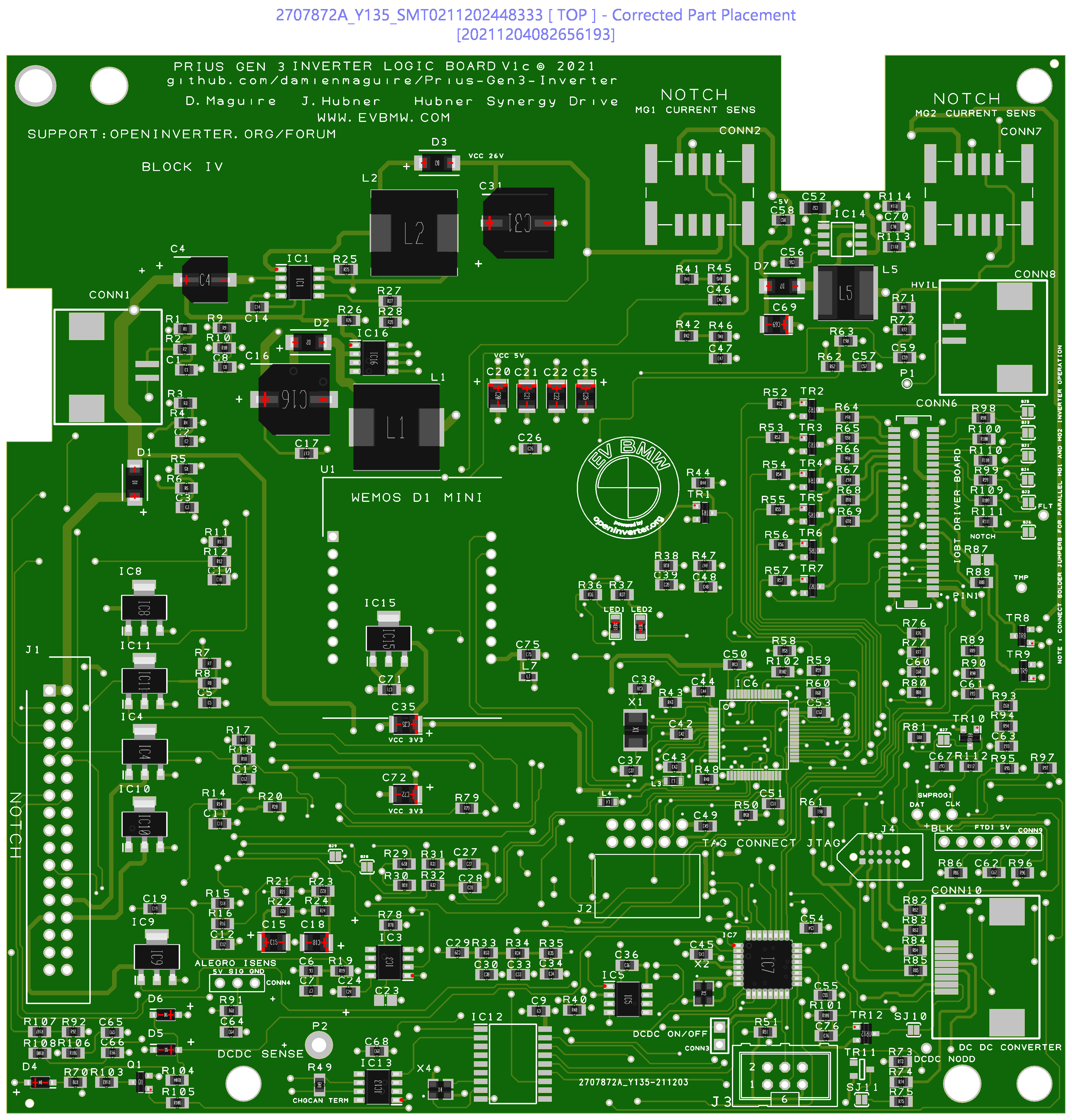

Hi everyone, I have the new v1c_b4 board that was released in December, and I have a few questions:
1. This one has the new Wemos WIFI module included, but I'm unclear which way this should be oriented. I see four possible orientations:
2. There were a few loose transistors and 1k resistors included with my board and I'm not sure where they go. I didn't see anything with these in the installation videos or the Wiki (the videos do mention changing the values of the DC/DC voltage dividers on the underside, but that seems to require 8 resistors, and there are only two here, and they have different values than those):
3. The microcontroller DC/DC converter came separately with mine, but in the assembly videos/Wiki, it appears to already be soldered. The release notes mention "DCDC 12V output control via STM32," so, is this no longer necessary? If so, can someone clarify the proper pin-1 orientation; I couldn't find a clear shot of it in the videos.
4. Related, I see a new "DC/DC on/off" jumper now. Should this have a jumper on it by default (assuming I want the DC/DC converter to run)?
Thanks!

I'm no expert, but I have two other variants of this board so I might be able to help out a bit.
It looks to me like you've got the correct orientation in the picture. I see the TX/RX lines going off to the STM32F and a chunkier connection going into the 5V pin.
IC12 appears to actually be the CAN bus controller for the charger CAN. If you want your inverter to act as a charger and you want to communicate with it over CAN you'll need to solder this chip on. Looks like you have it in the right orientation in the picture.jeffb wrote: ↑Mon Mar 14, 2022 3:13 am 3. The microcontroller DC/DC converter came separately with mine, but in the assembly videos/Wiki, it appears to already be soldered. The release notes mention "DCDC 12V output control via STM32," so, is this no longer necessary? If so, can someone clarify the proper pin-1 orientation; I couldn't find a clear shot of it in the videos.
Yeah, put a jumper on there or just solder it closed.

Here's a picture of my setup for reference:
Thanks!
