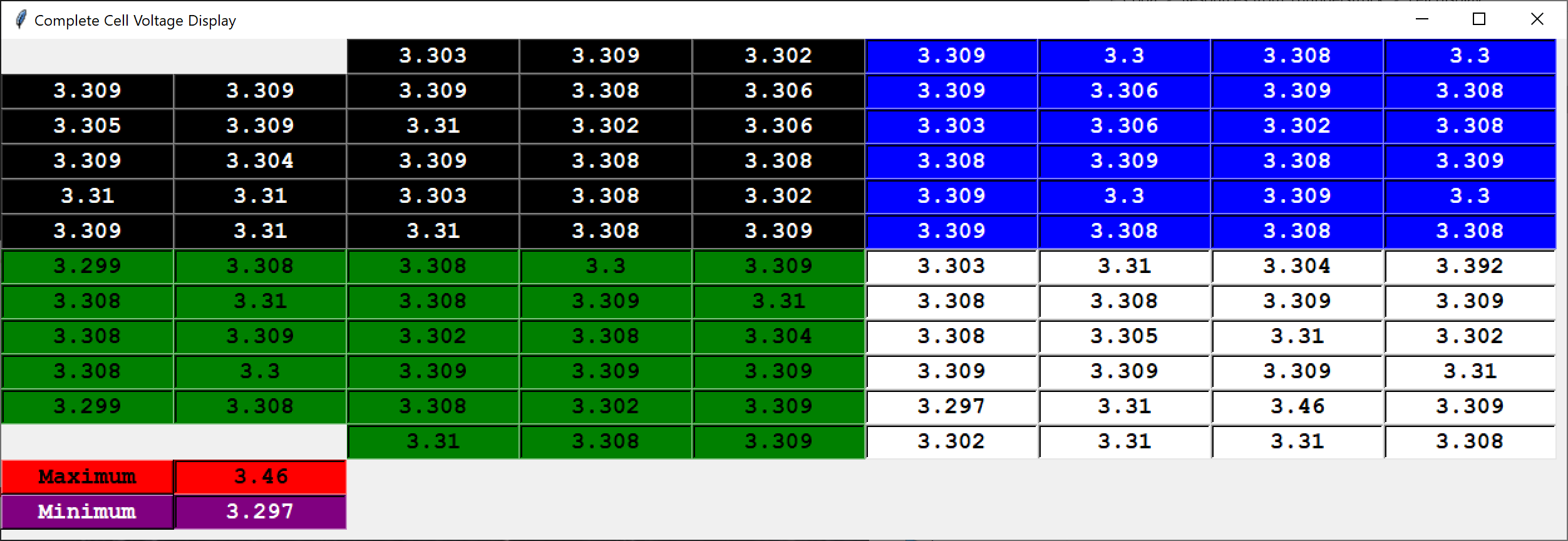

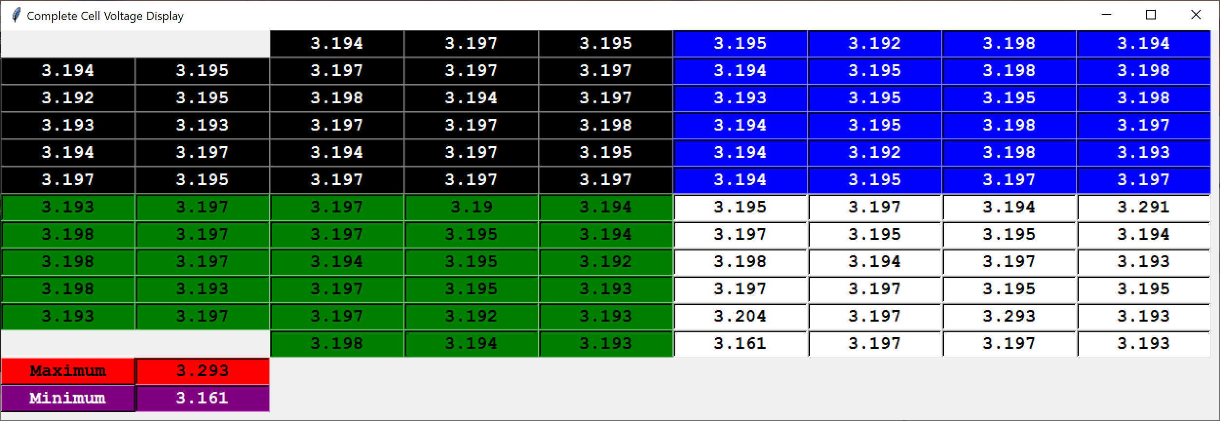

The range issue seems to not be a dead cell, but a bad BMS, specifically the balance channels. There are 2 cells (in the white quadrant) that are way higher than the rest of the pack, both when it's fully charged and fully discharged (fully discharged is indicated around 85% on the dash). So I think those balance channels have failed and let those 2 cells drift above the rest of the pack over time. If that's the case I can drop the pack, swap the BMS module, and then manually balance those 2 cells down, and I should be able to get the rest of the pack's capacity back.
Fully charged cell voltage view (Coda uses iron phosphate batteries):
Fully discharged battery cell view:

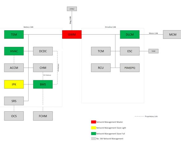

The diagnostic tool appears to be a custom version of the Omitec Omicheck tool - I hoped to find more information on the generic version, but didn't really find much information online, except for this page, though not much useful information here. All CANbusses on the car are broken out to the OBD connector (some on nonstandard pins) but this appears to only talk over the 'normal' OBD connector CAN pins to the Gateway module (red box) which then forwards all that to the rest of the car.

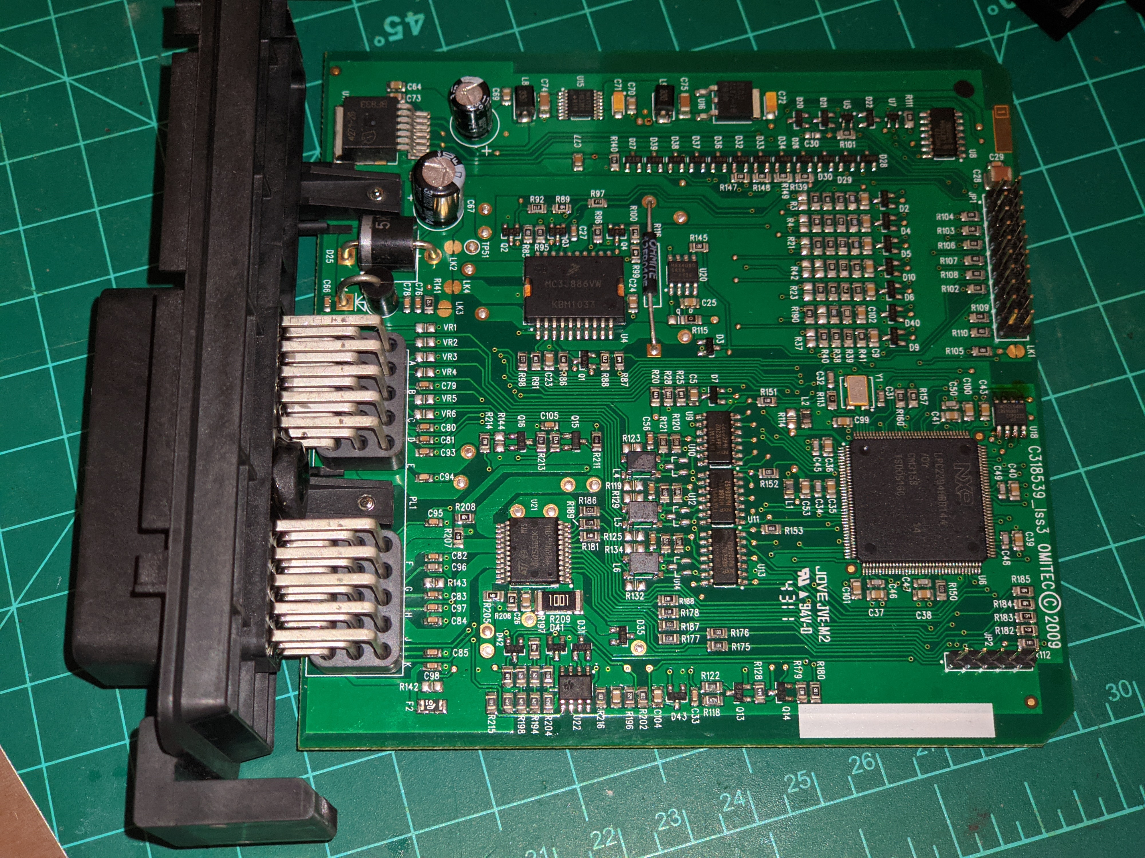

The traction control light turned out to be caused by the Gateway module actually - the ABS/traction control module was throwing a 'VIN mismatch' code, and it turned out that the Gateway module had the wrong VIN programmed into it. The scanner has a function to reprogram the VIN into the gateway module, but I couldn't get this to work - seemed to want the gateway to be new to the car or something. I tried replacing the EEPROM chip on the inside of the gateway module but this did not make it think it was new to the car either.
I ended up getting a new gateway module from Thunderstruck on a later order - swapping this into the car, it picked up the correct VIN and removed the light from the dash, even without me having to reprogram it. Still have no idea where it picked up the correct VIN from or what was wrong with my original gateway module.

Eventually I think fixing this will be the first modification to this car - The drivetrain control module (DLCM in the diagram above) that controls the inverter does a lot of different things and I don't want to have to replace it entirely - all of its the CAN messages for the UQM inverter are pretty well known, so I figure I might be able to use a Zombieverter with all 3 of its CAN ports, forward messages between the DLCM and the inverter, and then sit on the driveline CAN bus with the third bus port to get the raw throttle pedal data and maybe any other safety data coming from the rest of the car (traction control, brake switch, etc).

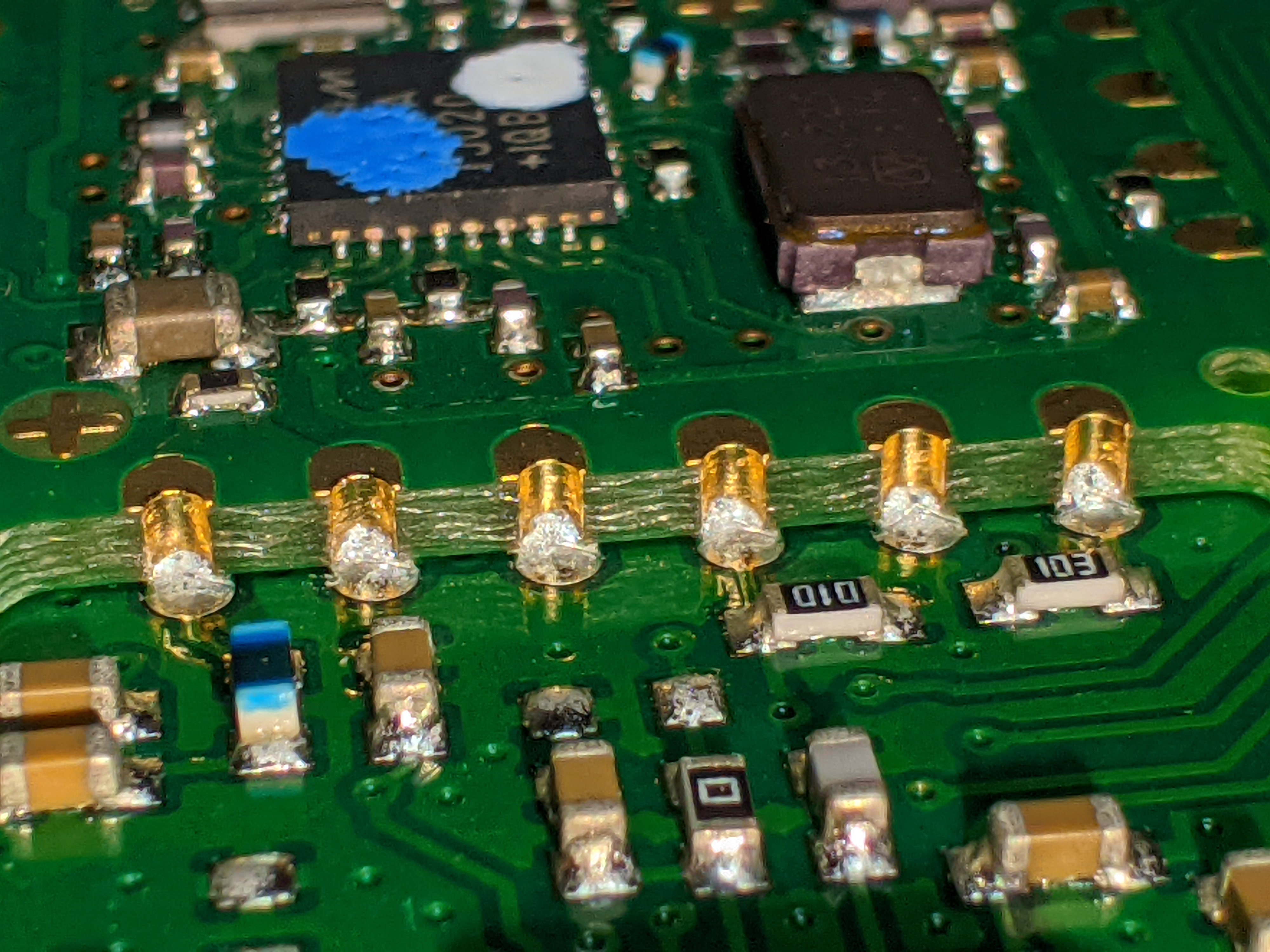

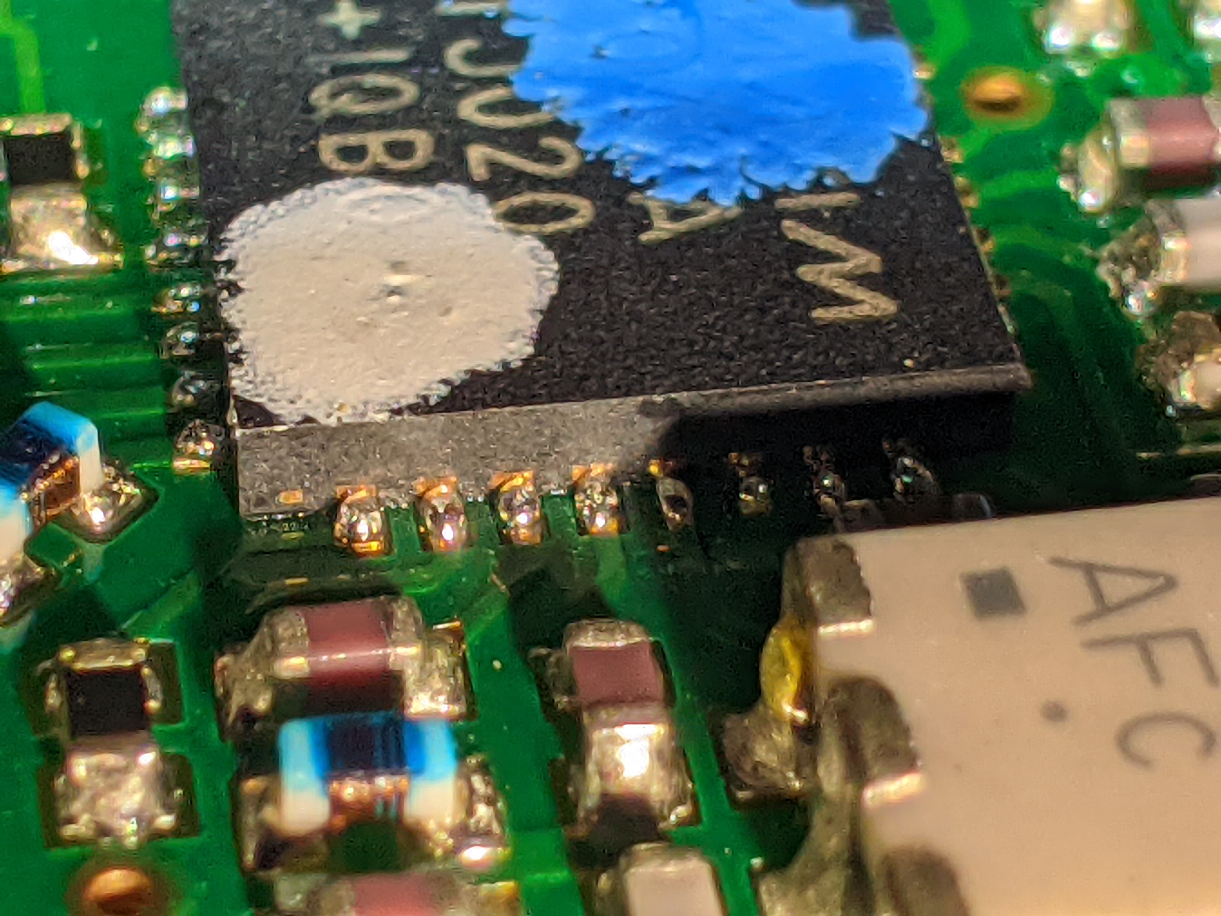

For the keys not working, the radio control unit (which does key fobs and immobilizer, and also TPMS - key fobs and TPMS both run at 433mhz), just seems to be frigged. The solder joints are quite poor on the 433mhz module on the board, but touching these up didn't fix the ability to receive key data. Hopefully I can just get a working radio module - if not maybe I can get a broken one and dig into it deeper and not worry about breaking the whole thing and then immobilizing my car...

I still have not been able to fix the issue with the keys. Robert Dunn of Aging Wheels kindly sent me another Radio Control unit to try in my car, but that didn't work either. Both had horrible solder joints on their MAX7042A 433mhz receiver chip, even after reflowing these I still couldn't pair the key fobs. So either my keys themselves are busted, or both of these RCUs are busted.
