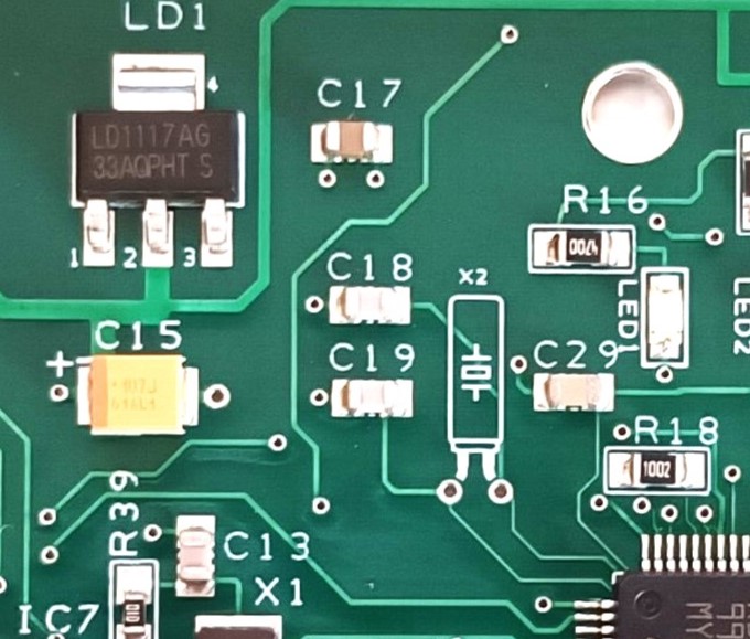

with or without (C18,C19)
What are the two capacitors for, some boards have them, some don't (C18, C19)

Re: with or without (C18,C19) [SOLVED]
They are load capacitor for X2 which is a crystal for the real time clock. As this uses an internally generated clock the crystal is not fitted and the capacitors are not needed.
