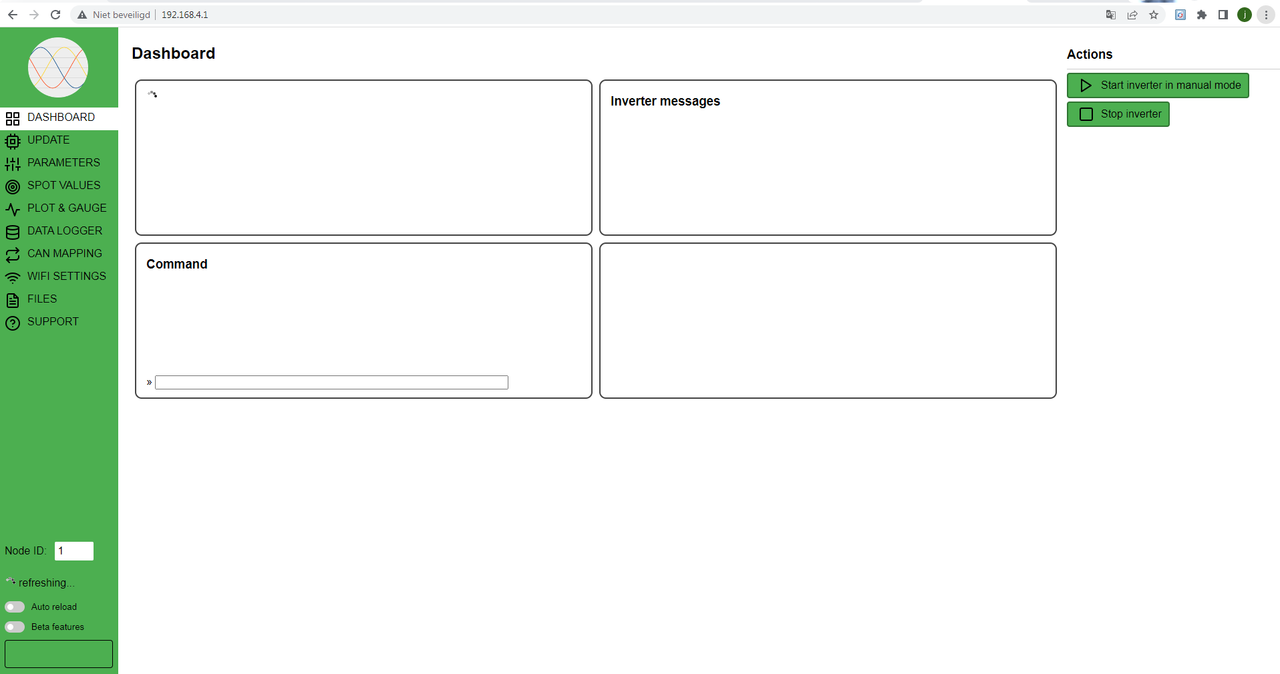

hello,
i am ev converting a g-wagon with a tesla sdu setup. this setup has a openinverter board and is running good. i am now trying to add the esp32 canlite module to this setup due to the inverter wifi signal not reachin the cabin. i am having trouble with this as i get no paramaters or spotvalues in the esp32 interface. i added a picture of this interface. simultaniously also the interface of the inverter has changed. i added a picture of this changed interface too. at this point a can no longer see any spot values or change any parameters. at one point when connected to the inverter the same interface as the esp32 showed up and all the paramaters and spot values where visible but this was a one time event.
i already tried some things to find the cause. i checked the can bus with a scope and saw some signals so i guess the canbus is being used. to eliminate all distortion of the signals i tried to run a shielded 2-wire cable directly from the inverter to the esp32 module but this did not change anything.
do i need to install a different firmware on the esp32 module to get it to work? do i need to change any can parameters in the inverter?

Thanks johu and muehlpower for the quick replies,
I already bridged the r6 resistor on the board, this did not solve the problem.
I tried the solution linked to by muehlpower but i do not see any .json files in the file list of the esp32. Or do you mean the .js files?
Could the solution be to download the paramlist from the inverter and upload this to the esp32?
A change in the interface did occur, in the lower left corner the text “firmware:null” and “web:v2.1” appeared. I dont know if this is normal?

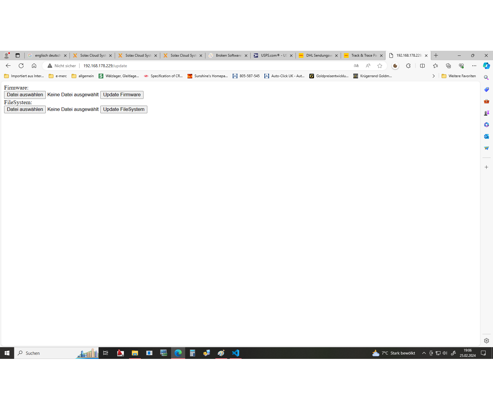

Do you think you can upload the latest firmware? https://github.com/jsphuebner/esp32-web ... an-backend
You need platformio. It works over the wifi connection with a little mod: viewtopic.php?p=60907#p60907
What firmware is on the SDU? I just checked again, for this to really work you need the latest https://github.com/jsphuebner/stm32-sine/releases
5.27 might also work but less reliable
Try that before updating the ESP firmware

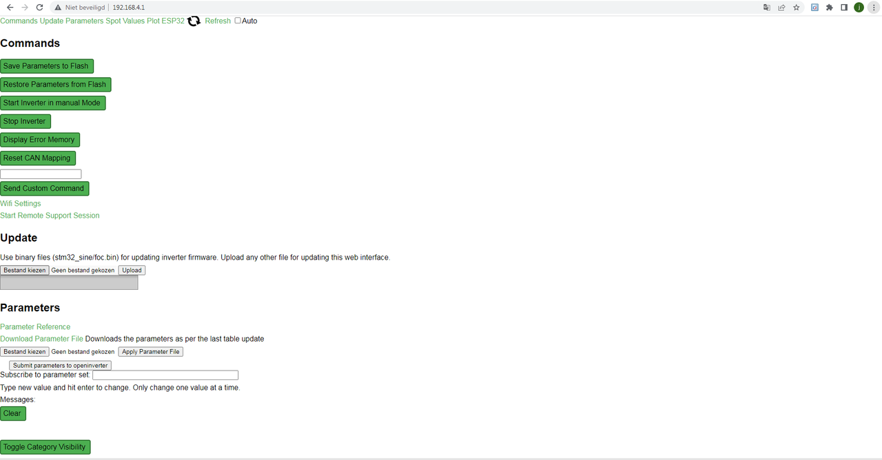

I've downloaded the images and attached to post.
Re: interface problem tesla sdu with esp32 canlite module
Johu thanks for the help!
The software update of the inverter was the issue, it was still on the 5.20 version it was delivered with. This update along with a change of the can speed parameter to 500 made the interface display the parameters and spot values. I only experience sometimes that the spotvalues do not display in realtime but seem to be stuck since the startup of the inverter. Is there a solution for this?

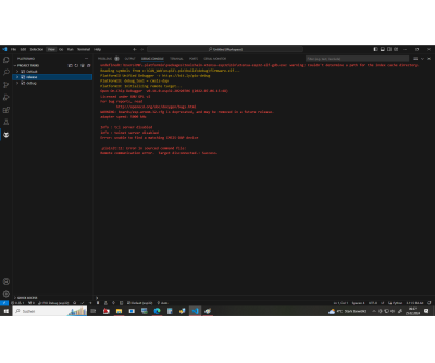

I tried to install the latest software, but now it doesn't work anymore. The connection works, but I get the following message.
platformio ran through and showed no errors
R6 is also exchanged with 10k
I downloaded the ZIP file from here and changed the 3 lines in the .ini.https://github.com/jsphuebner/esp32-web ... an-backend

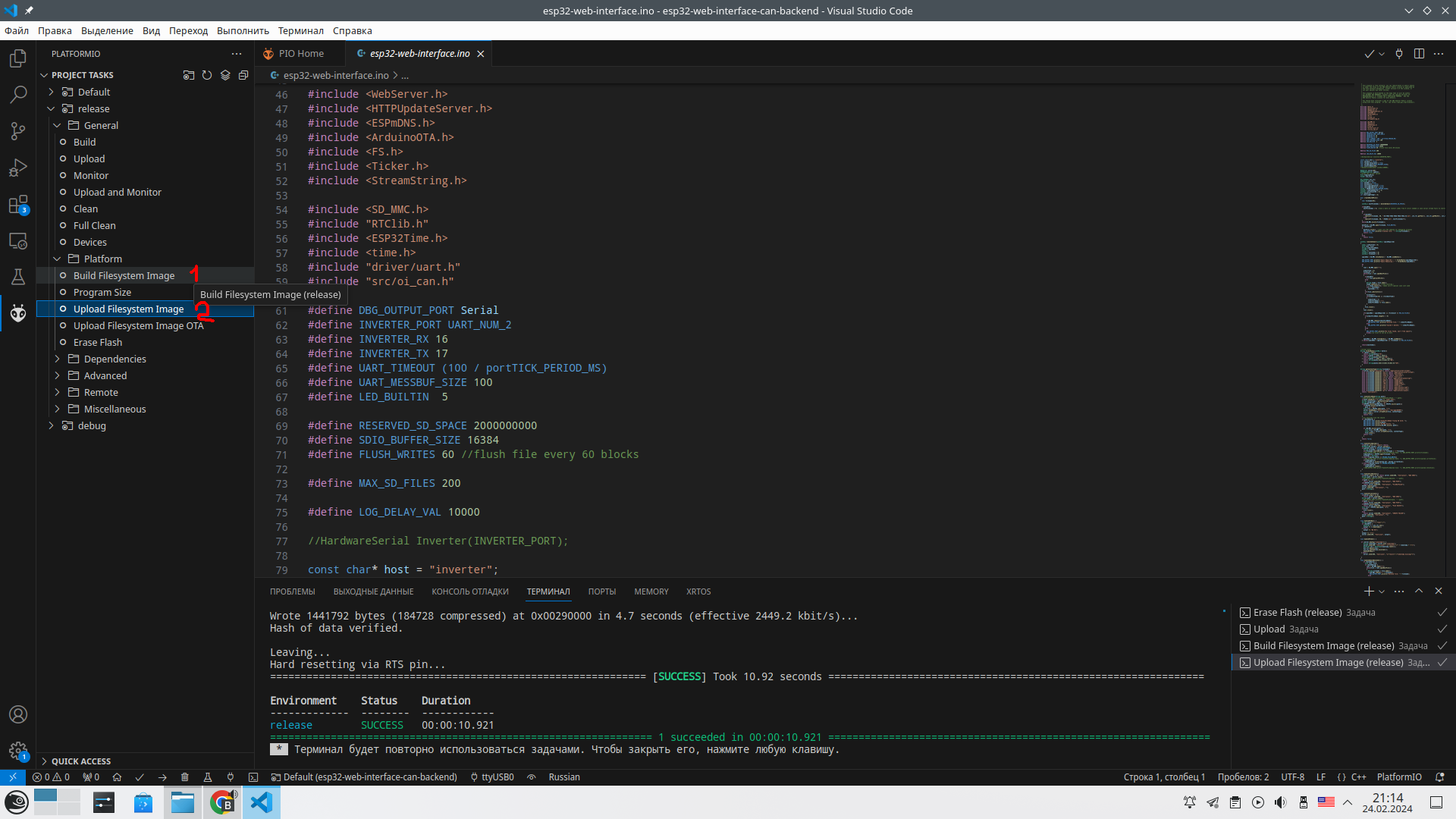

Have you updated the spifs also and pressed ctrl+f5 for full reload?

This is the ESP32 file system. Do this after flashing the ESP.

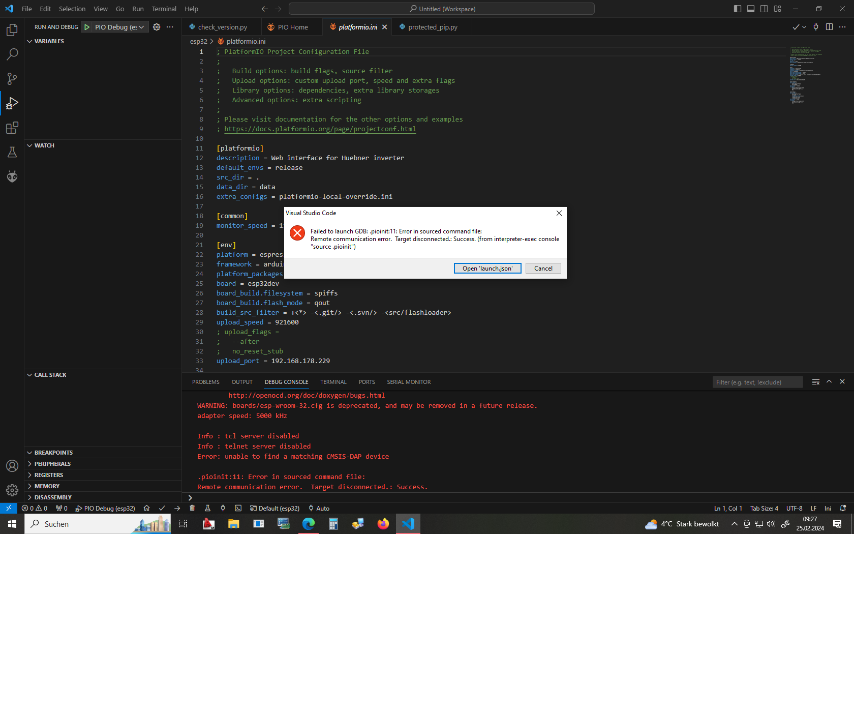

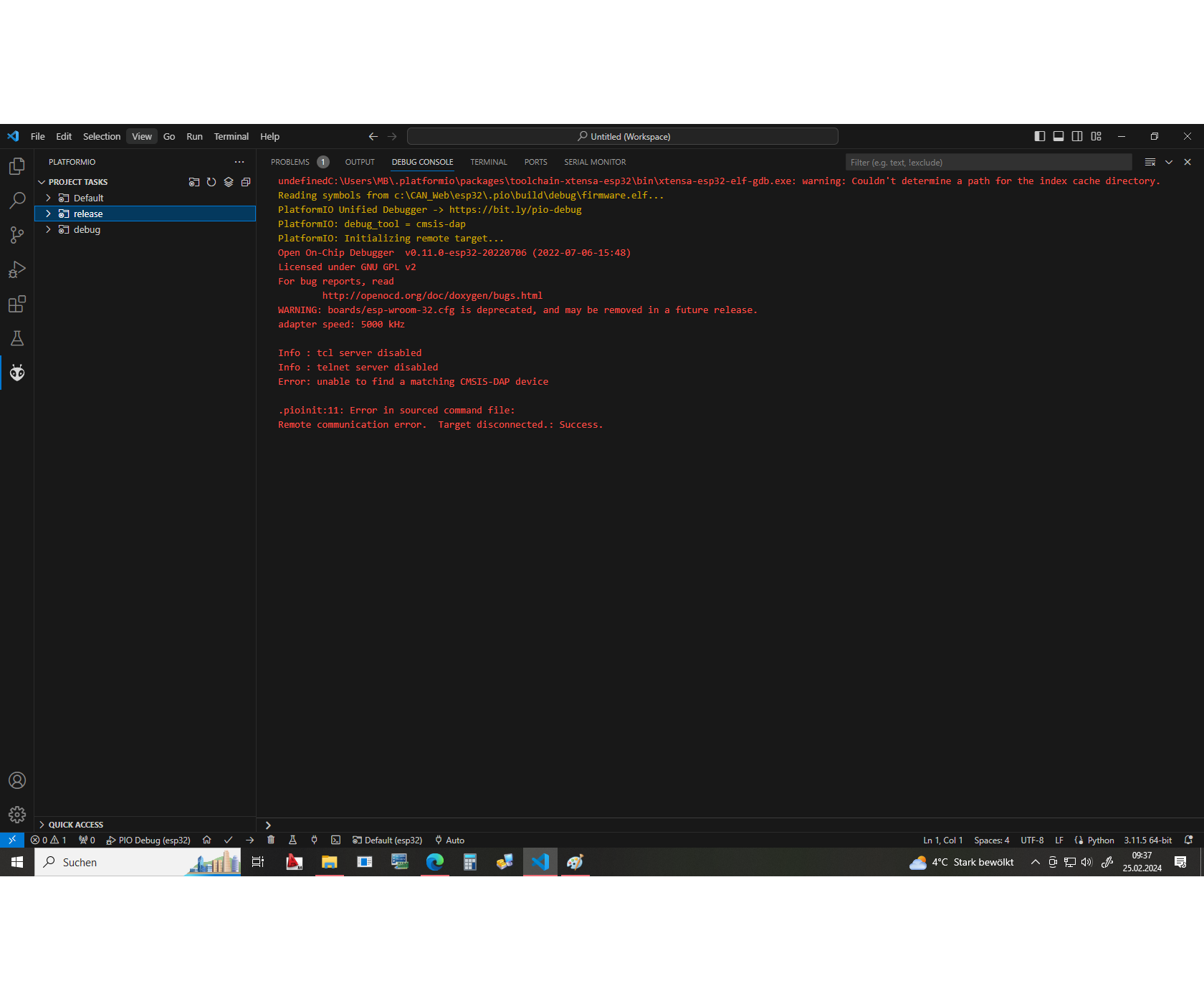

what I have done:
I downloaded the ZIP file from GitHub and unpacked it into a folder. I have VSC and the platformio extension installed. In platformio.ini I changed the 3 lines and entered the correct IP address. Then I opened a new terminal window and changed to the unpacked directory and entered "pio run --target uploadfs". After a while, 100% was achieved and success was indicated. what happens next?
- muehlpower
- Posts: 689
- Has thanked: 14 times
- Been thanked: 141 times
Then, as you described, I first clicked “Build filesystem image” and then “Upload filesystem image” again 100% and success. But it hasn't changed!
OK, that updates the spifsmuehlpower wrote: ↑Sat Feb 24, 2024 6:49 pm Then I opened a new terminal window and changed to the unpacked directory and entered "pio run --target uploadfs"
Did you also run "pio run --target upload"? that would be the actual firmware update

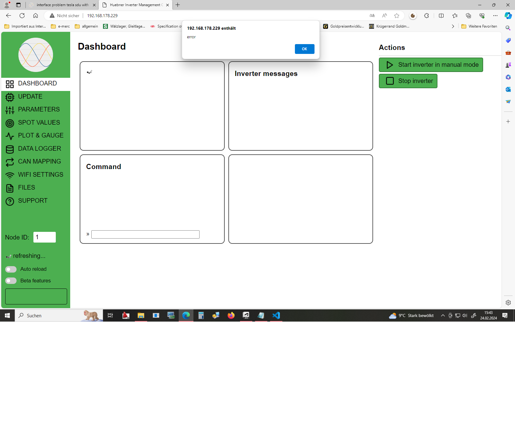

yes, the interface is visible, but no parameters and with the error message like in the picture.

Hmm, the error message is related to automatic parameter download from the parameter database. Weird.

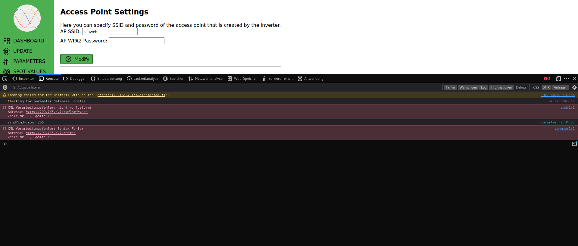

now it's a little different. At the bottom left corner it says firmware : null /web : v2.1 and I can't select a node id.

in most things I see the mask, in WIFI SETTINGS everything is just white!

the internet connection seems to be working. When I click on OpenInverter Forum in support I end up in the forum.
Can you press F12 so the debug console is visible, do a full reload (ctrl f5) and post a screenshot
After further attempts it now looks like this:
