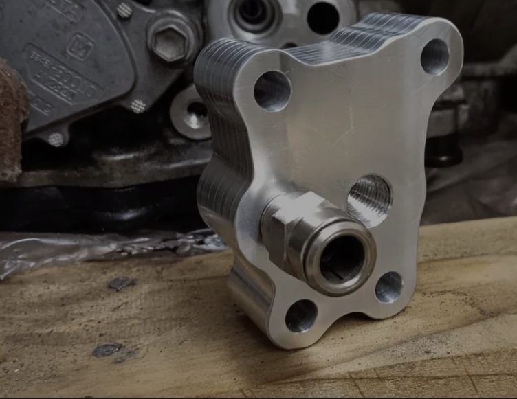

What about something like an accusump to store oil pressure while driving? They make them with a solenoid to store the combustion engines oil pressure while the vehicle is off. Key on typically turns on the solenoid to send pressurized oil into the engine. You could potentially use something like this to store oil pressure while not moving but a few points:
1 you'd have to build up oil pressure with the wheels up then turn off the accusump solenoid.
2 if you managed to run out of pressure while out you're screwed.
3 still looking like an auxiliary pump is required for slow moving traffic. I'm not sure what speed the transmissions internal pump takes over. An external pump that turns on < 0 throttle but < wheel speed. Then could watch pressure in the accumulator and kick on when necessary or run variably to maintain some acceptable pressure.
You could use an adapter like this,
https://www.ebay.com/itm/175936880476
Along with one of the many universal oil pumps available that could work as a backup pump plumbed into an adapter.
I'd be willing to draw an adapter up in Solidworks if someone got me good dimensions of everything.

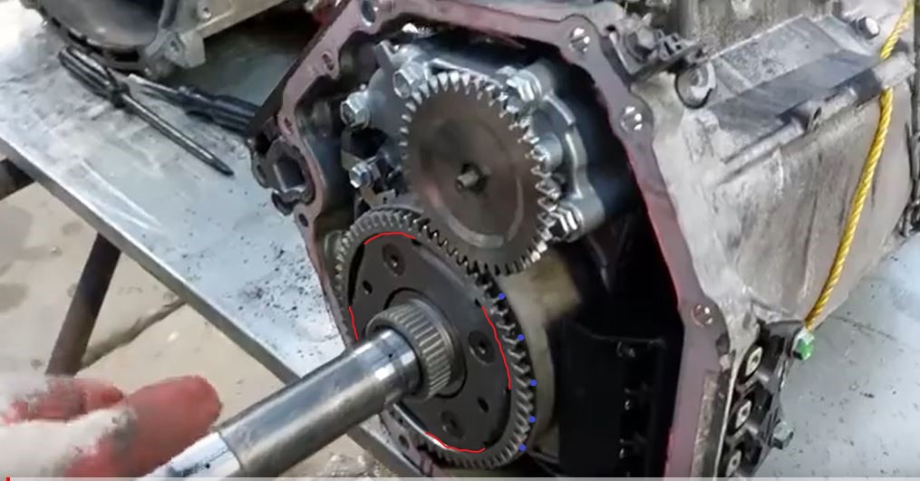

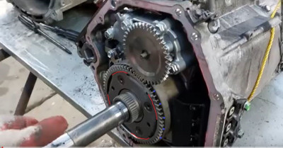

Ok. Moving forward. I now have a GS450h transmission, complete with pump and the inverter.
Although I have the oil pump, I'm still planning to see if I can find a way of running without it, for simplicity.
Having the pump means I should be able to trace the flow through the trans and see if the internal pump will provide sufficient flow for lubrication and cooling. We don't need high pressure, as I'm planning to lock the trans in high so no shifting is required.
I will assume locking in high will be fairly simple so will attack the internal pump drive first, to see if it's possible to drive it from the ring gear of the PSD (linked to output shaft), rather than the planet carrier, which is linked to the input shaft (which will, of course, be locked still).
nino500
Posts: 16
Joined: Sun Jan 21, 2024 11:21 am
Location: Somerset, UK
Has thanked: 10 times
Re: GS450h without external oil pump
Post by nino500 »
jrbe wrote: Tue Feb 06, 2024 4:51 pm The GS450h transmission has been run without the oil pump but with some other tricks.
viewtopic.php?t=644&start=225
viewtopic.php?p=39923#p39923
Yes. Konstantin8818's approach (welded PSD and running MG1 'forwards') was my first thought.
I like ggeter's idea of running MG1 independently just to energise the oil pump but this means no driving power from MG1.
So now I have three options:
1, go with locked PSD and code to run MG1 'forwards' or
2, Locked PSD and NO MG1 (either not powered up or completely removed from housing to reduce weight) or
3, and most attractive to me, locked input, running Damien's code but pump drive gear cut away from planet carrier and welded to ring gear as in pic (borrowed from Konstantin8818's video)
Drive gear cut along red lines and welded to ring gear at blue spots.
