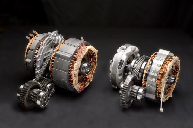

Overwhelmed with the amount of words on the OEM Parts: Category:Toyota wiki page, newb asks: Which Toyota Prius motor would you recommend we use for a front wheel drive conversion? I understand there are different generations of them, but what I'm specifically asking is do we use the regular non plug in one or the plug in one, or does it make a difference?
Johannes sells the Toyota Prius™ Gen2 inverter controller so do we assume that's the non Plug In?
Damien sells the Prius Gen 3 Inverter Logic Board again not specifying regular or plug in
I ask because the Plug In motors appear to be more powerful, correct me if I'm mistaken.

I used the non-plugin one in the A2 conversion and indeed it isn't mighty powerful. The inverter though has a lot more to give than the motor can take. In other words, if you can get ahold of the plugin transmission I'd think the non-plugin inverters can still run it. Not even sure if there's a separate set of inverters for the plugin version.

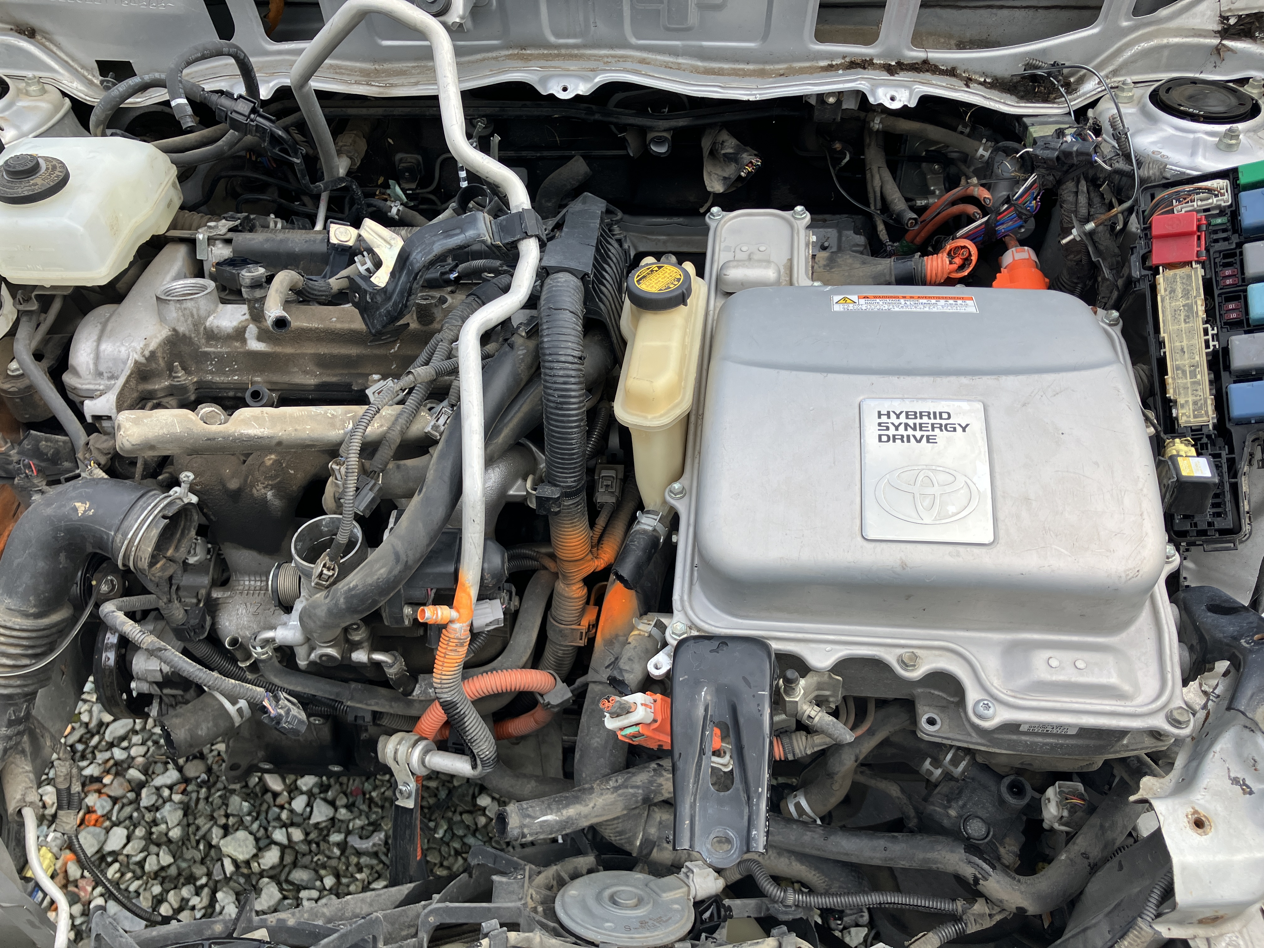

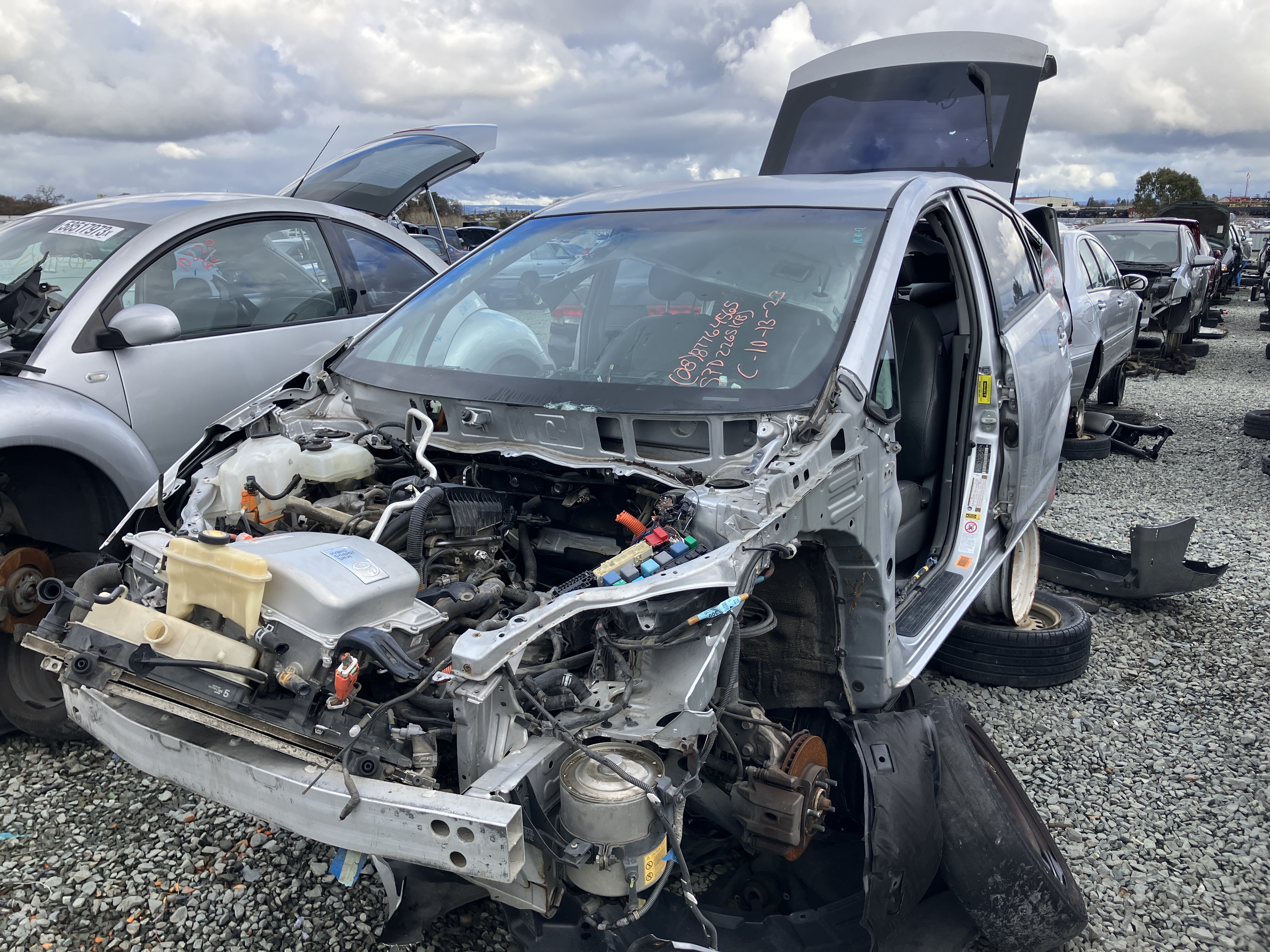

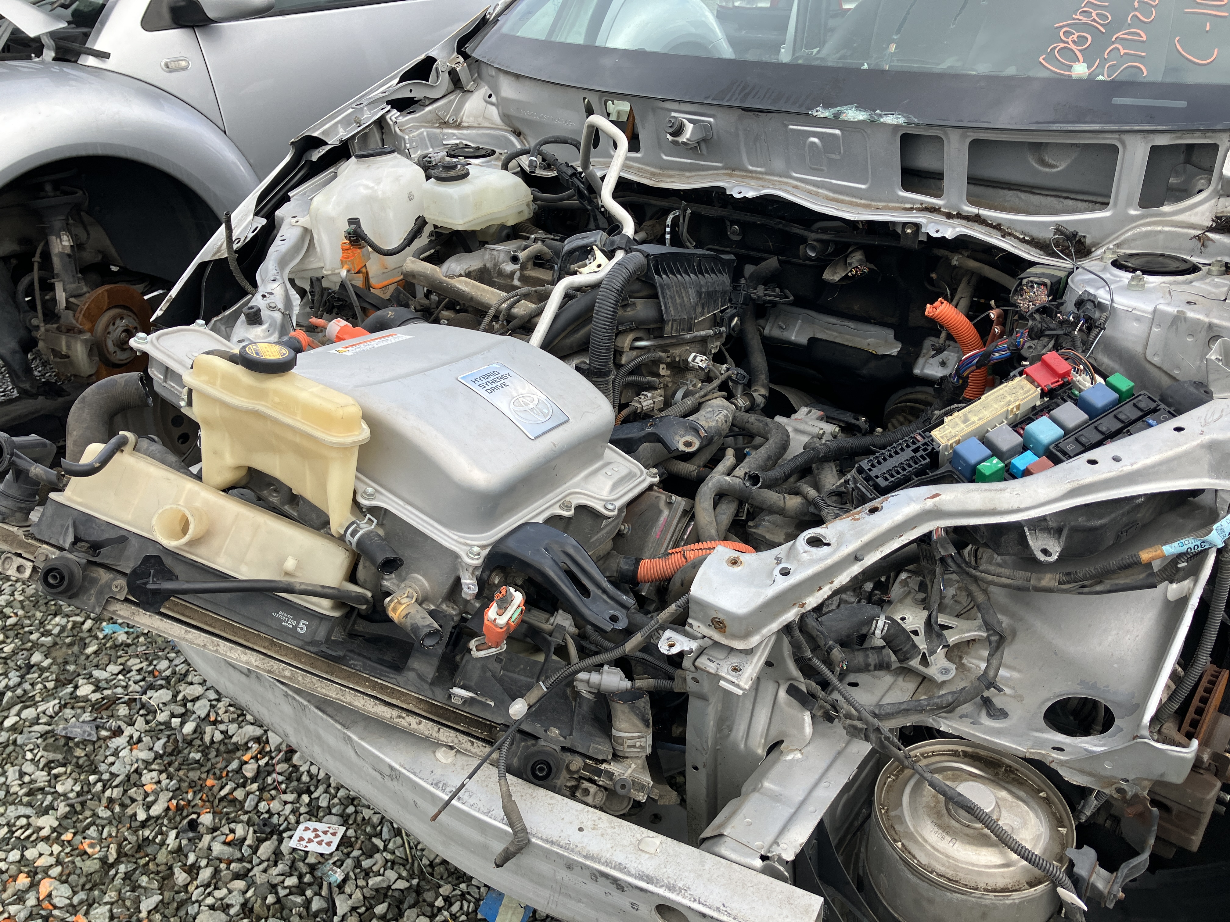

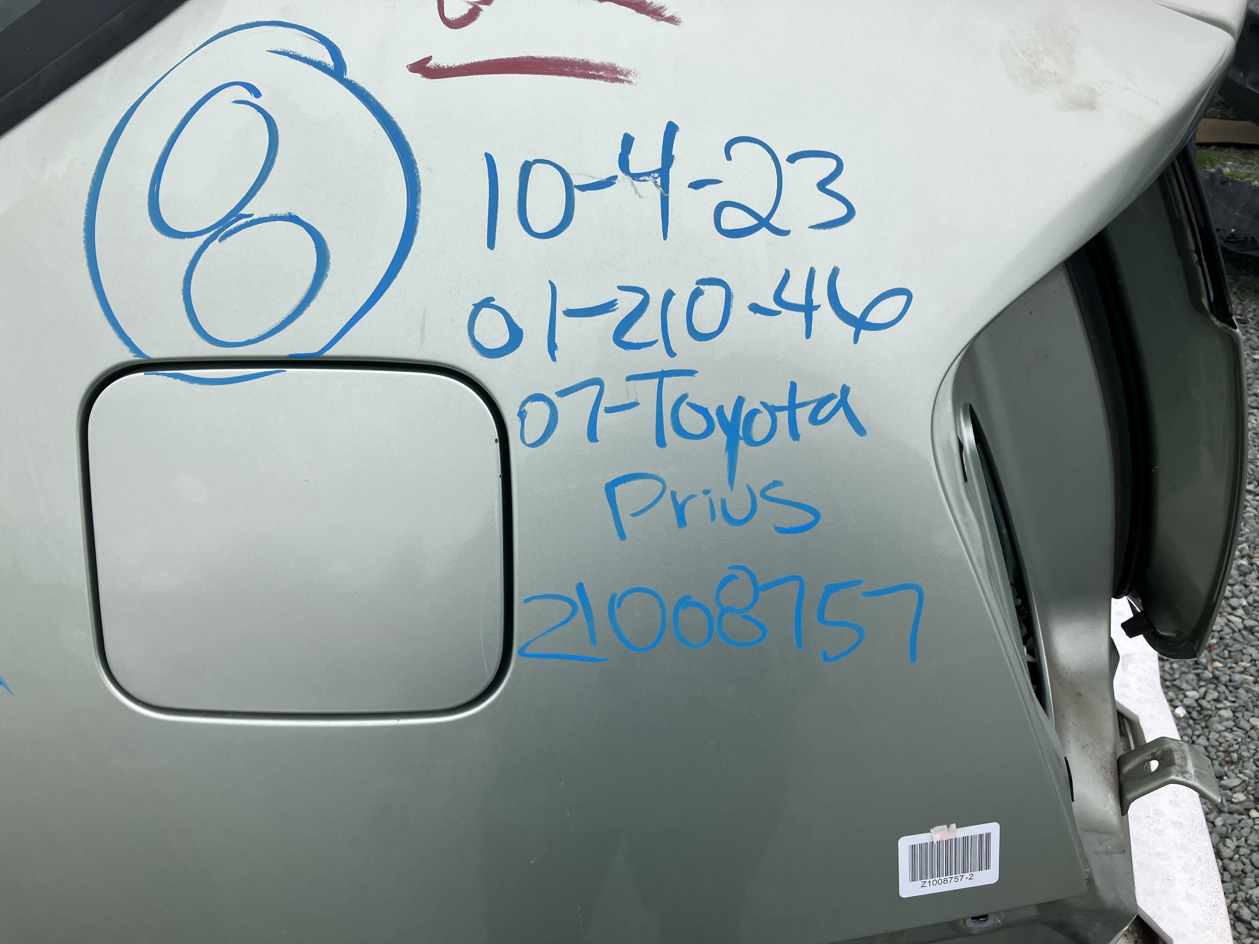

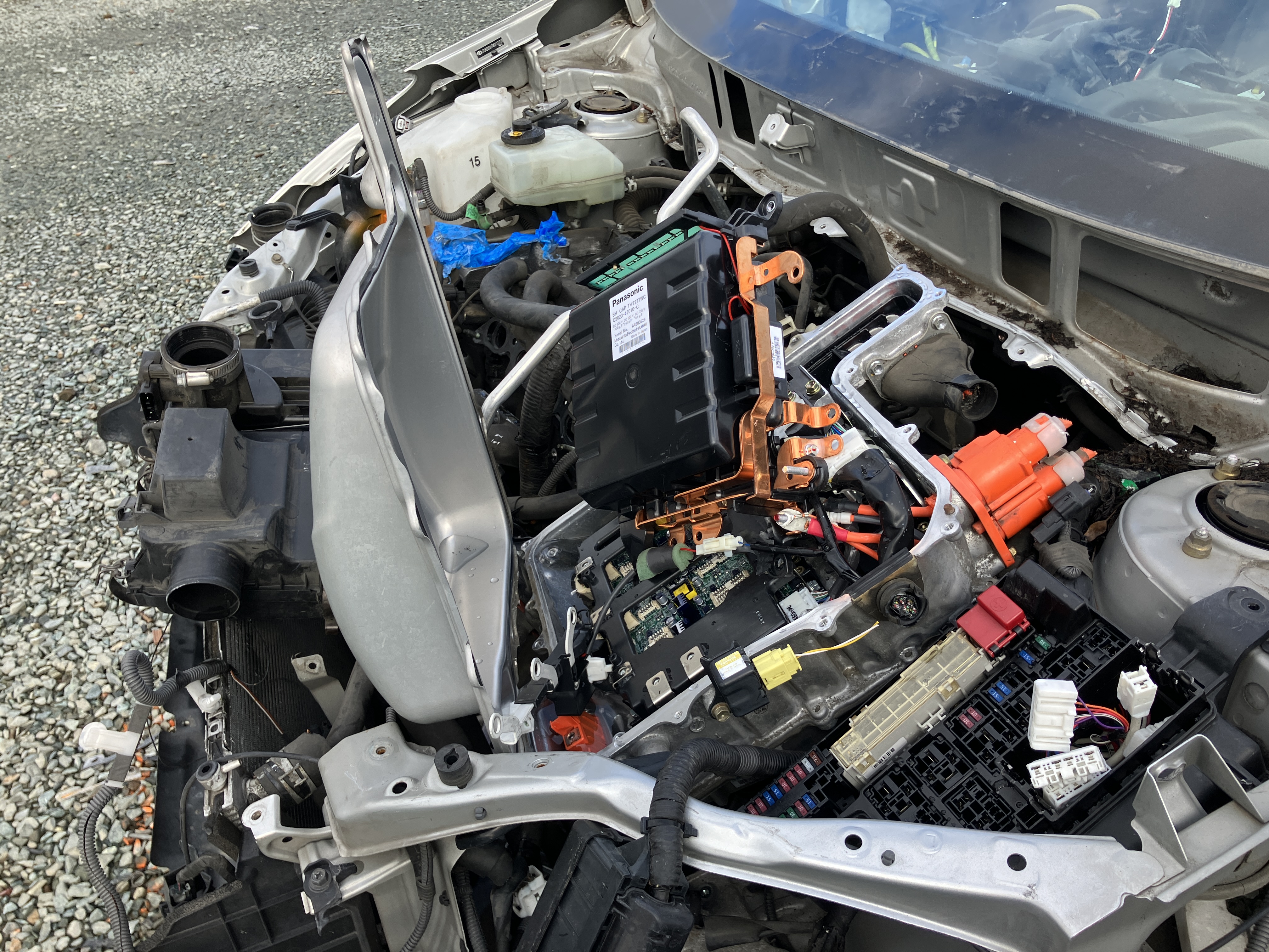

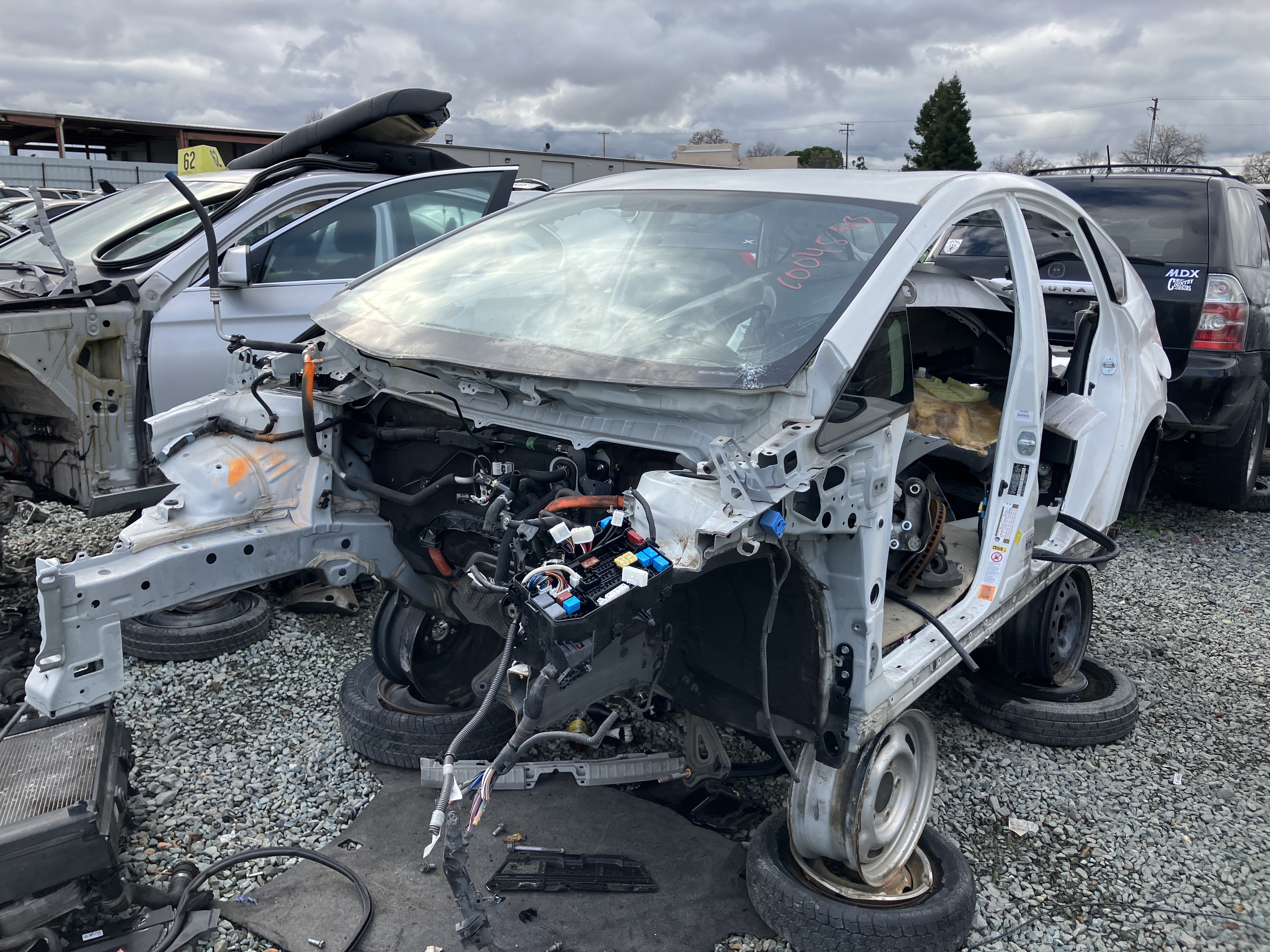

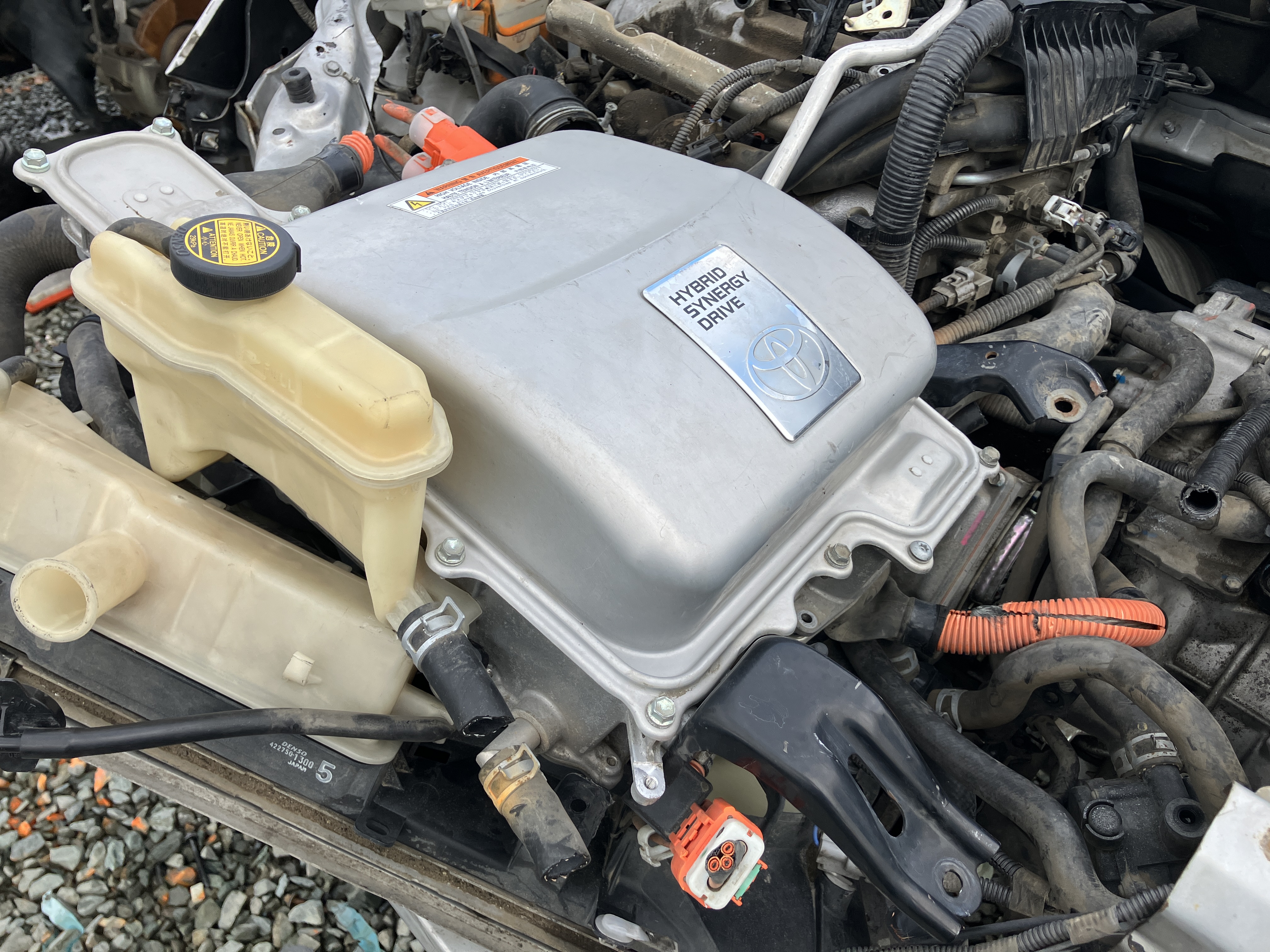

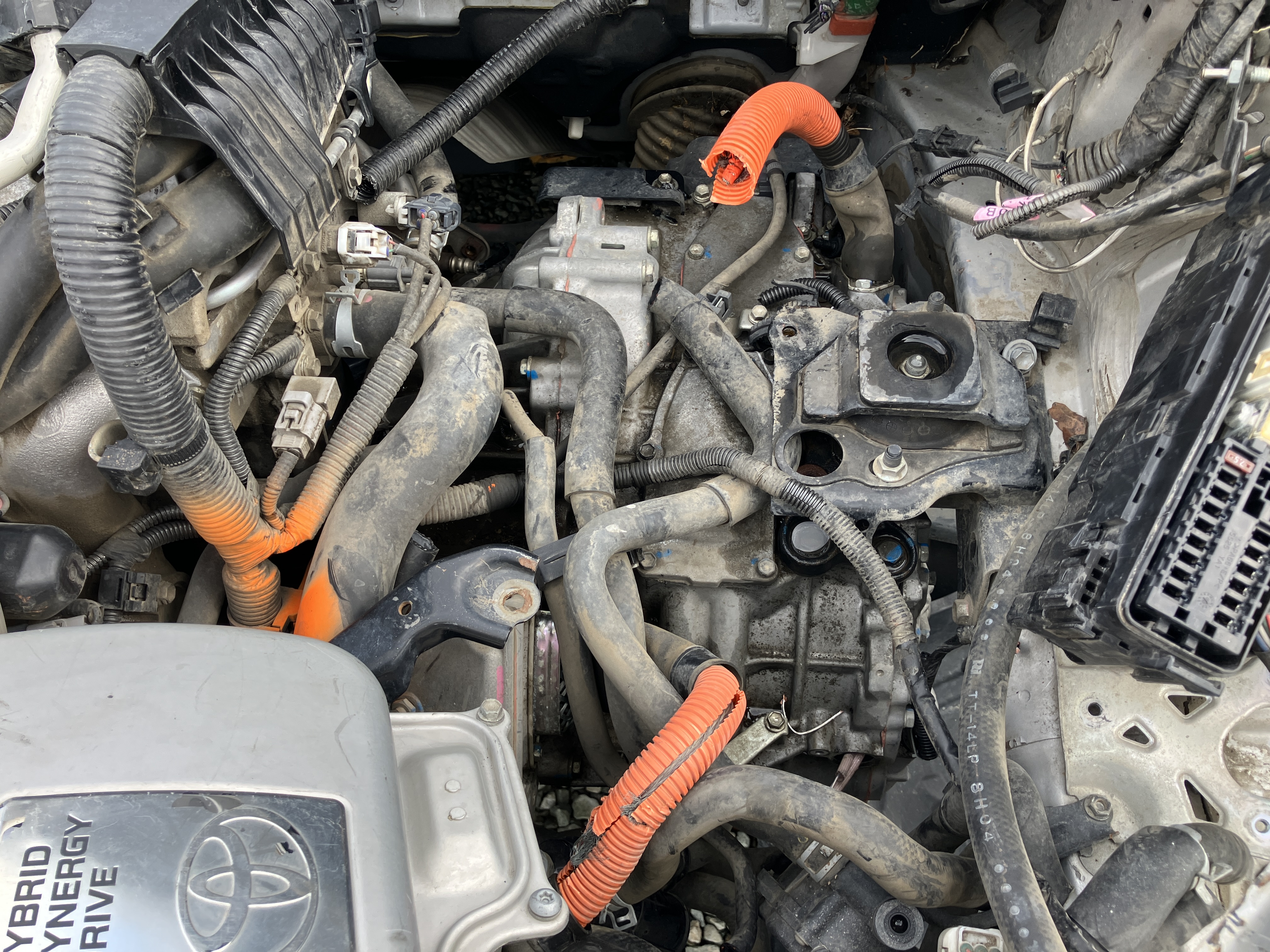

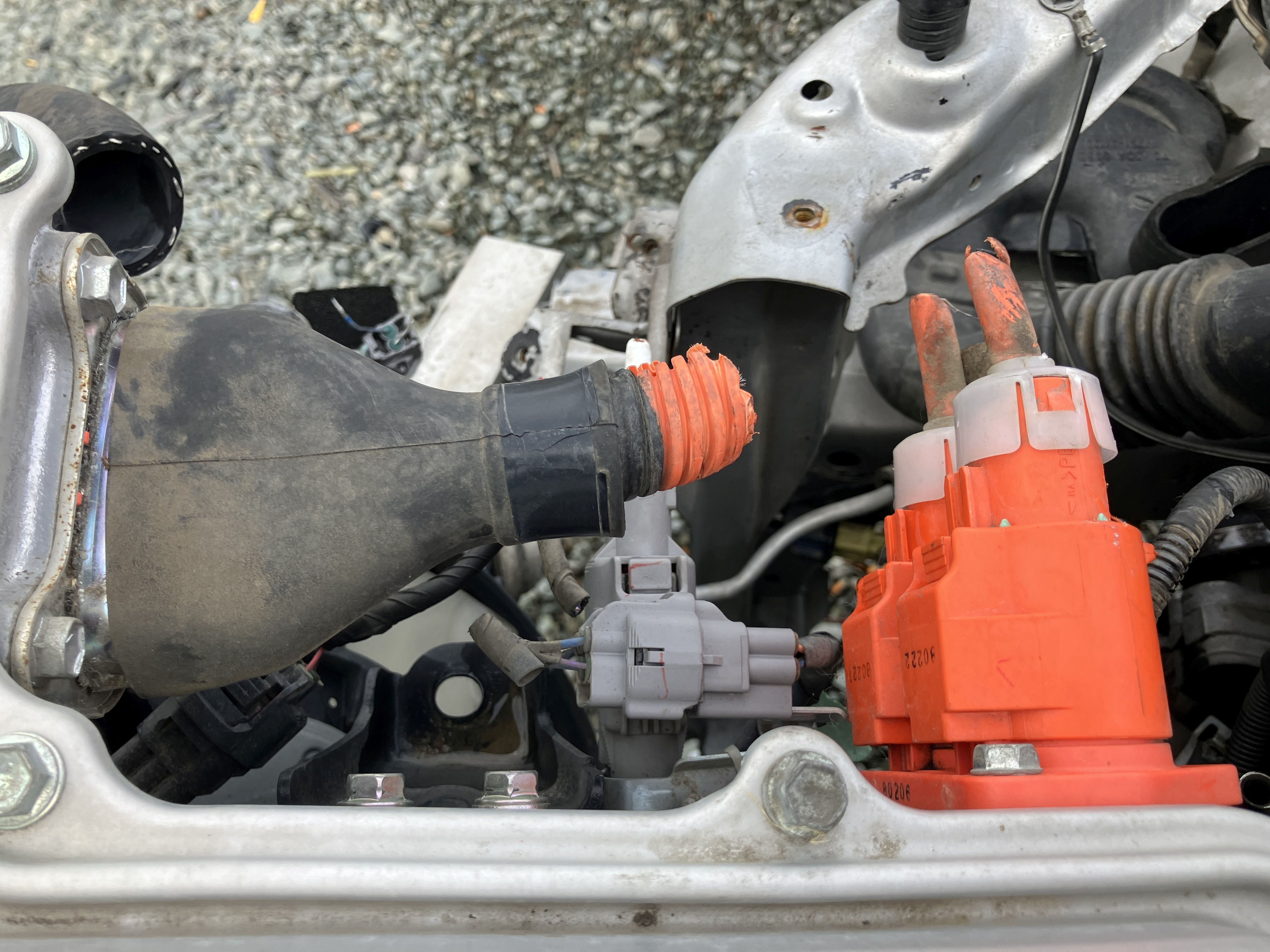

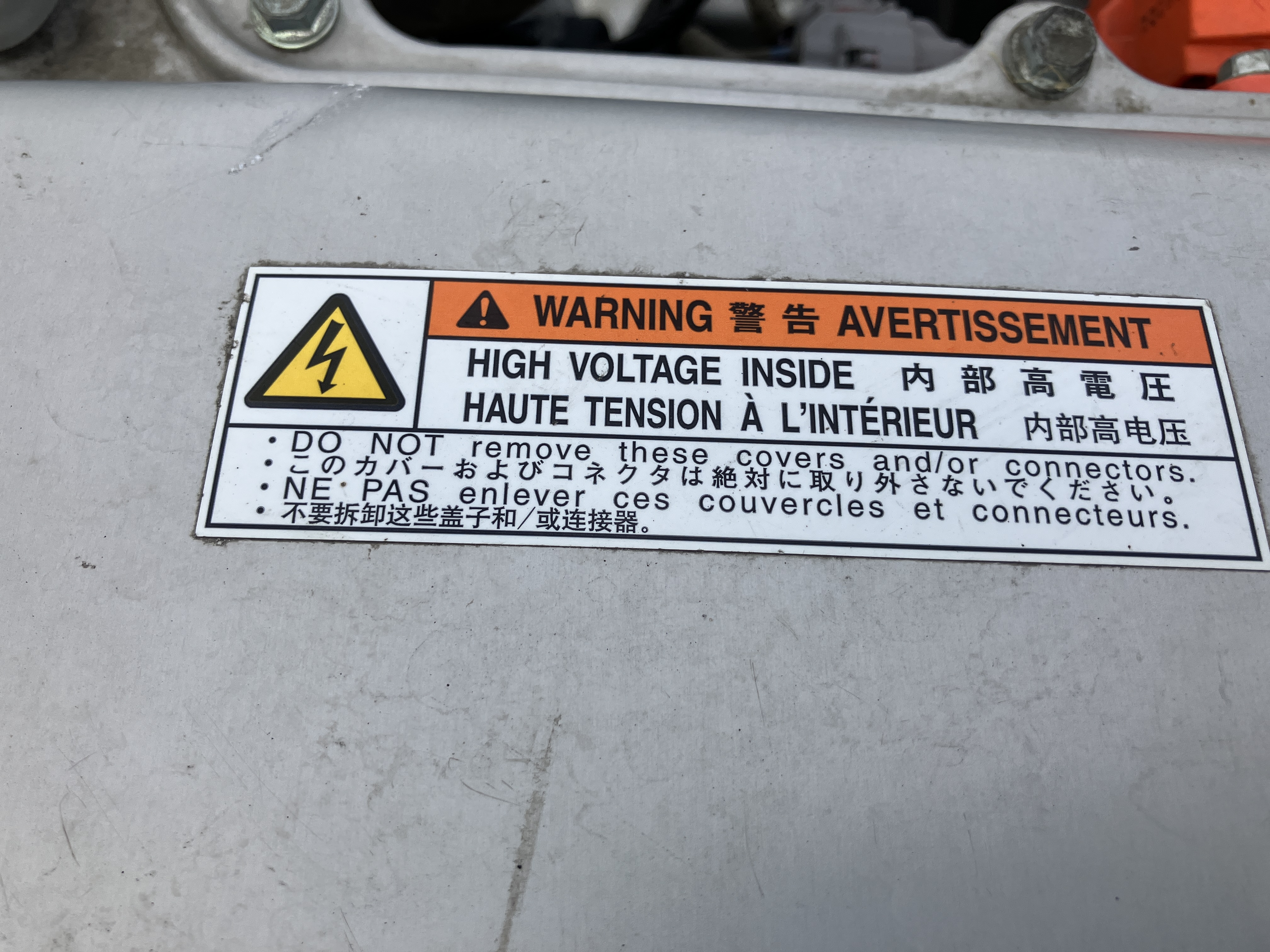

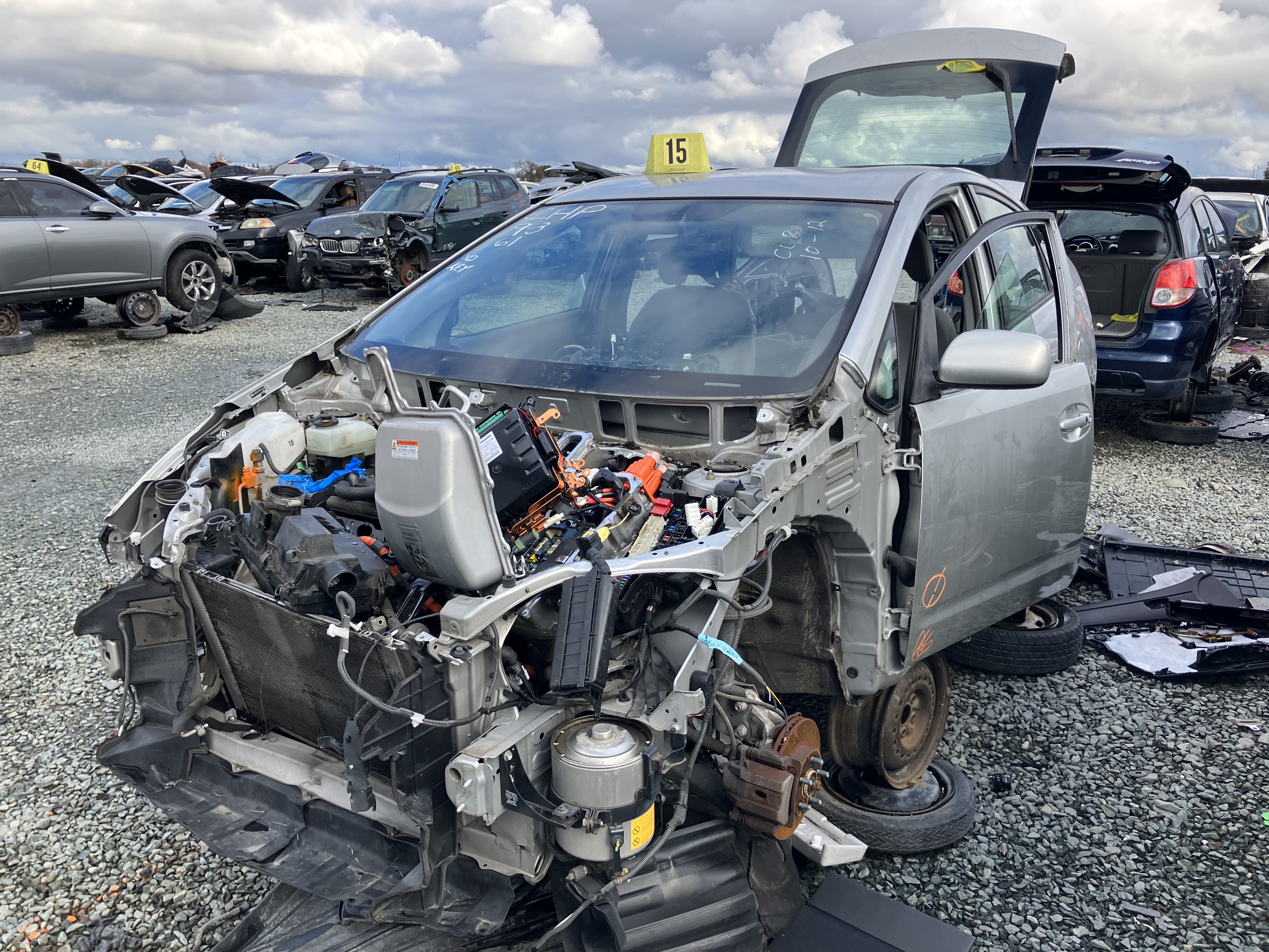

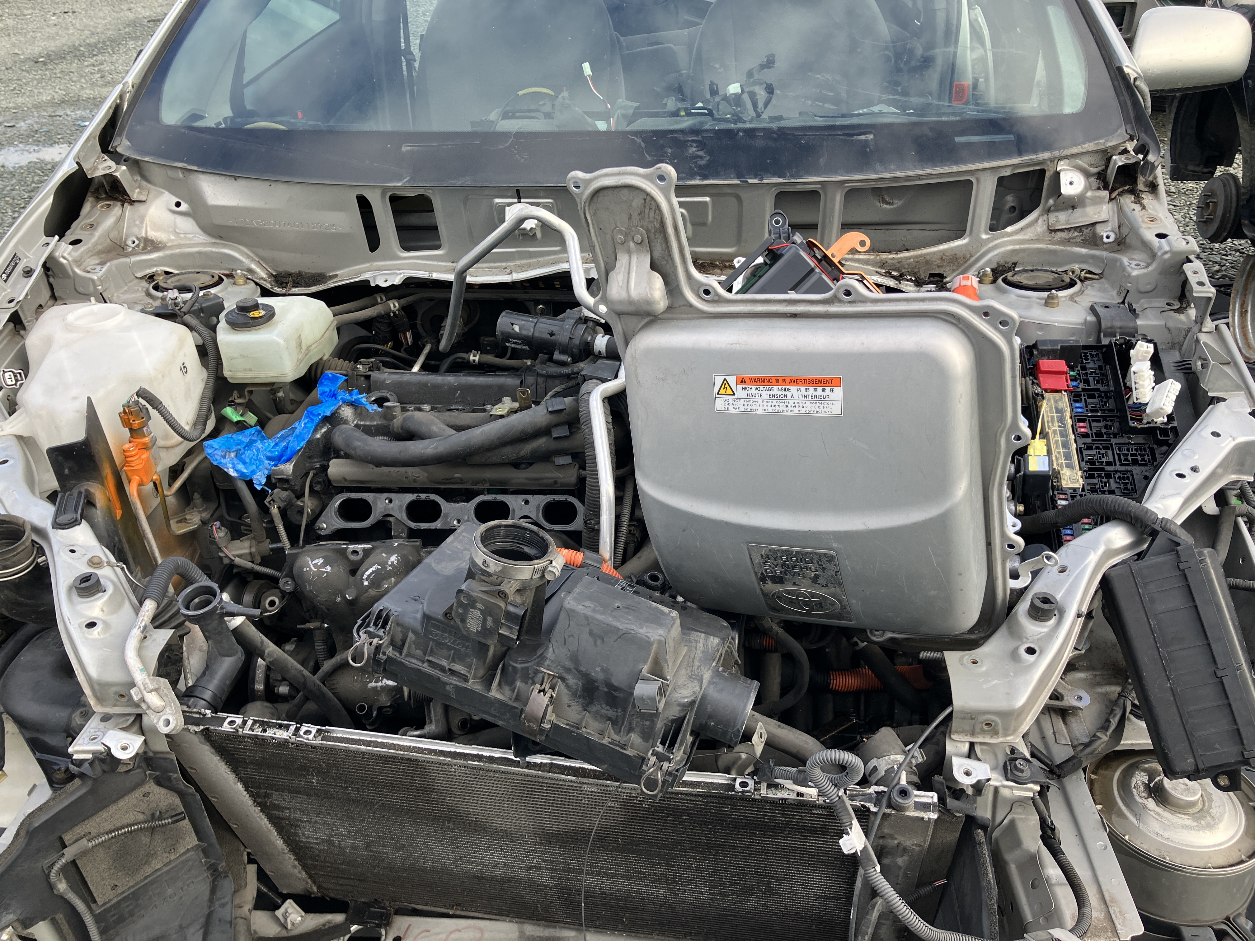

We now turn to our Field Correspondent: The Greg, reporting live from a Pick N Pull a famous junk yard chain in California, USA, tell us what we are looking at The Greg:

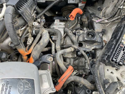

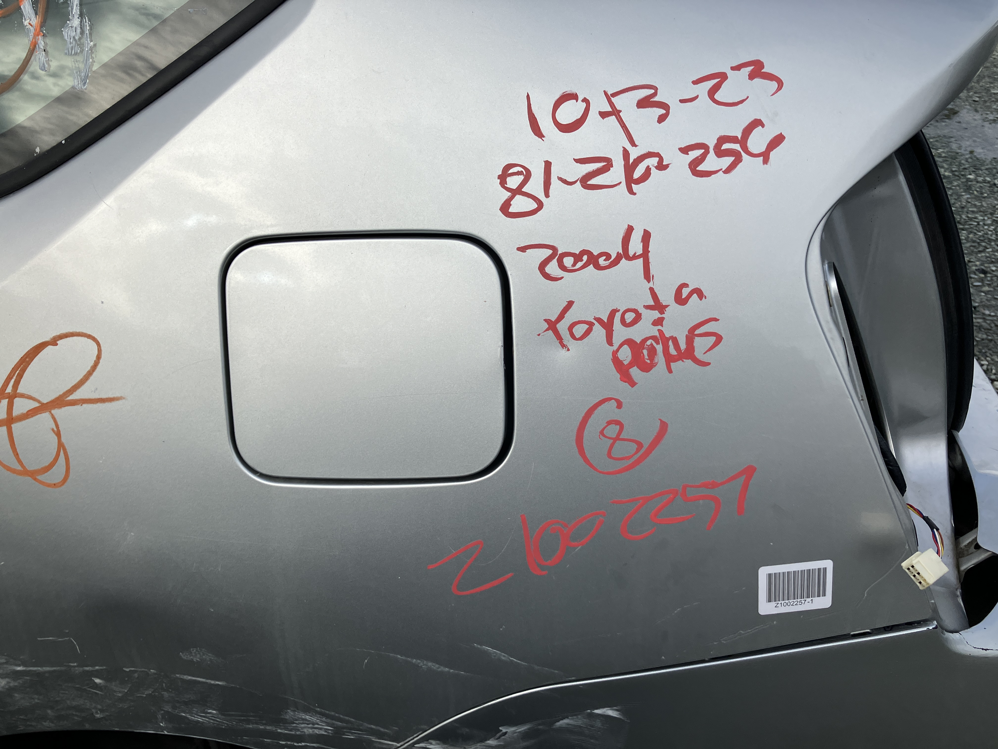

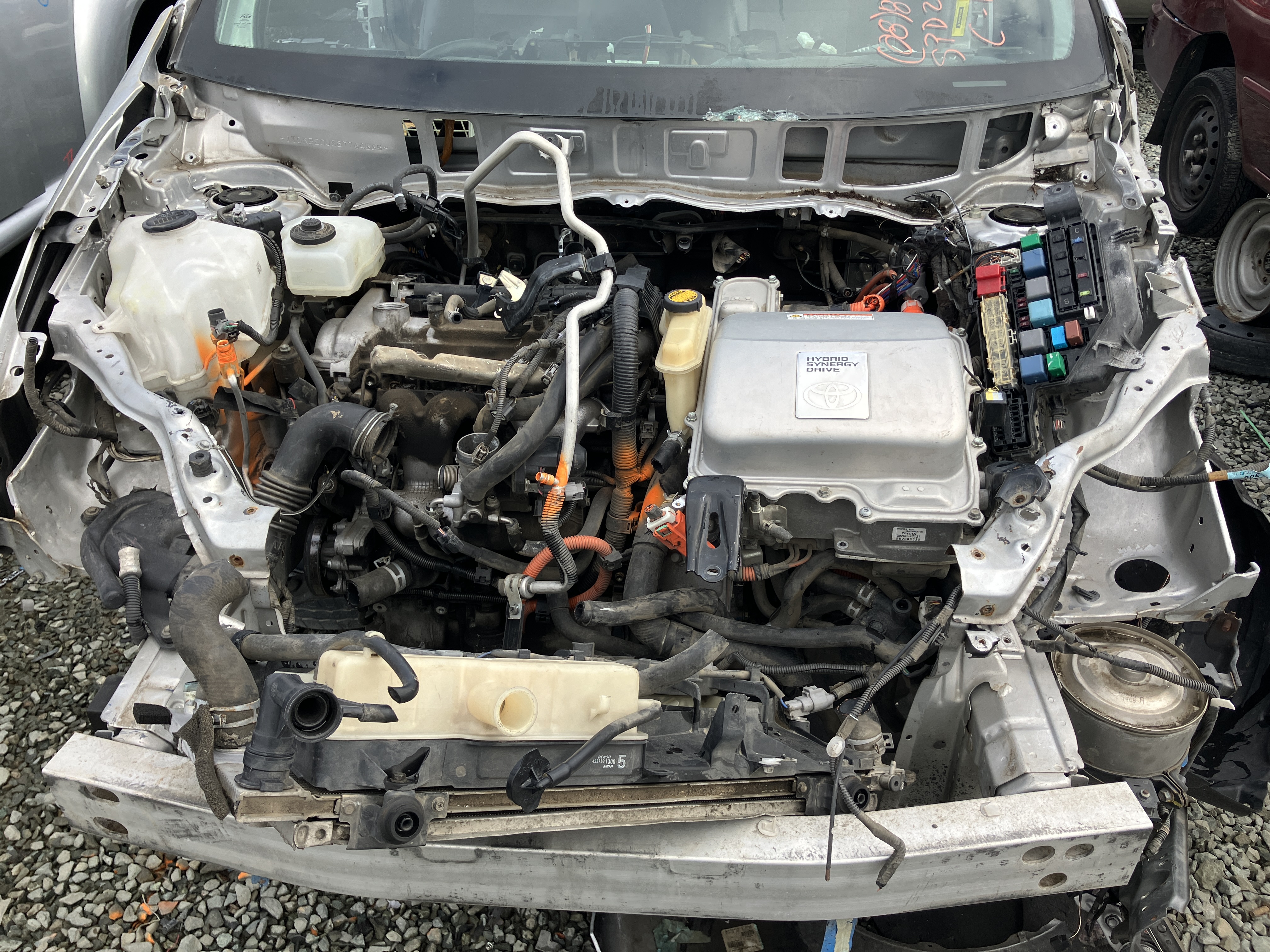

What we have here is a beautiful (Second Generation, non plug-in) 2008 Toyota Prius, offered in silver metalic

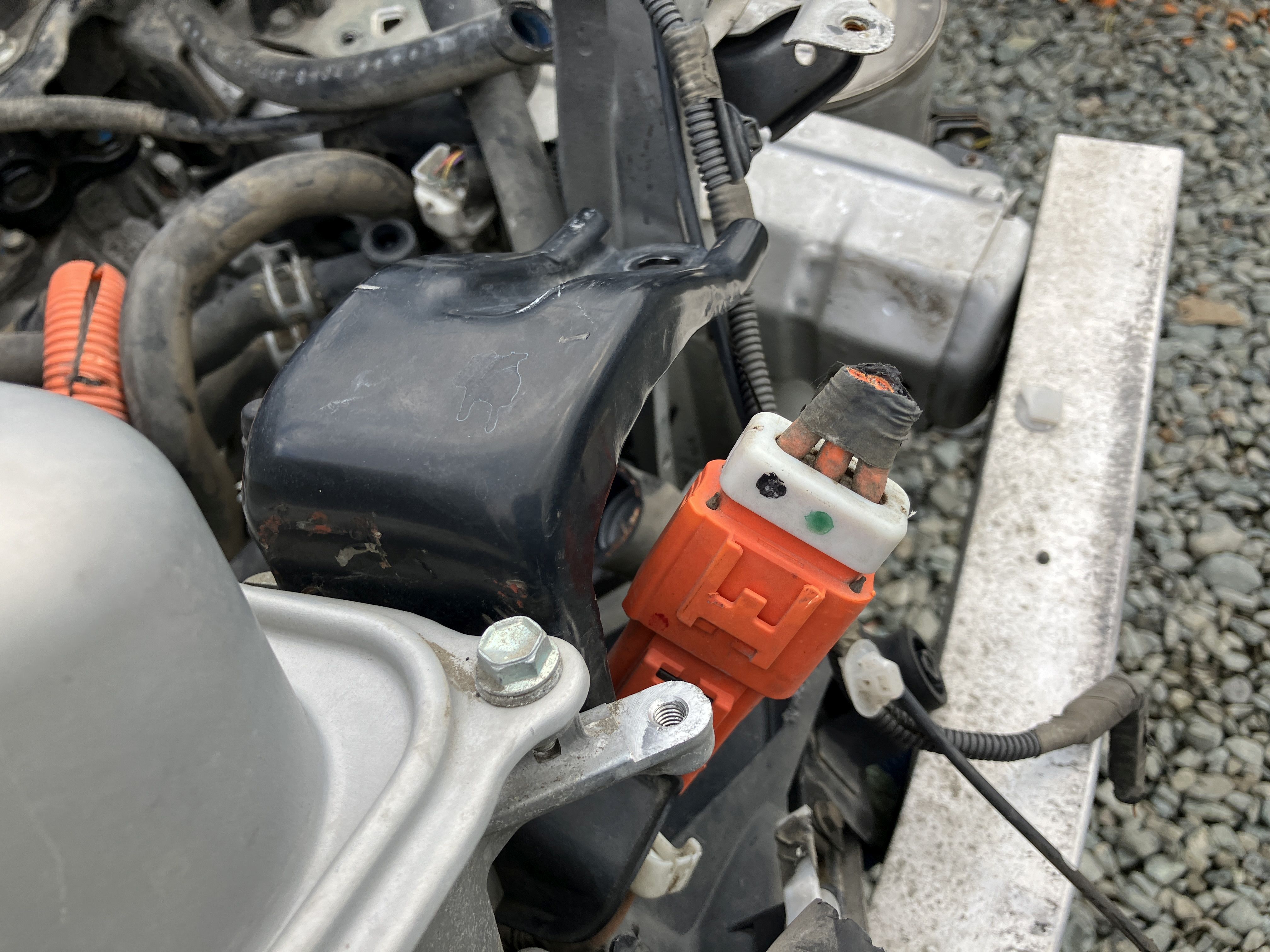

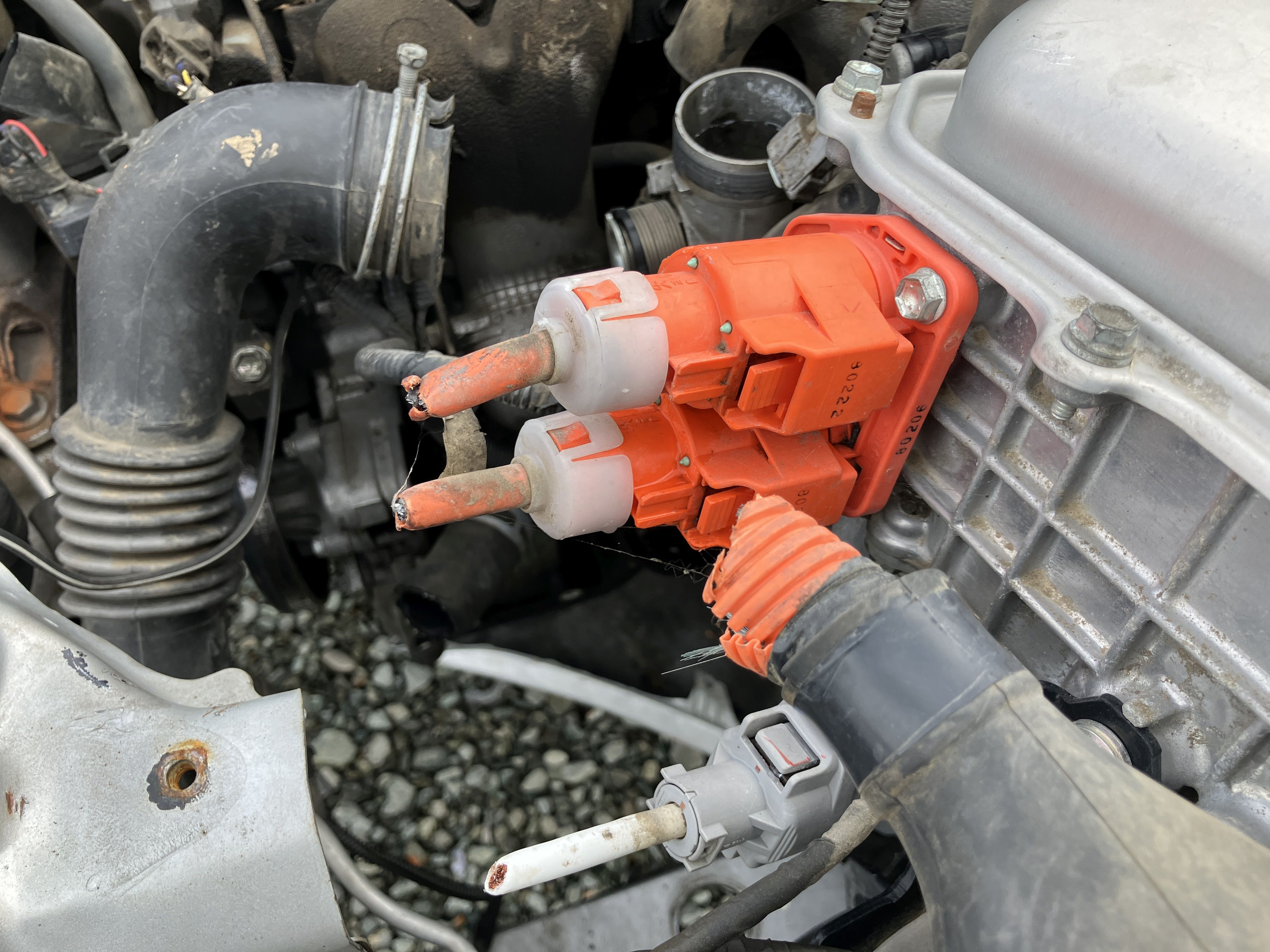

I would like to point out some things to you of what you may find in the scrap yards in United States, note the cut high voltage orange cables, I am being told by the PnP Weekend Staff (pronounced: Not Very Experienced) that, that is part of their "production process" and it wasn't butchered by the DIY gorillas like me

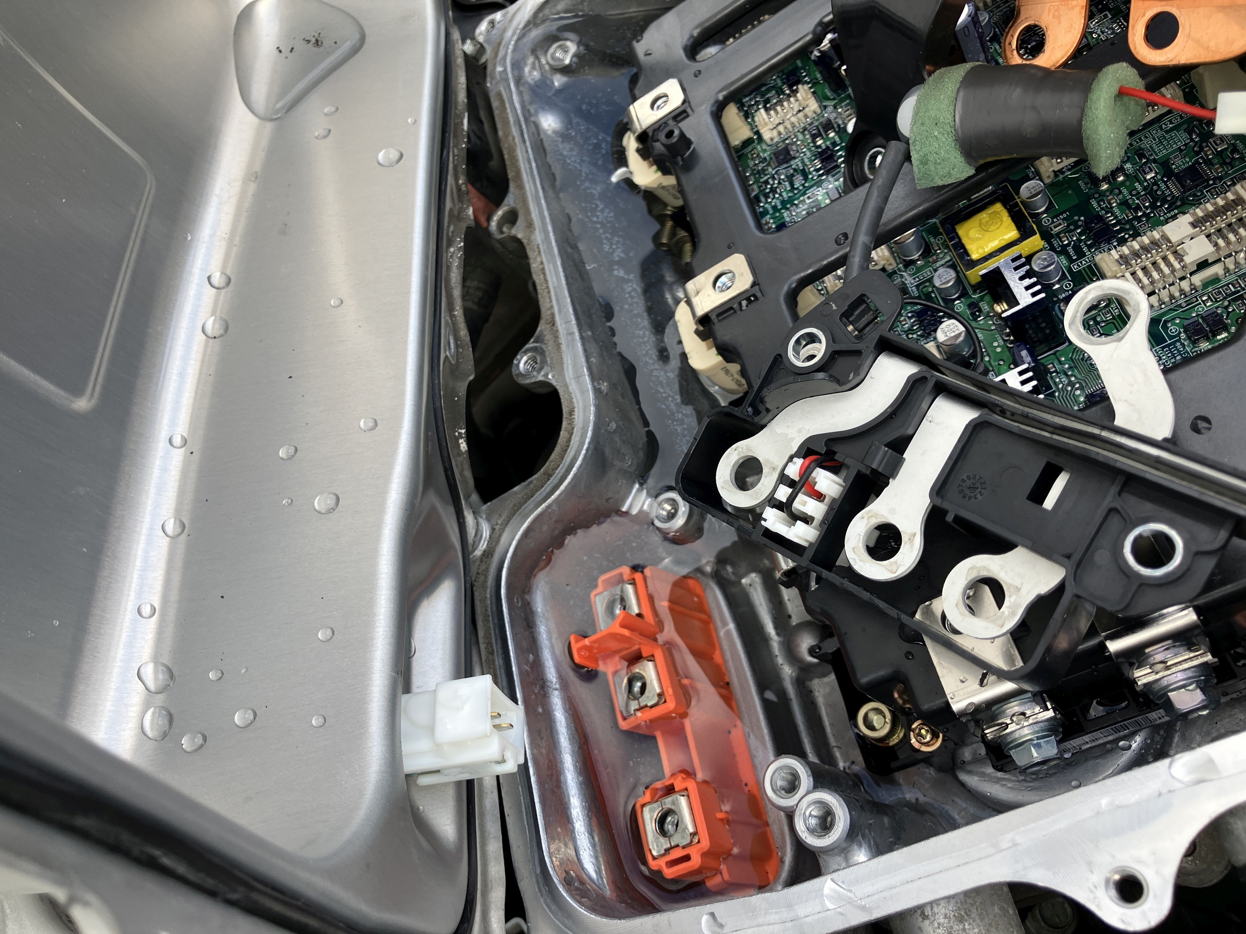

Inverter, obviously NOT in it's stock location
and here are some of those cut high voltage orange cables
Gregski
Posts: 3171
Has thanked: 635 times
Been thanked: 1611 times
Re: Newb Asks: Do we use the Prius motor or the Prius Plug-in one?
Post by Gregski »

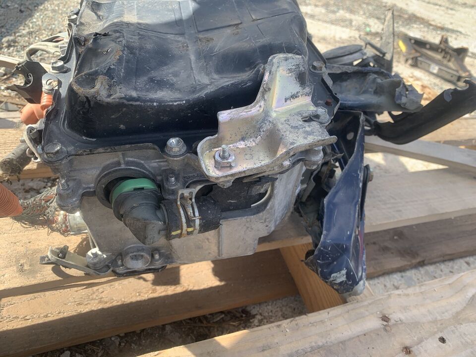

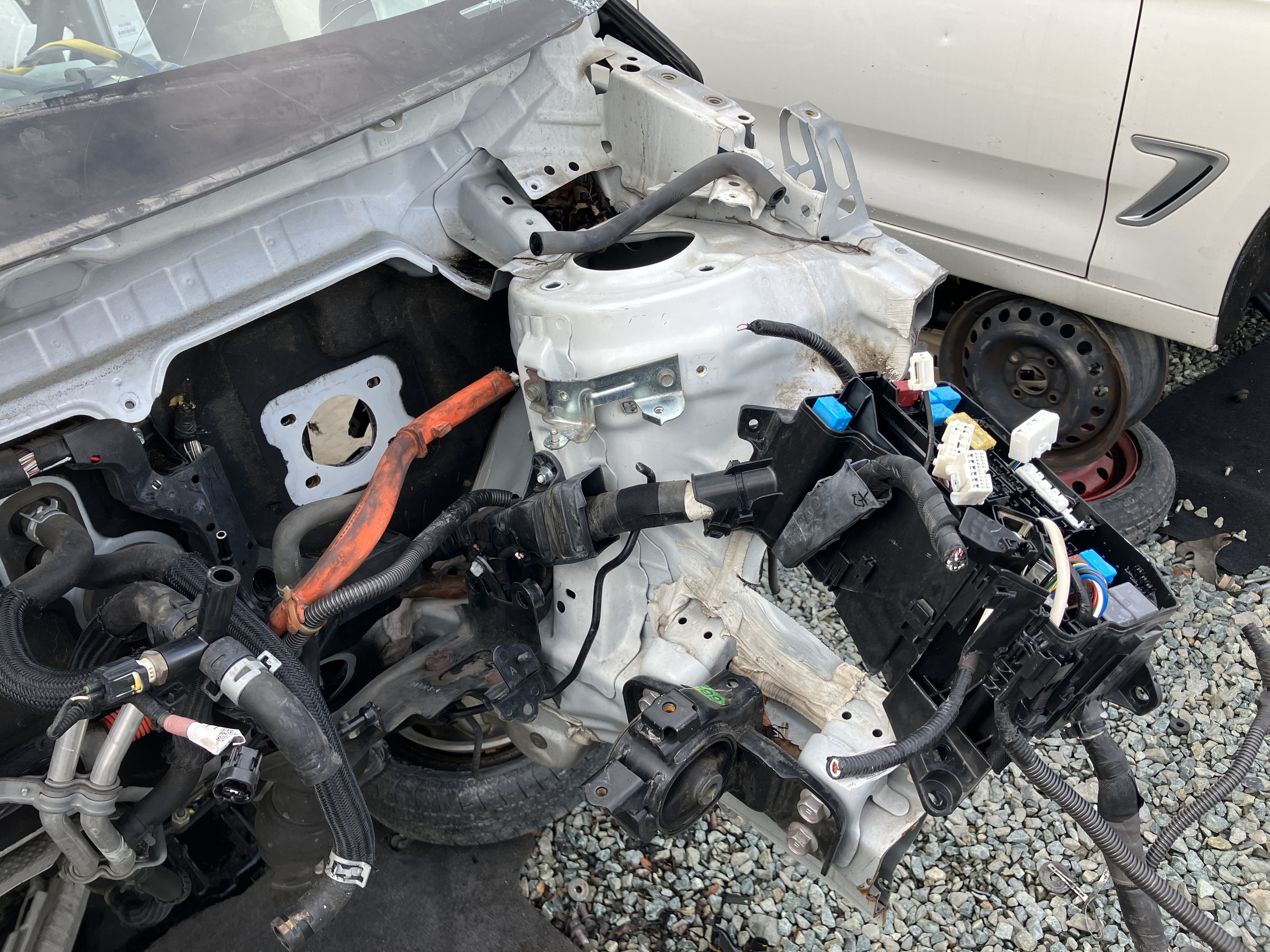

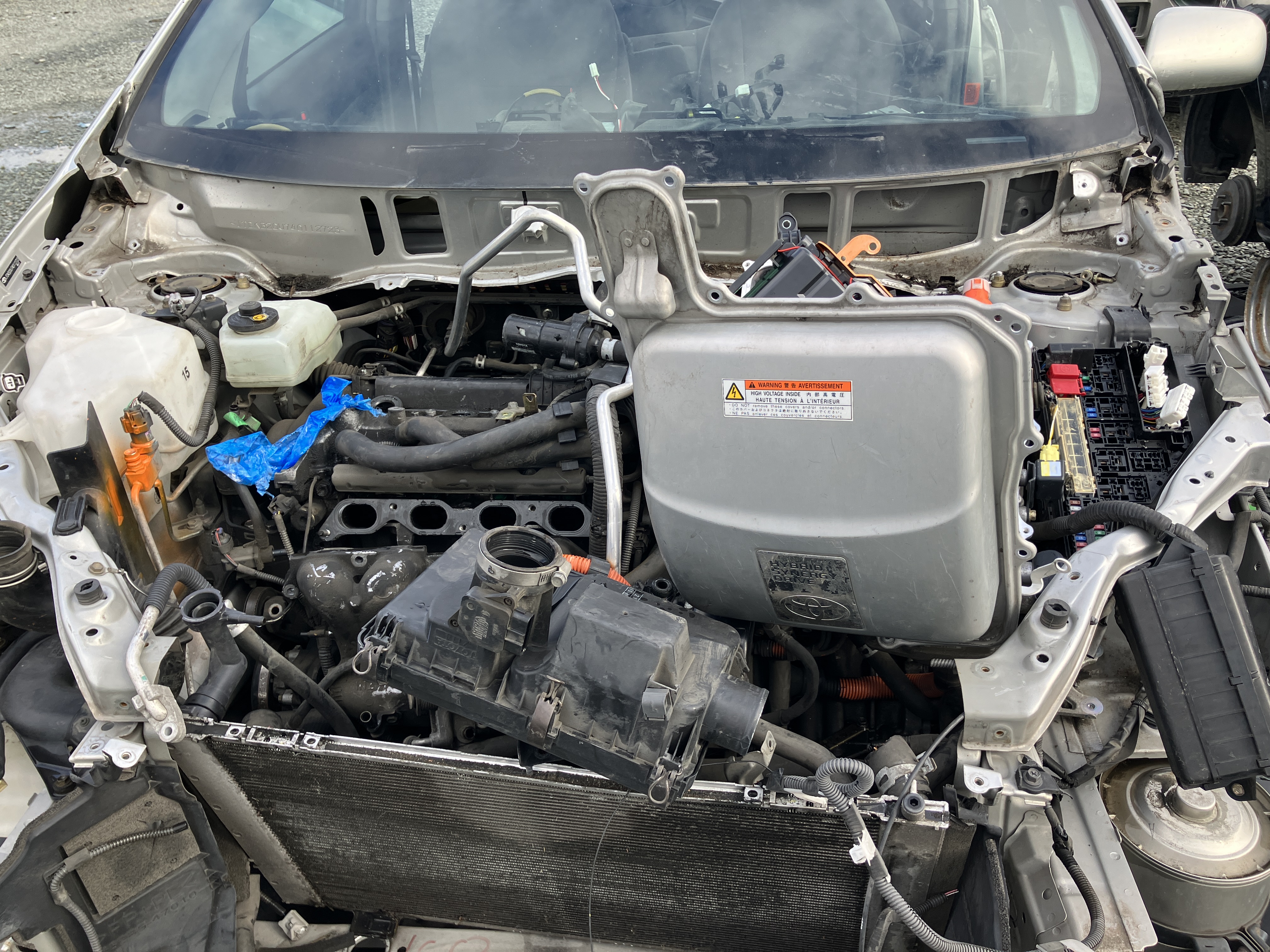

my OCD made me rehome the Inverter back in it's stock location
this is what the nest looked like under the Inverter, note more cut high voltage orange cables, or the other ends of them this made The Greg sad

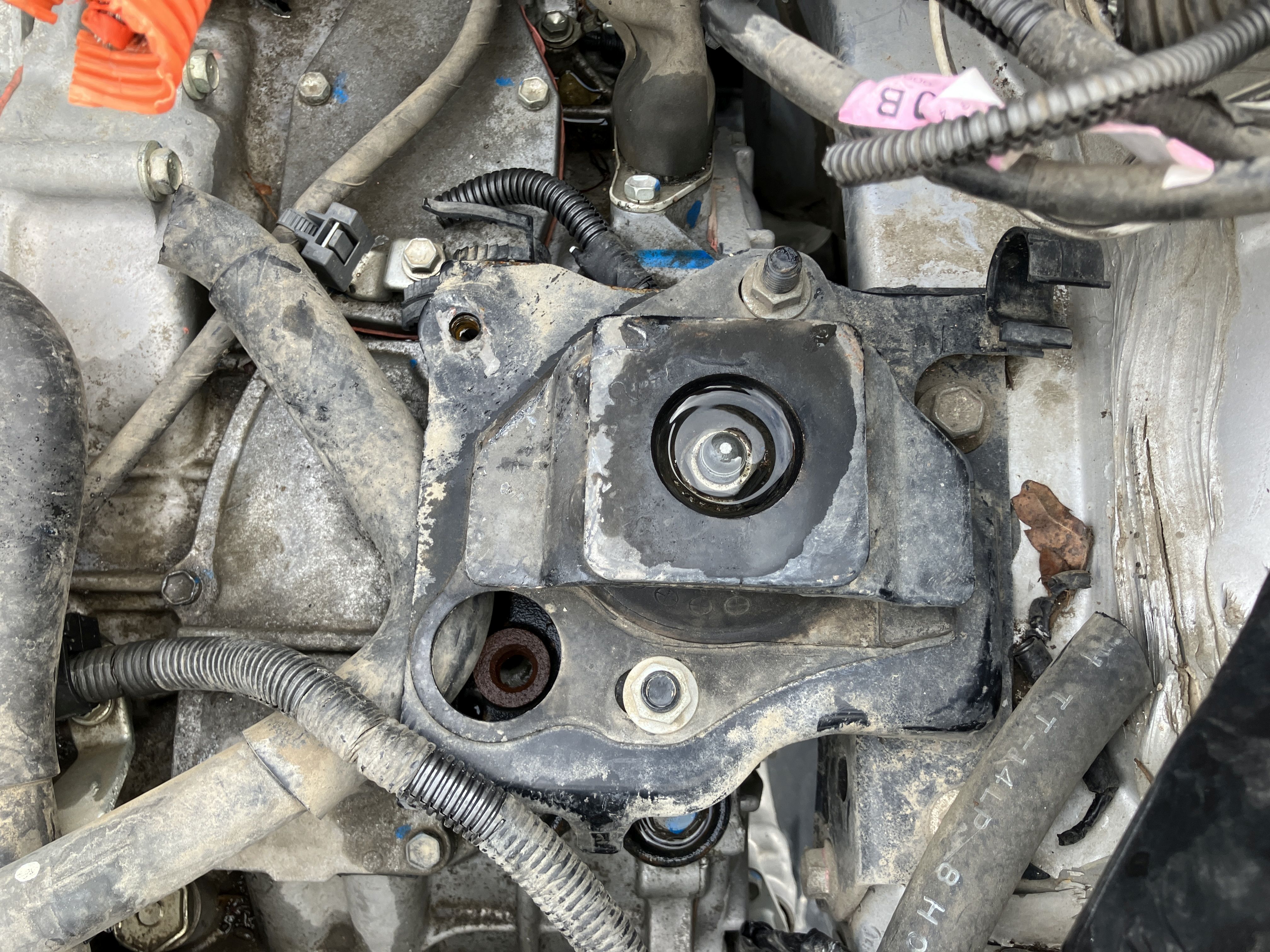

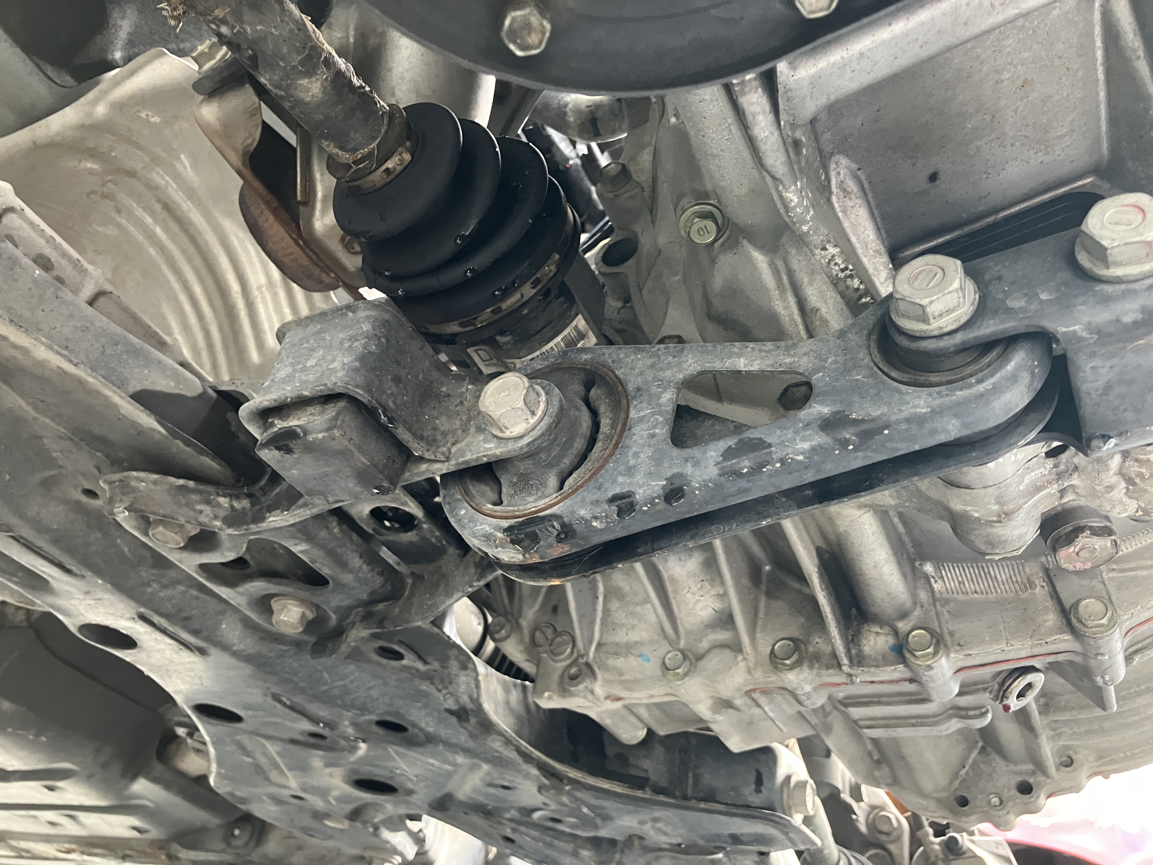

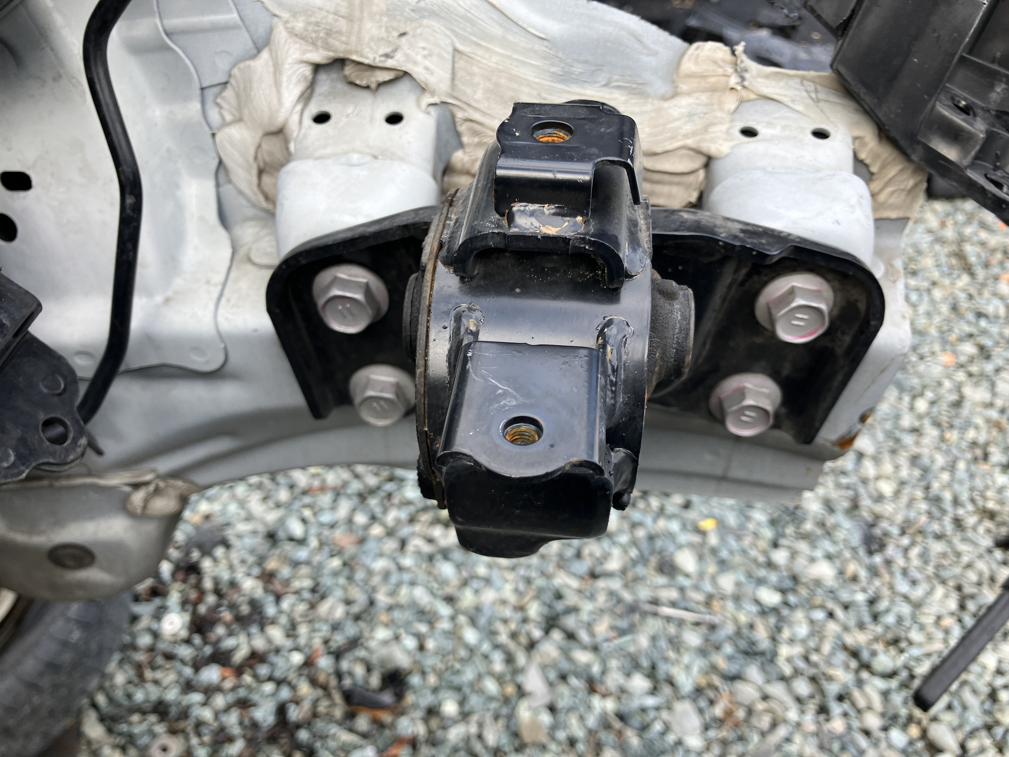

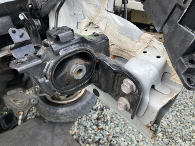

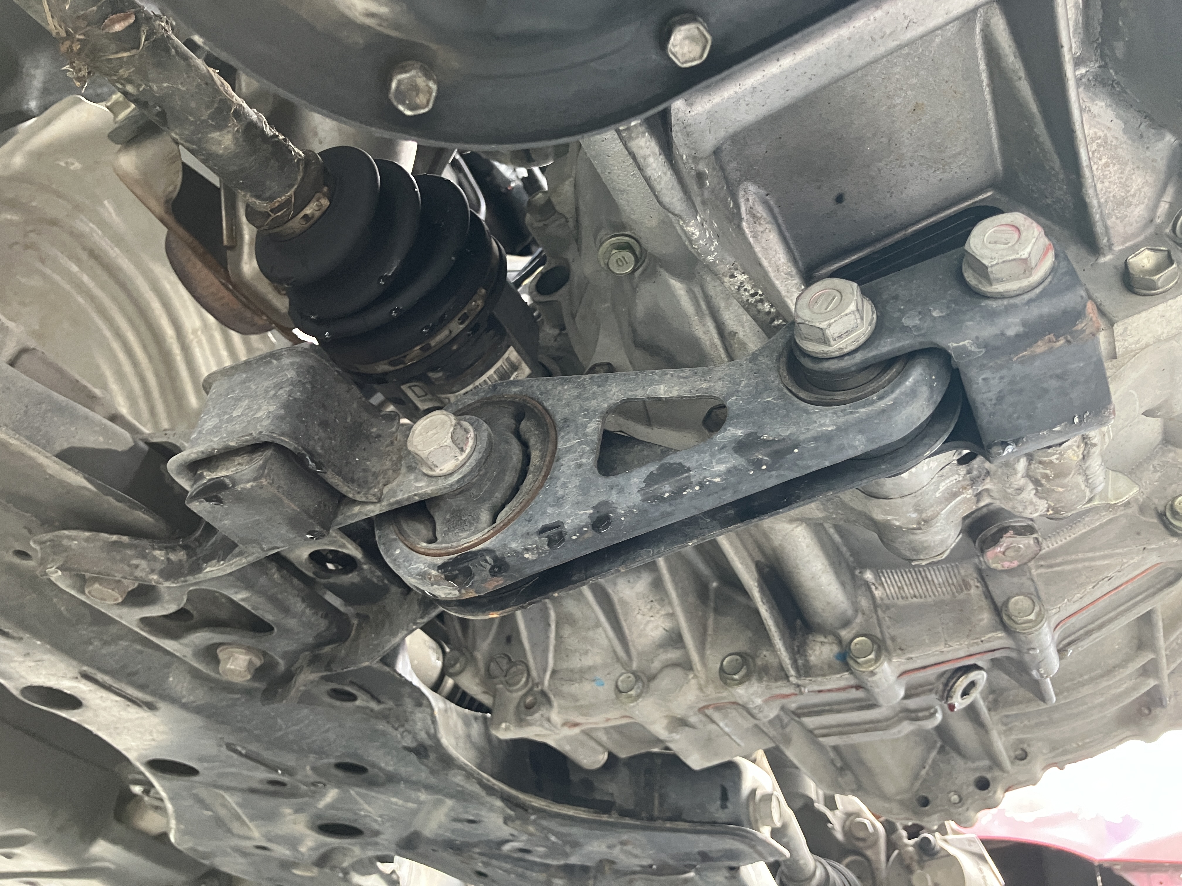

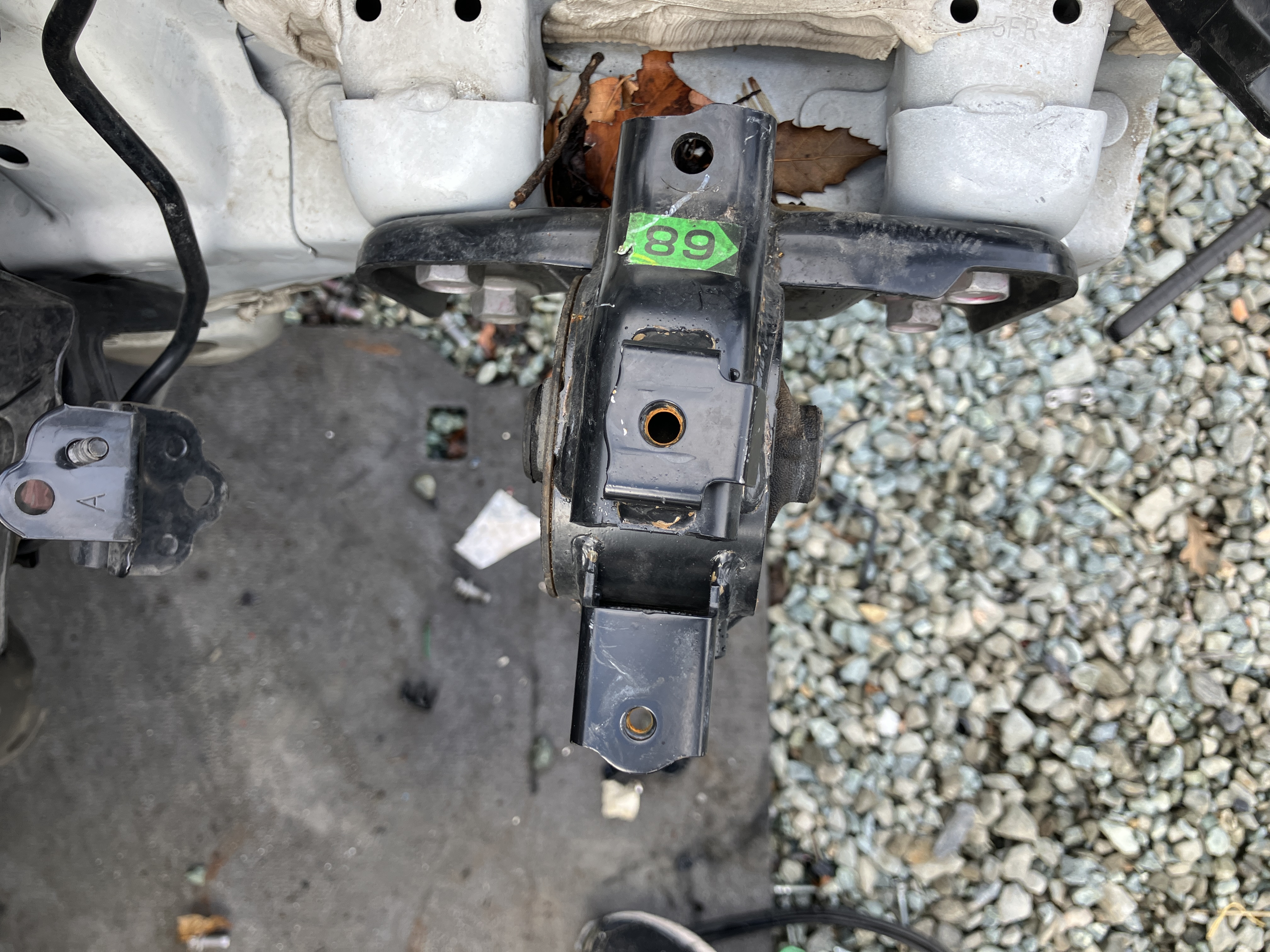

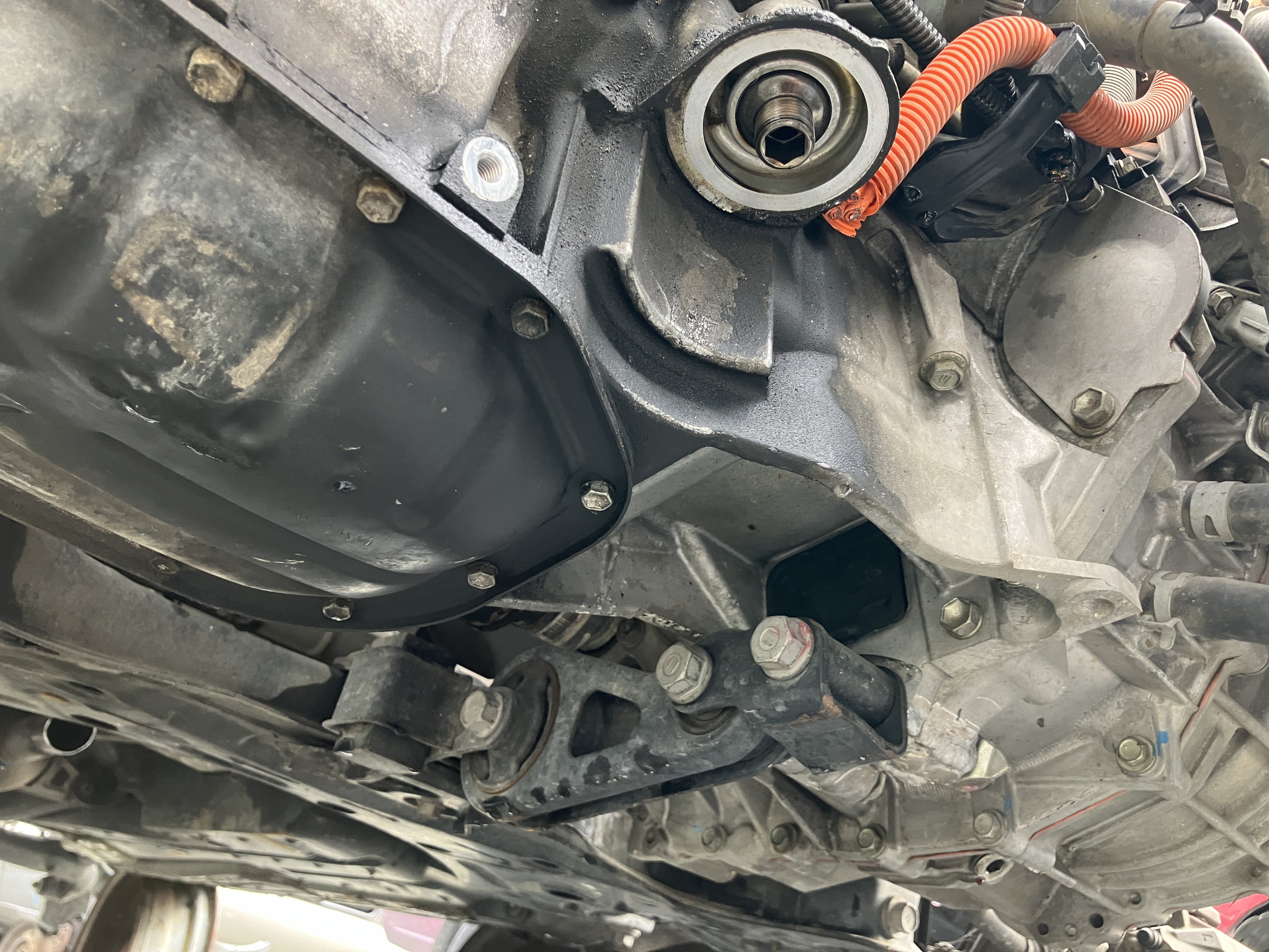

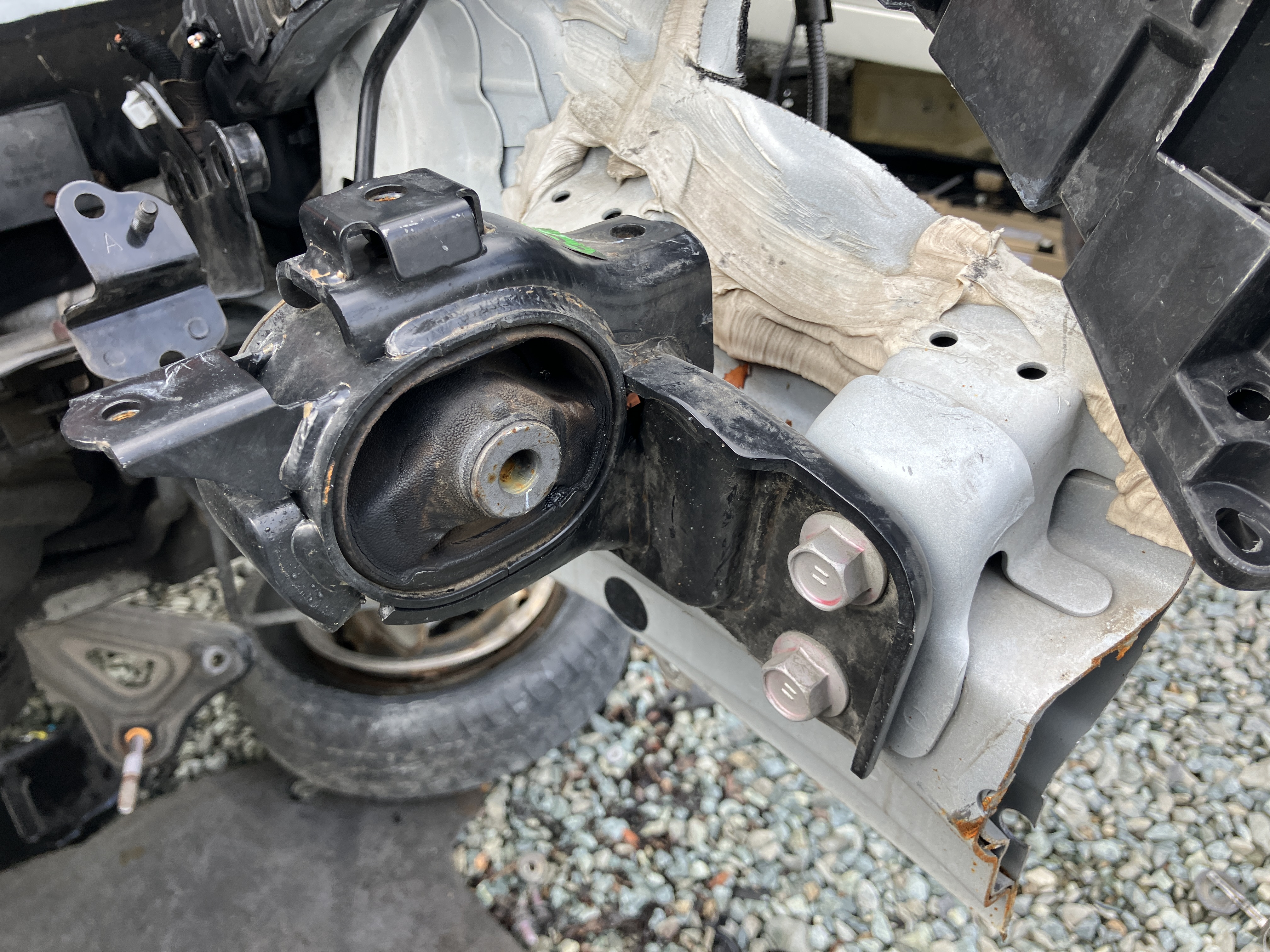

since we called ahead and had them strip the entire front clip off for us [joking] I thought this would be a good opportunity for a little Glamour Motor Mount Photo Shoot, GMMPS for any of us interested in a Prius power plant transplant utilizing stock motor mounts Johannes style
Top Motor Mount
Not Top Motor Mount

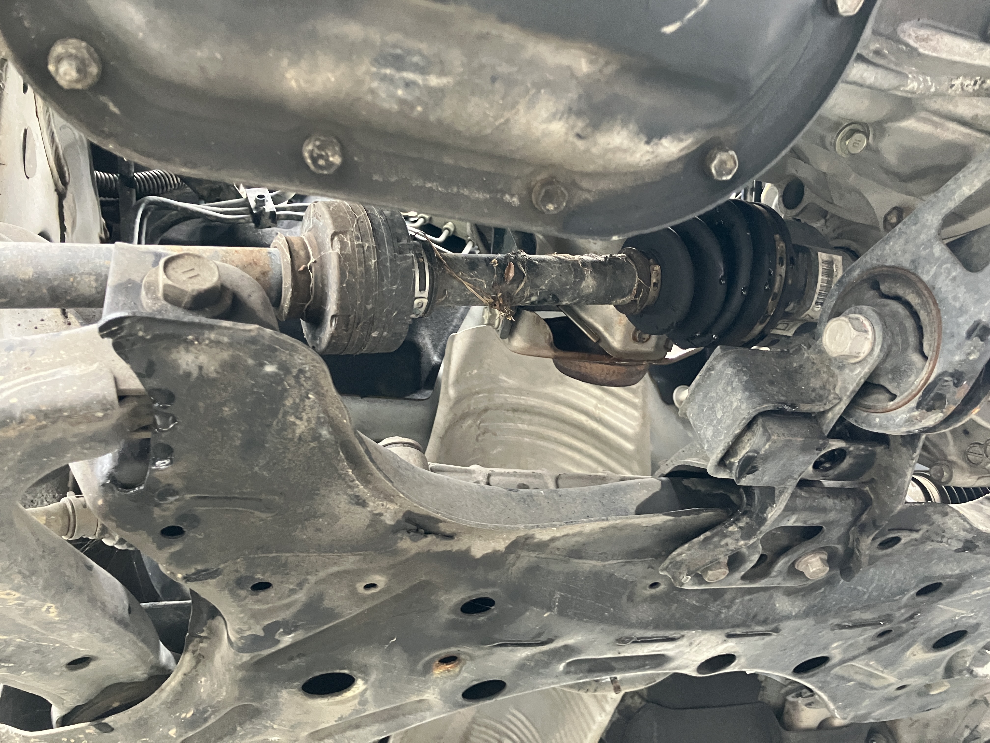

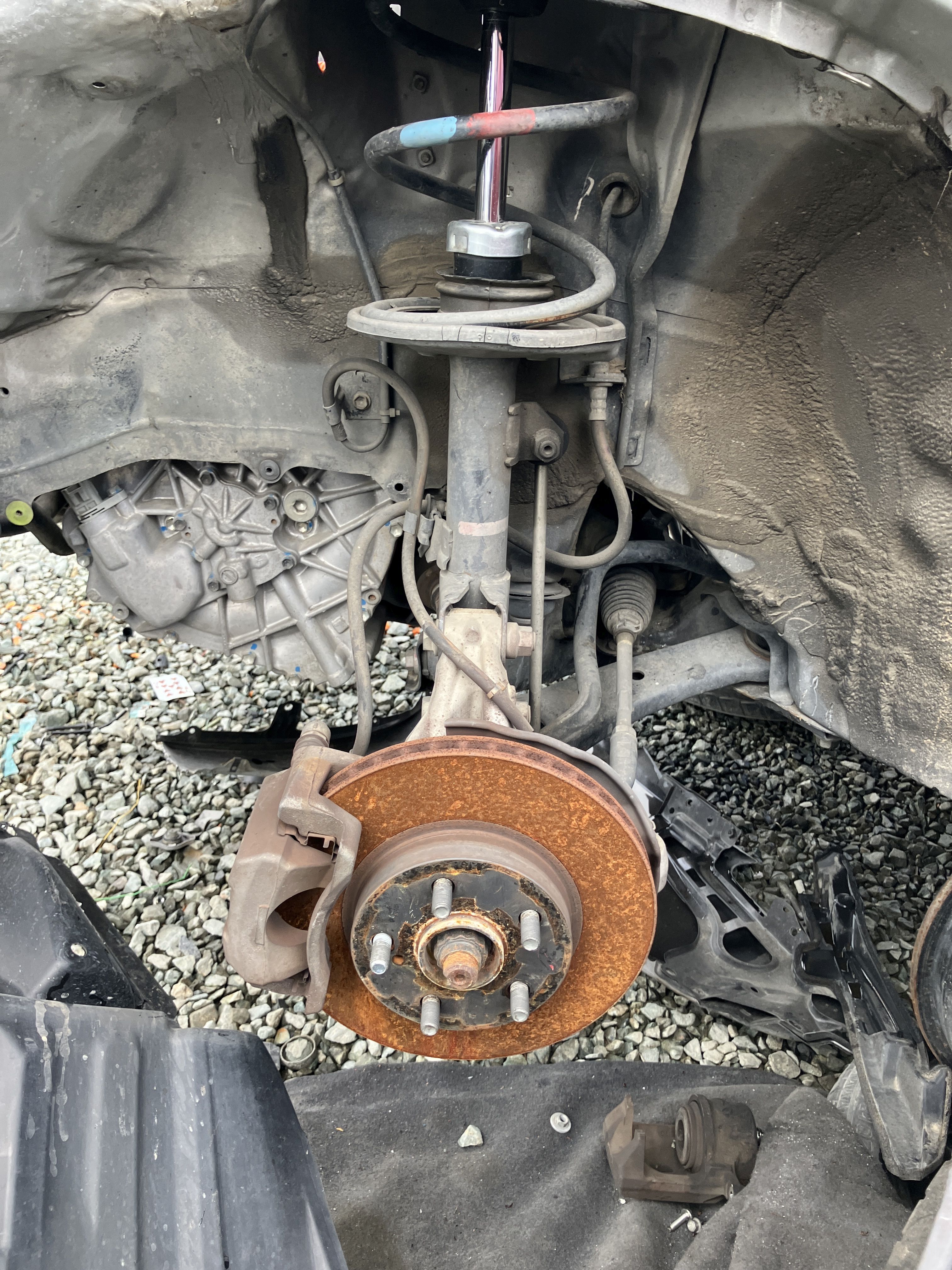

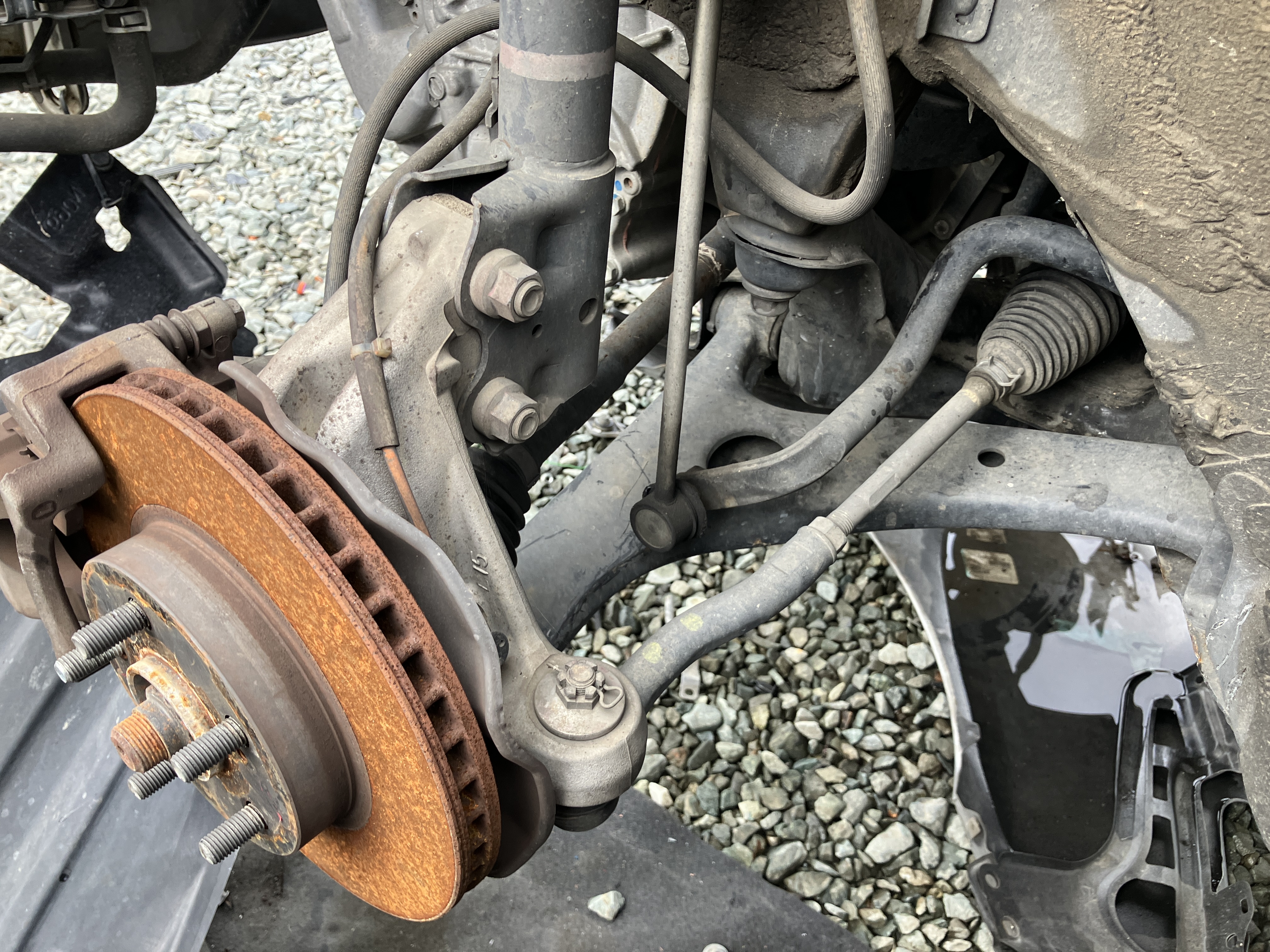

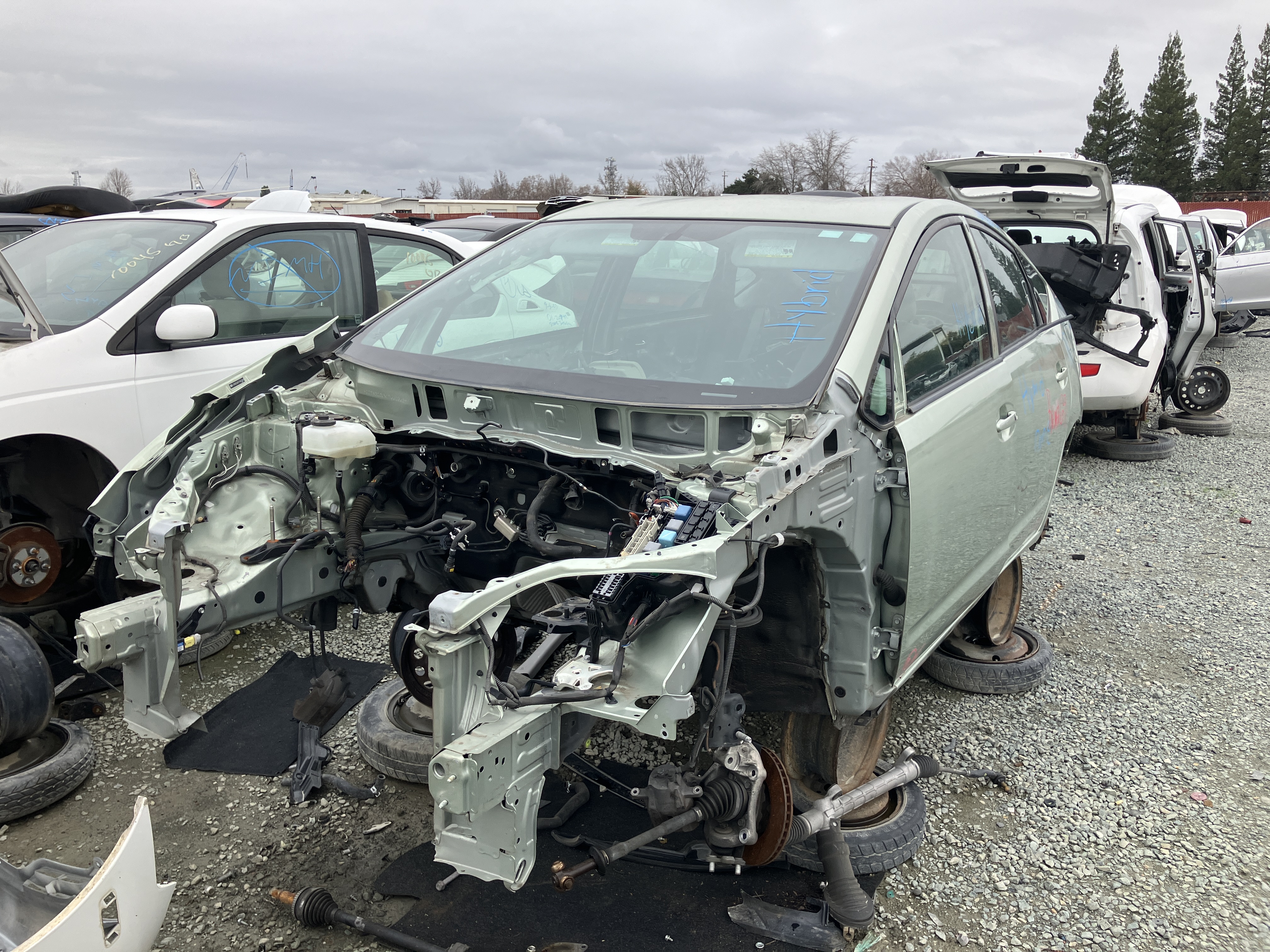

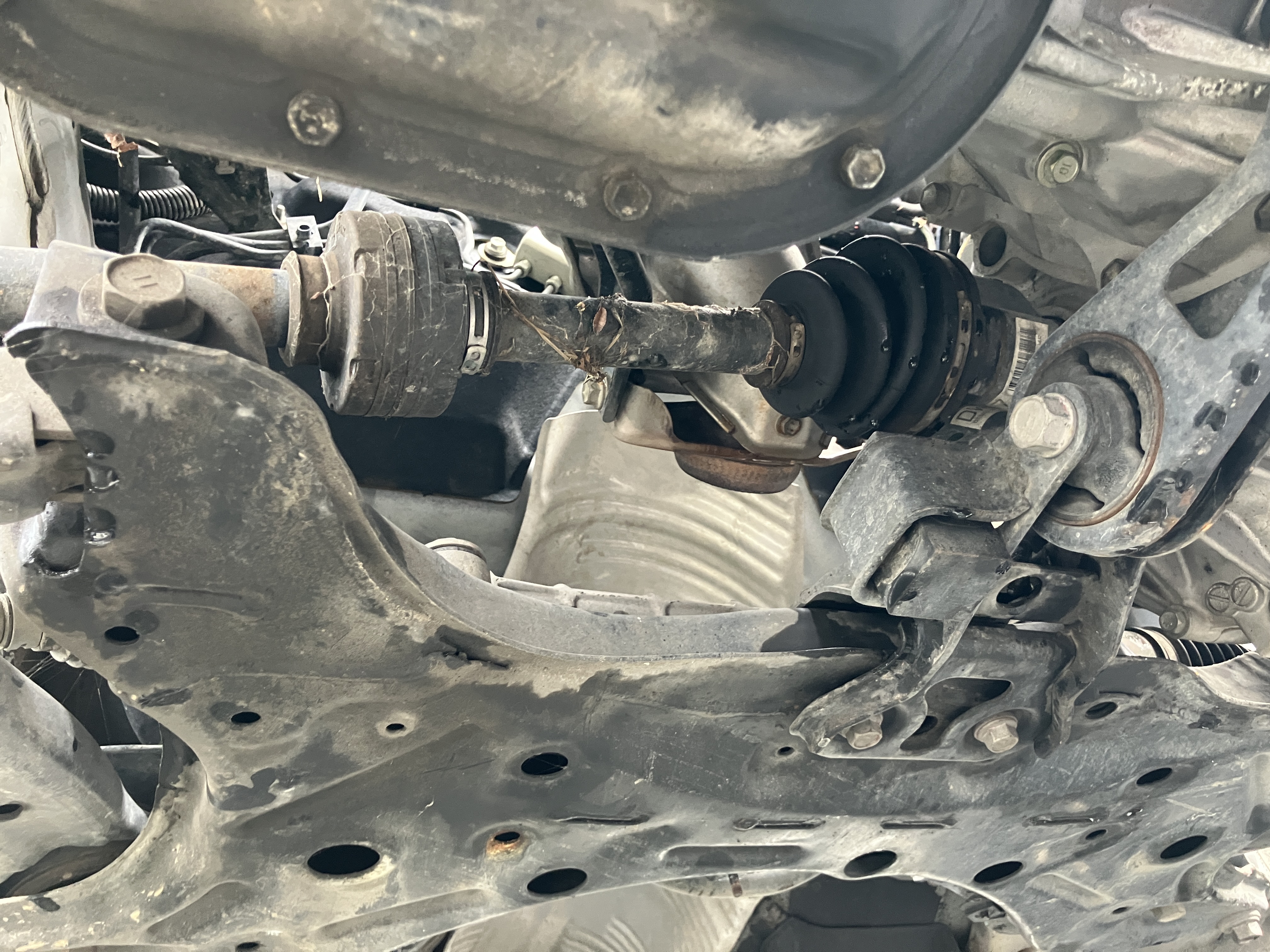

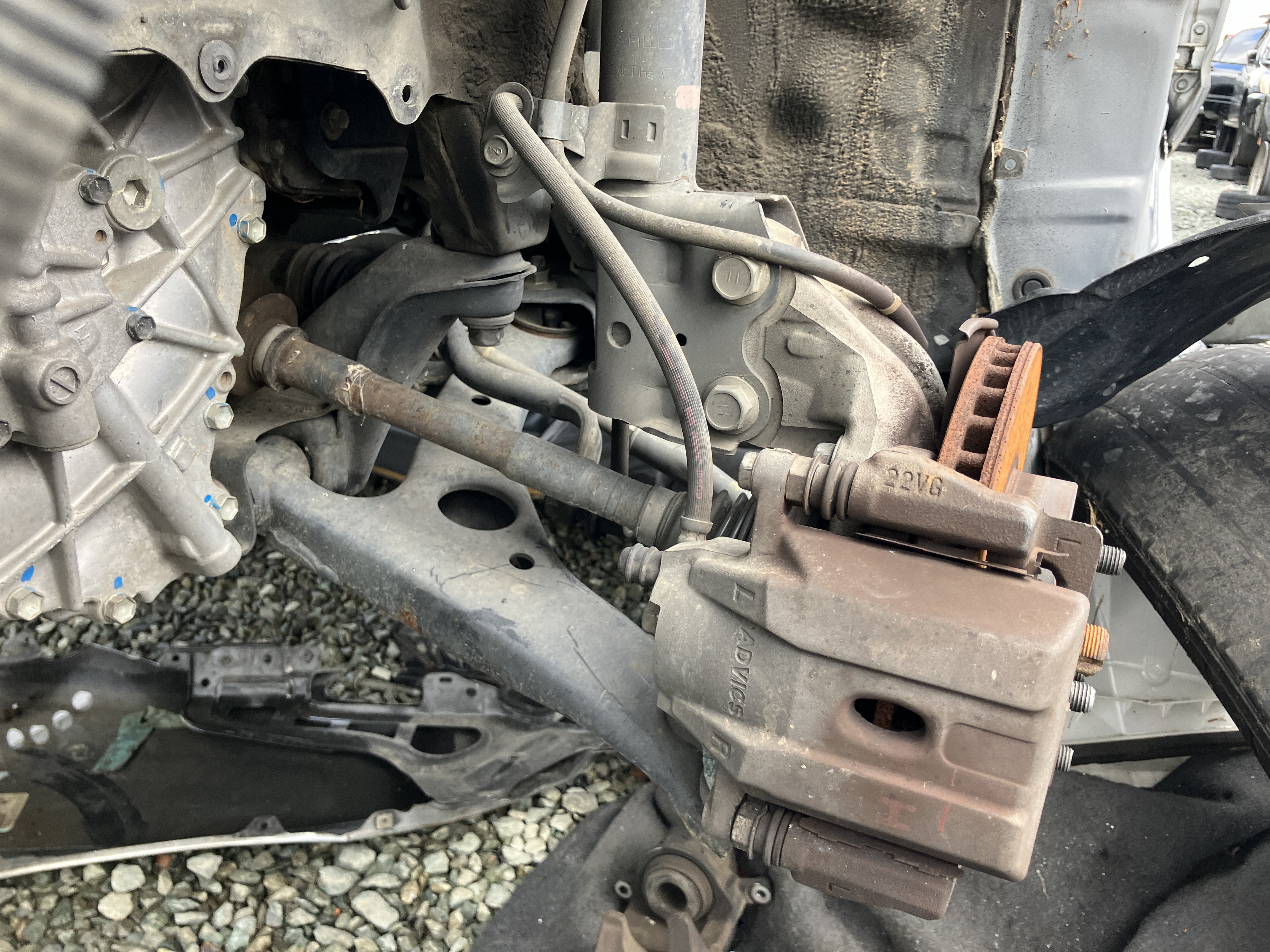

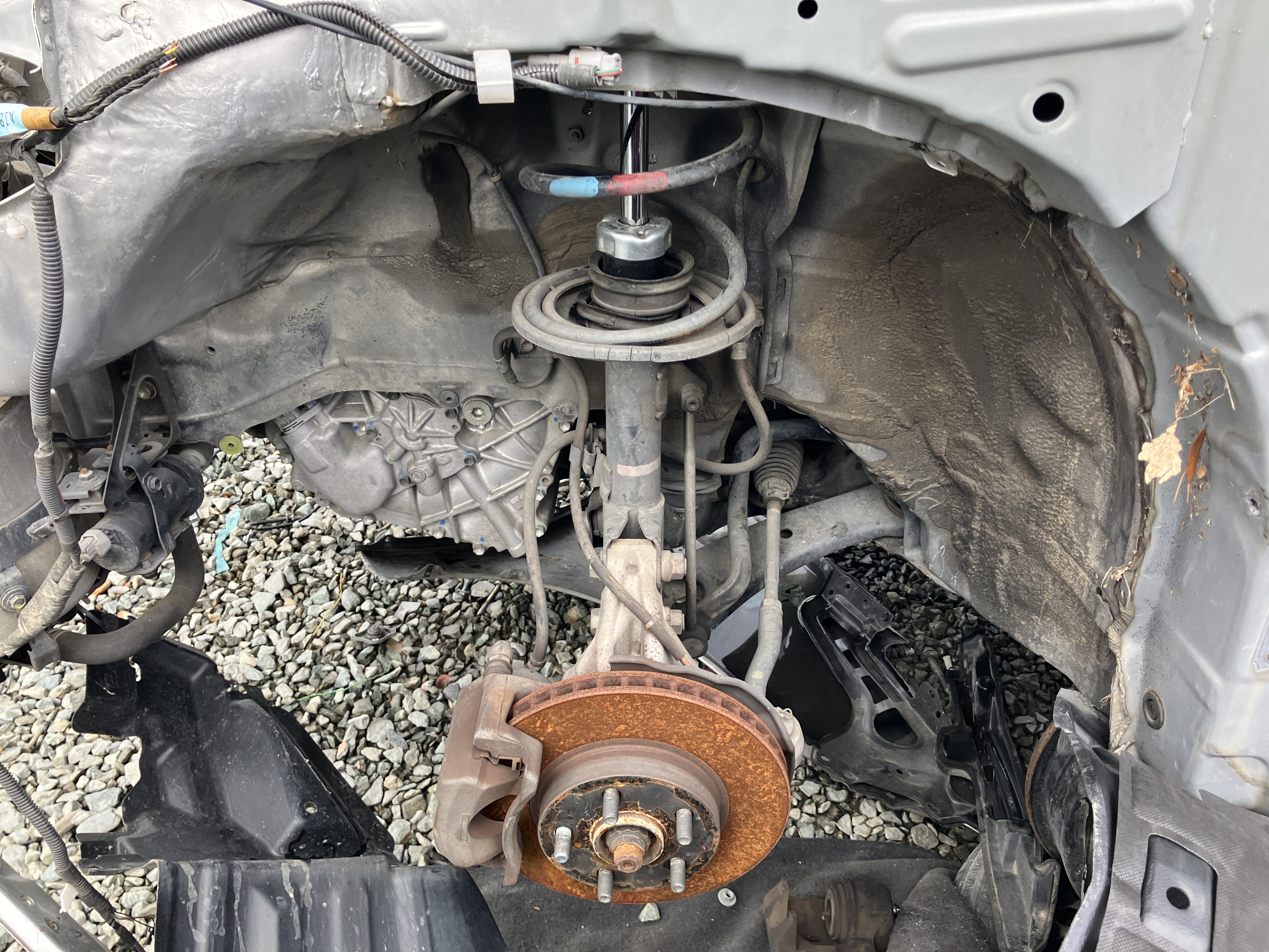

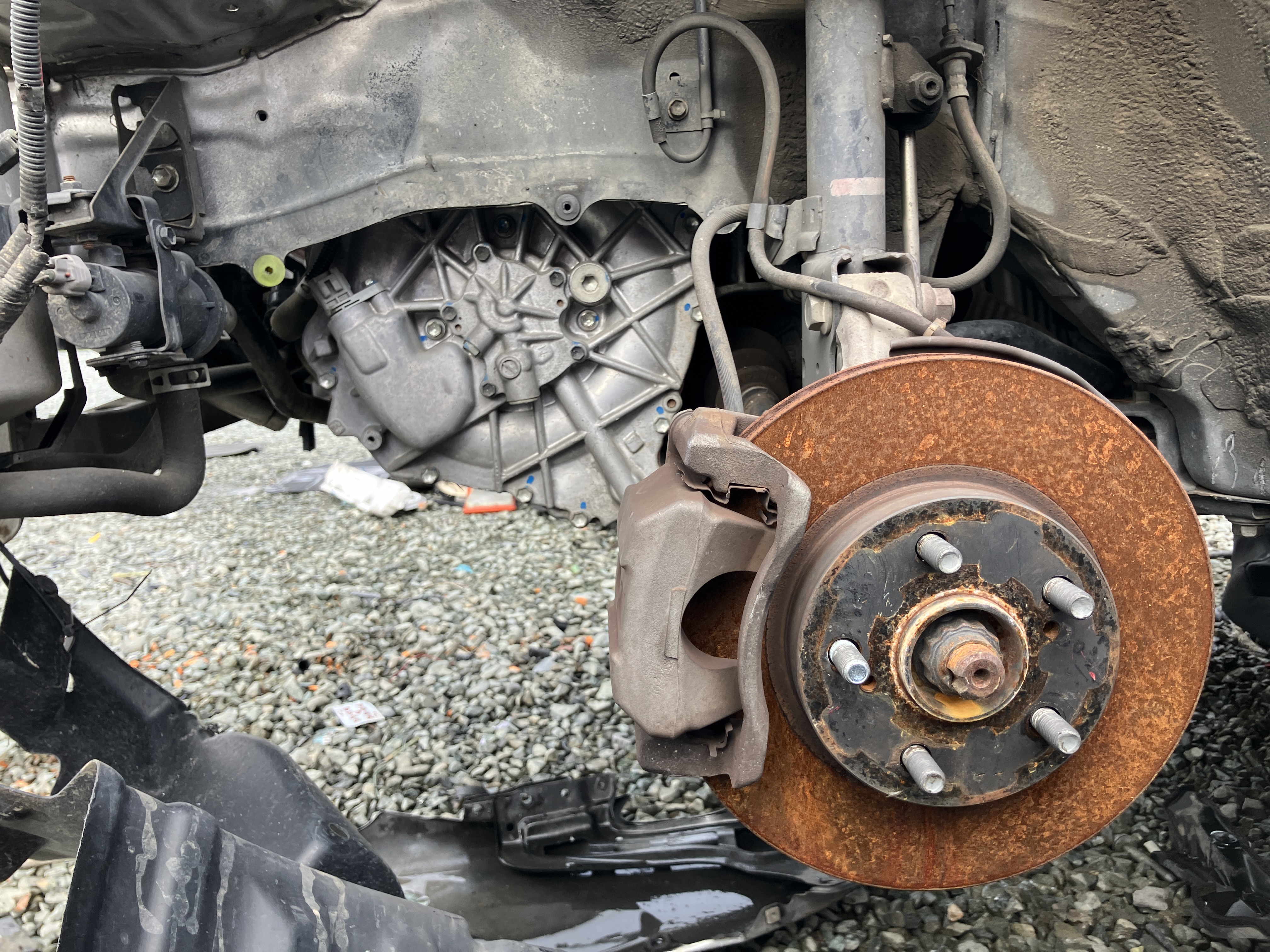

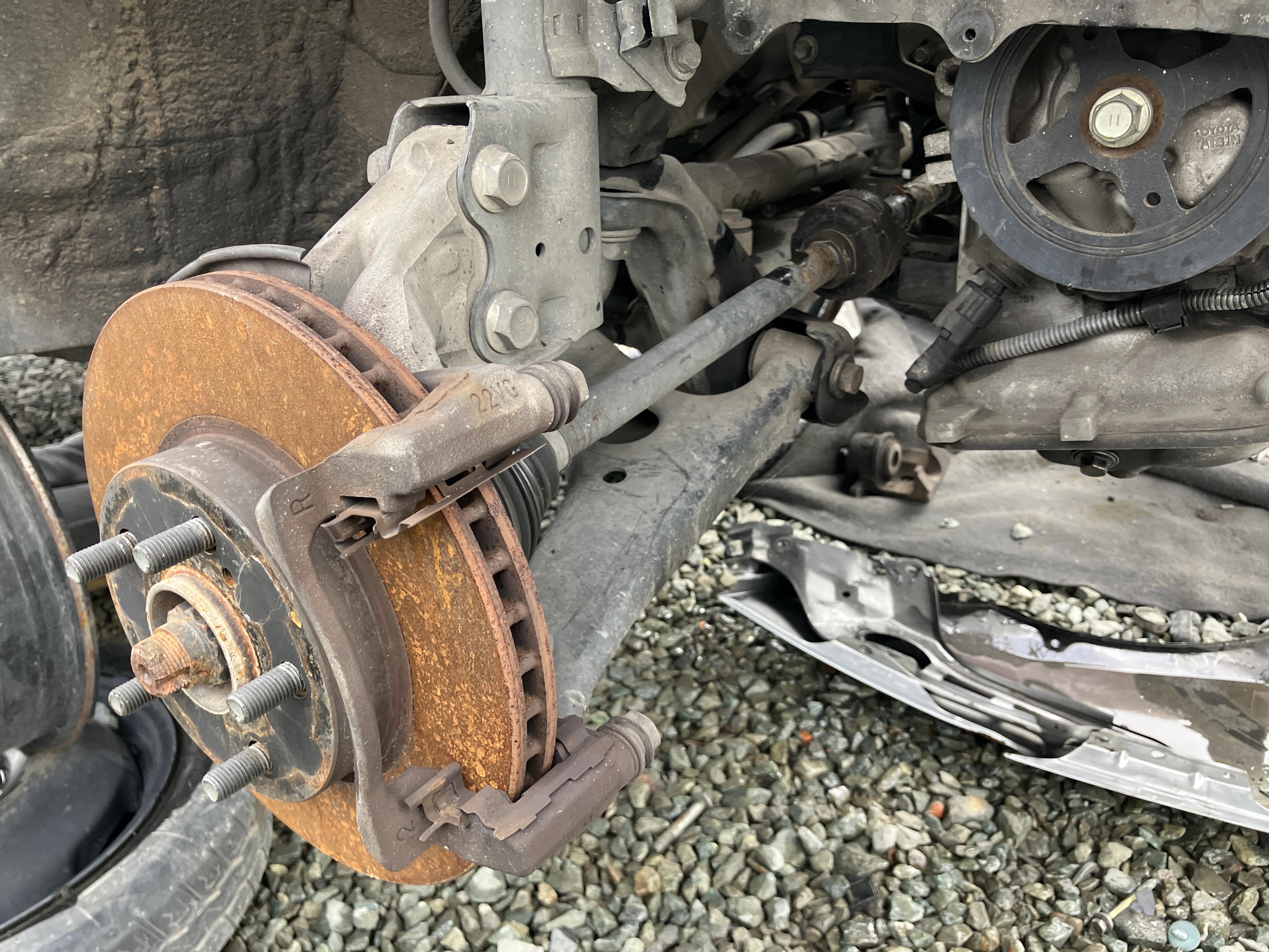

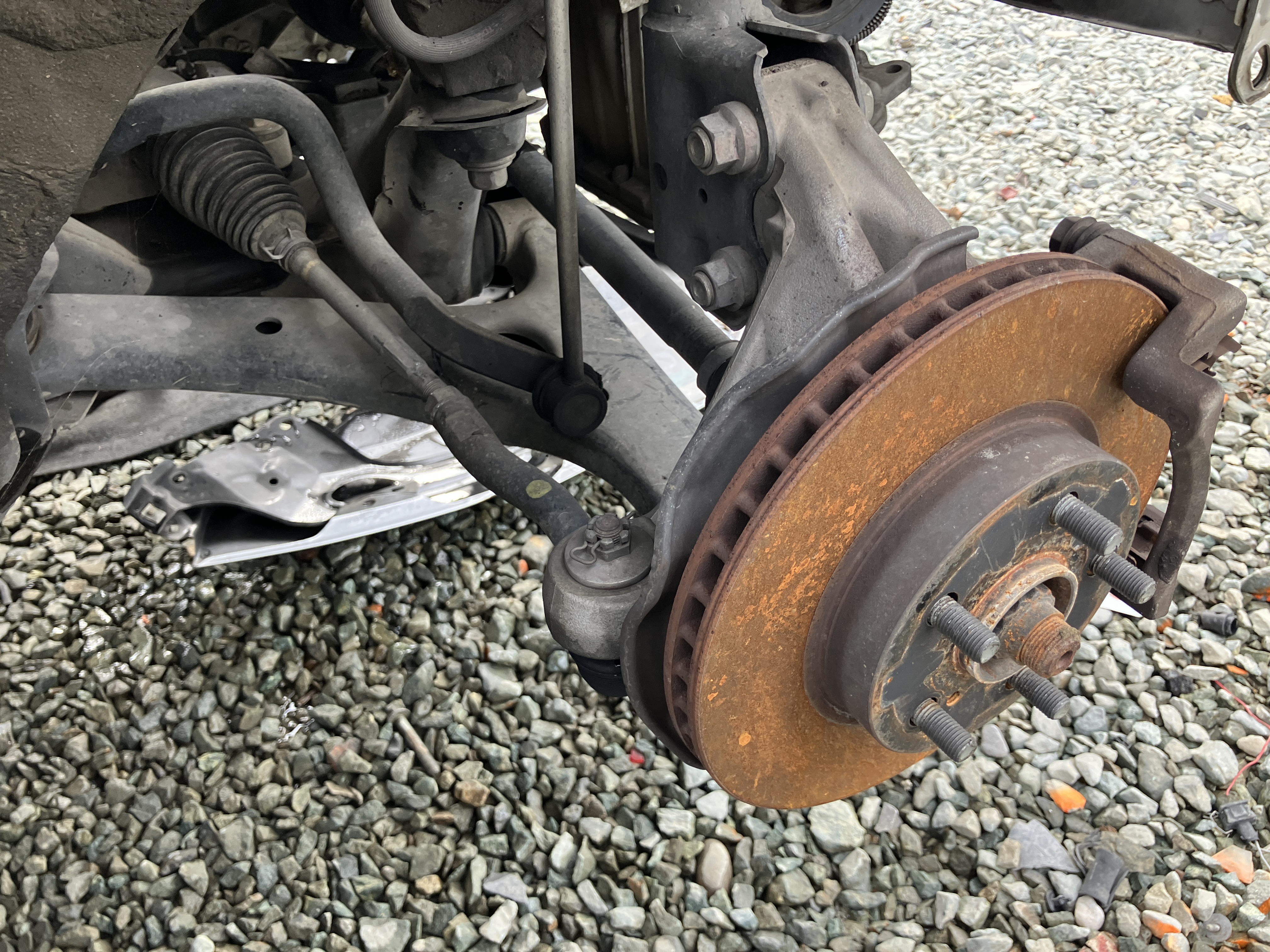

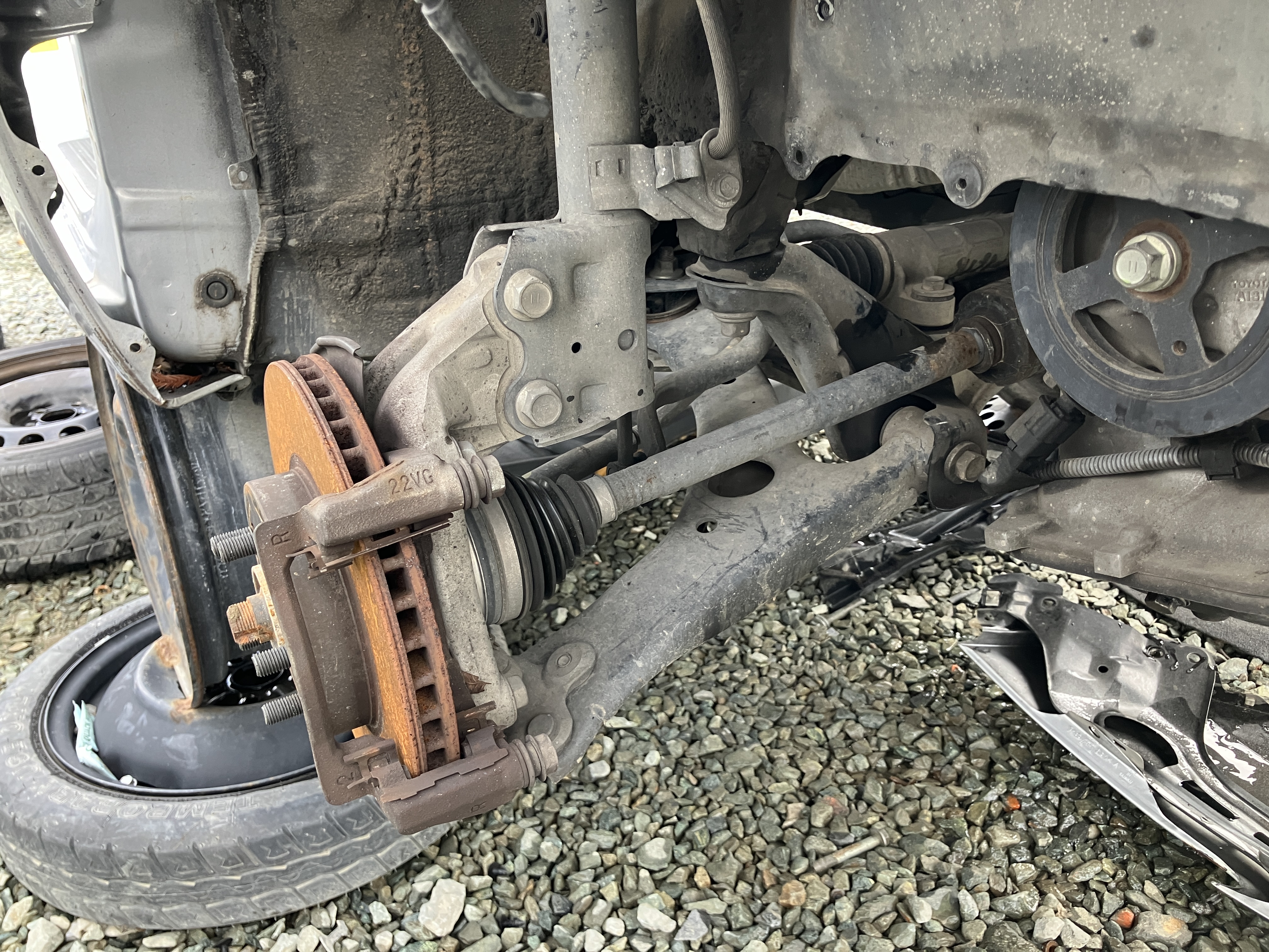

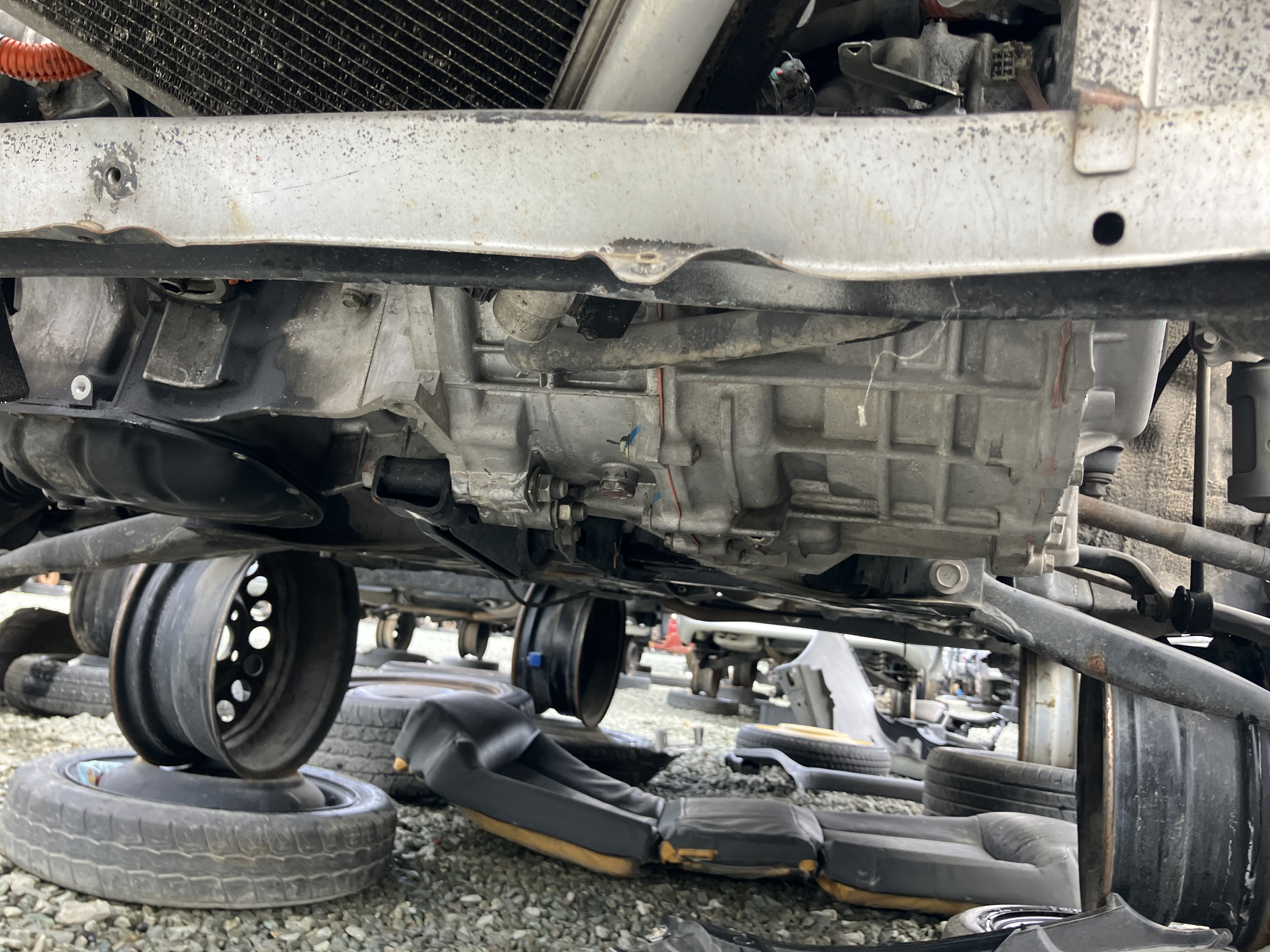

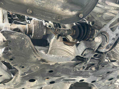

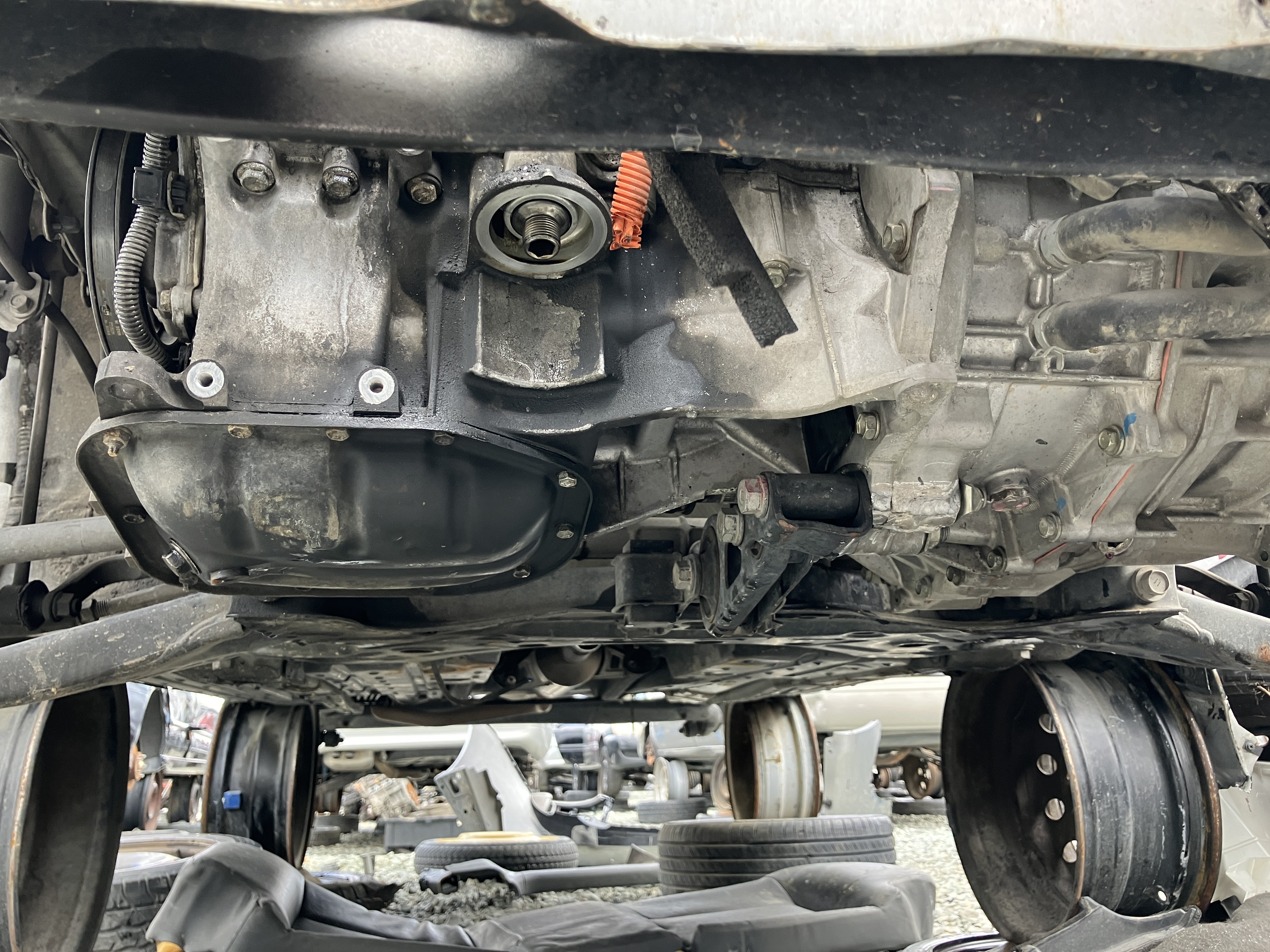

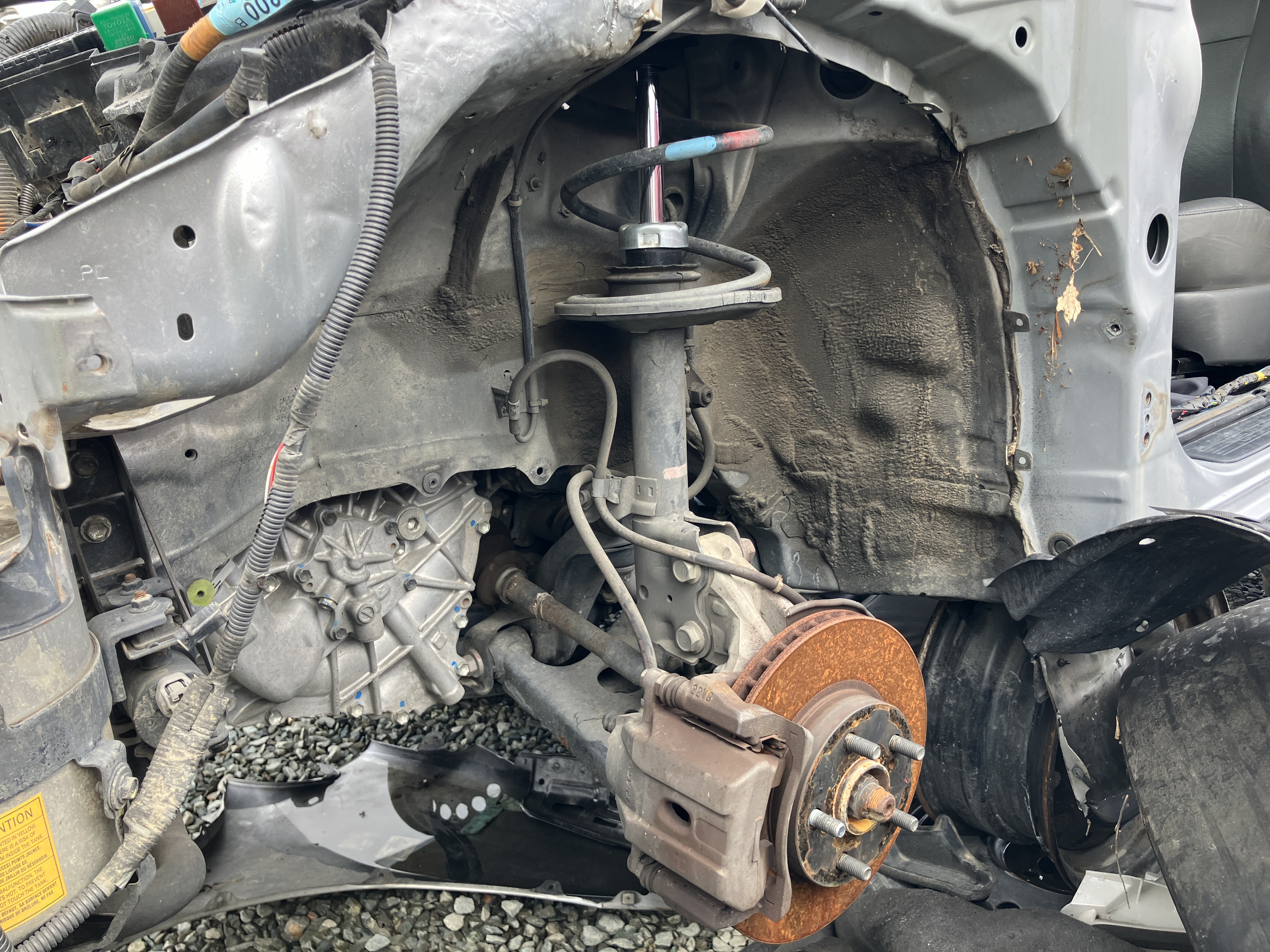

this being a front wheel drive car (something as a self proclaimed Muscle Car Guy, MCG I must snub my nose at) I decided to document it's arithmetic
note the CV axles run in front of the shock towers
US Driver Side this is the electric motor side
US Passenger Side this is the gasoline engine side
Gregski
Posts: 3171
Post by Gregski »

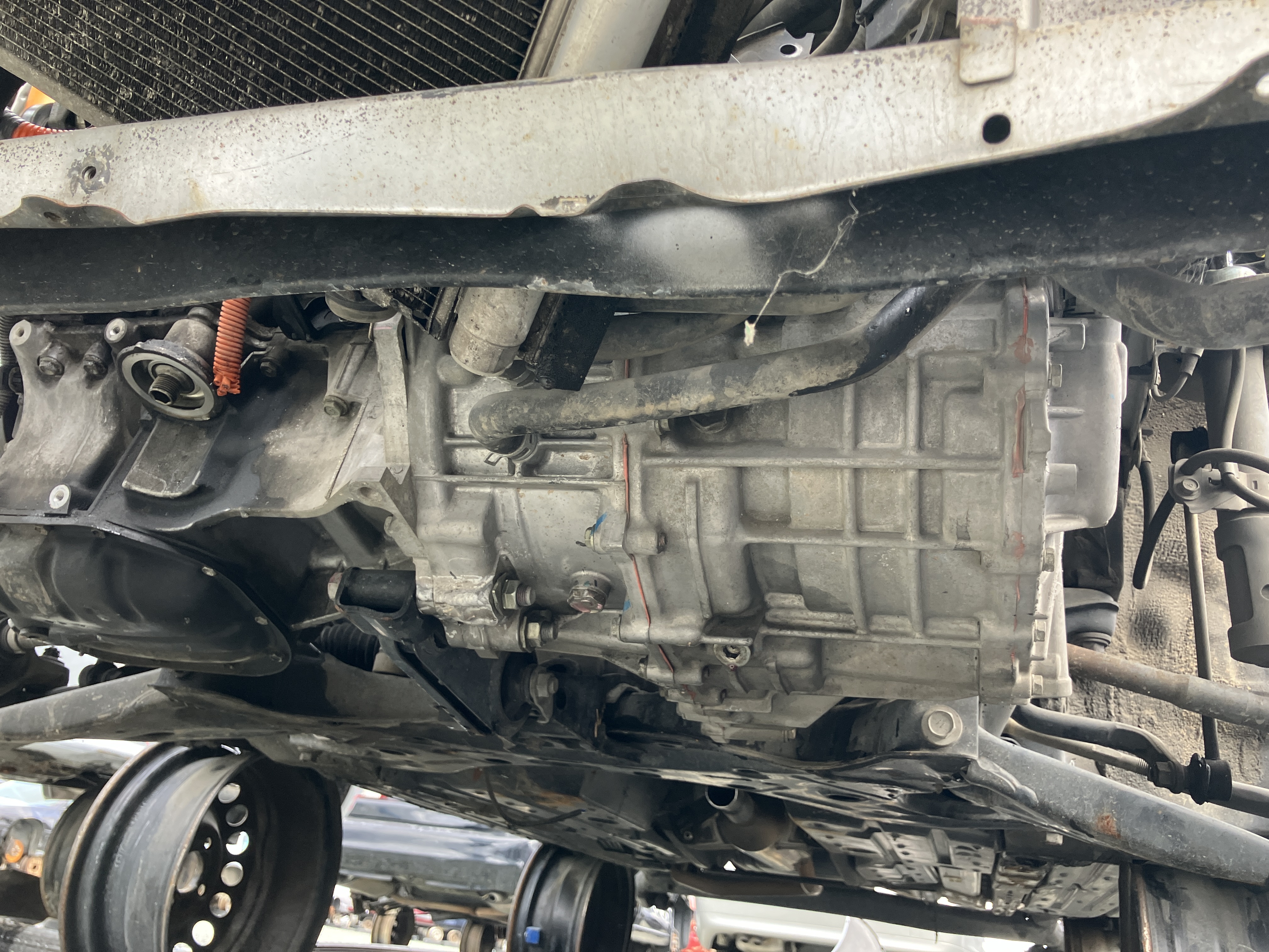

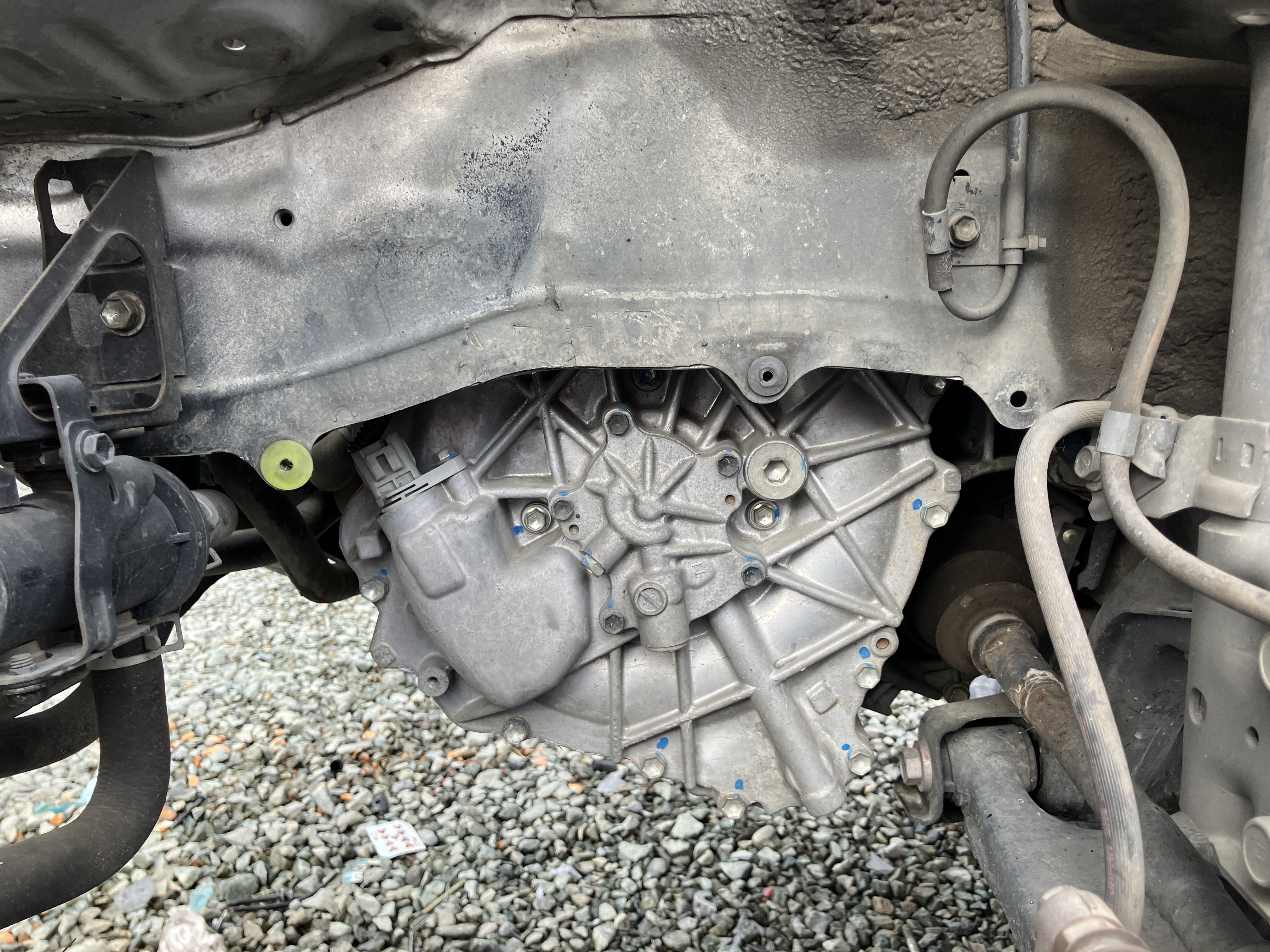

here we can see just how low the motor hangs in it's stock form

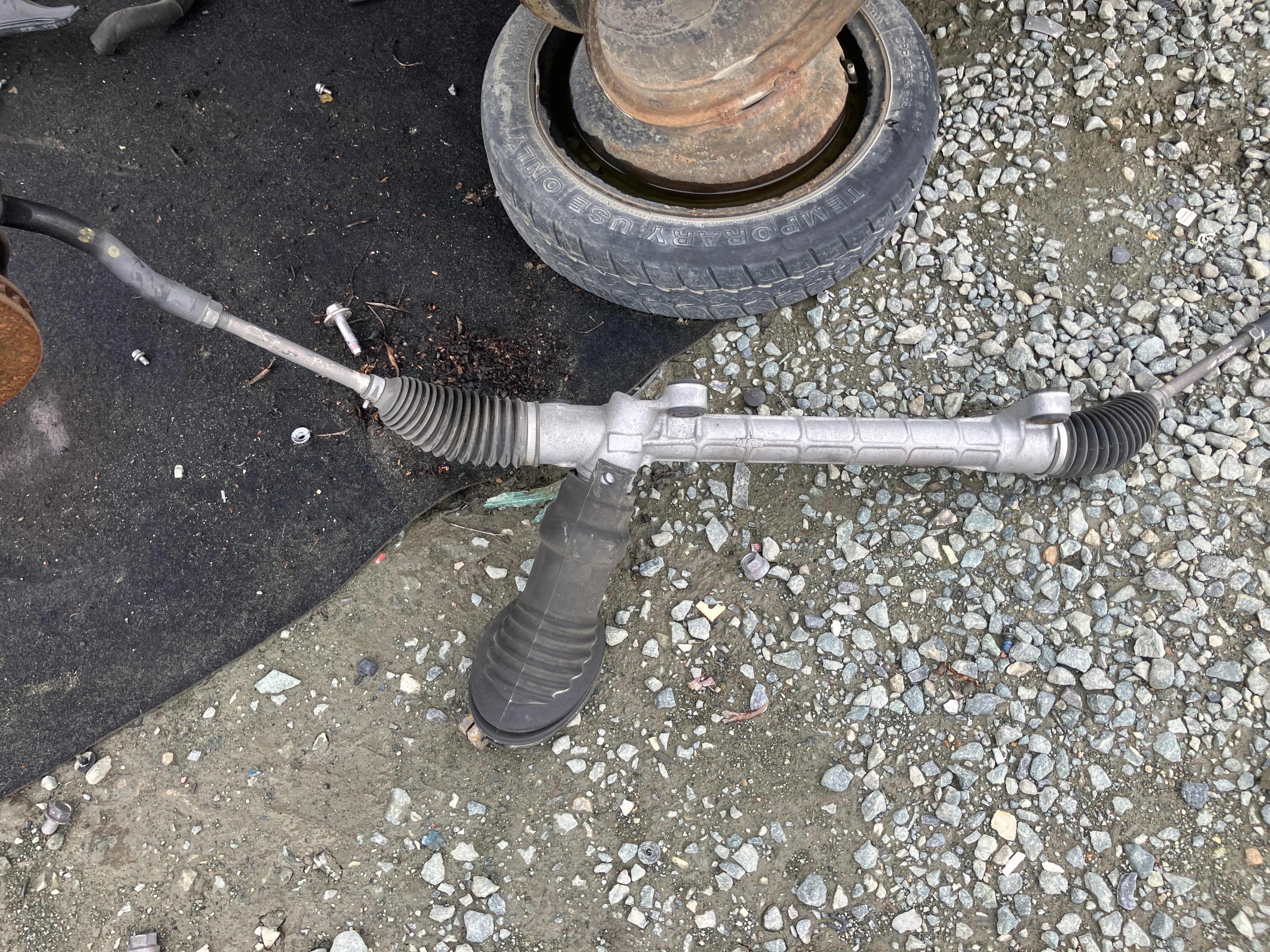

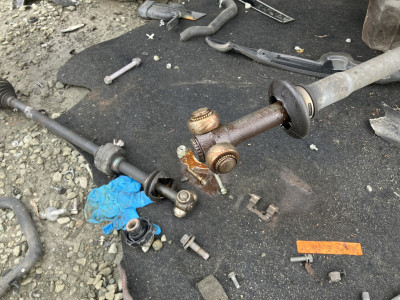

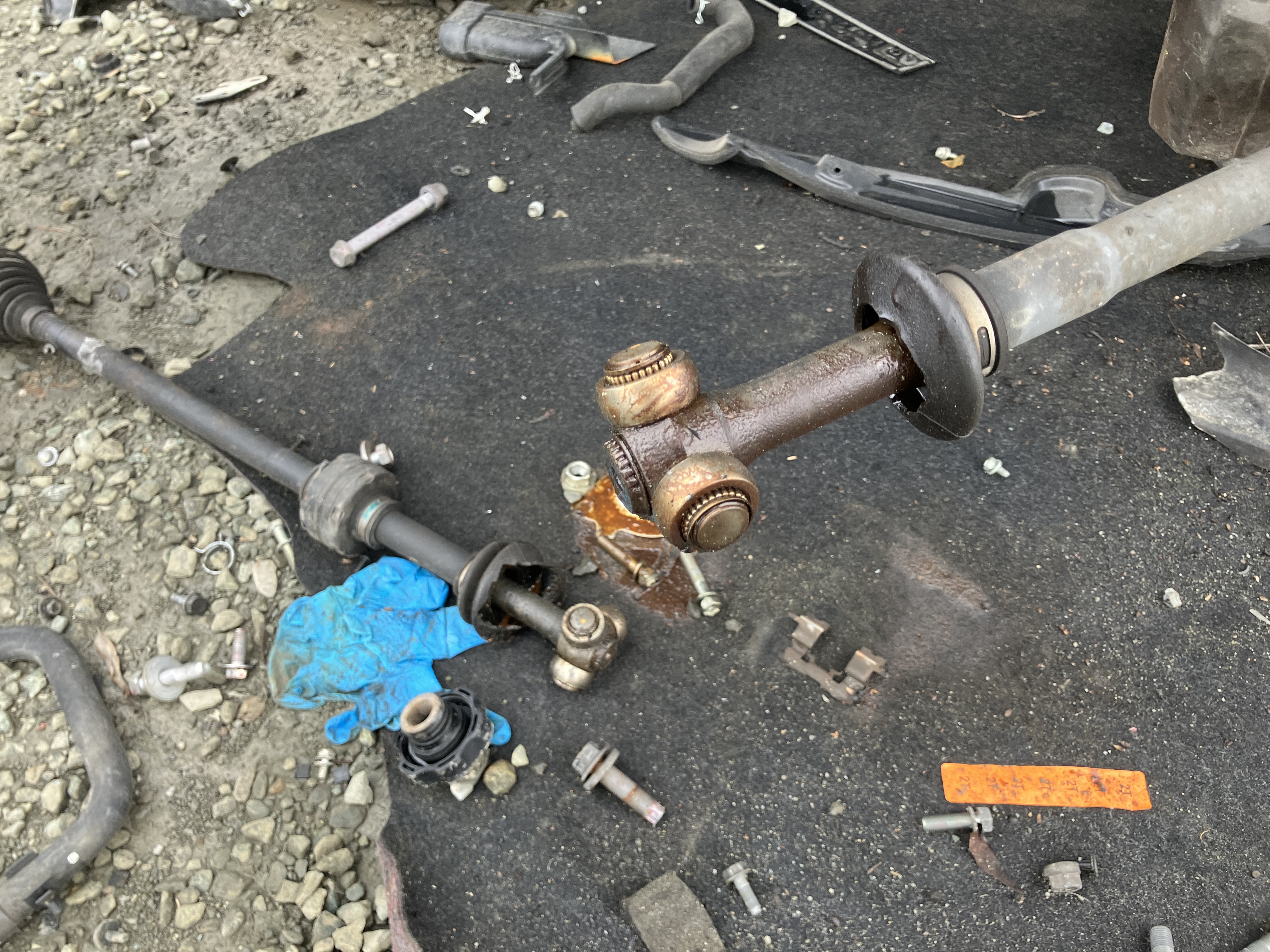

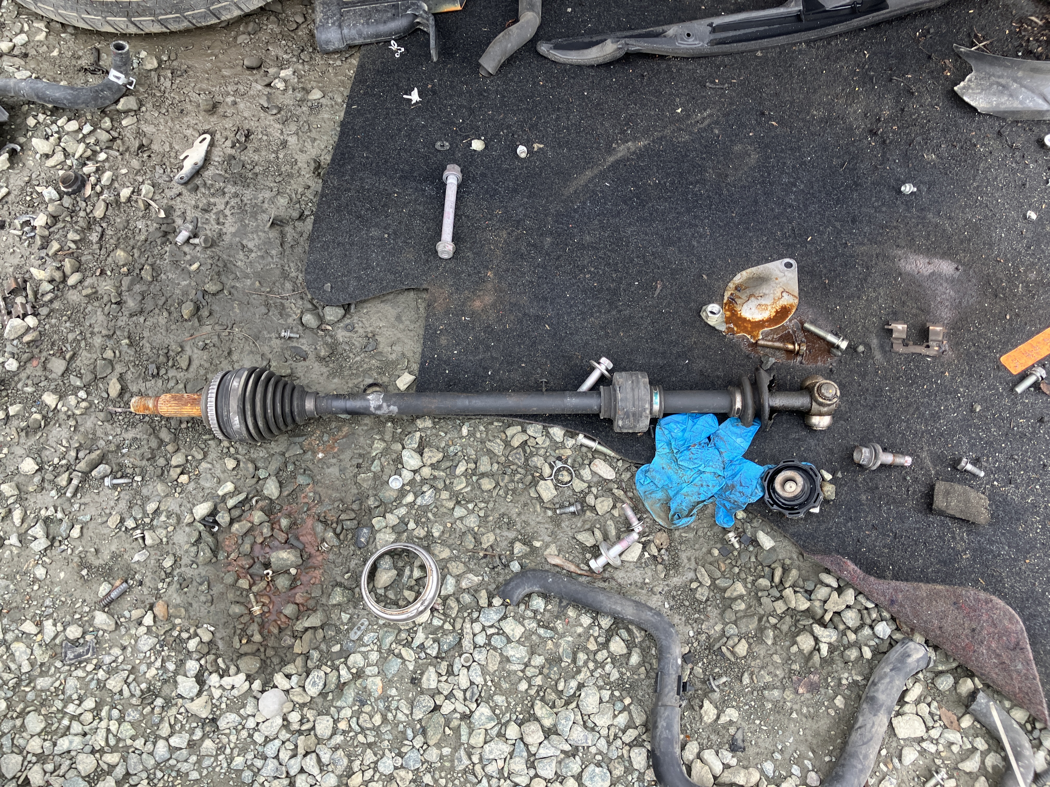

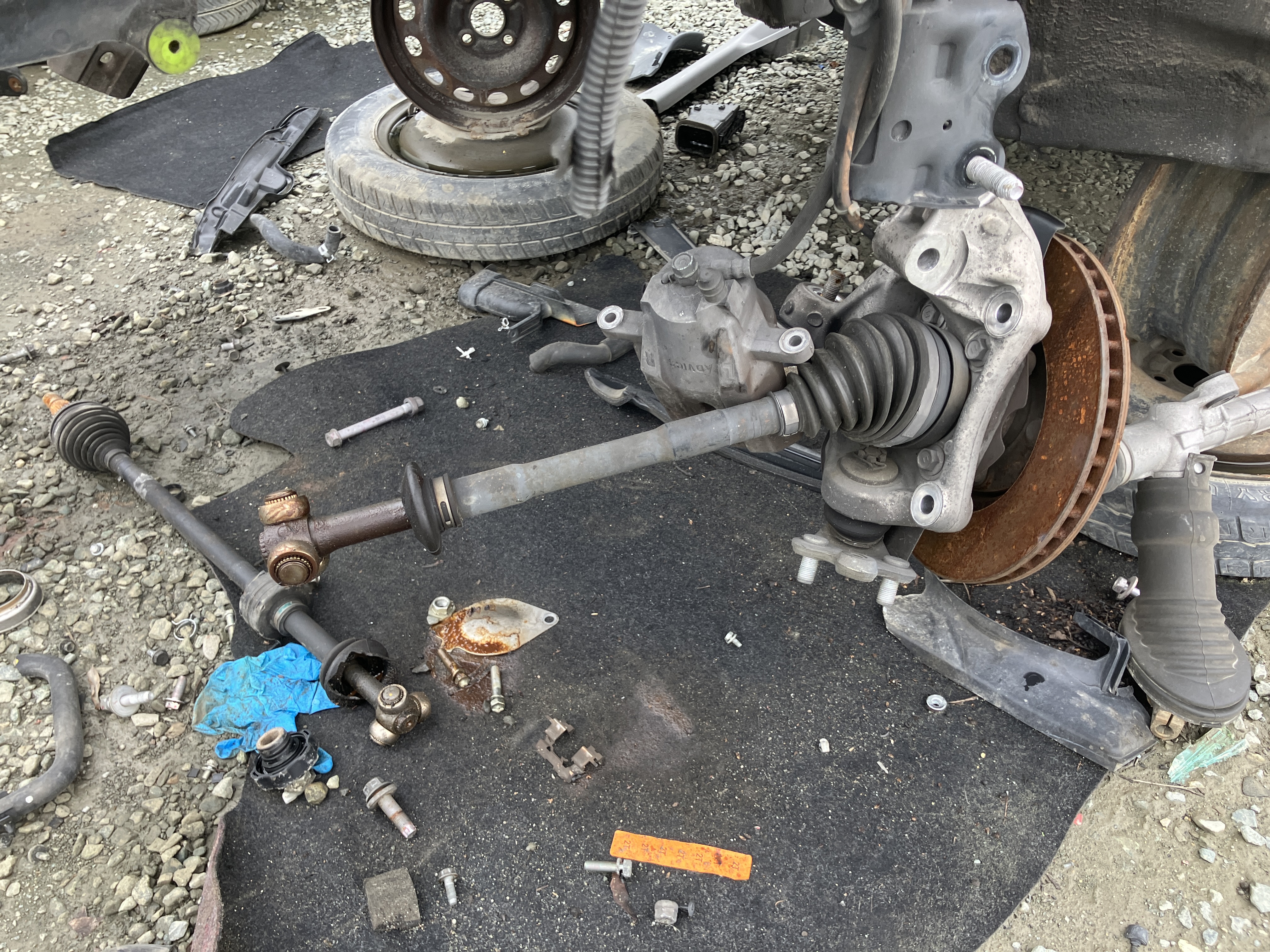

CV Axles and Steering Rack also from a Second Generation Non Plug-In 2007 Prius this time

Is this what TOYOTA means by liquid cooled inverter?

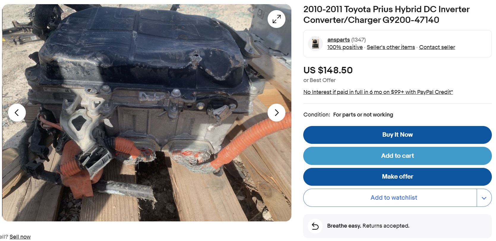

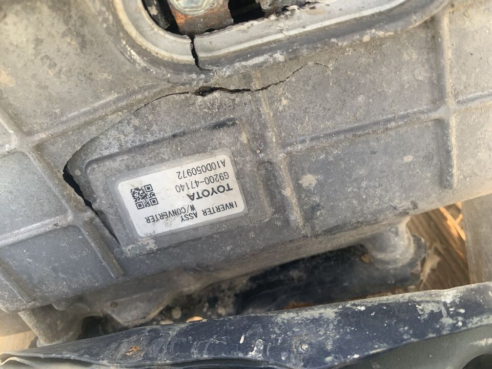

guys I just want to make sure we don't get into a bidding war on eBay for this Gen 3 Prius Inverter
so I beg to differ Mr. Maguire

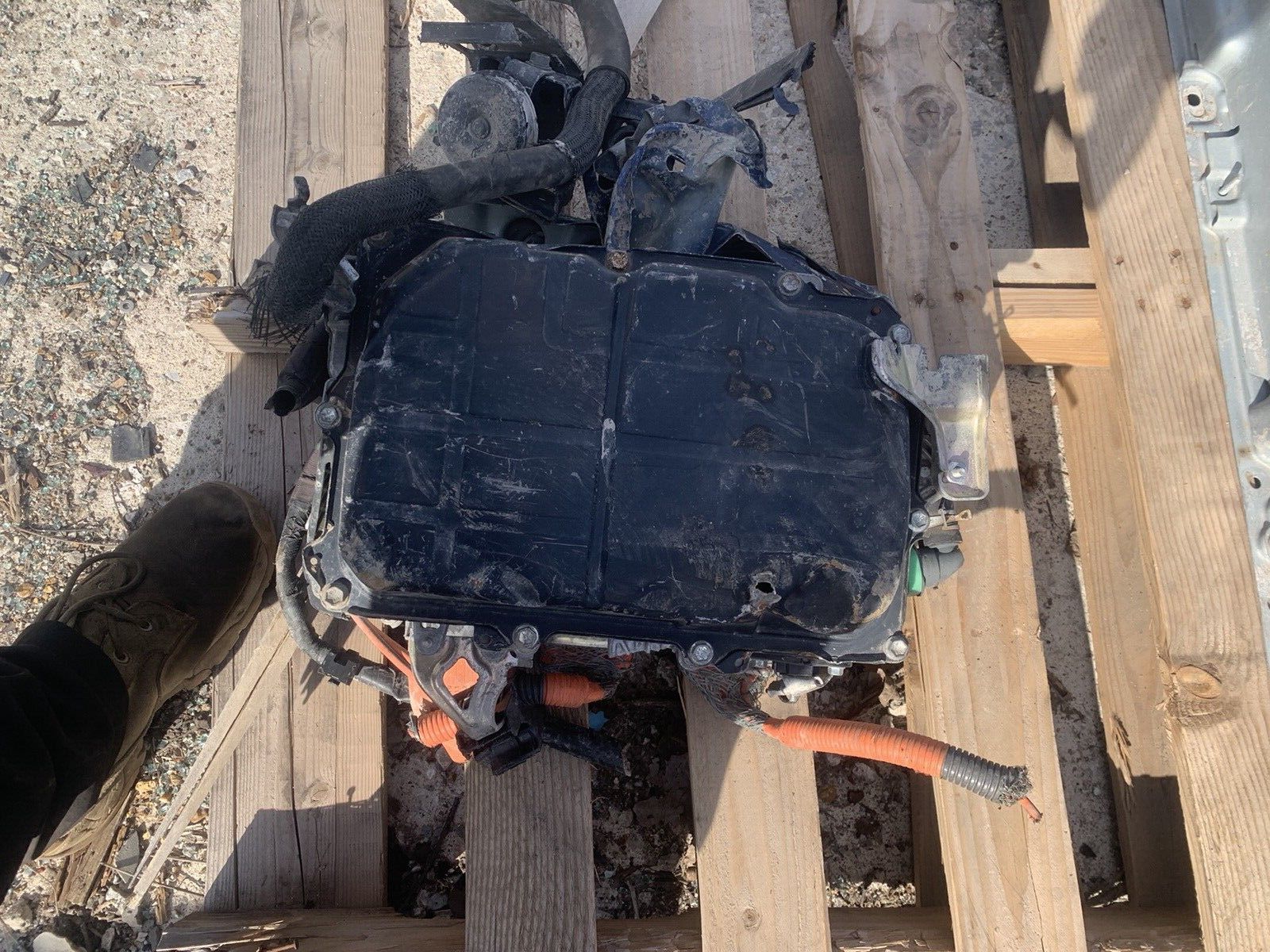

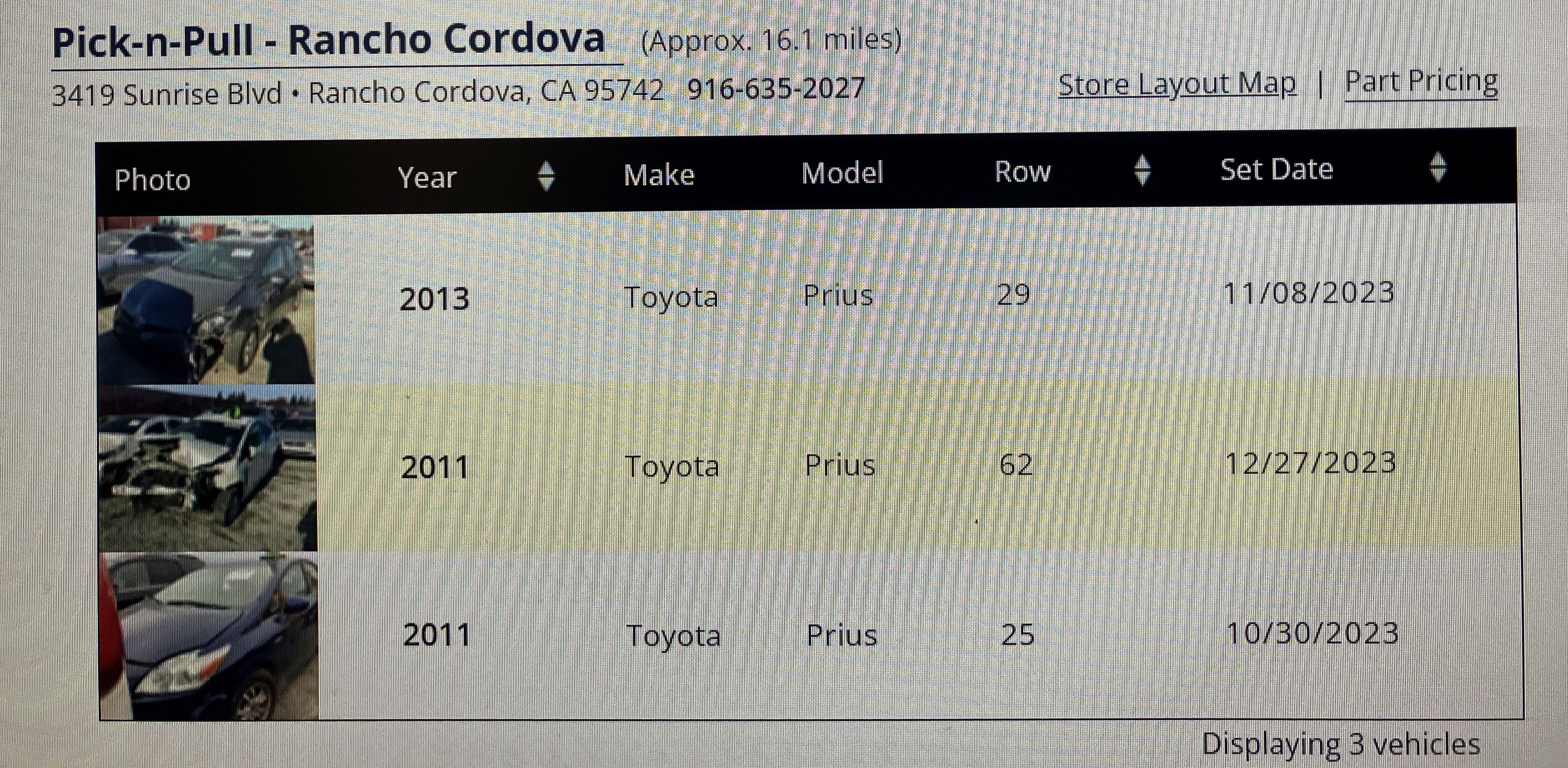

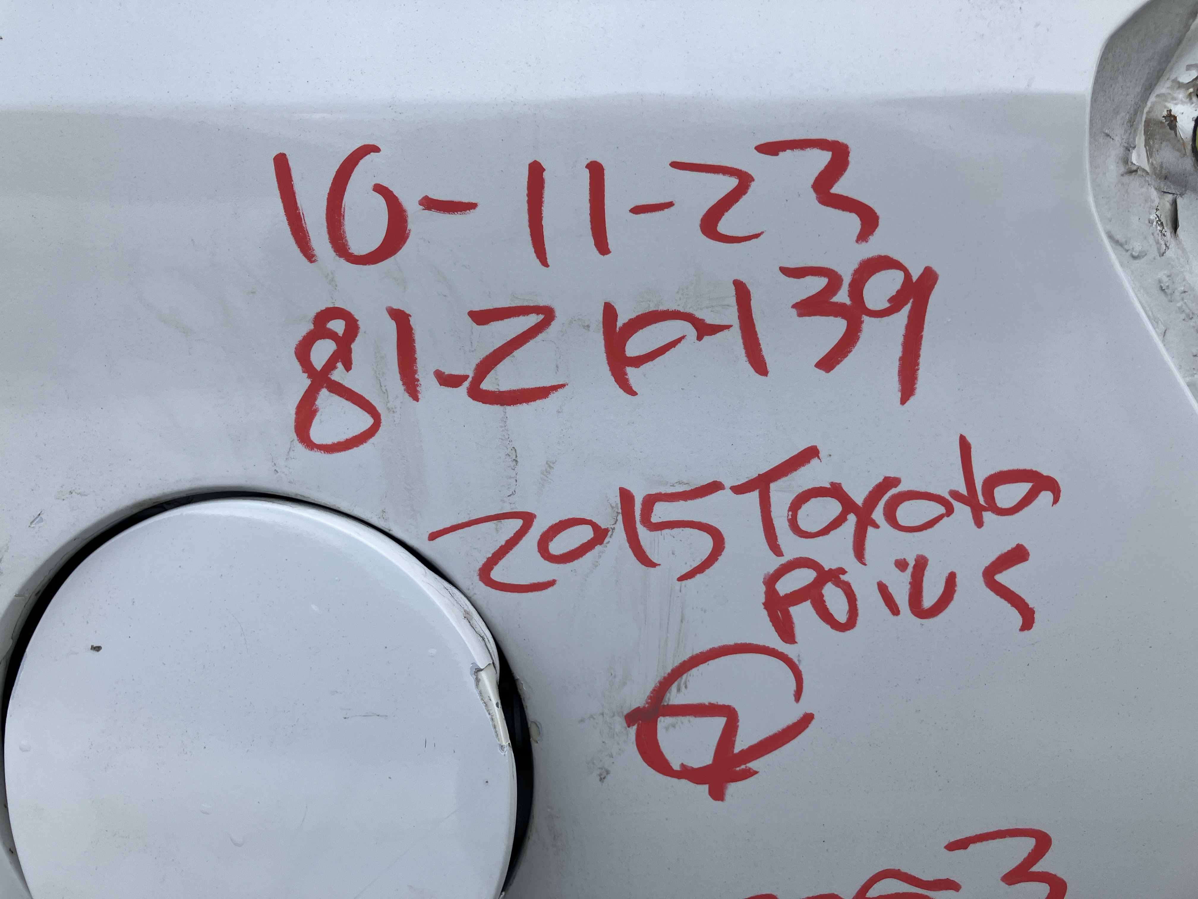

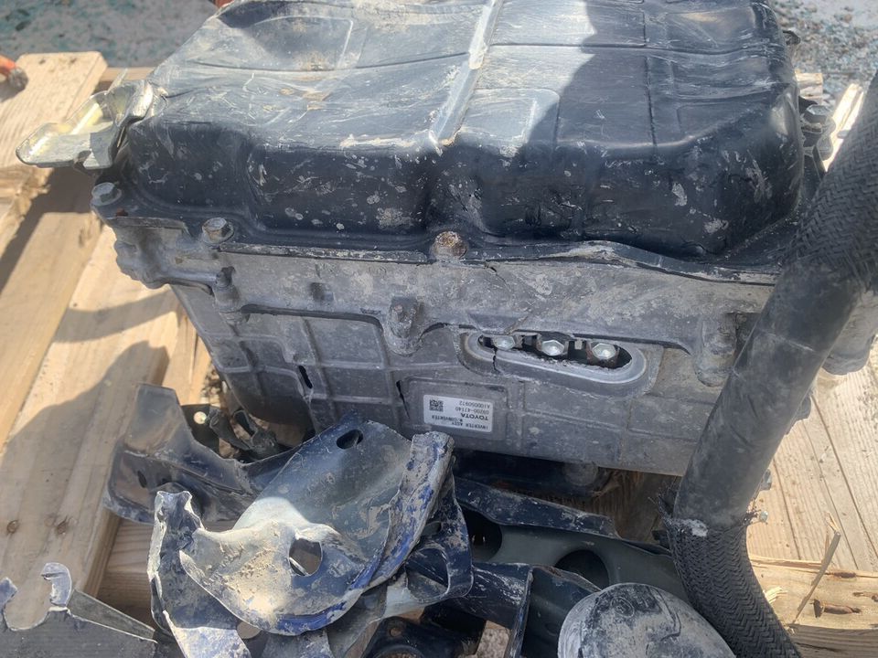

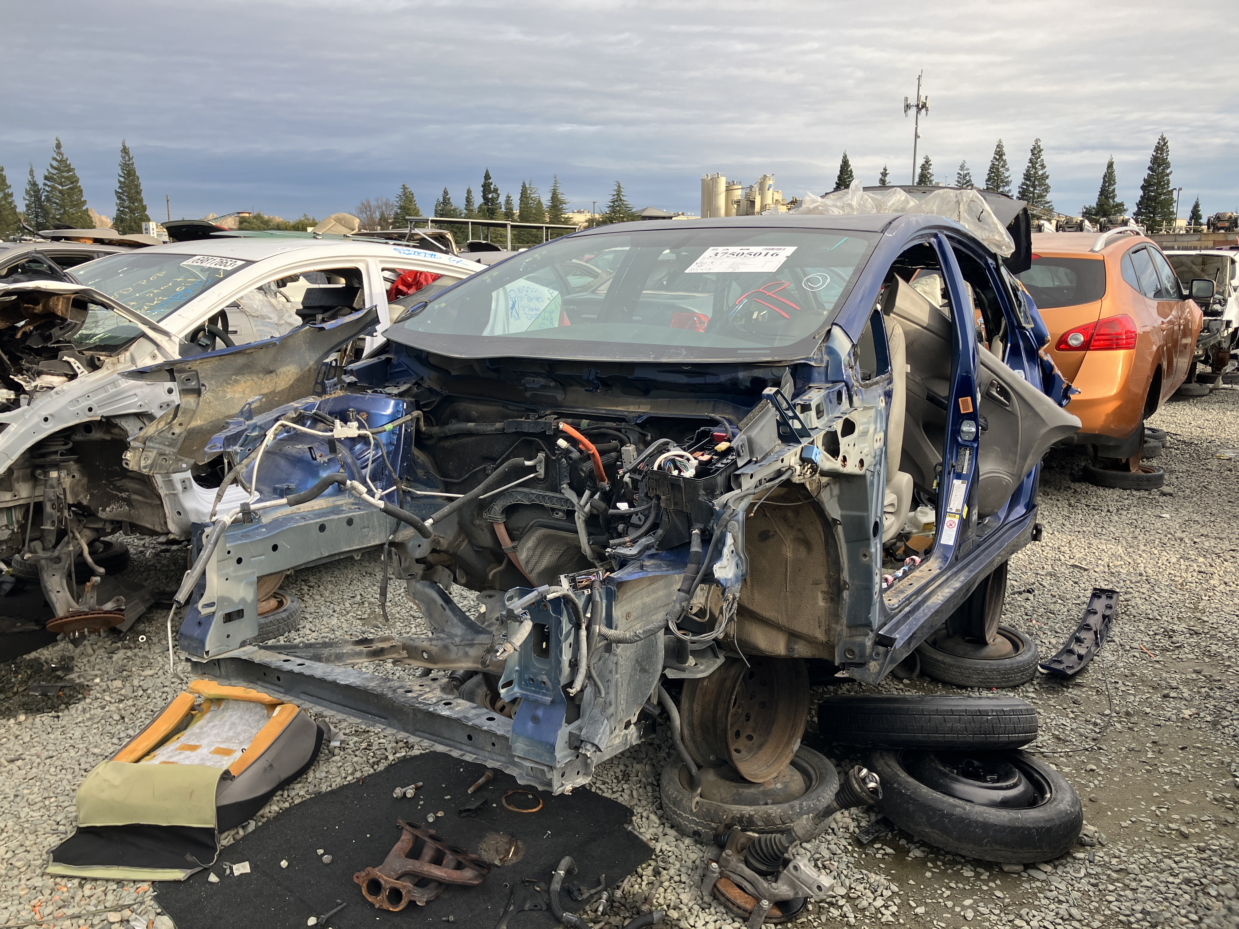

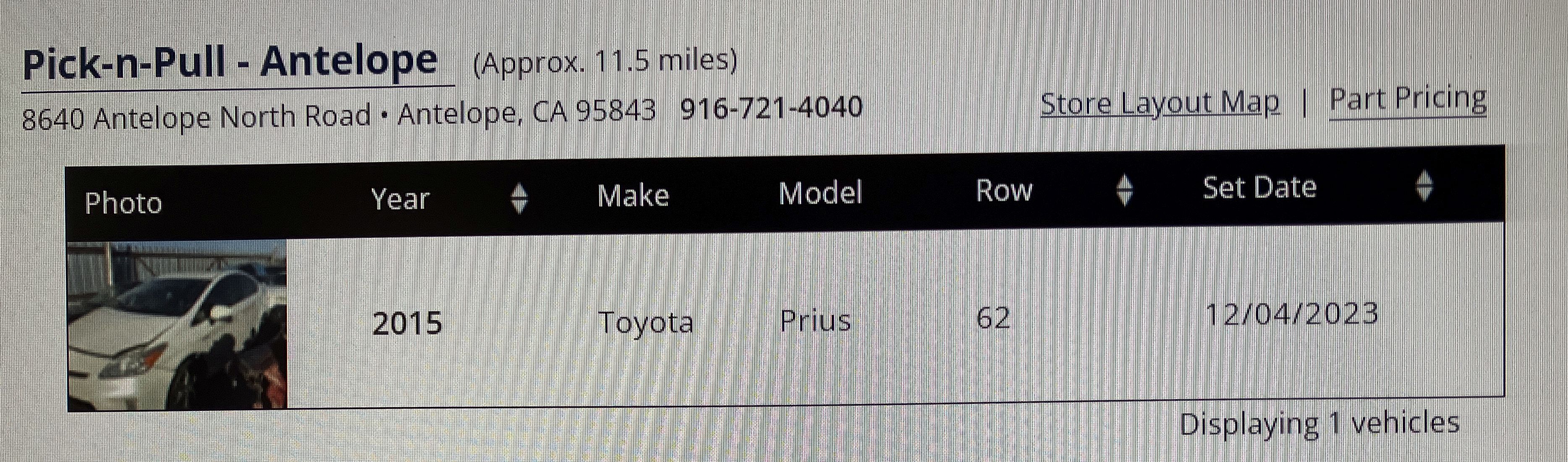

2010-15 Prius Gen 3 JunkYard Lessons Learned:
as of January 2024 it is nearly impossible to find motors and inverters in these cars in the local self service (you pull it) junkyards (in California anyways) they may have the vehicle, but the parts are long gone

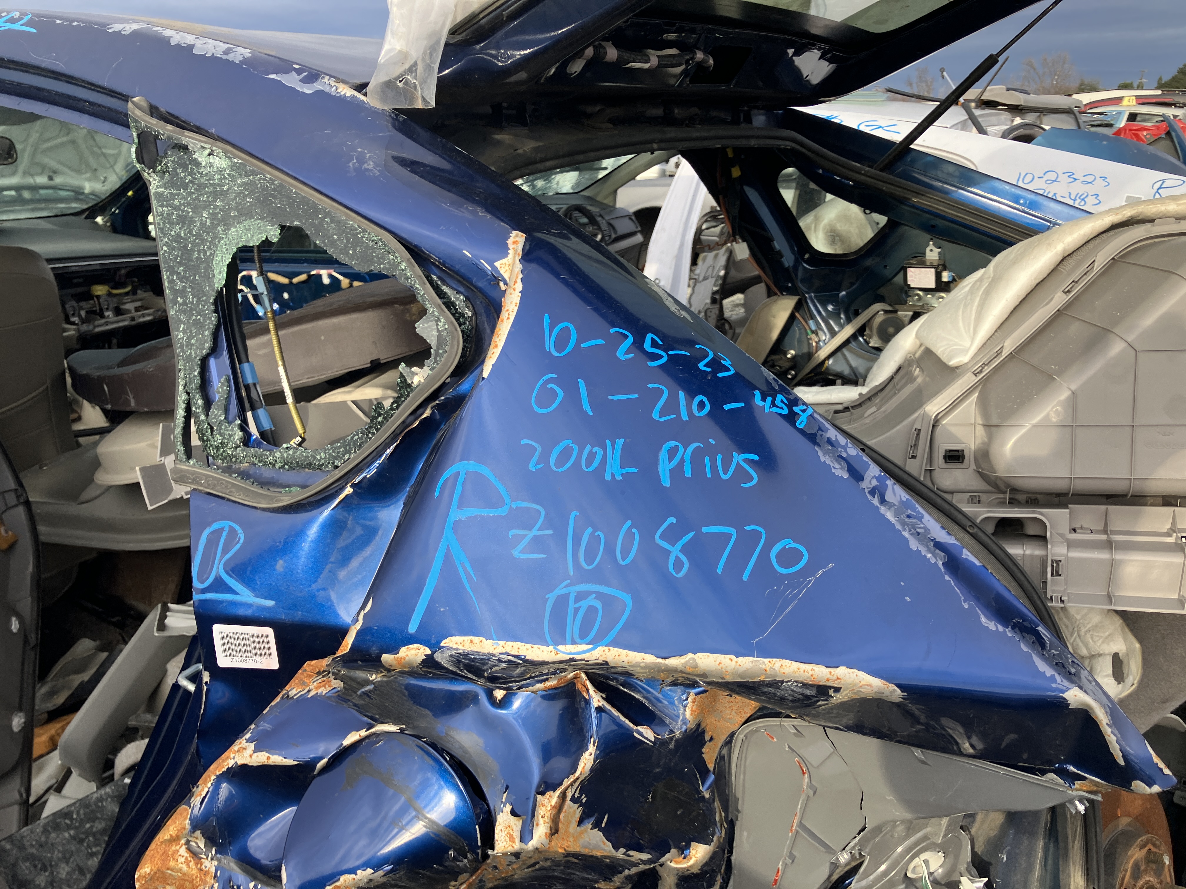

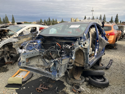

People's Exhibit A (2015 Toyota Prius)
Posts: 1084
Has thanked: 479 times
Been thanked: 314 times
Post by MattsAwesomeStuff »
Gregski wrote: Wed Jan 17, 2024 4:28 pmas of January 2024 it is nearly impossible to find motors and inverters in these cars in the local self service (you pull it) junkyards (in California anyways) they may have the vehicle, but the parts are long gone
Because of legislation change?
You were there two weeks ago and they had several.
Gregski
Posts: 3171
Post by Gregski »
MattsAwesomeStuff wrote: Thu Jan 18, 2024 6:56 am Because of legislation change?
No, no legislation change, the year roll over has nothing to do with it if that's what you were thinking.
MattsAwesomeStuff wrote: Thu Jan 18, 2024 6:56 am You were there two weeks ago and they had several.
Those were Gen 2 (2004-09), now I am reporting on Gen 3 (2010-15) the point being, the cars show up as listed in their online inventory, but when you get there they are completely picked already
