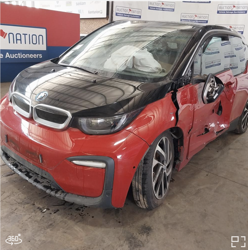

Hi There!
I'm new to the forum. Thanks everyone for sharing information so freely and creating this community, I am going to need it...
This is a first attempt at a conversion like this.
My project is just in its initial planning stages, and any input would be appreciated. I have a 1974 VW Kombi that I am planning to restore and convert to electric. For this I purchased and accident damaged 2019 120Ah REX BMW I3 on auction. I am hoping to use as many parts of the I3 as possible in the conversion, and modernise the safety and comfort of the VW to as close as possible to the standards of the I3. The plan is to use this as an everyday commuter vehicle for myself, and the occasional family trip. Charging mostly off solar at home with public infrastructure only used on rare occasions. It would be great to use the REX when needed.
I'm not an engineer, but am practical and creative and an owner of a Special effects company in Cape Town South Africa, with access to a well equipped workshop and skills where I will do the project over a time frame of maybe 5 years if possible.
Will post pictures as I go and most likely ask totally cringeworthy questions.
Here we go!

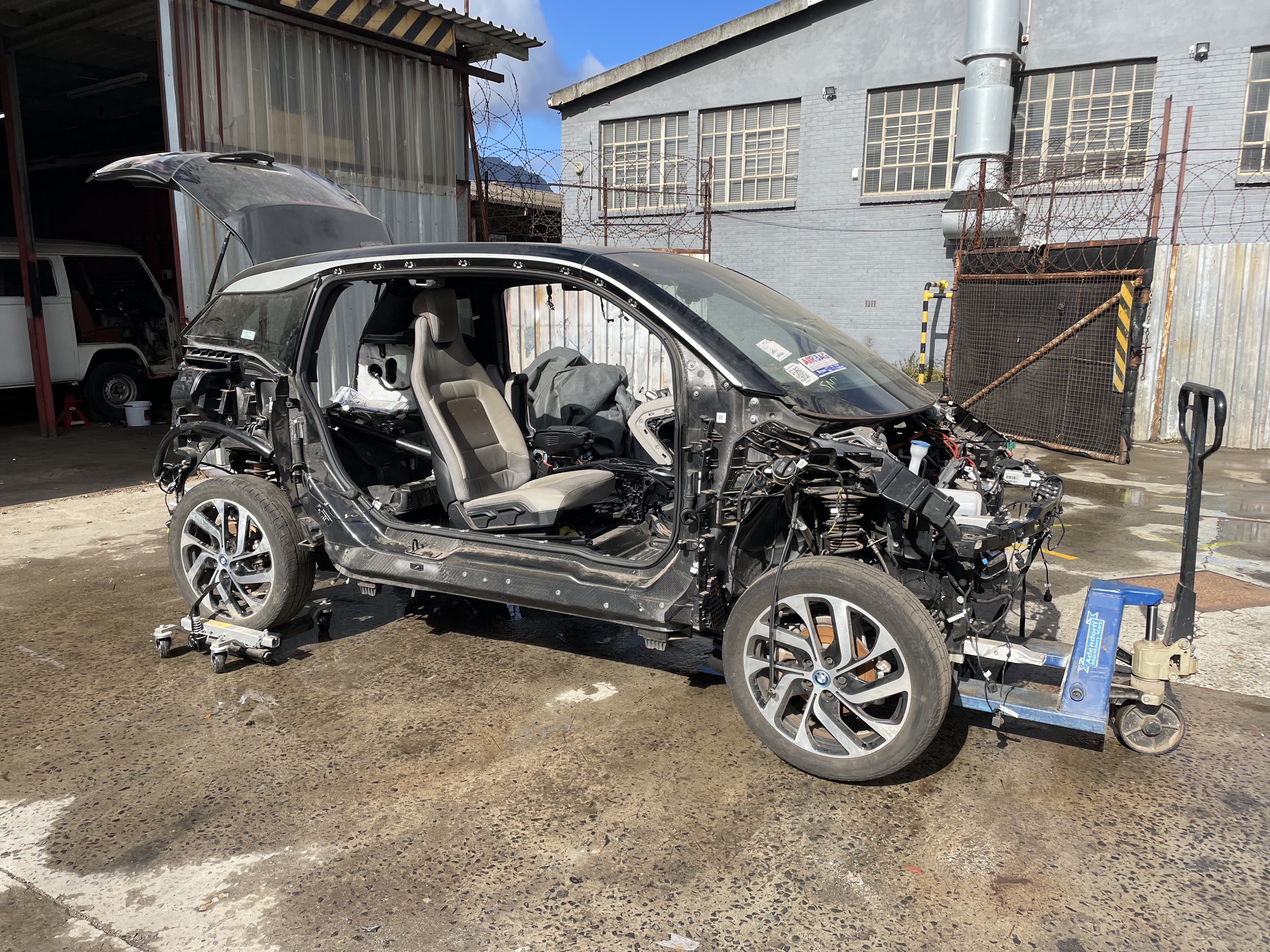

I love to see how your project will go. I'm also curious if your i3 currently is running, because I see a lot of wrecked i3's which don't run because of some crash sensors or something have activated some kind of protection in the system. I'm curious if yours have the same and how you have or will fix this.

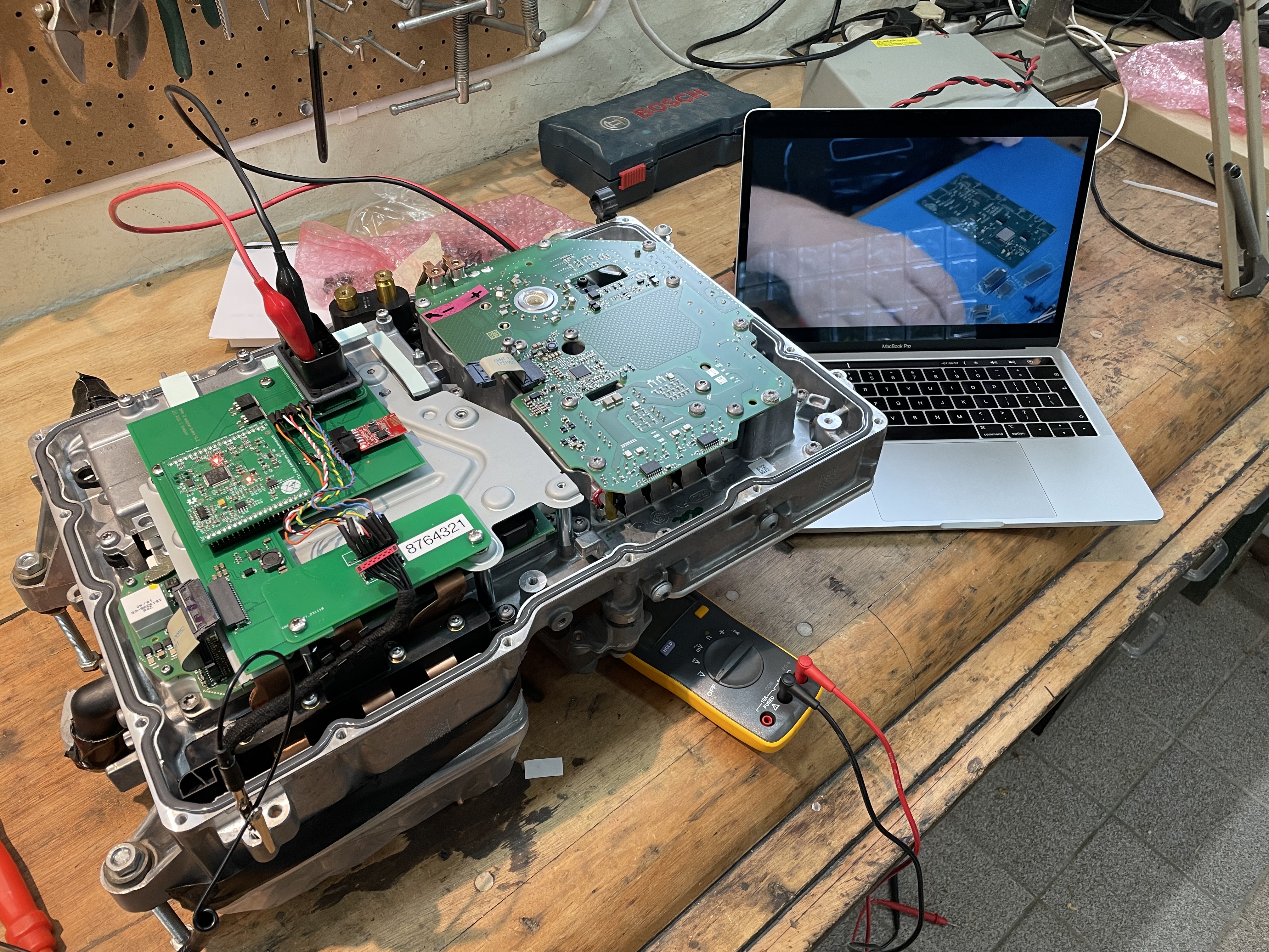

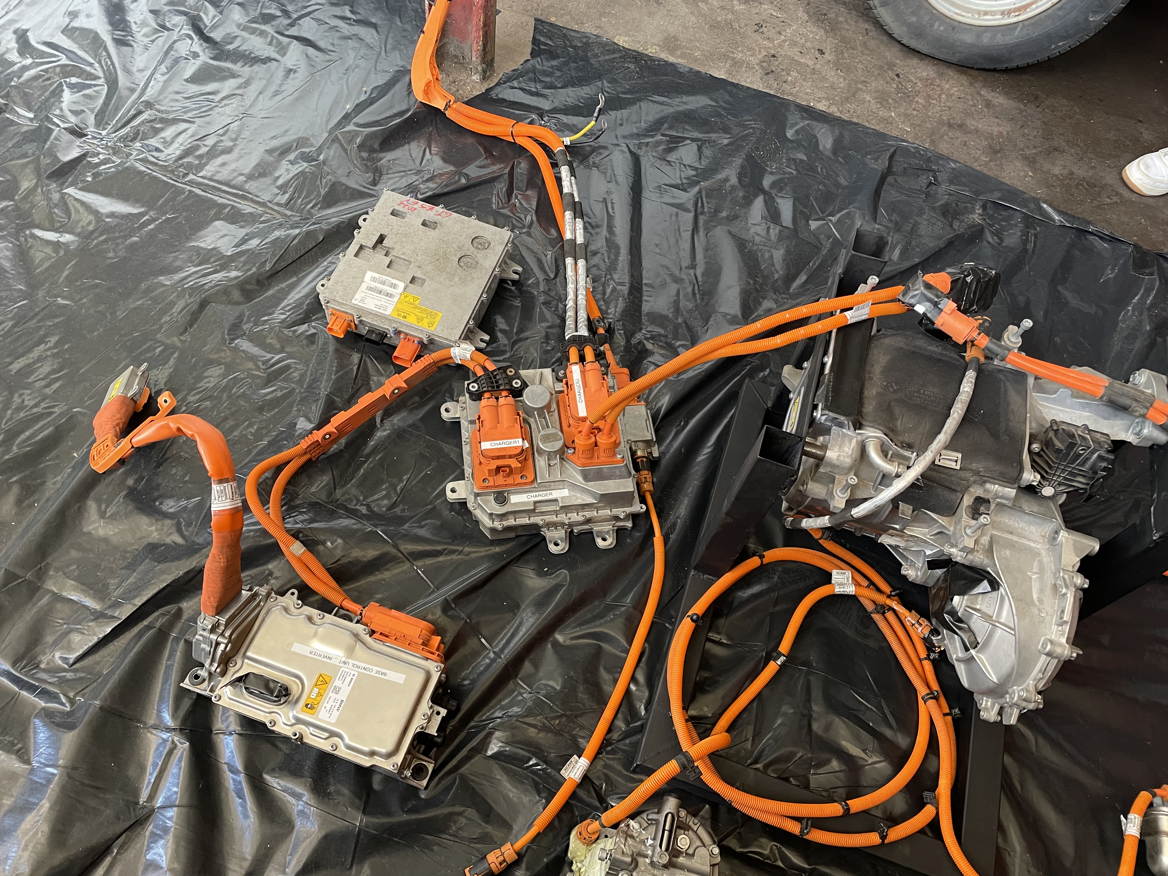

Thanks Knulen. Will update as I go. Started by stripping the VW and I3, but decided to just do some more research before I get carried away. Had a very informative chat to Janosch Opperman last week to talk through my plans, so I feel a lot more confident about the route forward. Thanks Janosh! Ordered the I3 OI board and a Zombiverter VCU. Next step is to get the motor out and start working towards a bench test as a first target. May be a couple of months before I get the time to get properly stuck in.Knulen wrote: ↑Fri Jan 05, 2024 11:45 am I love to see how your project will go. I'm also curious if your i3 currently is running, because I see a lot of wrecked i3's which don't run because of some crash sensors or something have activated some kind of protection in the system. I'm curious if yours have the same and how you have or will fix this.

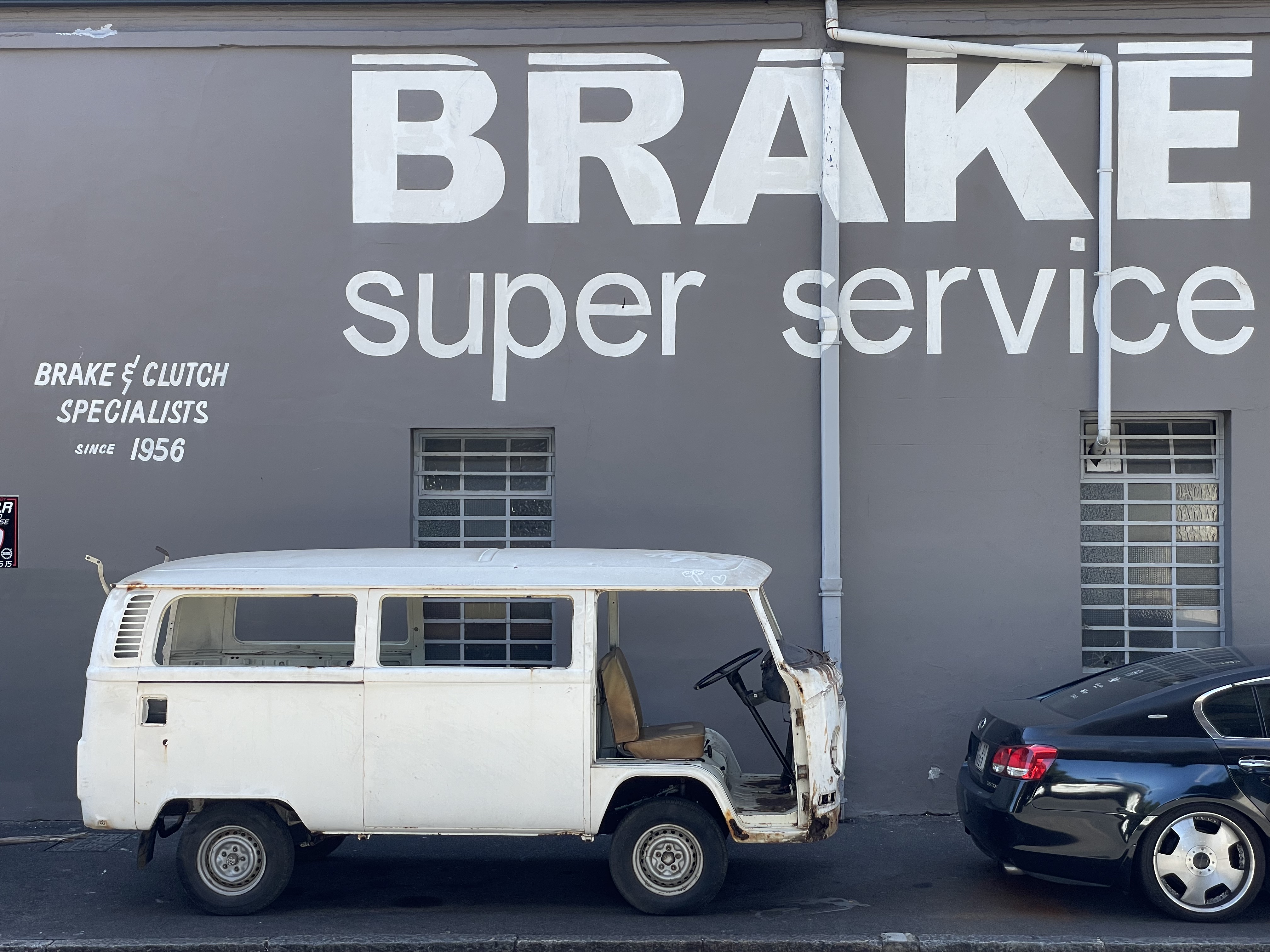

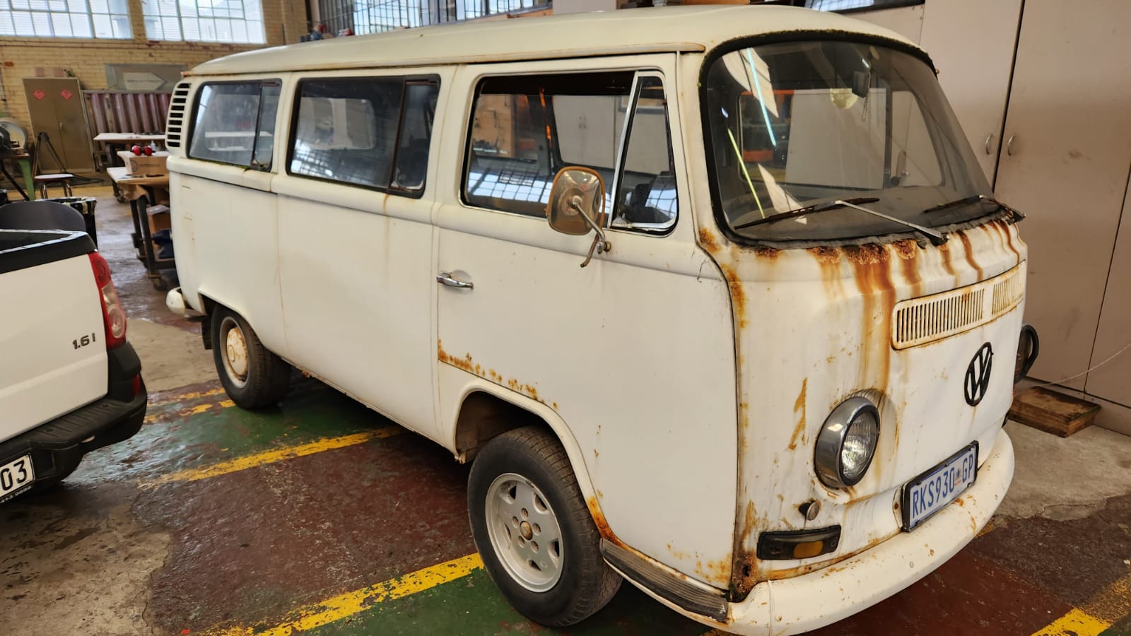

Thanks. Yes, making progress. The pictures above are not the actual Kombi- Its what I am aiming for. Here's the actual vehicle. Stripped and at a brake specialist. Starting with that before I fit the motor. Have fitted to OI. board and will hopefully soon get closer to a bench test of the motor.
T1Terry wrote: ↑Fri Nov 01, 2024 5:08 am I see you have an early bay window Kombi, the steps at the front doors and the indicators low set give it away.
Are you planning to replace the gearbox with the i3 transaxle and not using the petrol engine?
Planning to use the transaxle with new custom driveshafts, nothing from the Kombi
