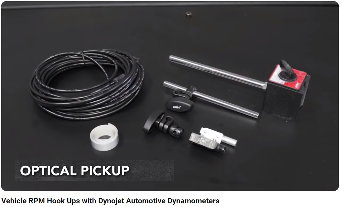

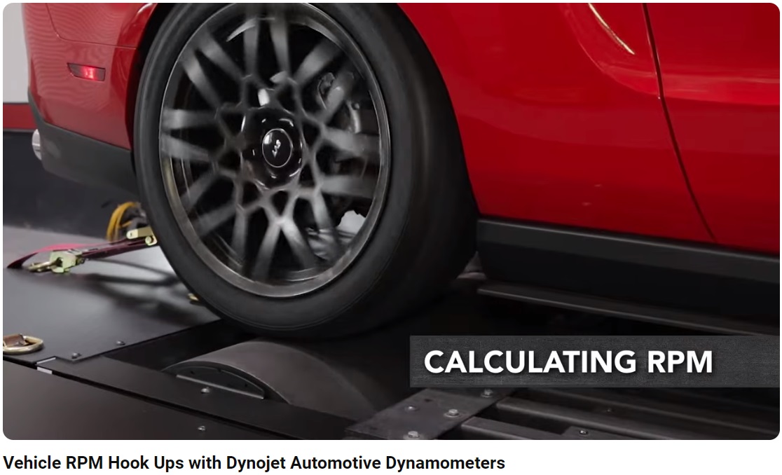

Vehicle RPM Hook Ups with Dynojet Automotive Dynamometers
this video goes over the five different ways you can send RPM signal from the vehicle to the dynamometer (maybe two of these could work for the EV, what do you think?)
  1. Inductive Pickups (this is the method we already tried and it did NOT work)
  2. Optical Pickup
  3. EZ-RPM Module
  4. OBDII Data Link (vehicles older than 1995 in the US do not have this port yet)
  5. Calculating RPM

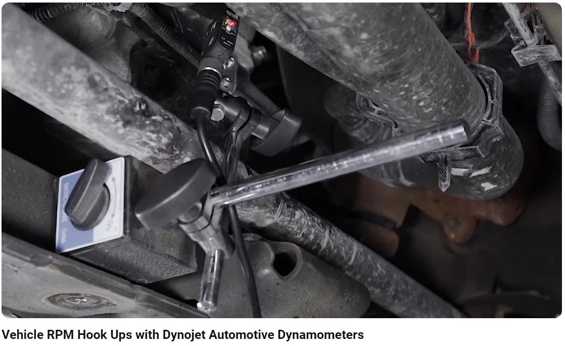

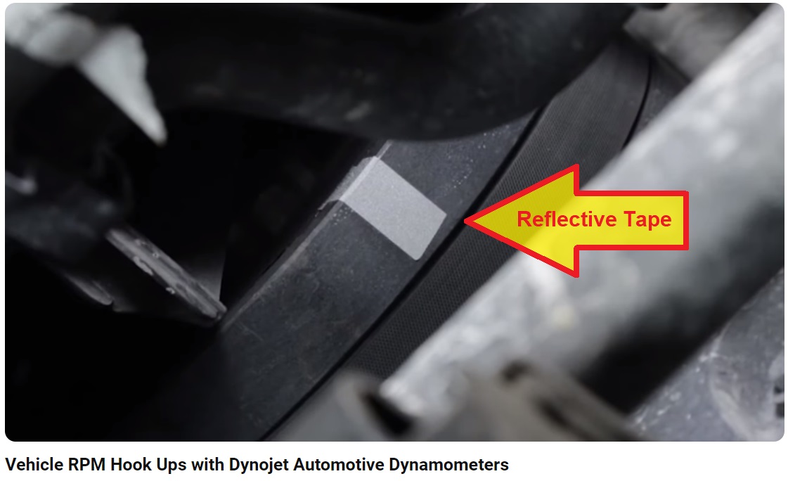

Dyno shops should already have this component as it is commonly used for diesel applications:

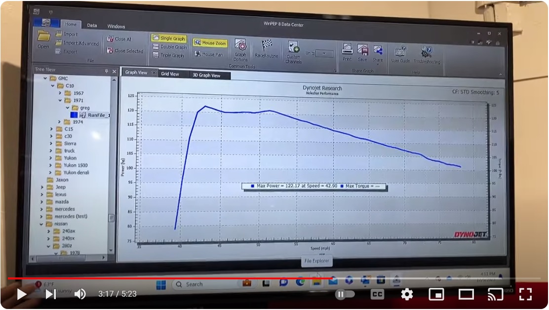

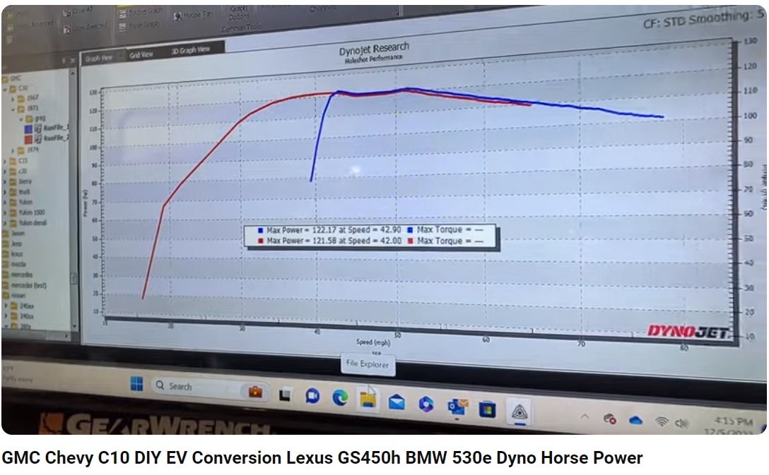

Aragorn wrote: Fri Dec 15, 2023 11:36 am The dyno chart is a slightly weird shape compared with Damiens. Damiens had a clear constant torque region, and then transitioned over to constant power, which it held fairly flat. Yours on the other hand hits constant power fairly quickly, then shortly afterwards the power starts dropping off. They started the dyno run at a fairly high speed though, which is perhaps hiding some of that constant torque region? but why the power drop off? Batteries?
both of my pulls were done from rolling starts, the first one from almost 40 miles per hour, and then I think it held for about 10 miles till 50, and yeah I am using a very small 9 kWh hybrid battery pack, one that I shouldn't even be running around with let alone driven 25 miles to a dyno shop and then tried to do some power pulls, lol
also both of my graphs are just horse power, one is from almost 40 miles per hour the other from about 10 mph

Gregski wrote: Fri Dec 15, 2023 4:09 pm both of my pulls were done from rolling starts, the first one from almost 40 miles per hour, and then I think it held for about 10 miles till 50, and yeah I am using a very small 9 kWh hybrid battery pack, one that I shouldn't even be running around with let alone driven 25 miles to a dyno shop and then tried to do some power pulls, lol
Ahha your 10mph pull looks much more like i'd expect! You can see the constant torque region now.
If we know tyre size we can calculate wheel torque from the chart.
Your 215/65r17 tyre has a diameter of around 28"/711mm and will do around 721 revs per mile.
At 20mph therefore the wheel is doing (721*20/60) 240rpm.
Its making ~73hp at 20mph/240rpm so we know its making 1597lbft at the tyre. (Power*5252/rpm)
At 30mph its making 110hp, doing the same math we can see that again its making similar torque (1604lbft)
Thereafter it transitions into power limiting and torque starts to fall off.
We also know your rear diff ratio, 3.73 and the 1.9 reduction in the trans, so we can calculate motor torque.
1575/3.73/1.9 gives us around 222lbft, or almost exactly 300nm at the motor.
