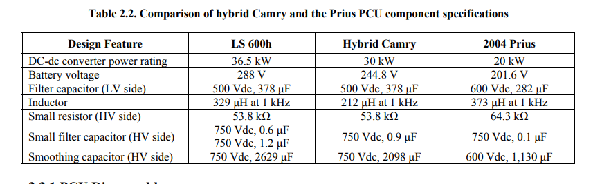

LS 600h report
https://www.osti.gov/servlets/purl/947393 I would strongly recommend you read into the subject of high voltage. The higher the voltage the more you need to pay attention to component ratings and design considerations.
There are very few and not really available second hand components for such high voltages. This means you will need to buy all auxiliary HV components new and they will be expensive due to being 650V.
LS 600h report

Ahh, I thought it was a 650V cap, not massively familiar with it yet. Don't think zombie does anything with the buck boost, but on the Prius OI boards you could use it to buck down the voltage into the DCDC range.
If you got control of it, you could use 400v DCDC
