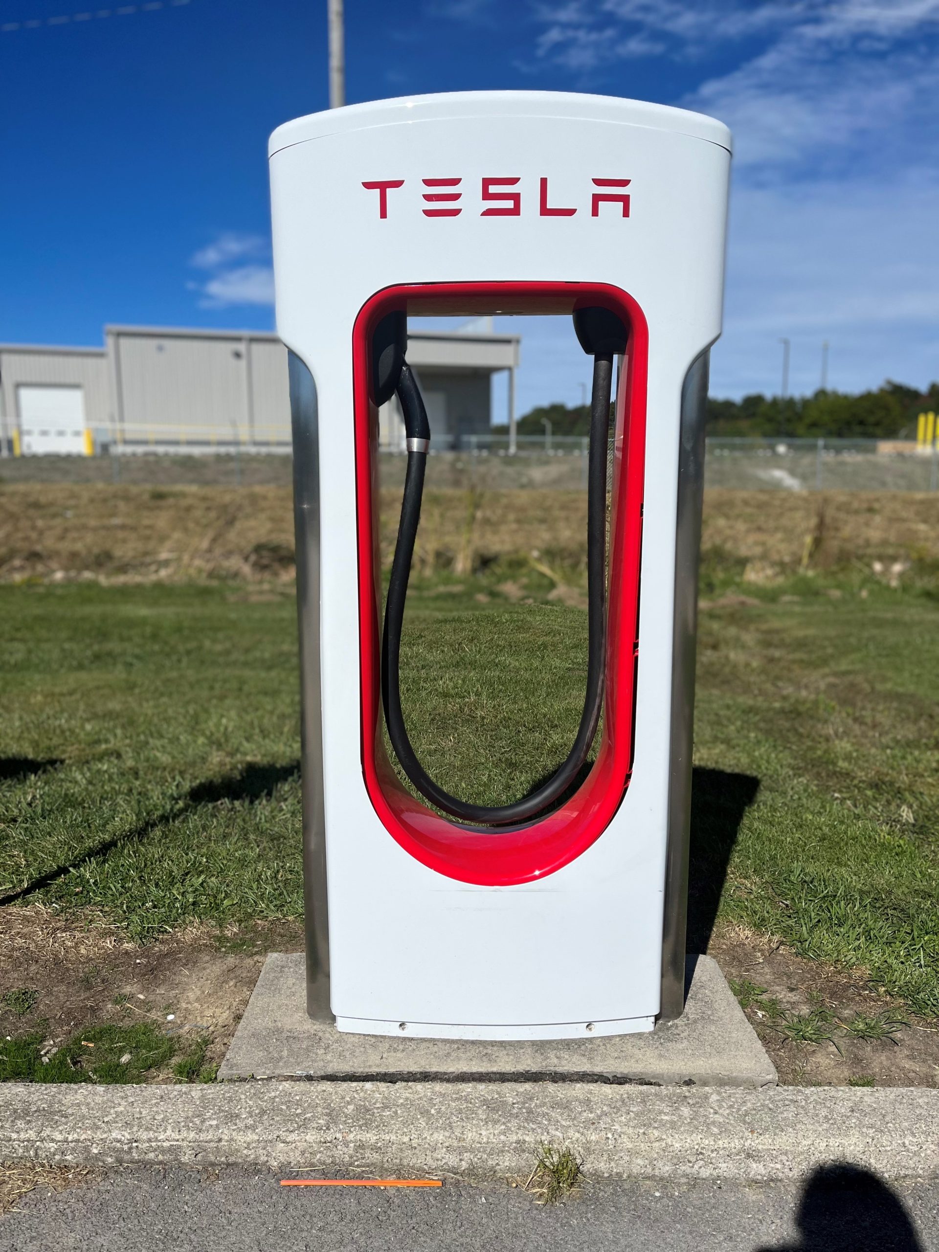

Re: Newb Asks: Can anybody just charge at a Tesla public station?
First of all not all Tesla charger were created equal, I think most of us think of these types of see through beauties when we think of Tesla chargers
and rightly so, but these are not just chargers, these are SuperChargers, and they are NOT for us, non Tesla owners!

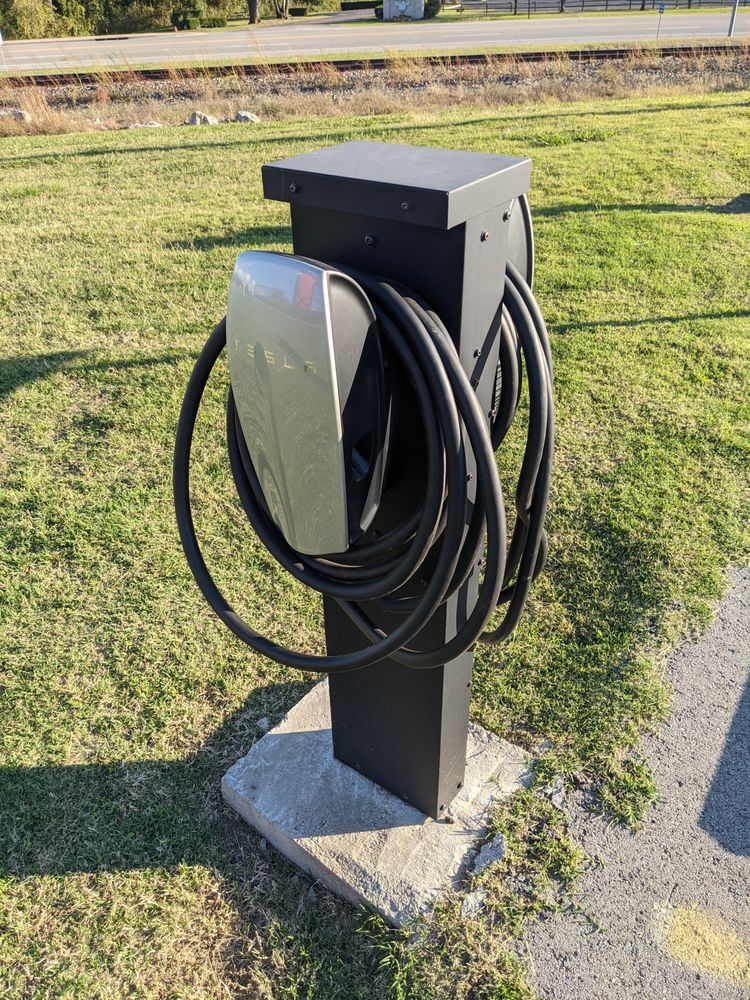

Besides Tesla Superchargers, Tesla owners can also take advantage of the company’s network of Destination Chargers. Destination Chargers are installed by Tesla’s ‘Charging Partners.’ pronounced "Hotels"
Charging Partners are usually business or land owners who choose to install a Tesla Wall Connector on their property for public use.
Destination Chargers have a slower charging speed than Superchargers. Depending on how much charge is left on your Tesla’s battery, a Destination Charge can take anywhere from one to 12 hours to fully charge your vehicle.
It's my understanding that the destination chargers are AC charging using the onboard charger, vs the Supercharger's DC fast charging.
Effectively:
Destination=J1772 for Teslas (and others with adapter I think?)
Supercharger=CCS for Teslas (and soon others)
