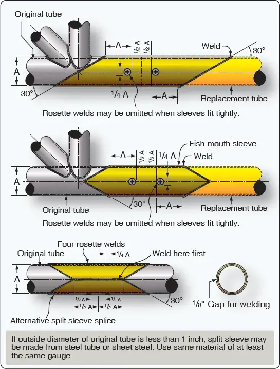

Well i will soon go with the No. 1 option - welding on Mazda MX3 reconversionZieg wrote: ↑Mon Oct 16, 2023 1:51 pm I'd like to talk about the matter of shortening/modifying CV axles and what options are out there. I think it's a common enough issue encountered during conversions, so I'm hoping there will be a few people here with different insights.
Are there any other options out there worth looking at. What did you do on your conversion?
viewtopic.php?t=4210
With converting Peugeot i was fortunate enough the Pug axles were larger than Leafs and hollow. This allowed me to cut the axles a bit longer and put them to lathe. Some material later i could slide Leaf axle into the Pug larger axle and weld it around the joint.
HOWEVER! This by itself is not enough. By material joining theory those welds will cause stress in a form of torque spike which could damage material, Usually welded axles are normalized in an oven at more than 400degC for a long time. I imagine this is why custom axles are expensive.
My idea however comes from aviation instruction on how to extend shafts and carry members. https://grassrootsmotorsports.com/forum ... 977/page1/
Idea is to fit a sleeve over the innitial weld. This sleeve will be welded at the ends of course. But additionaly i will put several holes into that sleeve spaced at 25mm and at 90deg to each other. Then we will rosette weld those.
This effort will mean that the torque spike will not happen as rosette weldswill join material so it will only create a wider torque hill instead of a true shattering spike in place of weld.
That is theory at least. I need to put it to practical application...

Well first of all you need to weld the seams like you did. Then you prepare the sleeve. It needs to be made of correct material that allows for good normalizing in air and has high strength when quenched. First you need to drill 8mm holes with about 25mm spacing in 90deg positioning. They will serve to weld rosettes in material underneath in effect fusing sleeve to both shafts. Of course you need to weld the sleeve on both circumferences.P.S.Mangelsdorf wrote: ↑Tue Oct 24, 2023 2:30 pm When I first build my Tesla swap, I cut and welded the Tesla axles to the GTO axles my rear suspension uses. I used a technique I saw on Youtube of cutting each axle on an angle, then welding, then sleeving and welding again. That worked for getting on the road but eventually failed, and it had bad vibrations the whole time too.
Then i suggest you normalize steel according to material properties chart... basicaly heat-up material to certain level and letting it cool down by air.
Finally you need to put that shaft to lathe and balance it in the plane of rotation.
Like i said Mazda has huge chassis scissors in front which can interfeere with size of the driveshaft. I need to keep the size down.
