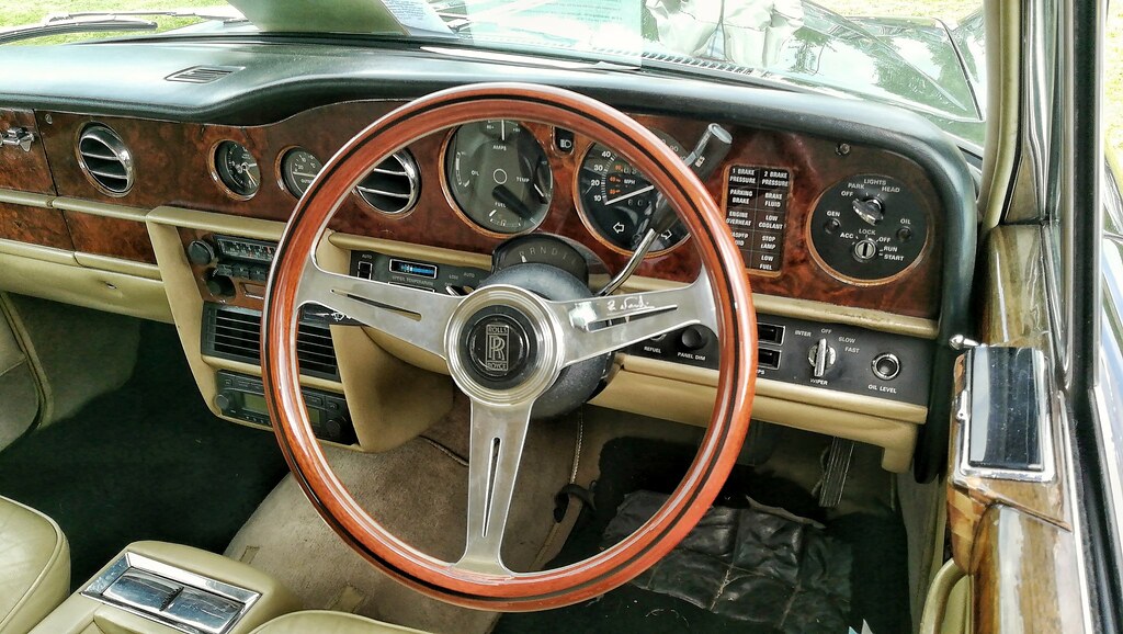

I used a column shifter from a 1970's Rolls Royce in my VW Bus. Allows me to select 'drive' with three different regen settings (if I ever get around to modifying the firmware)
Re: Asserting Drive - Neutral - Reverse signals
I like this idea a lot.

I'm just starting a conversion on a 78 Rolls. Brilliant idea! I'm stealing it.Kevin Sharpe wrote: ↑Tue Dec 03, 2019 10:27 pmI used a column shifter from a 1970's Rolls Royce in my VW Bus. Allows me to select 'drive' with three different regen settings (if I ever get around to modifying the firmware)
