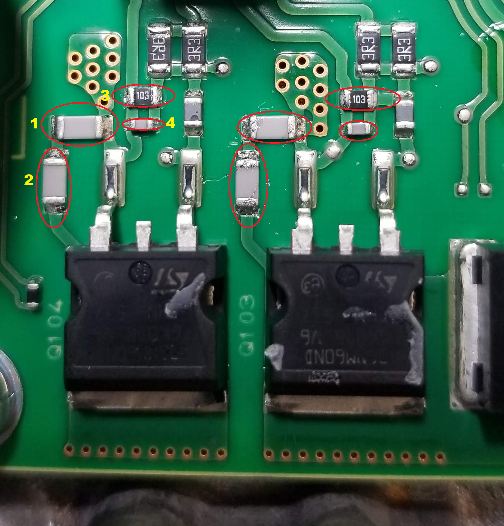

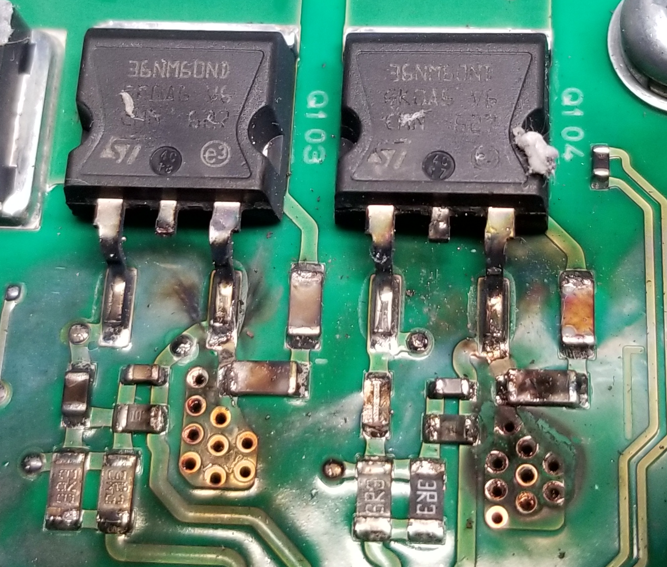

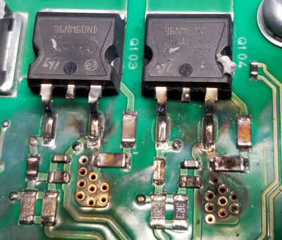

I'm now on my 3rd DCtoDC converter.
For some reason the board burns/shorts out at the same spot.
I was hoping someone on here can identify 4 numbered parts. (especially #2)
This way I can try to replace them instead of buying the entire unit.
Thanks in advance.

Can you mark down readings across all of them in place and verify that the 2 are identical circuits / identical value components? If so, pull the ones off the left side of the burnt image to measure resistance / capacitance.
Just saw the difference edit.
Some could be the same between the circuits but it's probably wise to pull each and measure them.
1 resistor of unknown value
2 resistor of unknown value
3 "103" = 10k https://www.digikey.com/en/resources/co ... istor-code
4 capacitor? Of unknown value
Then https://www.protoexpress.com/kb/differe ... age-sizes/ for the footprint size references.
White body of the resistor means non flammable / fusible resistor. Just means when they fail it's not on fire (for long) or exploding.

1 and 2 could also be capacitors. The light grey colour suggest COG/NP0 dielectric so could be up to 100nF depending on voltage rating.

Oh boy...
I guess the only way to figure out if it's a capacitor or resistor is to remove it and measure it....right?
