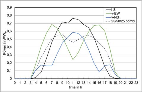

Do you have access to bifacial solar panels? A partial vertical install could be a good option to help supplement solar generation. They typically make power earlier and later in the day, benefit from no snow accumulating on the energy producing faces, and can make a surprising amount of energy from albedo light which goes up when there's snow on the ground.
From https://cleantechnica.com/2022/07/25/ne ... rformance/
Do you know the buildings power usage throughout the day, and how much power needs to be made / stored while dark?

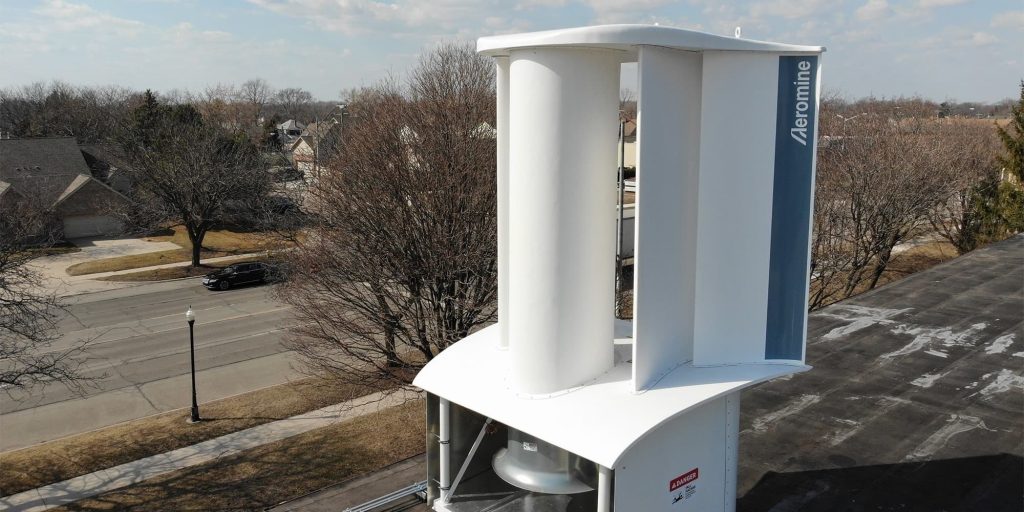

There are also the venturi style wind turbines if it's worth going with a fixed unit.
https://electrek.co/2022/10/14/rooftop-wind-solar/ They claim to be blade-less but have the turbine in the base. These are likely an easier shape to make if you're going the do it yourself route.
Adding a wind direction sensor nearby and a motor to rotate the venturi top to match wind direction could be very beneficial. That could be an evolution path as you get time.

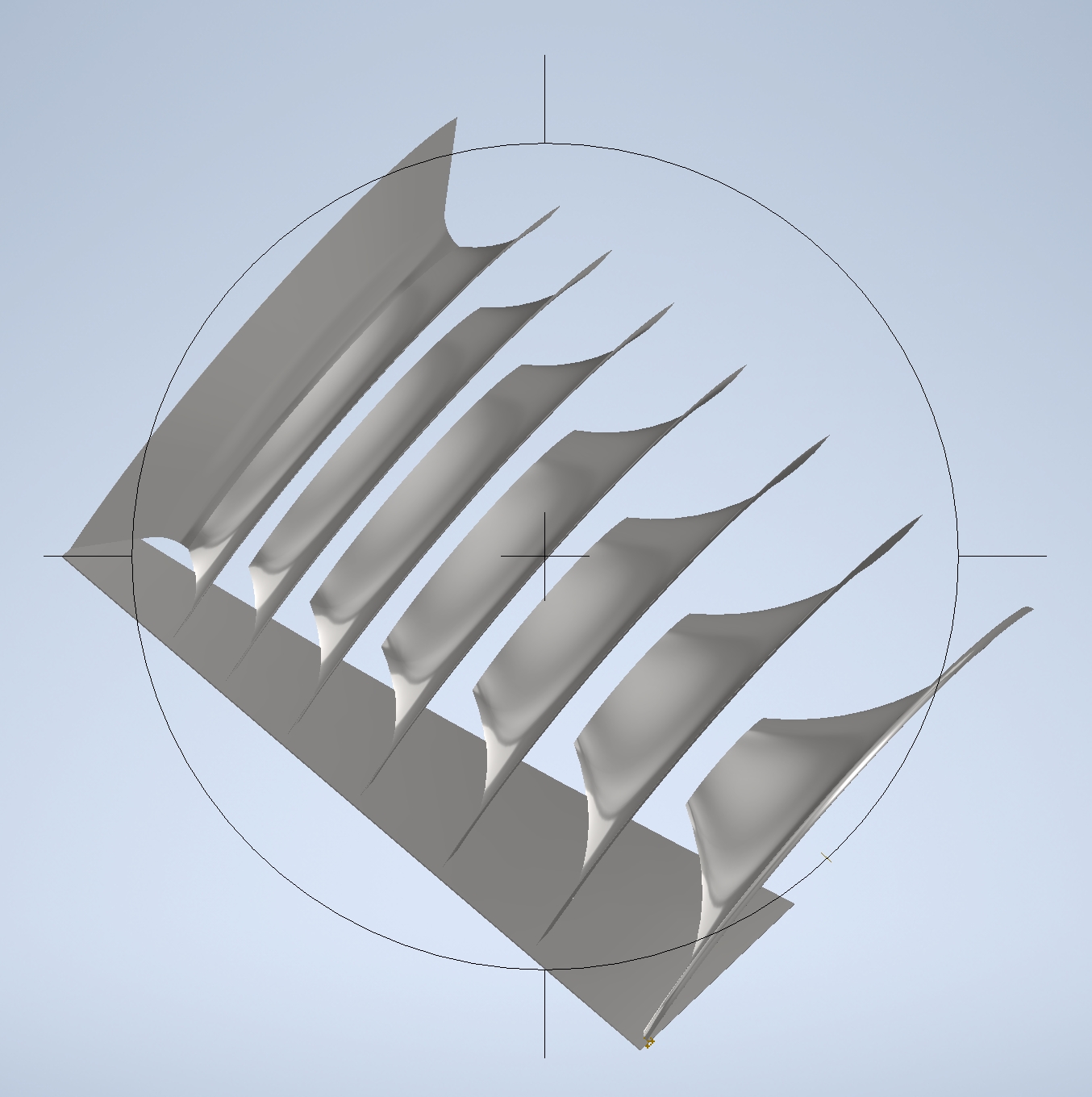

So I started to make a CAD model, and so far so good ^^
