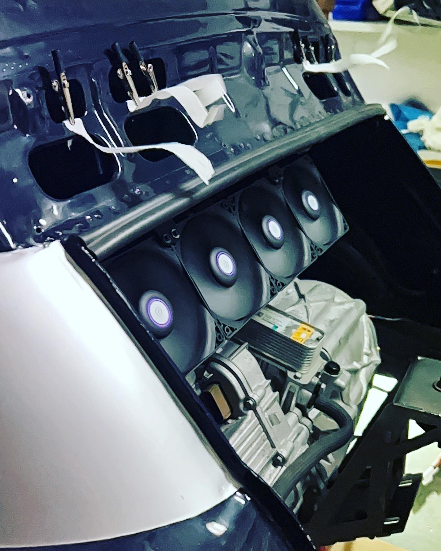

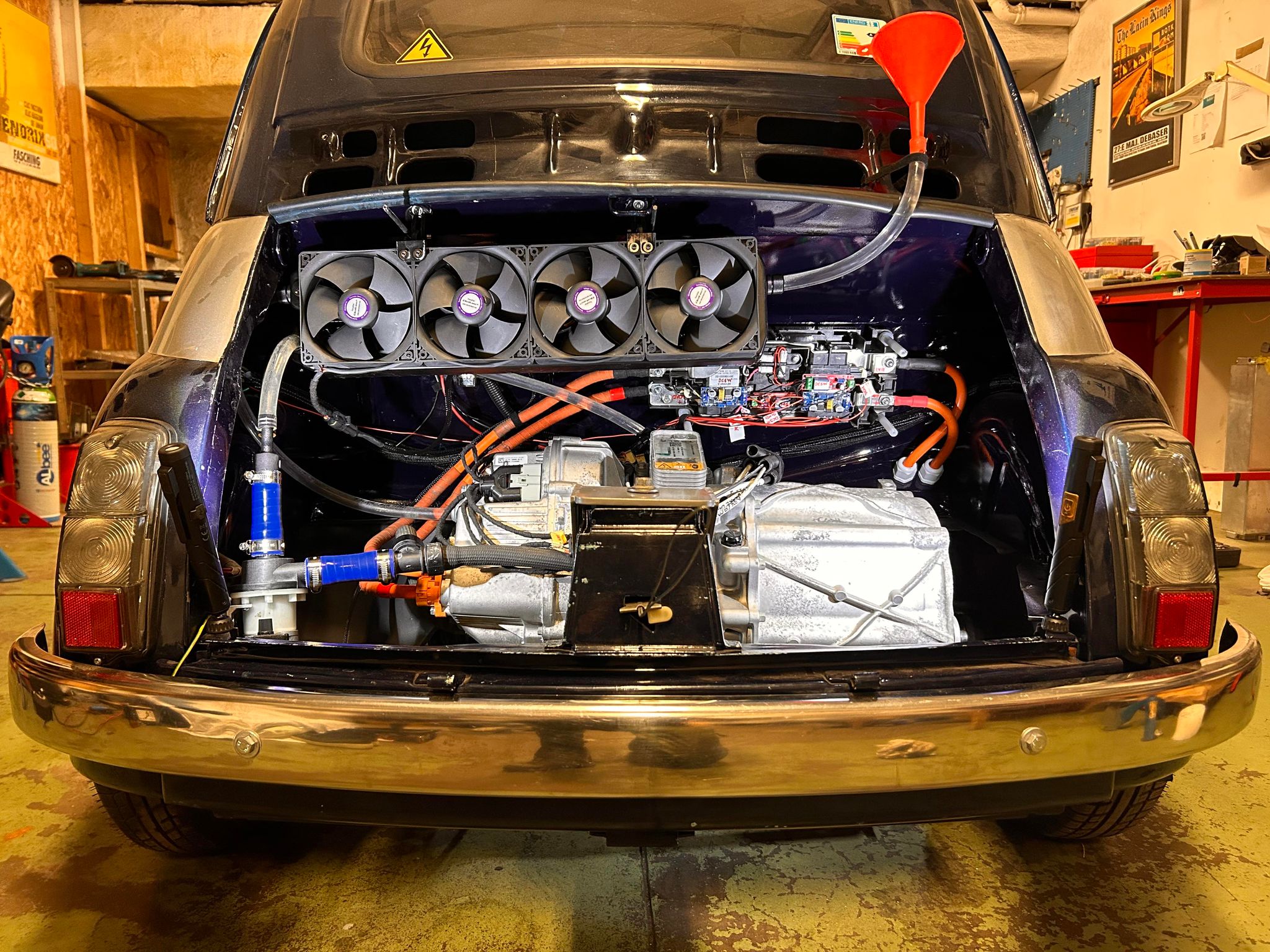

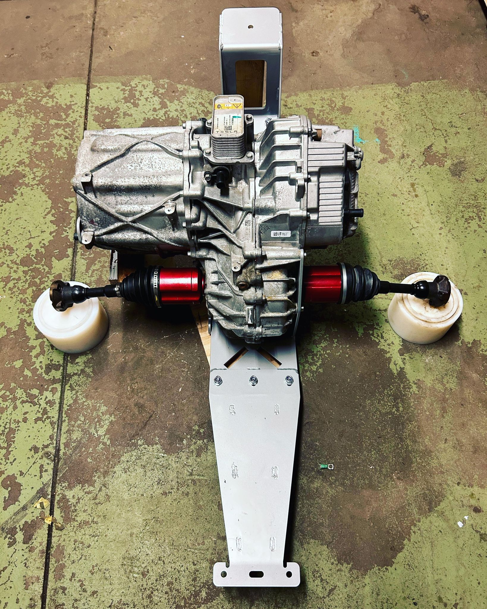

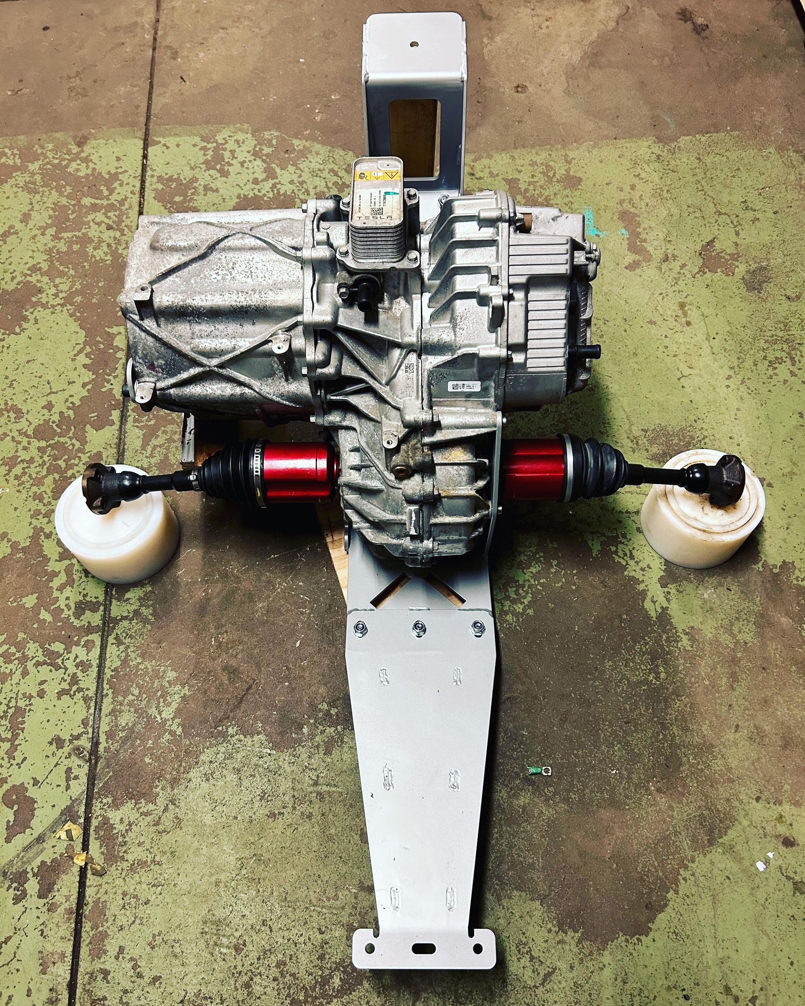

Luigi was first converted back in 2012 using a Agni 95R + Kelly. I decided to upgrade and went for the Tesla SDU.

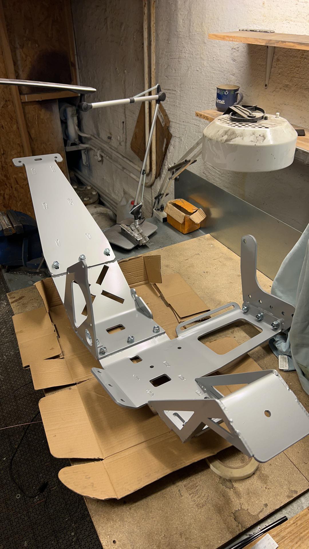

The hardest part so far was CAD-ing up the motormount.
More info on intagram.com/wildtech.eu
Today i did the first test using 100V, Two 12S MEB-modules. Feels good.

@200V (48S)
