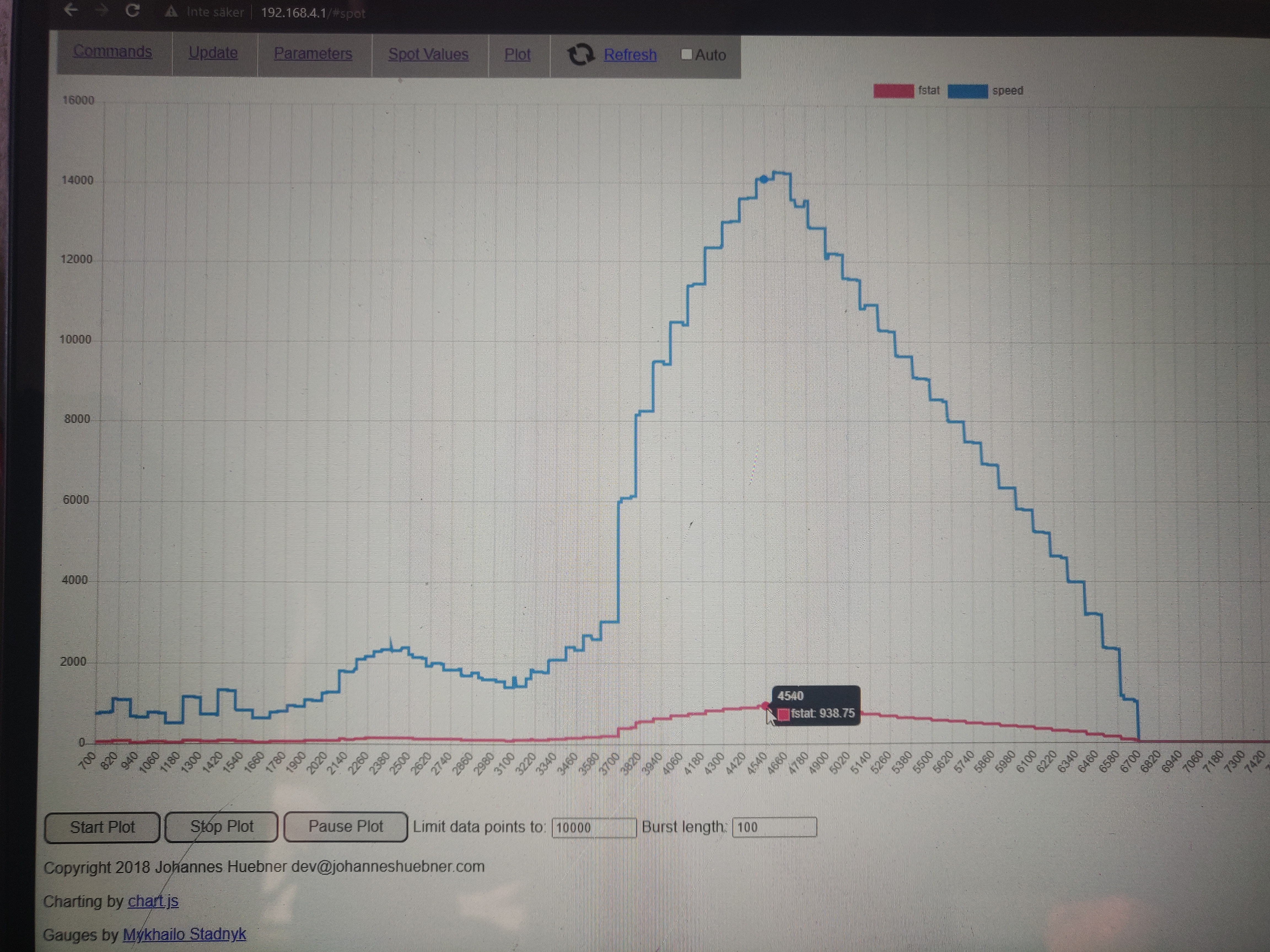

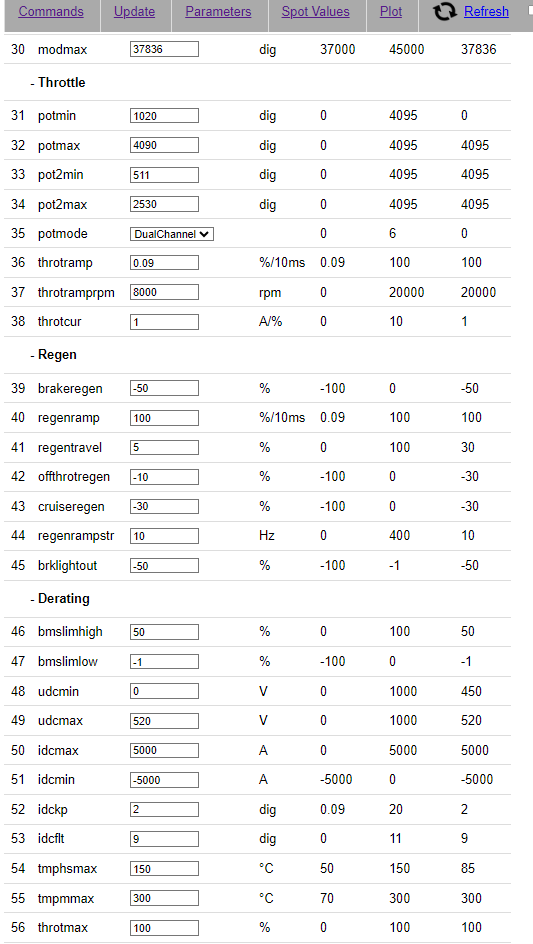

I have the throttle working. If I press the throttle too much the motor goes into 16000 RPM or 1000Hz and stays there until I cut the power.

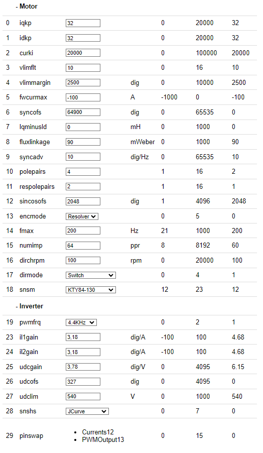

I am sure it's a parameter, I have tried to limit the Hz with "fmax" to 200 Hz, but it still goes to 1000 Hz.
Also, "throtramprpm" set to 8000 it still goes to 16000 rpm.
I have tried changing "throtramp" to 0.09 but it still can go to max speed.
Here is a video of the problem:
I thought that maybe "syncadv" could be something I need to change but after reading the description I didn't want to mess with it without making a post here because it says it's "SUPER DANGEROUS!"

Known problem unfortunately. With field weakening the motor can spin up without throttle input. Torque will be low but enough for an unloaded motor to spin up. Set fwcurmax to 0 while bench testing

johu wrote: Sun Aug 13, 2023 3:04 pm Known problem unfortunately. With field weakening the motor can spin up without throttle input. Torque will be low but enough for an unloaded motor to spin up. Set fwcurmax to 0 while bench testing
That did fix the issue, but now the motor is limited to around 4000rpm even though I increased the rpm & Hz limit. I assume this is just test bench issues and that it will work better in the car. I wonder what is the actual rpm limit for the Prius gen 2 gearbox? Was planing on setting it to 8000rpm, so it's not more than a combustion engine. My plan is to run my BMW from the shaft normally connected to the Prius engine to a gearbox, haven't heard of anyone doing it this way, I will weld the plantery gears like people do when they are going to use both mg1 and mg2 to drive the car, and then it should work I figured.
