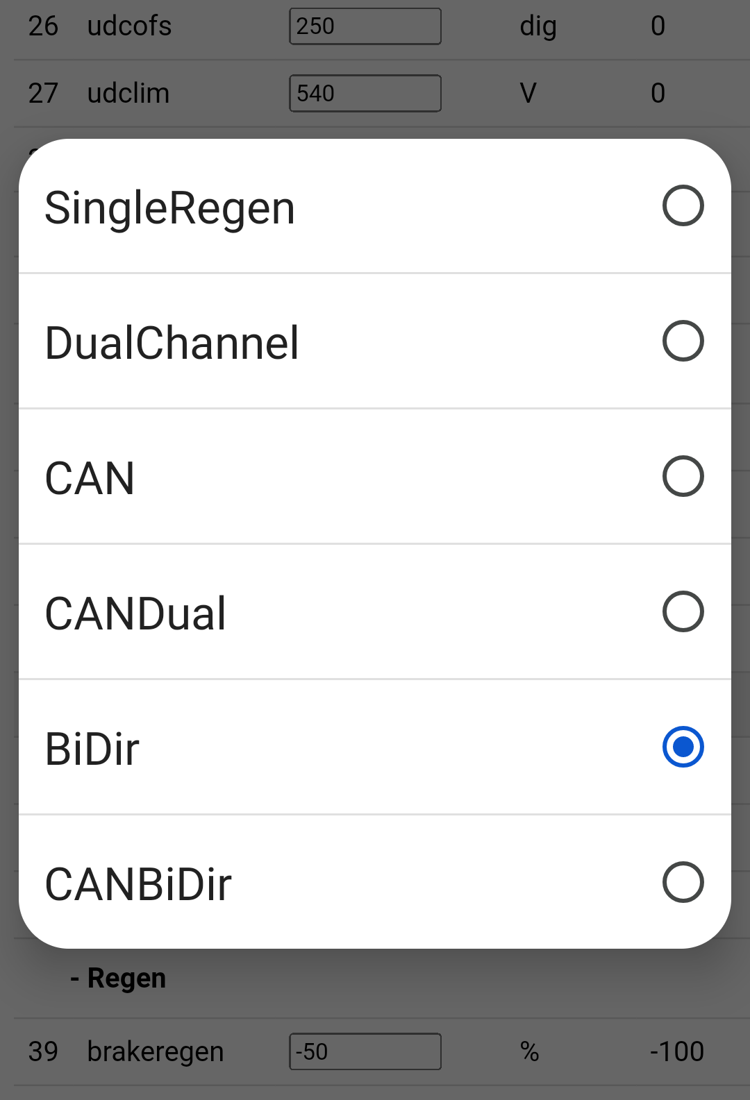

hello, people! I have such a question, in the case of using bidir mode, is it possible to hold the hill in both directions or not?

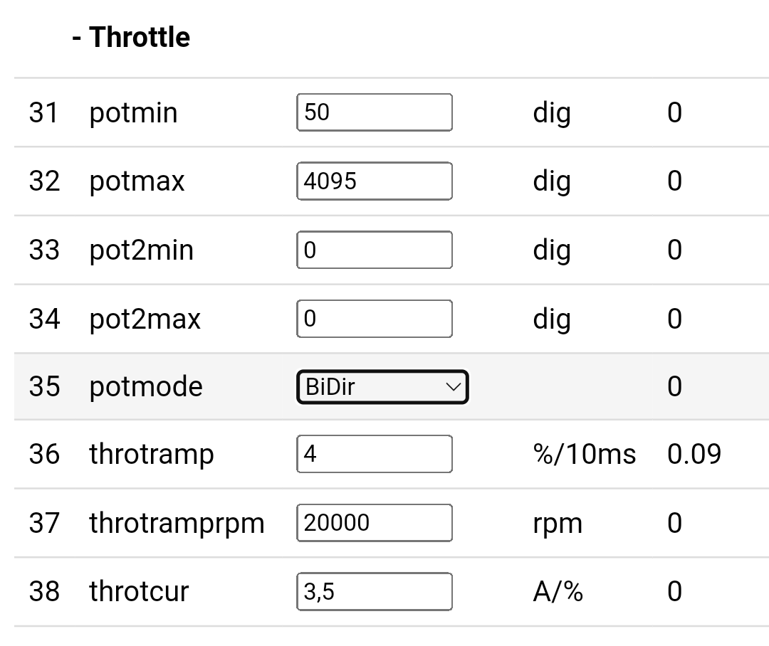

also, do I understand correctly that the average value of the throttle should output 1.65 volts, the maximum forward 3.3 volts, and the maximum backward 0 volts?

Romale wrote: Fri May 12, 2023 9:37 pm hello, people! I have such a question, in the case of using bidir mode, is it possible to hold the hill in both directions or not?
Not tested, but in theory it should do just that.
Romale wrote: Fri May 12, 2023 9:39 pm also, do I understand correctly that the average value of the throttle should output 1.65 volts, the maximum forward 3.3 volts, and the maximum backward 0 volts?
No, calibration as always, midpoint is 0 throttle

johu wrote: Sat May 13, 2023 6:58 am No, calibration as always, midpoint is 0 throttle
strange. I connected a 5kohm variable resistor and the motor stands still when the middle position. I connected a voltmeter and yes, the voltage of the middle is 1.65 ! and a full 0 volt output (leftmost position) gives the maximum motor speed in the opposite direction

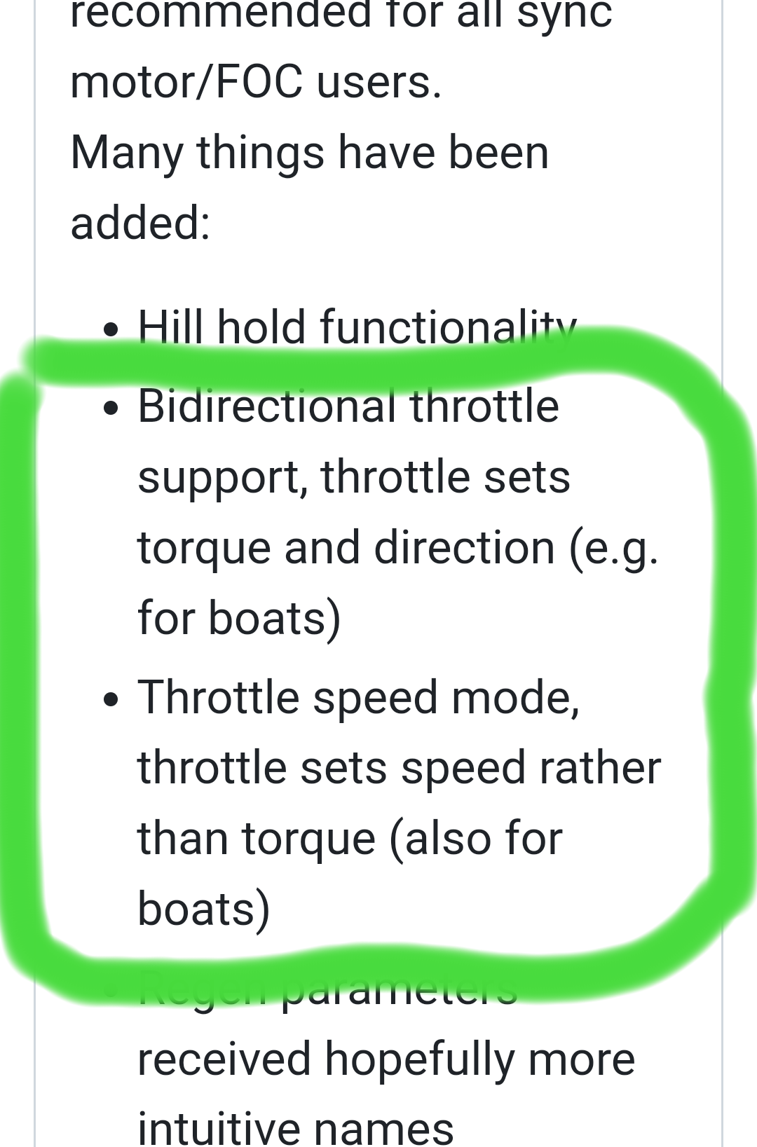

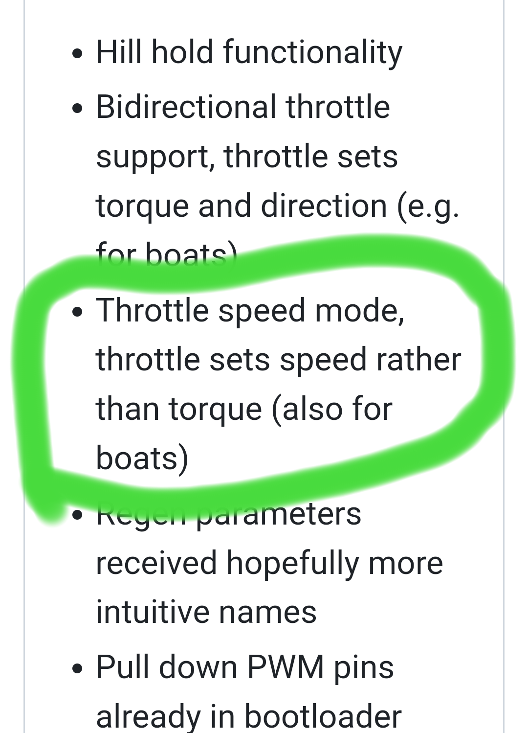

Throttle speed mode, throttle sets speed rather than torque (also for boats)
this part of the description interests me))
bidir mode works fine.
but he controls the moment. it is not very convenient for rotating the propeller under water.
the described ability to control the number of revolutions of the motor instead of the torque would be ideal.
but how to turn it on?
evil neodymium :twisted:
Posts: 6709
Has thanked: 368 times
Been thanked: 1536 times
Re: question about bidir pedal control
cruise control = speed control ;)
For a propeller it does work with speedflt=0 and speedkp=0.1, tested before on a boat.
