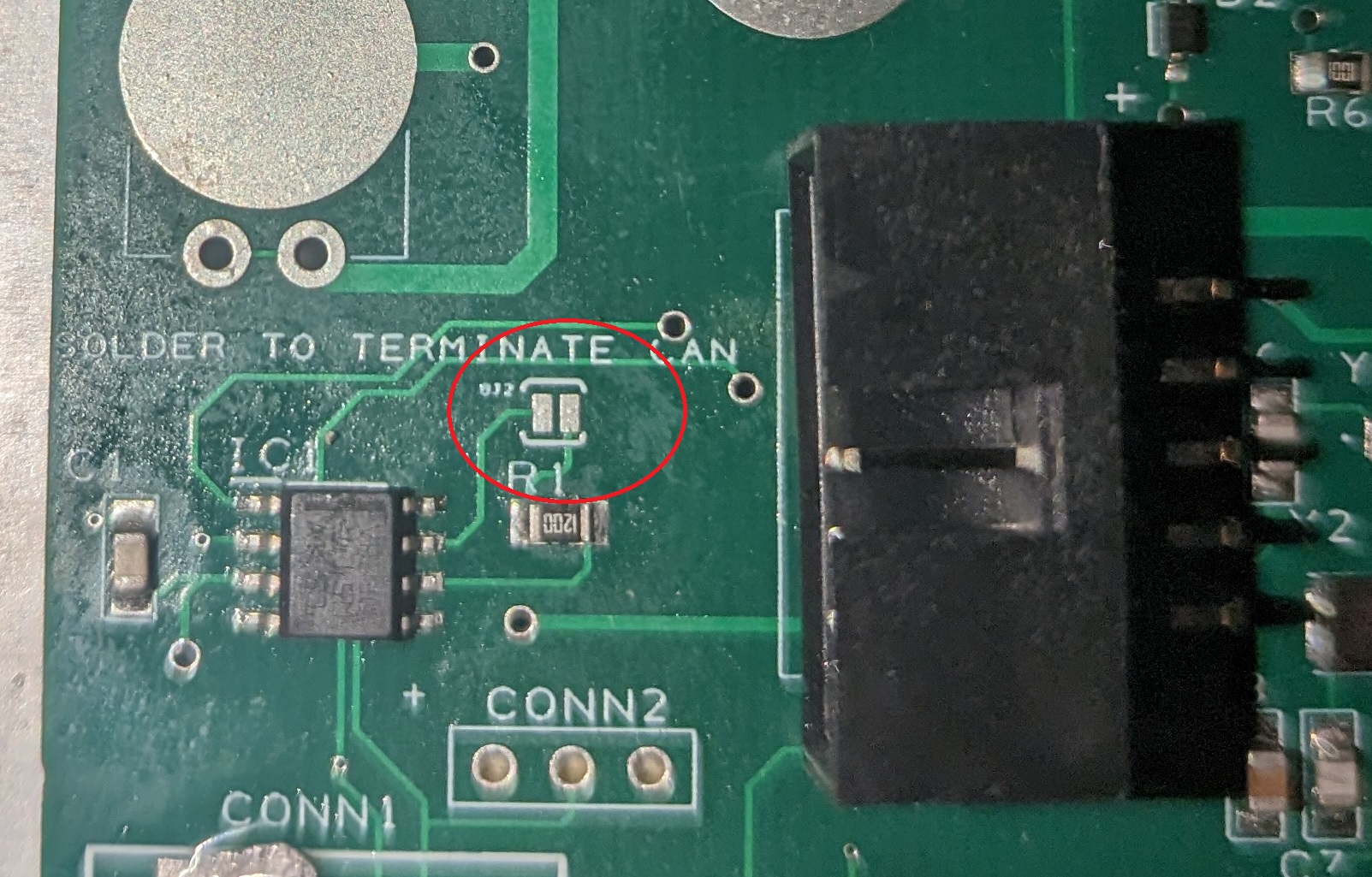

If I am using the ORION BMS to manage my batteries, I assume I really do not even need to communicate with the charger via CAN bus. I am currently wired into the charger CAN bus inputs (B4 and B10) from my original setup with V4, but will abandon this or cut those wires out if they are not necessary. If so, from the Wiki page, it sounds like I also need to solder the connection above R1 to take the CAN bus out of the picture.
If you do NOT use the external CAN bus on that version remember to close the solder jumper next to R1 under the WiFi module.
Can someone confirm this is what I need to do to take CAN bus out of the equation for my set up? I assume after I do this, I no longer need to remove the 120 ohm built in resistor that would mess with my existing CAN bus wiring that has 120 ohm resistance at both ends (Charger is somewhere in the middle of all of this).
