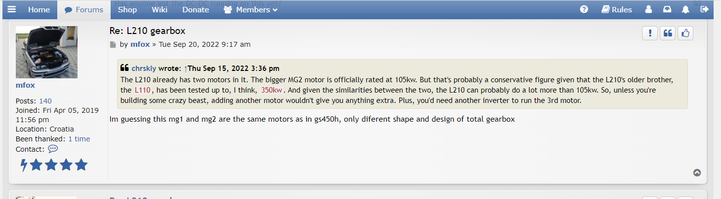

Sorry for jumping into the topic. I have a question. According to the wiki, the GS300H has 105 kW, but it seems like a big difference compared to the 227 kW that the GS450H has when the MG1 input shaft is locked. Is it a mistake on the wiki, or is the GS300H half as powerful as the GS450H?
- Posts: 2962
- Has thanked: 330 times
- Been thanked: 848 times
Re: L210/GS300H (or IS300H?) transmission max rpm
The power listed for the GS300H transmission the L210 is the drive motor MG2 power. There are no real figures available for the MG1
the GS450H MG2 power is rated at 147-165kw.
https://toyota-club.net/files/faq/21-12 ... n.htm#L210
Thanks tom91, let's see if anyone comes with real meassures, as GS450H has reach 350kw on test.
- Posts: 2962
Hi Tom91, to be hones, I took these numbers from one comment in this forum, see image above. I would prefer to use L210 as per the oil pum, but in otherhand I want as max power as I can obtaing as the donnor vehicle will be heavy old one.
Any advise?
Any advise?
- Posts: 2962
No facts in that comment just a guy pulling numbers out of his ass.Tachopis wrote: ↑Mon Dec 11, 2023 9:08 am image.pngHi Tom91, to be hones, I took these numbers from one comment in this forum, see image above. I would prefer to use L210 as per the oil pum, but in otherhand I want as max power as I can obtaing as the donnor vehicle will be heavy old one.
Any advise?
Buy what you can get, GS450H is a well proven setup and quite some documentation about and should be more powerful then the GS300h L210.
Given that the GS300H is an easier install and should be more available.

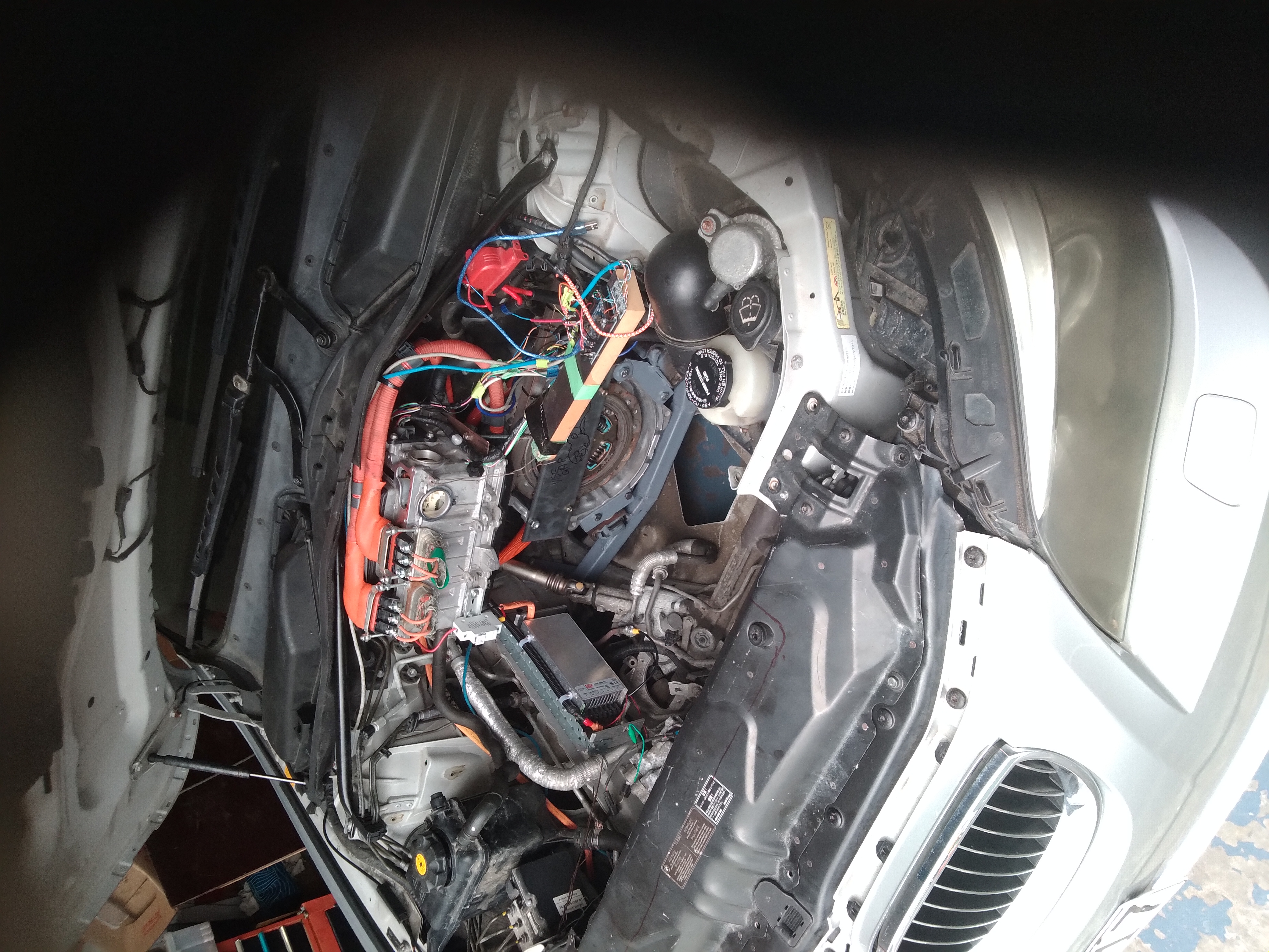

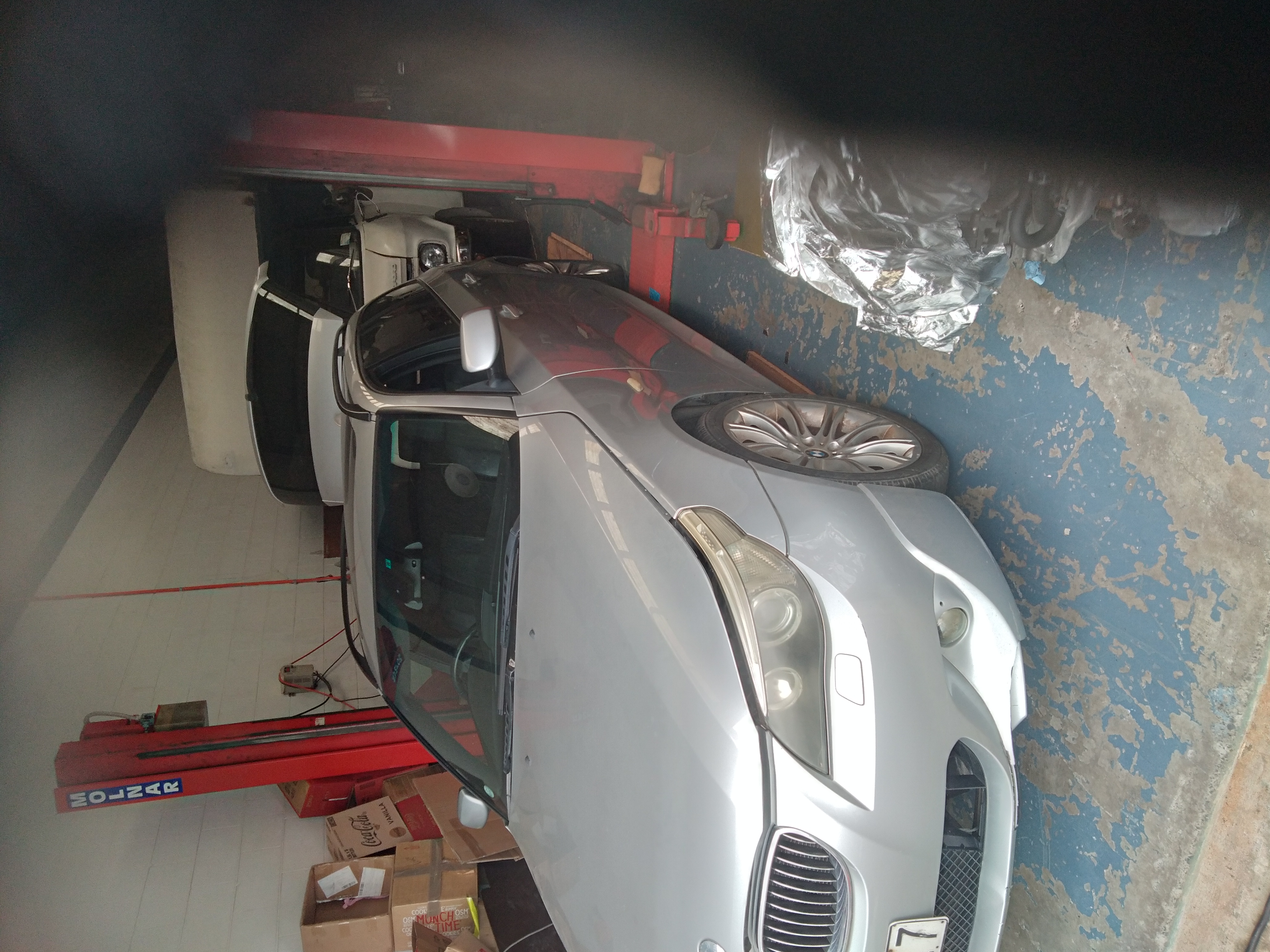

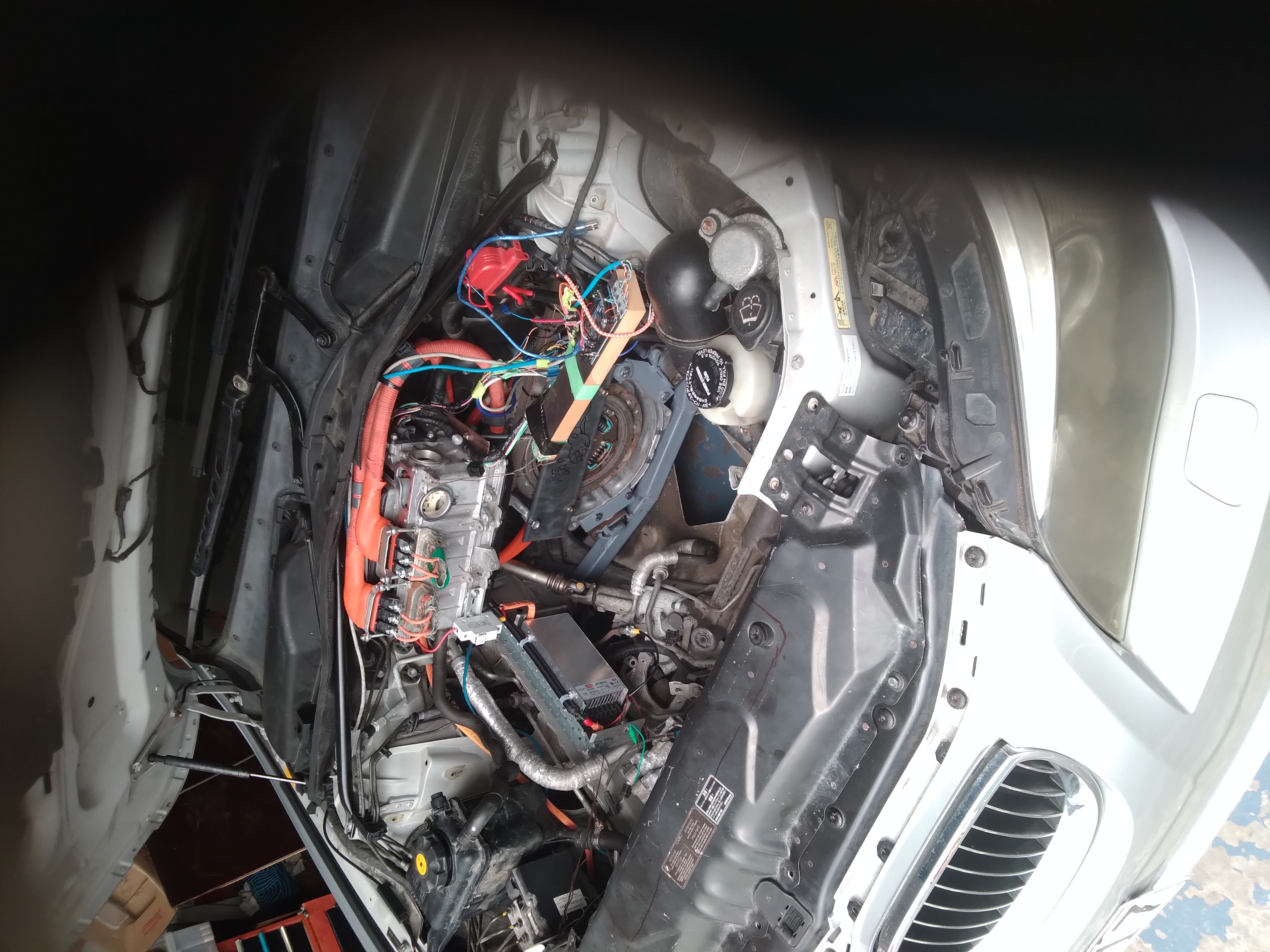

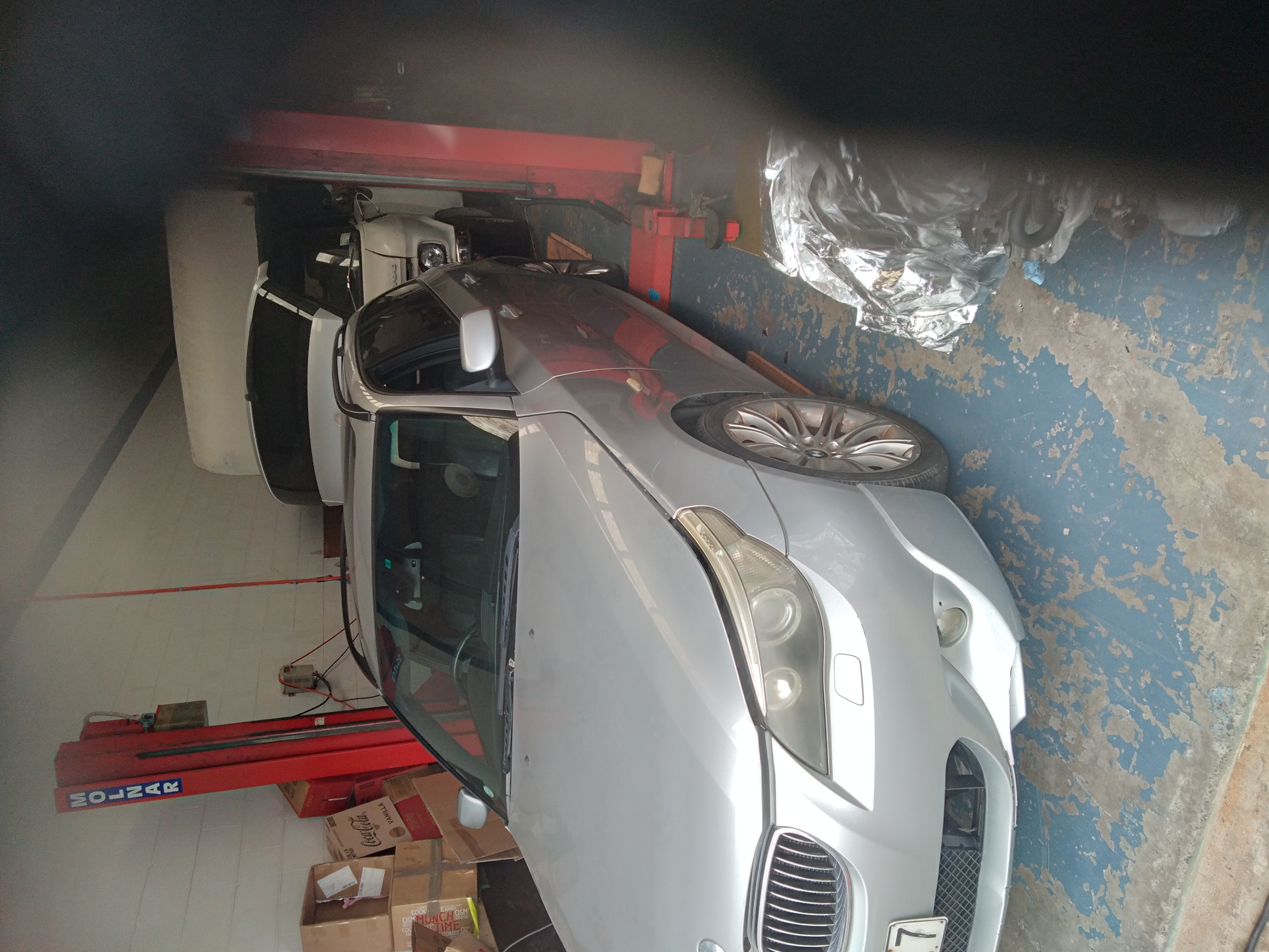

Re Bmwagon,
L210 trans , using Mg1 and Mg2
Prius zvw30 inverter,
76cells from Imeiv ,
Bmw E 61 I think was marked on driveshaft 2.7 diff,
Approx 26" tyre OD.
290v, around 90A observed max so far drawn on 5km trip
Also an indication of 34kw, which would be 115Aish.
Max speed on today's test run was 65kph, limited by traffic, an open road run is planned, but now rain has stopped progress. Aiming to find working limits.
Figure was around 4000rpm Mg2 speed.
Had struggled to find much information on the L210, so hence figured some trialing required.. Goal is to use this trans in a Soarer, where the L110 looks to bulky to fit the tunnel. In the absence of an available 300h inverter, a modified zvw30 inverter which are freely available some with faulty Boost converter, which is bypassed, seemed a good idea,
I did see on some post that 85kph had been achieved, can't find the post to re read, could anyone point me to it please.
Have worried the neighbour, who had glanced into the empty engine bay a short time before testing, and was aghast, stating emphatically But it's got no Engine.
I added , yes could take it to BMW and say think have a few cylinders missing!
Hope this information may help for anyone

- marcexec
- Posts: 239
- Location: Dublin, Ireland
- Has thanked: 1042 times
- Been thanked: 111 times
Nice!
Where are you hiding the batteries currently?
Also I think you should beef up the small connecting wires, they look like they are 6mm2 max.

Woodfie
- Posts: 242
- Location: Auckland NZ
- Has thanked: 221 times
- Been thanked: 96 times
Batteries are in the rear luggage at this stage for trialing .
This vehicle was intended as a mobile test bench, aimed at assessment of suitability for use in another vehicle, a Toyota Soarer, or Lexus 430scv.
The linking wires are a chopped off loom that came with the inverter plugs, and yes was stunned at how small they are inside the standard car, as you saw looks like 6mm□. and far too light.. But as is size used by Toyota, have pressed into service, and monitoring temp .
