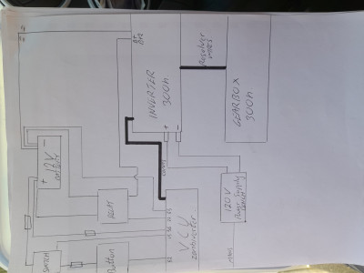

Hi, bench testing my 300h transmission/inverter using zombieverter and unable to get it to spin. Have checked and triple checked all wiring using wiki and still nothing. I am using a 120volt bench power supply for inverter and a 12 volt battery for the vcu. When I switch ignition on it shows in the Web interface that t15 is on and when I press start opmode will show precharge for 5 seconds and then back to off.
INVude =122v
Uaux =12.9v
InvStat = Off
Am I doing something silly ?

You'll need to provide more info for anyone to be able to help you I'm afraid.
Pictures of your setup, some diagrams of your wiring, any messages from the OI interface, a copy of your params.

Post by royhen99 »
Shouldn't B+ and B2+ be connected to 12V? Your diagram appears to have them connected to battery -ve.

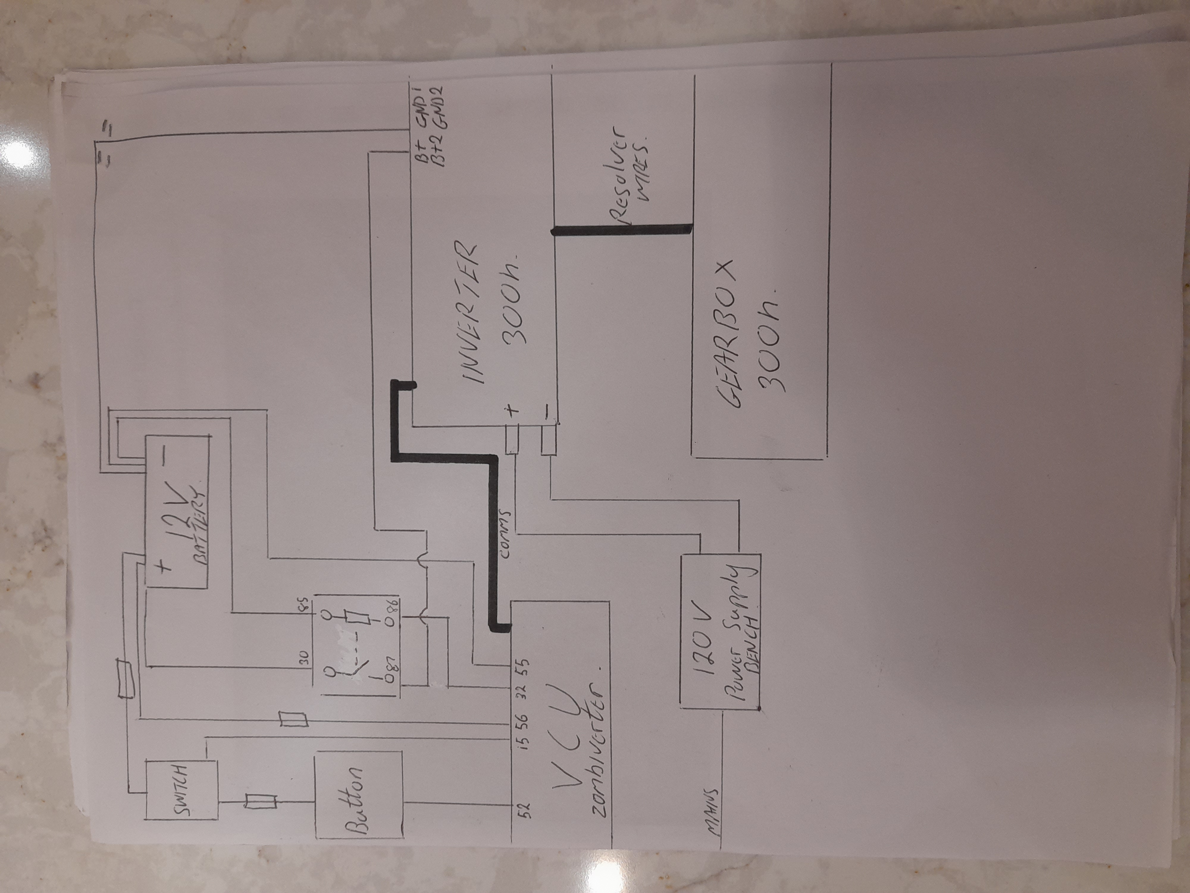

royhen99 wrote: Thu Apr 06, 2023 3:31 pm Shouldn't B+ and B2+ be connected to 12V? Your diagram appears to have them connected to battery -ve.
Amended diagram
Amended diagram

Post by royhen99 »
Pin 32 of VCU is a low side switch so I assume the 12V on the relay is connected to the coil. In that case the relay is connecting bat -ve to B+ and B2+.
Maybe the drawing just isn't very clear, relays should really have the coil and contacts/switch shown.

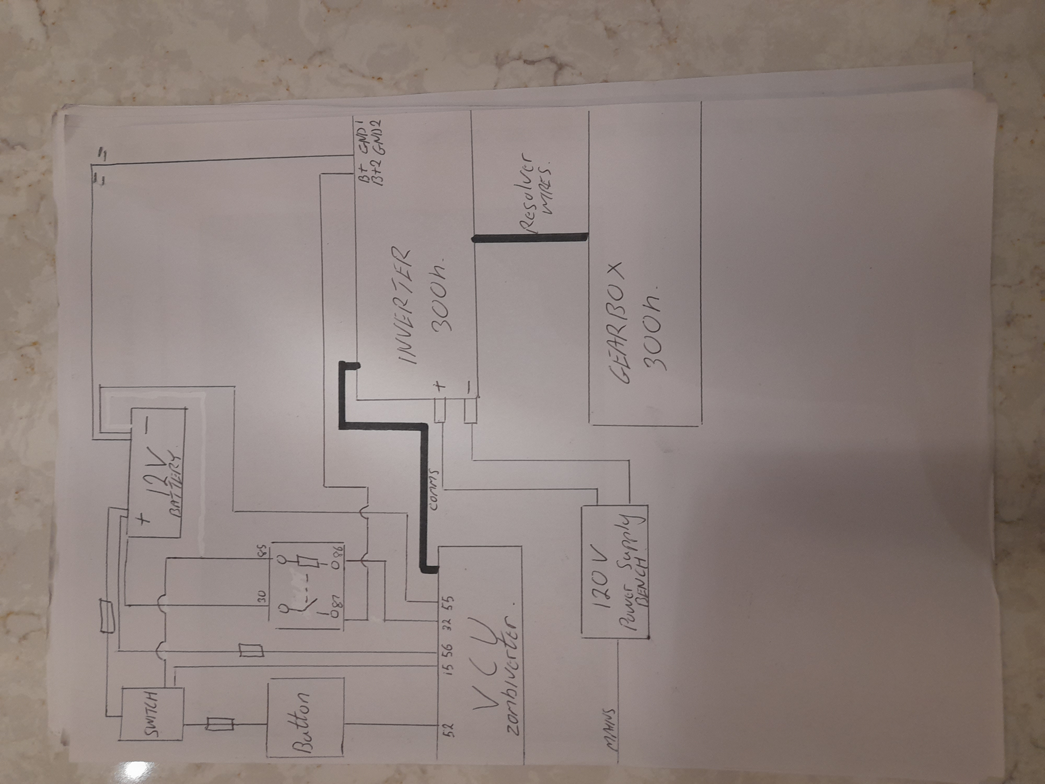

royhen99 wrote: Thu Apr 06, 2023 8:20 pm Pin 32 of VCU is a low side switch so I assume the 12V on the relay is connected to the coil. In that case the relay is connecting bat -ve to B+ and B2+.
Amended. Drawing skills not great

Post by irsjohnk »
Like royhen99 said the pin 32 is low side switch so your relay needs a positive on the coil.

Re: Lexus 300h trans not spinning
Post by royhen99 »
Coil needs connecting to 12V.

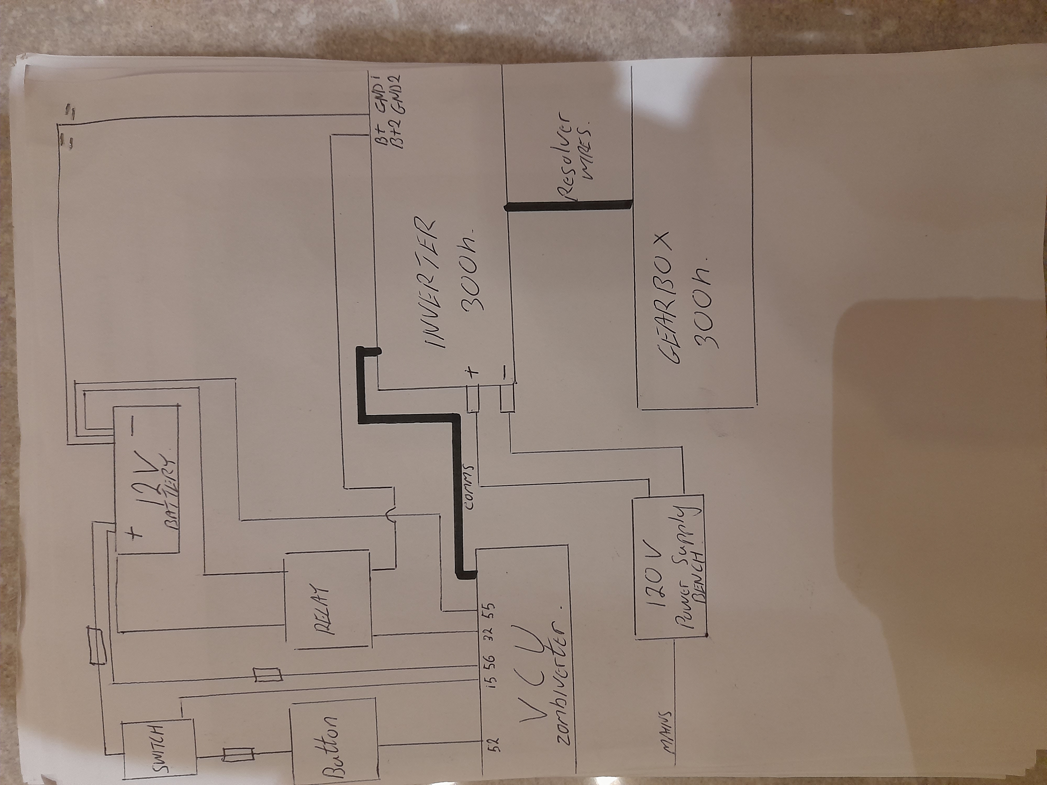

royhen99 wrote: Thu Apr 06, 2023 9:24 pm Coil needs connecting to 12V.
Diagram amended. Checked relay and wiring was correct.

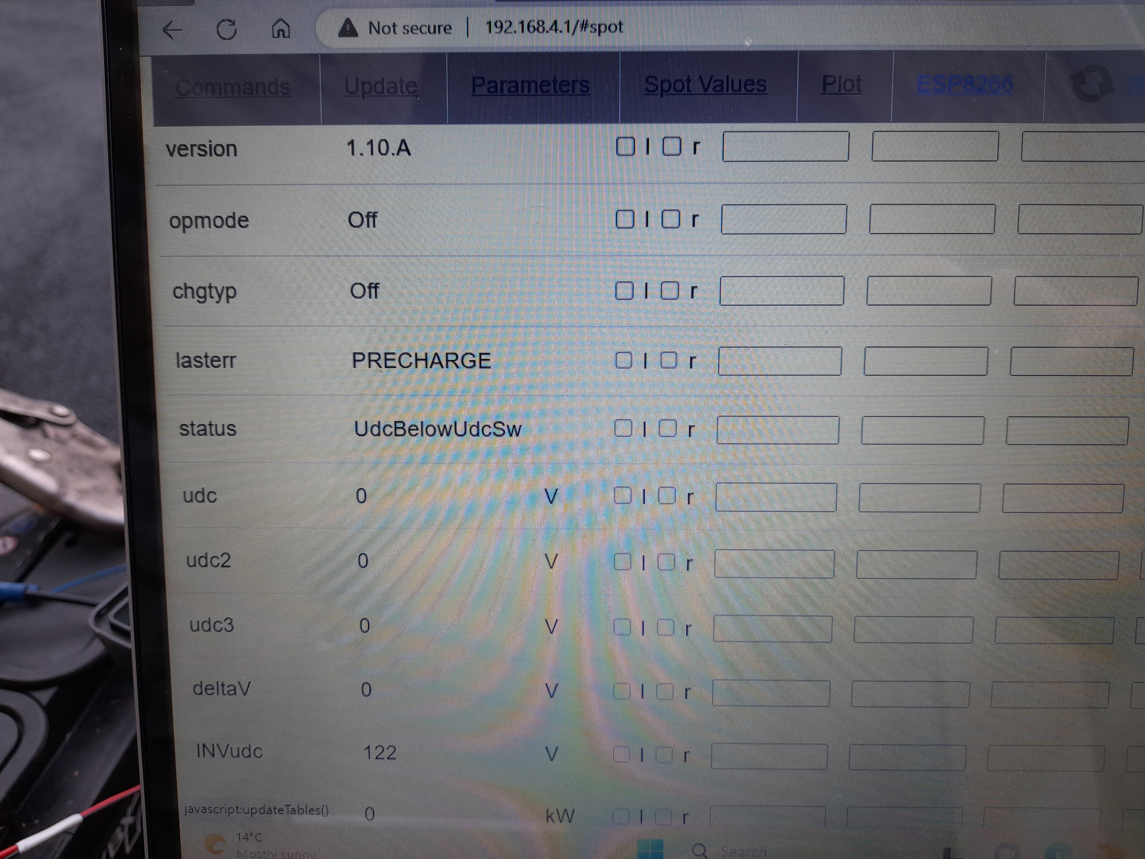

Post by Beemer »
Aragorn wrote: Tue Apr 11, 2023 8:13 am and what is lasterr and status showing now?
Lasterr = precharge
Status = udc below udcsw
Opmode = shows precharge for 5sec and then back
to off.
Post by Aragorn »
So its still not happy about the udc readings, which come from the IVT. I dont know if its possible to bypass that.
Post by Aragorn »
if udcmin is still at 50v then that very likely wont work, because udc is at 0. You can try setting udcmin to 0v as well?
