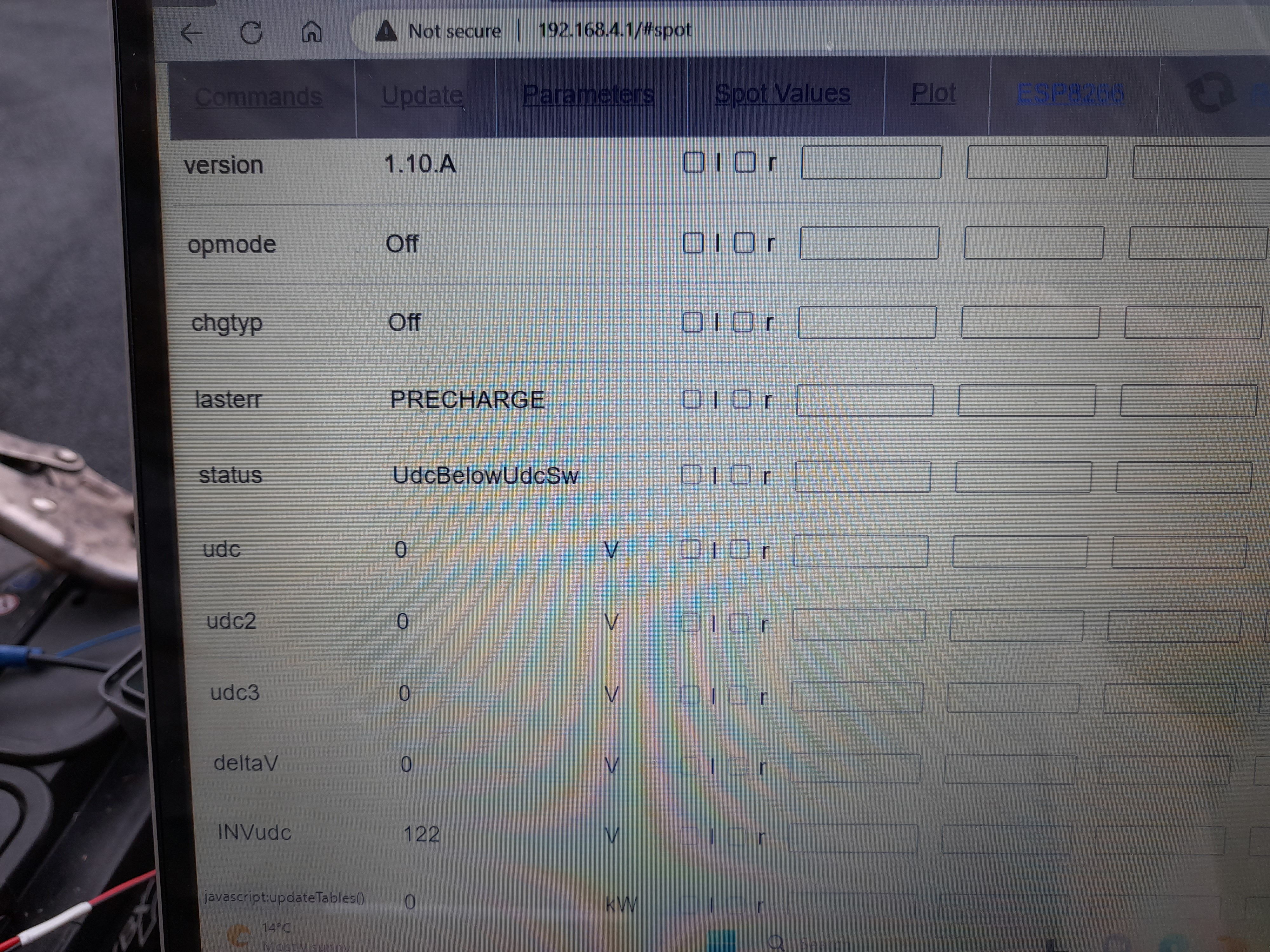

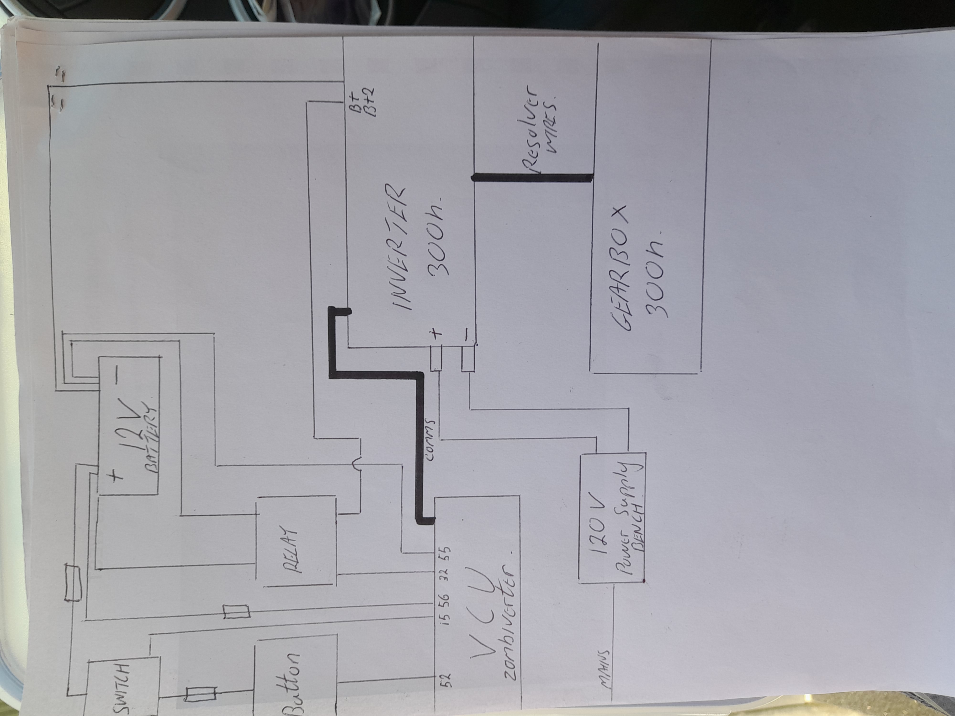

Hi, bench testing my 300h transmission/inverter using zombieverter and unable to get it to spin. Have checked and triple checked all wiring using wiki and still nothing. I am using a 120volt bench power supply for inverter and a 12 volt battery for the vcu. When I switch ignition on it shows in the Web interface that t15 is on and when I press start opmode will show precharge for 5 seconds and then back to off.
INVude =122v
Uaux =12.9v
InvStat = Off
Am I doing something silly ?
INVude =122v
Uaux =12.9v
InvStat = Off

what is lasterr saying?
udcmin/udcsw?
as above you need to provide more detail.
udcmin/udcsw?

Shouldn't B+ and B2+ be connected to 12V? Your diagram appears to have them connected to battery -ve.
royhen99
- Posts: 265
- Location: N. Wiltshire. UK
- Has thanked: 22 times
- Been thanked: 134 times
Re: Lexus 300h trans not spinning
Pin 32 of VCU is a low side switch so I assume the 12V on the relay is connected to the coil. In that case the relay is connecting bat -ve to B+ and B2+.
Maybe the drawing just isn't very clear, relays should really have the coil and contacts/switch shown.
- irsjohnk
- Posts: 11
- Joined: Sat Jul 23, 2022 11:58 pm
- Location: Vancouver USA
- Has thanked: 2 times
- Been thanked: 3 times
Like royhen99 said the pin 32 is low side switch so your relay needs a positive on the coil.

udc is reporting 0v?

I dont see a shunt at all in your block diagram as well as the missing precharge components?

As I am only doing a simple bench test to get trans/ motors spinning I was under the impression that precharge components and the shunt were not needed at this stage but please correct me if I am wrong.Aragorn wrote: ↑Fri Apr 07, 2023 8:09 am udc is reporting 0v?

You will need to set udcsw to 0V otherwise as stated above there is a 5 sec timeout. Only do this if you can limit the power supply output current to say 10A, otherwise the inrush current could be too high.
Udcsw set to 0v which has deleted the 5 sec time out and still no inverter whine .
I can't see an IVT shunt. The Zombieverter will look for an hv signal when precharge is energised. If it does not see HV on the canbus from the shunt the inverter will not be turned on by the Zombieverter.
Hope that helps
Was not aware that the shunt was needed when doing a basic bench test. Will try connecting up my ivt and report back.
Lasterr = precharge
Status = udc below udcsw
Opmode = shows precharge for 5sec and then back
to off.
Have videos but unable to upload at the moment as website does not except. MP4 format.
So its still not happy about the udc readings, which come from the IVT. I dont know if its possible to bypass that.
