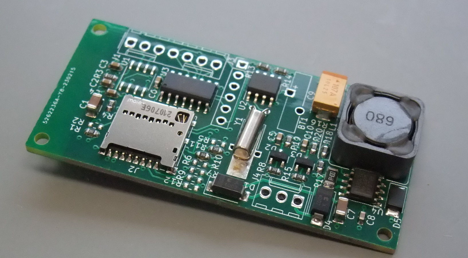

I've designed a PCB based around an ESP32-WROOM-32E that is intended to provide a remotely mounted version of the web interface WiFi module:
The idea is that this lives outside the inverter (not mounted on the control board). This should give better WiFi signal strength, reduced electrical interference and make it easier to access the module if OTA updates stop working (it also makes it easier to get at the SD card).
It has two communication interfaces, RS485 and CAN bus. At the moment the CAN bus isn't supported in the firmware (the CAN hardware isn't tested either as I don't have a suitable chip handy!).
It also has an SD card on it to allow data logging and a real time clock to time stamp the SD card files.
The PSU, ESP32, RS485 and RTC (except for backup battery which I still need to order) are tested and working. The CAN interface hasn't been tested yet. To use with a standard OpenInverter board it will need an small RS485 interface board making to go in place of the normal WiFi module (essentially the ISL83076E block from this board plus a plug to fit with the normal WiFi module header). If there is enough interest I'll do a quick Kicad design for one.
The board is designed to accept Molex KK headers but 2.54mm pitch screw terminals may fit (untested). I intend to solder wires directly to the board on mine.
There are a few more details on using it in the github readme.
The Kicad design is here : https://github.com/Pete9008/RemoteESP32-Board
The firmware is here : https://github.com/Pete9008/esp32-web-i ... /Remote485

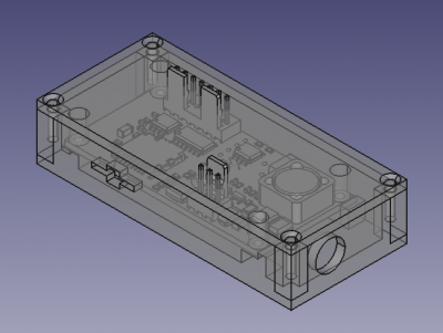

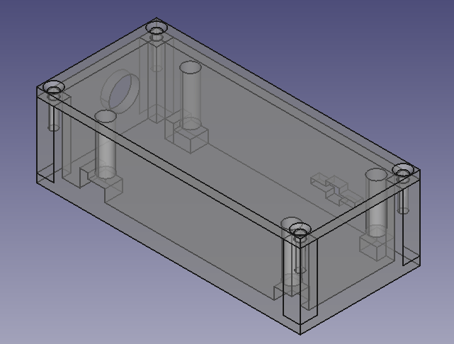

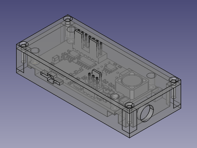

Git repository updated to include models for 3D printable enclosures.
There are two there, a slimline one I did before realising that the RTC battery wouldn't fit inside it! It might be useful to anyone not using logging and the RTC though so have included it anyway:
And a larger one that tha battery will fit in (this one is a bit bigger than I'd like so may have another go at it with the recesses for battery and ESP32 to reduce the height a little):
Both are designed to take a rubber grommet strain relief (9mm hole) and are not designed to be sealed and print fine.
Note - This is the first design I've done with both FreeCAD and constraint based design so I very much doubt that it's the best way of doing it!
Edit - Worth noting a few things that I'd change if doing the PCB again:
  • Add a couple of LED's!
  • Change from a push/pull to a push/push SD card holder and mount it a little closer to the board edge (I already had this socket and had originally planned on just heatshrinking it rather than having a case).
  • Use a different form factor inductor in the PSU (again this is a part I already had spare but it is a bit big and over specced for this application).
  • Possibly add/replace the battery with a permanent 12V feed and a uPower regulator (a battery is more convenient for development, a permanent supply is better for end use)

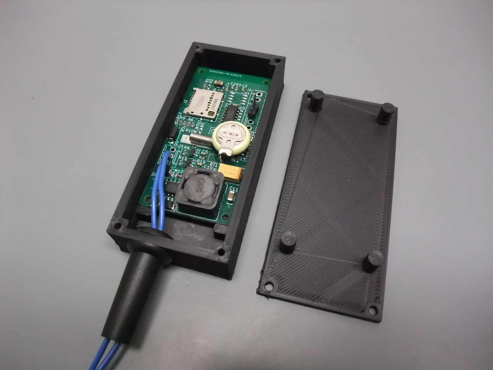

Quick update, wasn't happy with the larger case, just a bit too bulky. However, a little bit of reworking of the battery pins gets it to fit into the smaller case:
Needs a little hot glue or sealant between the battery and PCB to give it some additional support but should be OK. Was a little worried that the battery was discharging too quickly but have double checked the calcs and it should be good for years. Have cleaned all the flux of the board in case there was some leakage current and am keeping an eye on it to see if the voltage stabilises.
If there is a rev2 I'll change to a smaller surface mount crystal which should create enough space to change to a battery that lays flat as standard.

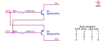

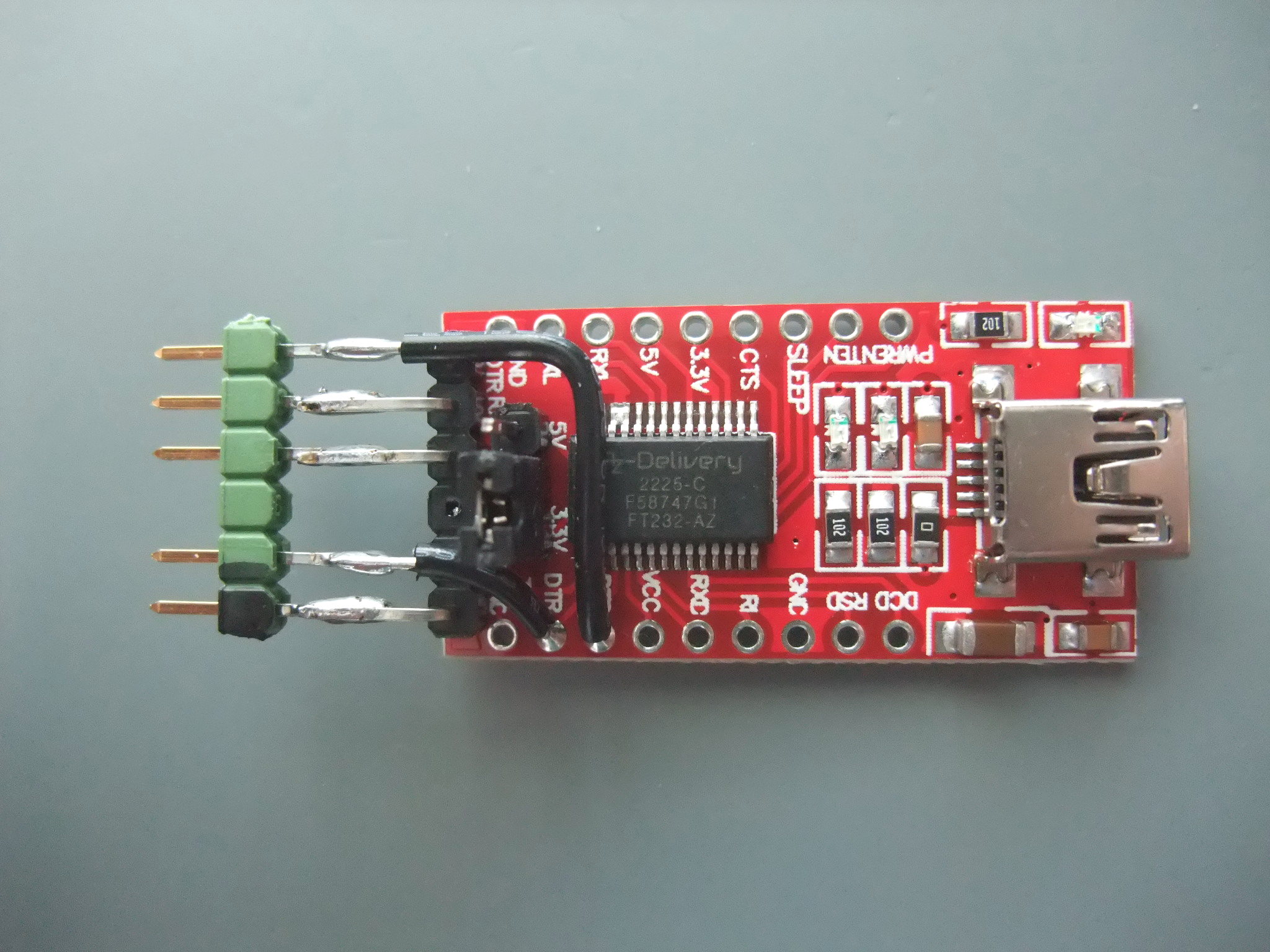

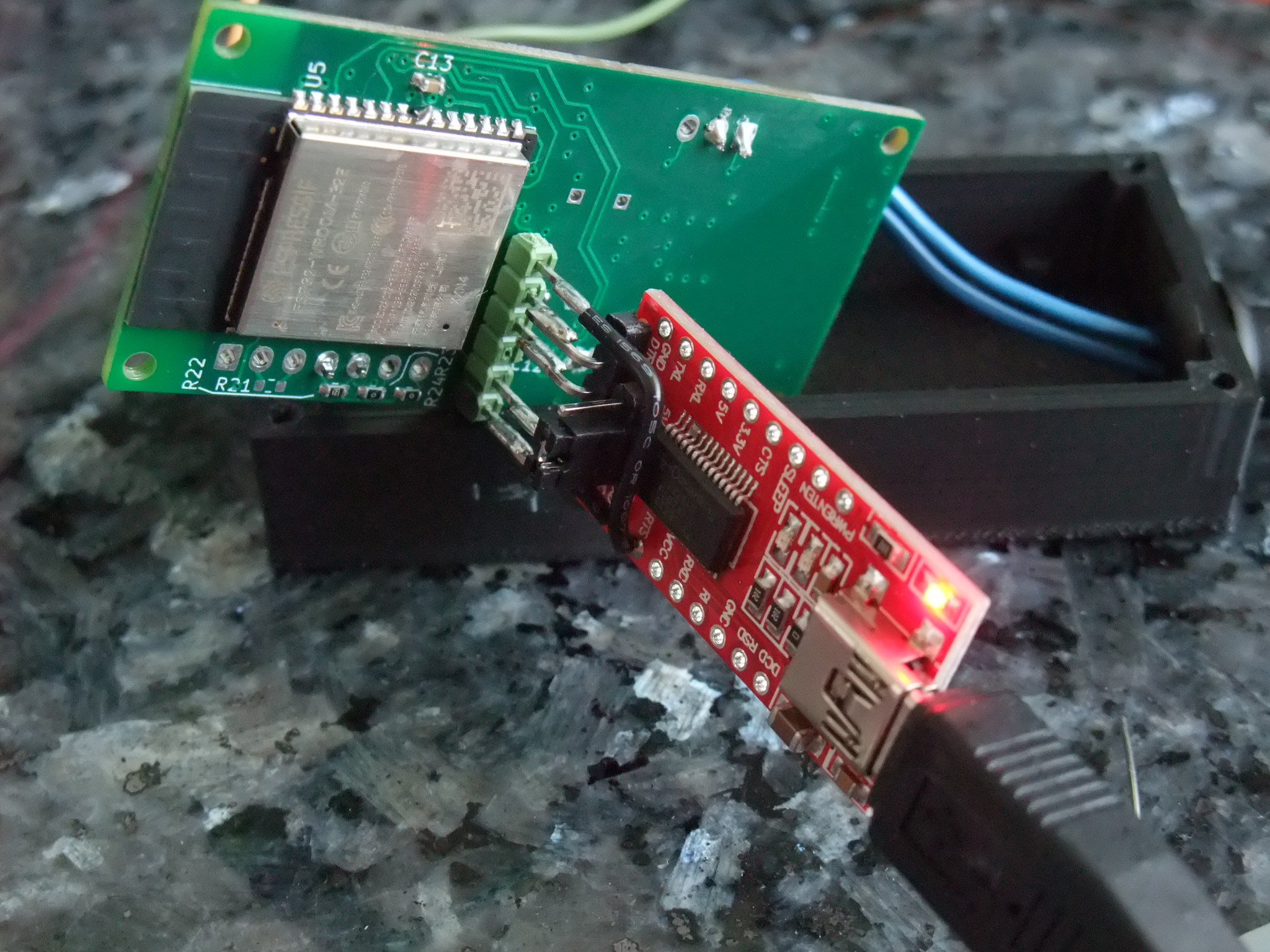

Got fed up of my old programming lead which needed manual intervention to switch the IO0 line to put the module into programming mode before programming and then again to switch it back before running so have come up with a better solution:
It uses an FT232RL based USB to serial TTL converter. These chips have both DTR and RTS lines on them, the DTR line goes to GPIO0 and is used to put the ESP32 into bootloader mode on reset while the RTS line goes to EN and applies a reset pulse to start the bootloader. You can just about see in the picture that GND, Rx and TX are in the right places on the module header but the other pins have to be isolated and wire links used to connect pin2 to DTR and Pin6 to RTS (pin1 is the bottom one, coloured black, in the picture).
With this done and the programmer plugged into the ESP board:
The esptool (used in PlatformIO and Arduino for ESP32 programming) will automatically drive the lines to put the ESP32 into programming mode before programming it. When not in programming mode the two lines are inactive allowing the ESP32 to run normally.
One slight pain is that when using serial monitor window within PlatformIO it drives the two lines active so holding the ESP32 in reset. To get round this click into the serial monitor window and do a Ctrl-T, Ctrl-D, Ctrl-T and Ctrl-R to take the two lines inactive. There are monitor configuration flags that are supposed to do the same but I haven't been able to get them to work so far. The Ctrl-T, Ctrl-R sequence (used twice) can also be useful to reset the ESP32 from the monitor window. Guessing the same problem may be there from the Arduino monitor window but haven't tried it.
This should work for programming any ESP32 based board but obviously the header pinout may change!

Pete9008 wrote: Tue May 16, 2023 9:28 am One slight pain is that when using serial monitor window within PlatformIO it drives the two lines active so holding the ESP32 in reset.
There is a standard(ish) bit of logic fitted to most dev boards to tackle this problem:
This is from the Espressif ESP32-Core-Board-V2 eval board schematics. I've built such a thing into an FTDI FT232 based programmer for ESP32 programming using a header not unlike your design.

davefiddes wrote: Wed May 17, 2023 10:47 am
Thanks, I'm familiar with that circuit and have used it before but unfortunately didn't put the components on my board and couldn't be bothered putting them on the programmer (but it would be a better solution!).
I've now found the right config to get the PlatformIO monitor to behave without them. In the platformio-local-override.ini just add the lines:
monitor_dtr = 0
monitor_rts = 0
and it should behave (it will still give the ESP32 a brief reset pulse when the monitor starts but in some ways that's useful).
For the Arduino monitor I think you would need the transistor circuit though.
Edit - it would seem that there are similar lines in the Arduino ESP32 board definition that do the same for the Arduino serial monitor (https://arduino.github.io/arduino-cli/0 ... ification/). Not tried it but supposedly setting:
esp32s3.serial.disableDTR=true
esp32s3.serial.disableRTS=true
might fix it in there?? (the transistors still seems like a better solution though!)

davefiddes wrote: Wed May 17, 2023 10:47 am There is a standard(ish) bit of logic fitted to most dev boards to tackle this problem:
I've been reading about programming the ESP32 and found this 2 npn reference circuit. But it seems some are still running into programming issues and are adding a .1 - 1uf capacitor to the enable line to add a bit of a boot delay. That seems to fix the programming issues.
There are others that claim only the en capacitor is required to program the ESP32 (and that the 2 npn transistors aren't required.) This is how the current openinverter ESP32 boards are configured (just the en capacitor with a feed resistor for boot delay.)
Anyone that has tested both methods have any feedback on them? I'm working on the gen 3 leaf adapter board. It's currently setup with the enable capacitor / resistor (aka boot delay). Asking for that but the info should still help here.
