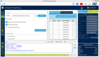

Hello,
Working on my first conversion, hopefully this isn't a stupid question--I don't want to waste anyone's time--but i have been looking around on the forum and haven't been able to figure out my issue.
I bought a completed dual motor gen 3 Prius Inverter board from Damien, but while following the wiki's instructions I (stupidly) started the STM32 Programming. Now I can't seem to get it working right. I am not getting the blinking LED or the wifi from the STM32. I have watched Damien's video on programming these boards and followed the instructions on the wiki.
Here is a video of me doing the procedure:
(2:26 min)
I am wondering if anyone can see something that I am doing wrong?
Could there be an issue with my ST link or my computer?
How easily could i have damaged the STM32?
I appreciate your guys' advice/time.
Thank you

I think you need to check the option "Skip Flash Erase" when doing the FOC upload, otherwise it erases the previously uploaded boot loader?

Your process looks right. I would expect to do a full chip erase (just to clear any protection flags that may have accidentally been set) , program the bootloader and then program the main stm32 foc code (both without a full or partial erase). Which code are you downloading, where did you get the files?
It is always worth unplugging the programmer and doing a power cycle after programming just to make sure the micros have had a reset and the debugger isn't loading anything.

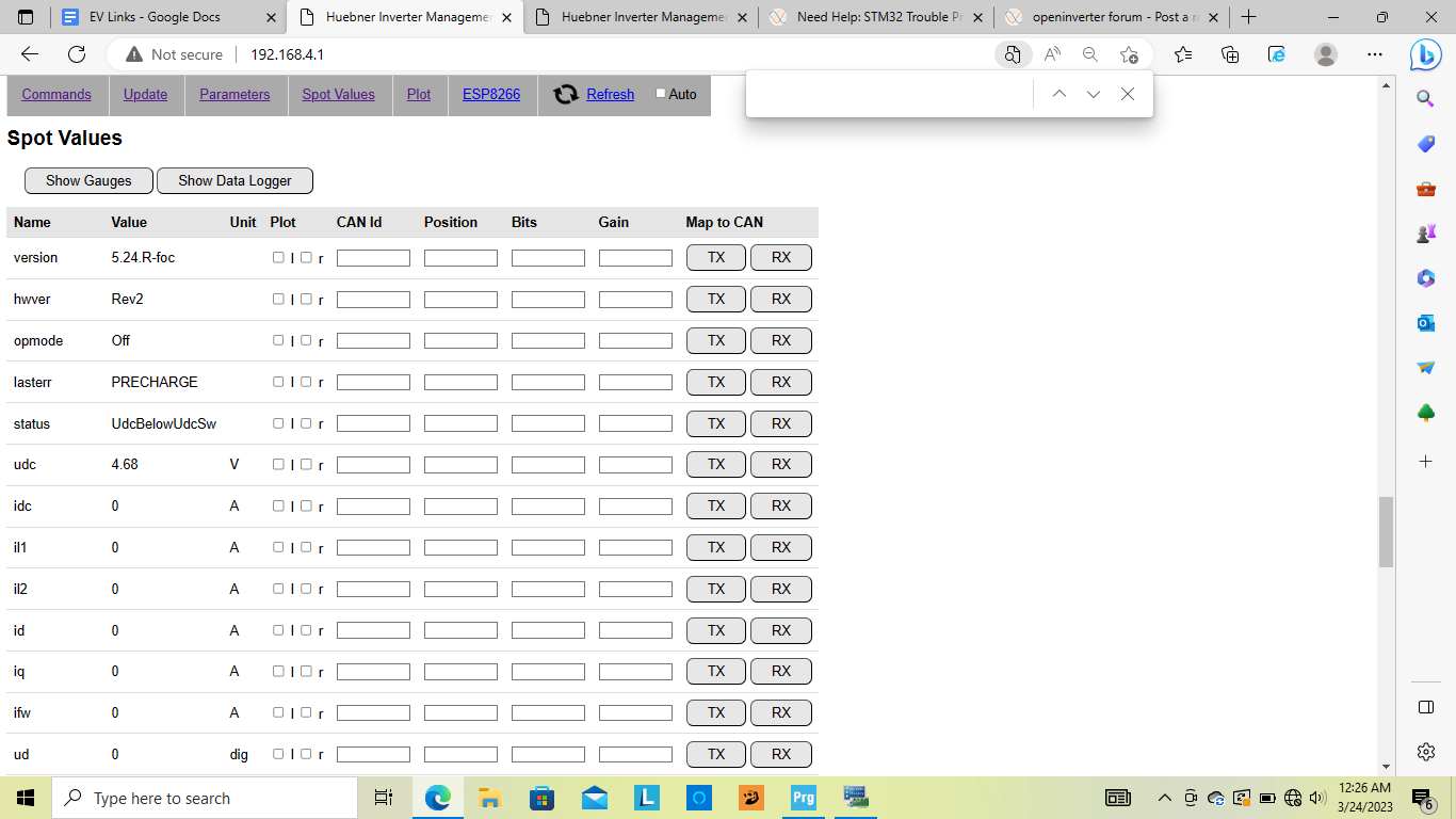

Thank you guys a lot for the detailed responses.
It turns out that I am getting the wifi that I am supposed to. I knew that the modules put out wifi called "inverter" with a password of "inverter123" but in the wiki it says there should be a wifi titled "ESP-..." which is why I thought that I was missing something. I assume that when Damian had to update the wifi modules with a password, the name changed and the wiki was not updated. (if so, should I update it?)
I am only getting one wifi network, should I be getting one from each Olimex module?

You should be getting two separate networks in your Wi-Fi list... each module is a unique network and you'll need to attach to them one at a time depending on weather or not you are configuring MG1 or MG2.

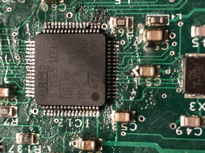

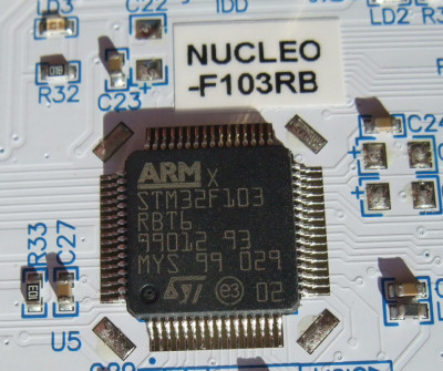

Are you able to post a close up picture just showing the STM chip, or check and post the part number on the top of it? It would also be interesting to know what the st-link identifies it as. Some chips need slightly different programming algorithms so just want to check what part is fitted.

The communication with the bootloader is pretty limited, it uses a different comms protocol to the main code. There are no parameters or anything similar in the bootloader that can be read out though the web interface. If the bootloader appears to be work you can be reasonably confident that the comms are working.lsh3rd wrote: ↑Thu Mar 02, 2023 4:06 pm Someone correct me if I'm wrong, but I *think* you should be able to communicate through the Wi-Fi module to the bootloader if only the bootloader is flashed. I'm suspecting that when you write the main firmware you could possibly be overwriting the bootloader. You could try writing the bootloader again, connect via the web interface, then try and push the foc firmware over-the-air. This process would most definitely not overwrite the bootloader, so it is a worthy test of my theory.
My suspicion is that it is a high density device fitted to the board (see link in above post), or possible a GD32 rather than the normal part due to recent chip supply problems. If it is then the bootloader won't work as the flash block size is different. If this is the case then the first thing I'd try is to use the later STM cube programmer which seems to be a little better at identifying/programming the target chip.

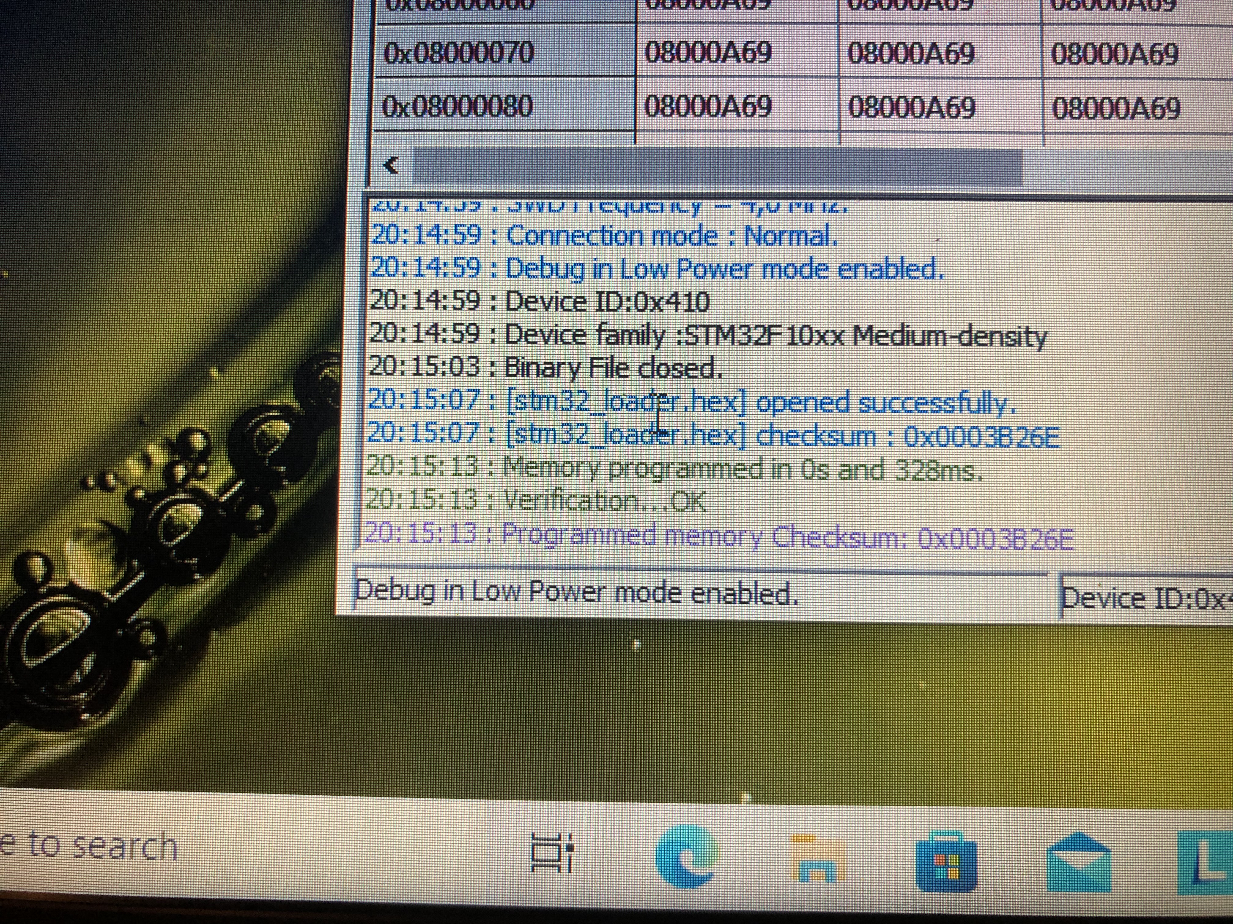

Indeed if you program just the boot loader the wifi module will be able to flash the actual firmware as the processor is in a watchdog reboot loop.
I need to try the boot loader on the GD32. It *should* be able to handle different page sizes - theoretically.
It writes 1k blocks and only issues the delete command if the flash contains something else than all 0xff. So even if the block size were 8k it would only delete the page once and then write subsequent 1k chunks.

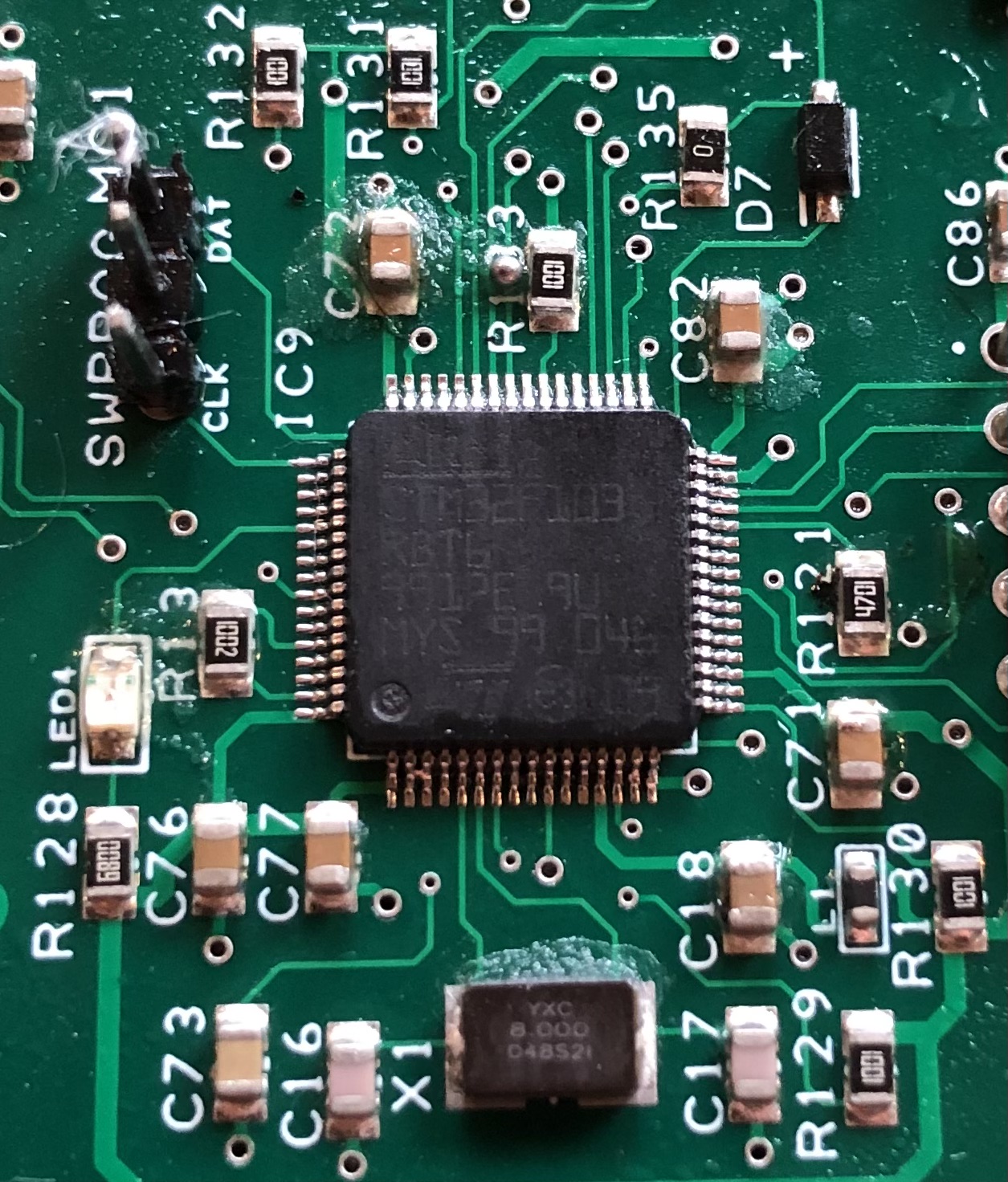

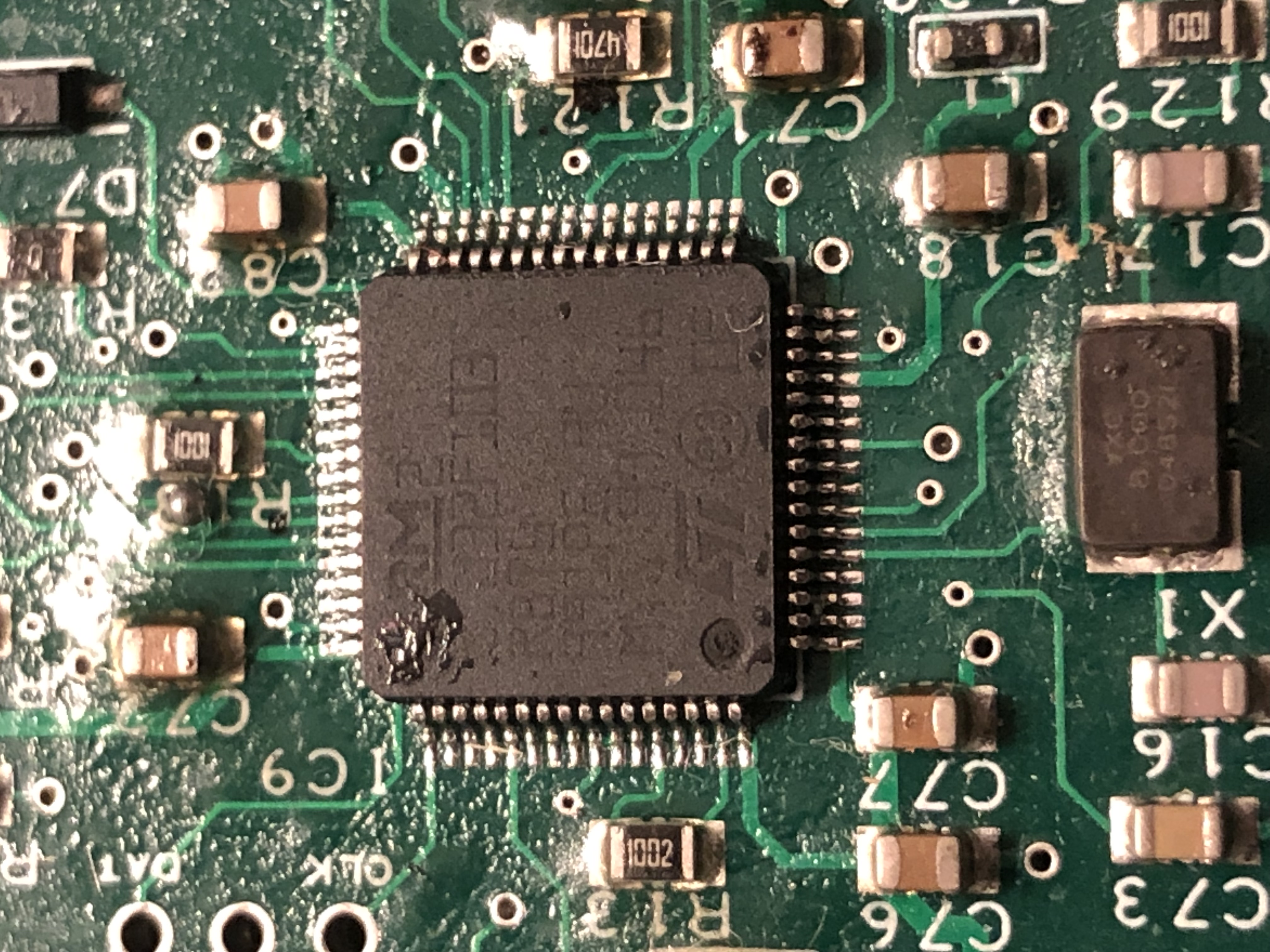

Re: Need Help: STM32 Trouble Programming
It looks like I need to add power to the ESP modules from a capacitor, this may be why I am only getting one network. After this weekend I will be back home with a 12v supply again and will test both modules.

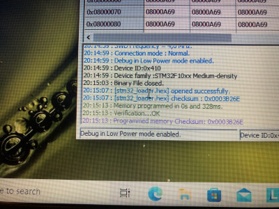

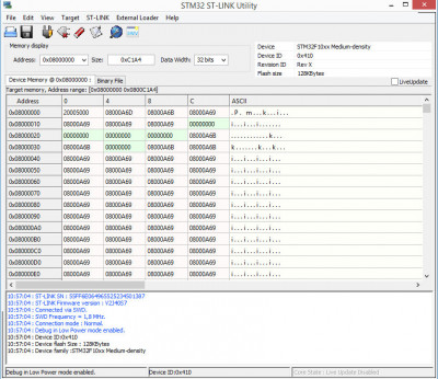

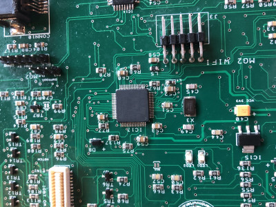

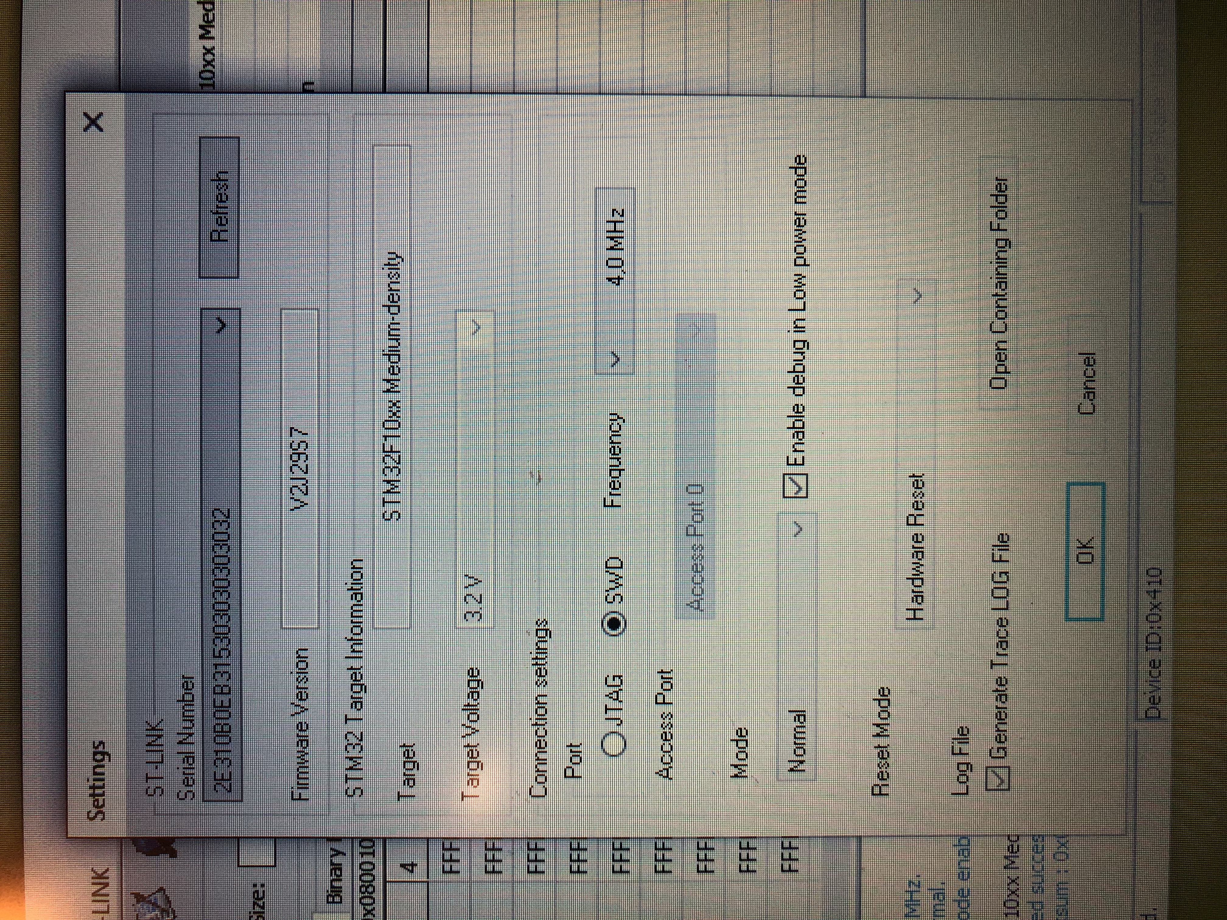

Here are photos of MG2 chip, MG1 chip, and info from the ST link: I red through the forum Pete linked; the ST identifies my chip as a medium-density and is ST branded.
I'll try loading the bootloader and firmware the few different ways mentioned and get back here. I can also get a cube programmer if you still recommend trying it.
Thanks for the help!
- Posts: 1801
- Has thanked: 102 times
- Been thanked: 347 times
Those look like the correct, genuine STM chips and they are reading correctly so it looks like this is a different issue to the one on the linked thread. In that case I doubt the cube programmer will be any better.
The cap is well worth a try.
Agree with Lsh3rd's suggestion that the next thing to try is to program the bootloader using st link and then try to download the main foc code via the web page.
BTW, it is possible to read back the flash memory using the st link, or verify what is there against a file, so it is quite easy to check whether you have overwritten the bootloader.
Also, don't try powering the ESP modules from a 12V supply. They need a 3V3 supply.

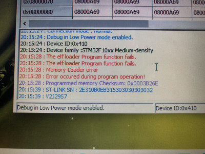

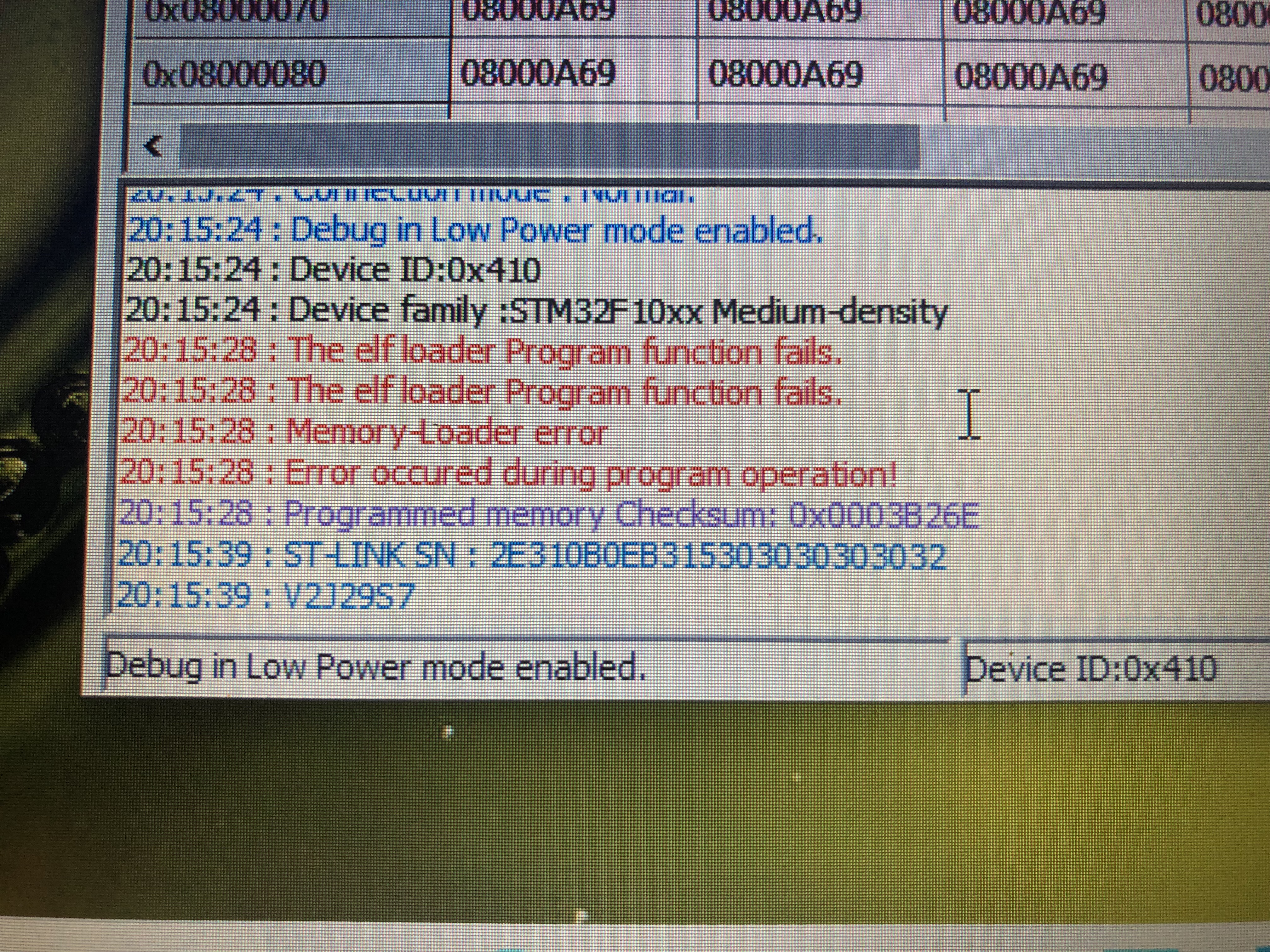

Sorry for the delay since last post. I've spent some time working with it and here is what has happened:
wifi modules: both appear to be receiving the necessary power supply, and I can connect to both individually (i.e. only one on the board at a time). When both are on the board, I still only receive one network and cannot differentiate between MG2 and MG1. Does anyone know if this is normal? I think this is how I got my MG1 un-programmed--by accidentally loading firmware onto it when I was trying to connect to MG1.
STM32s: I have tried flashing the bootloader then uploading the firmware over air on both, with no luck. I was receiving this messaging when installing the bootloader: Then I changed target settings from "Hardware Reset" in Reset Mode to "Core Reset" per the image in the wiki of settings to follow. After that I started receiving this: , even when reverting settings to "Hardware Reset"
Is it possible that I damaged the STMs by overwriting them when they were already programmed? Honestly I'm a bit out of my wheelhouse here, with most of my experience being mechanical, it might make the most sense for me to buy another programmed board from Damien to keep my project rolling.

Use software reset as without the nrst pin connected HW reset will not work.

I'm starting to get a bit suspicious about the power supplies on this board, especially with your comments about IC17. Could you measure the 5V and 3V3 rails with a multimeter on both DC and AC ranges, ideally with neither ESP fitted, then one and then both.
If everything is working right you should see 5V/3V3 DC and a low value AC (10-100mV) in each case. If the rails are struggling then the DC value will drop and the AC value increase.
The ESPs are quite a heavy load on the 3V3 rail. If you program both the bootloader and main code with the ESPs unplugged does the board LED flash (unlikely but worth checking).

I'm starting to think that your chip might not be a genuine STM one again (as per the above post and link). If so it's a better copy than the one in the above thread but it still doesn't look quite right. This is a picture of one I have here (on a genuine STM dev board and made before the chip shortage so pretty sure it's genuine - it also looks identical to other ones I have on other old boards):
If it's not a STM chip then a compatibility issue with either the programmer or bootloader could be the problem. I'd suggest that you install the later STM32Cube programmer (https://www.st.com/en/development-tools ... eprog.html) and give that a try to program both the bootloader and the main code.
The other option, if it helps, is I could knock up a quick test app. Just something that would run independently of the bootloader and flash the LED, first running on the internal RC oscillator and then setup the clocks and external oscillator and flash the LED again. It would prove that the processor could be programmed, comes out of reset and run code and the external crystal is operational but that's about it.
Compared to yours the text just looks cleaner and better defined, there are slight differences in the package, font and the logo too. Not conclusive either way though. Might be worth taking another picture of yours now the flux has been cleaned away - the device markings might now be a bit clearer? If it's not a STM chip then a compatibility issue with either the programmer or bootloader could be the problem. I'd suggest that you install the later STM32Cube programmer (https://www.st.com/en/development-tools ... eprog.html) and give that a try to program both the bootloader and the main code.

I have been using the latest bootloader from here: https://github.com/jsphuebner/tumanako- ... r/releases
I just tried using the Version 4 bootloader from the same source, but with no luck.
On MG1 (where I know that I once had a blinking LED) I tried loading the bootloader, doing a power cycle, and then uploading the firmware on the ESP with the ST-Link disconnected. I did this with both the latest and 4th Version of the Bootloader. When I upload the firmware, a green light momentarily comes on the ESP, but there is no other sign that the STM32 has been programmed, and the Spot Values on the wed interface do not show a firmware verson like they are supposed to, according to the wiki.
Here are photos of MG2 STM32 and MG1 STM32: It seems like the markings have become more faint after being cleaned with IPA.
I tried using the CubeProgrammer, but it was not consistently connecting to my ST-Link (Sometimes it would take a few refreshes) and it was unable to identify or update the firmware on my ST-Link. This makes me think that maybe I should buy another ST-Link and see if it works better.

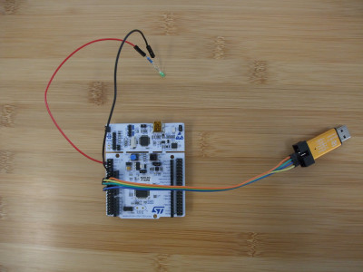

Worth noting that the debuggers built into the Nucleo boards can be separated from the main board and used as stand alone programmers with any STM chip. Being STM parts compatibility and reliability is good, and they are still available but are a little more hassle to setup and use.
BTW - There is what looks like a solder ball visible on your second image above (next to the resistor just above the processor). These can sometimes be produced during soldering and need to be removed otherwise they could cause shorts. Worth checking over the board to see if there are any more too.

Just noticed that in your programmer screen shots the flash size is being reported as unknown, on mine it correctly reports as 128k. Now this could be a programmer issue but it's more likely to be an issue with the chip. It's possible that it doesn't contain the full 128k of memory and if that is the case then it could explain why the main FOC code doesn't run (if that's the case then my test app should still fit and should run ok).
It would be interesting if you could program the device with both bootloader and main code (either using the same method you have used above or my single image) and then read it back out via the st-link software? To read it back out set the memory address to 0x08000000, the size to 0x20000 and press enter, that should read the chip data out and into the Device Memory window. Then go to File, Save file as, save it in hex format and post here. (I'm wondering whether the contents will end at either 32k or 64k instead of the correct address)
Edit - Could you also change your programming settings from validate during programming to validate after programming (the latter is more sensitive to blocks being overwritten) and try programming again using my single image file?
