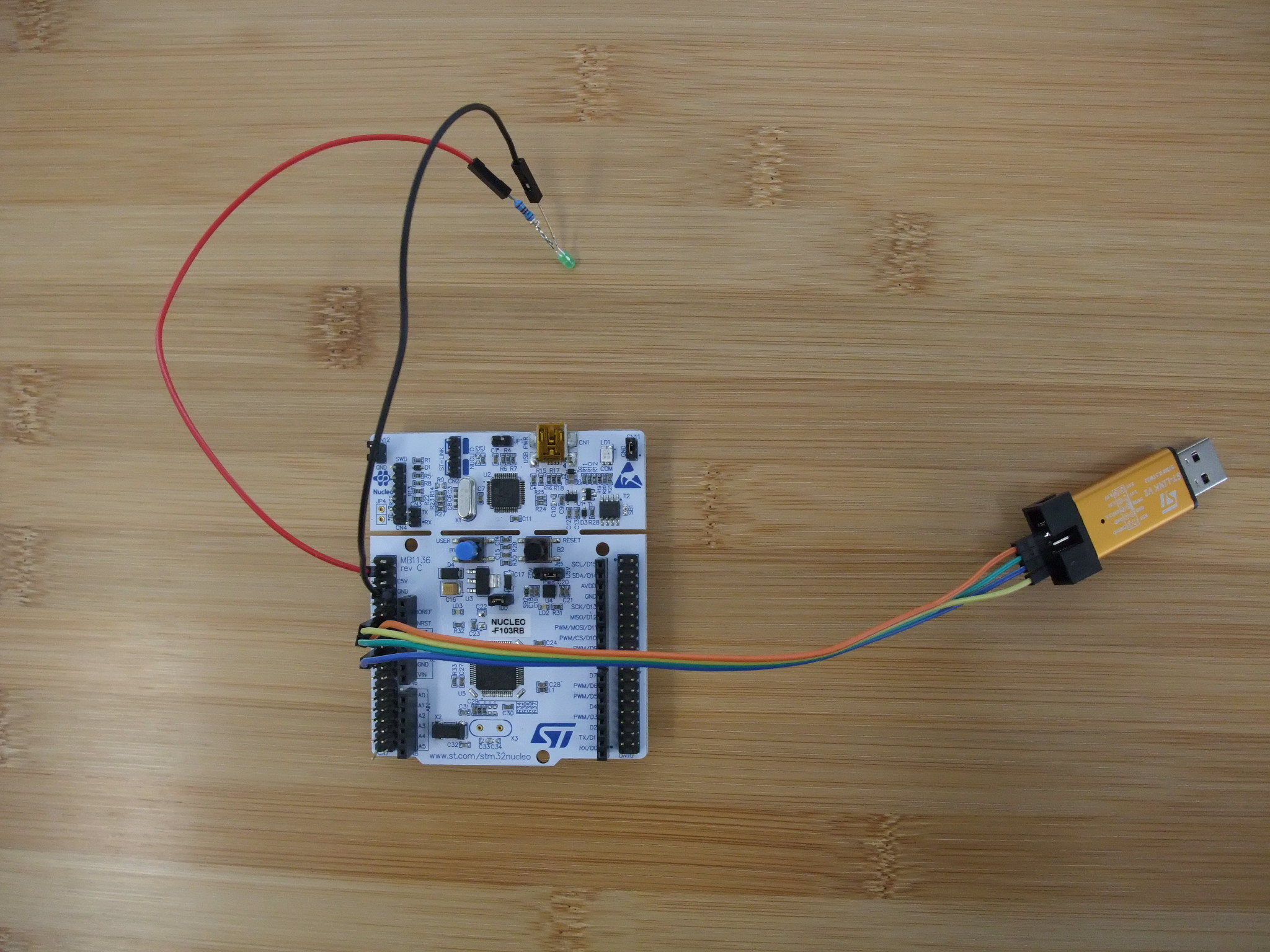

I ended up doing a test app anyway - I've been meaning to get to grips with the bootloader for a while now (so far everything I have been doing directly programs the board from the IDE) so this was a good excuse to have a look at it. The test app is pretty quick/rough bodge but seems to work, it just flashes the LED 5 times following reset/power up (while still running on the internal oscillator), then configures the external oscillator and the chip clocks and flashes the LED again (faster this time as the chip clocks are then running a lot faster). Nothing, apart from the clocks and the one LED GPIO line is configured. It's a very minimal test but if it works it proves that you can program the chip, that the micro is able to run code, that the external crystal oscillator is working and that the LED works.
To use it just program this to the chip:
stm32_foc_StandaloneTestApp.hex
(68.5 KiB) Downloaded 550 times
This is actually based on the latest FOC code so while doing it I also built the FOC code in a way that will run without a bootloader. Note - this is no good for normal use as without the bootloader you can't update the code without plugging in the ST programmer (I'm also not sure whether saving parameters to flash will still work - I think they will) but it would be interesting to see whether the board comes to life when using it and whether parameters/spot values then appear on the web interface:
stm32_foc_FullNoBootload.hex
(133.95 KiB) Downloaded 631 times
I've tested these on a STM nucleo board using both the built in ST-Link debug and with an old 3rd party debug probe I found in the cupboard:

A the moment I'm thinking that either the chip or the programmer is the problem. The 3rd party programmers can be a bit variable so I normally use a genuine STM ST-Link/V2 debug interface (although they do seem difficult to get at the moment). Having said that the 3rd party one in the picture updated to the latest firmware first time and then worked fine with both the old and new STM programming tools. It might be worth you trying another to see if it makes any difference, especially as it doesn't sound happy updating to the latest firmware.
Worth noting that the debuggers built into the Nucleo boards can be separated from the main board and used as stand alone programmers with any STM chip. Being STM parts compatibility and reliability is good, and they are still available but are a little more hassle to setup and use.
