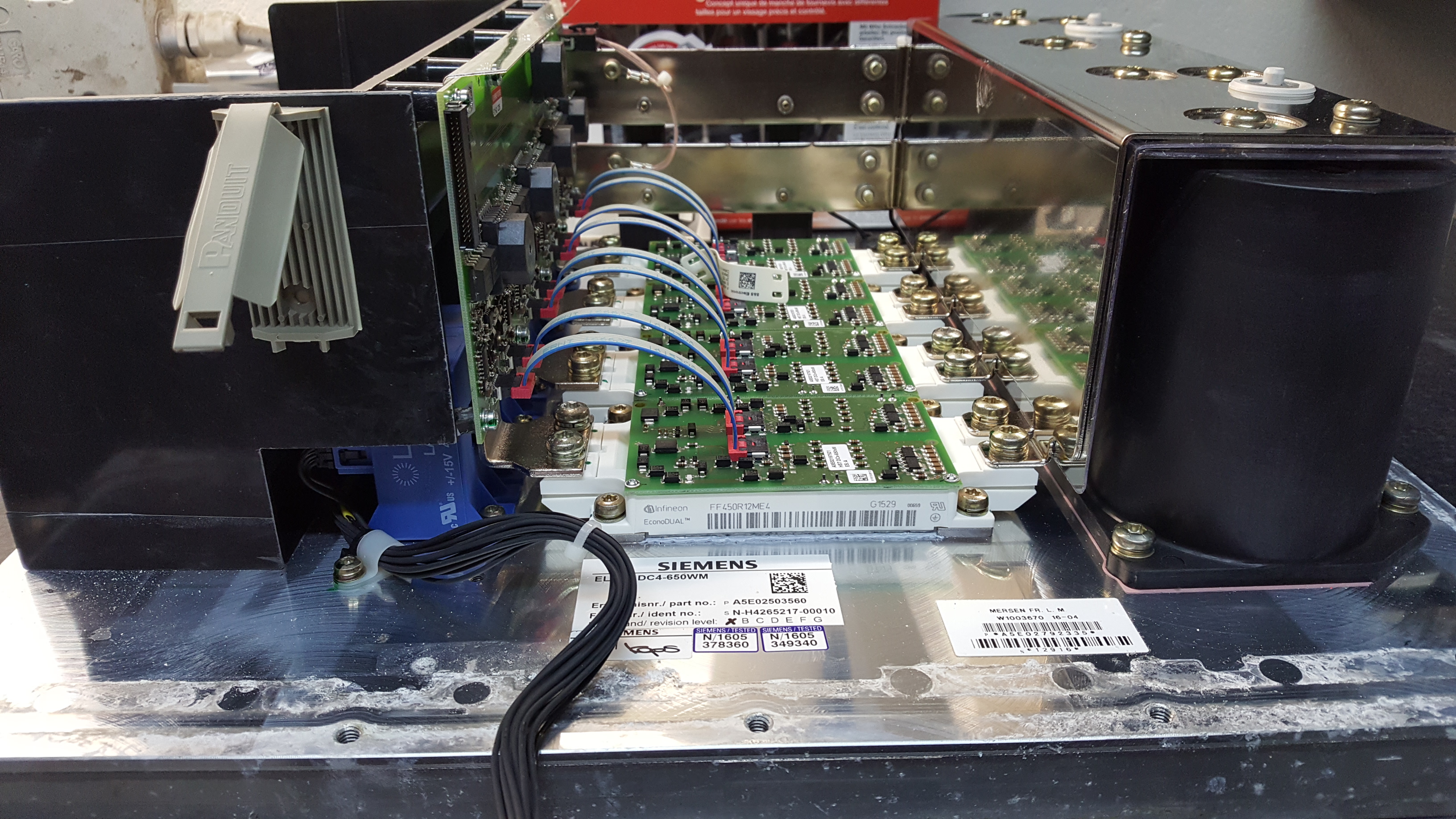

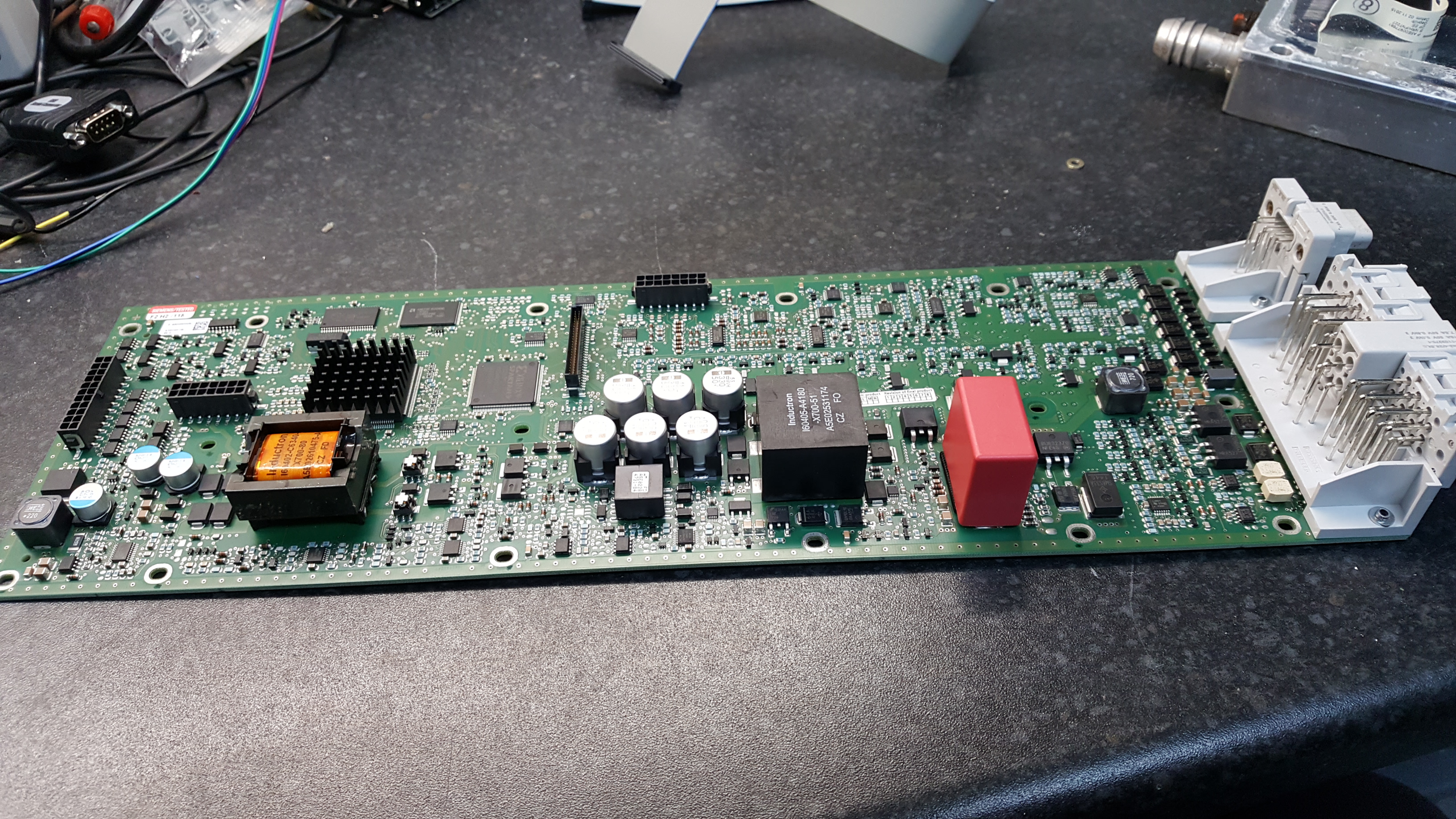

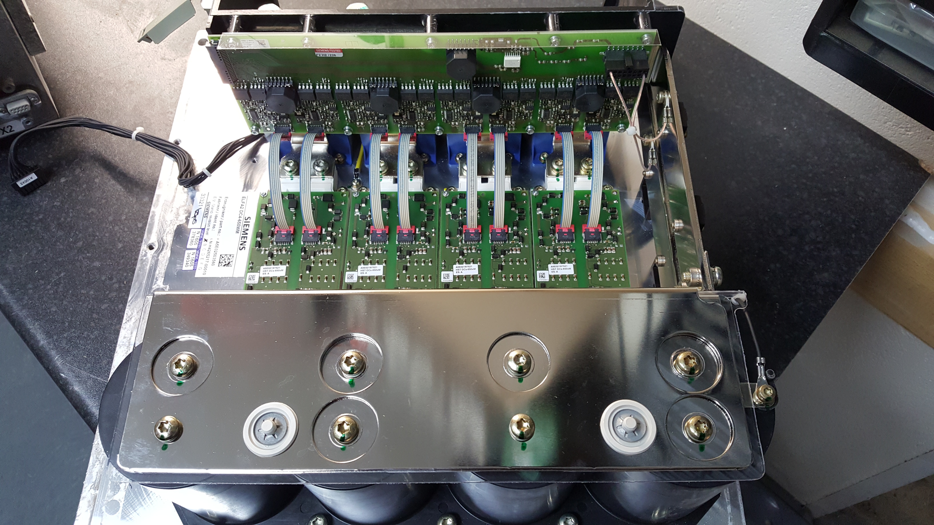

Starting a project to reverse engineer the Siemens Elfa2 1200V 450A inverter with a view to fitting a Heubner logic board. I have ten of these with a possibility of more on the way so could be a nice powerful inverter for people to use.
If anyone has any info on pinouts etc that would be great. Looking forward to replacing a ton of expensive logic (including a Xilinx Spartan fpga) with a little cheap STM32:)
One interesting thing is it seems to be a 4 phase inverter with 4 sets of half bridge modules....

Hi Damien. They look very tidy and well engineered. Can these be used with 3 phase induction motors, such as your favourite Enova motor ?? :-)
Try this for info... https://www.scribd.com/document/3669347 ... ter-Manual
TTFN. Peter

The 4th fase is a DC/DC converter for ultra-caps (in combination with inductors), brake resistors. Battery's are direct linked on the DC-link.
