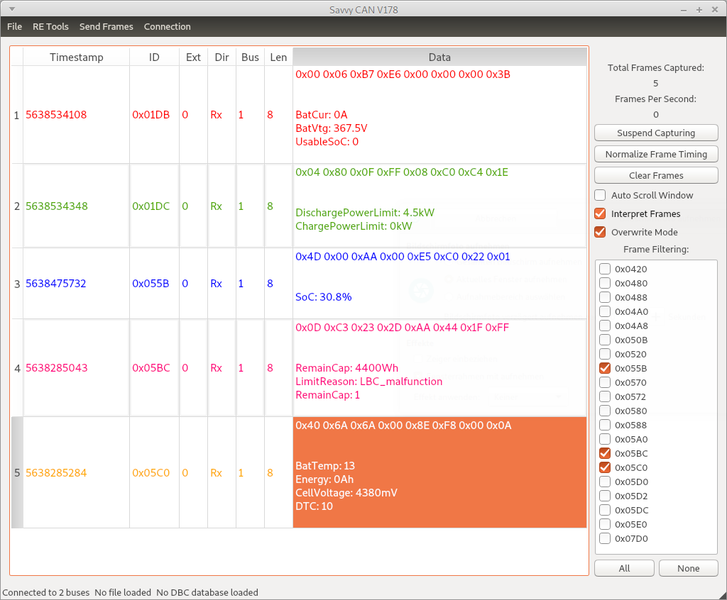

So hooked up the BMS today and looked at CAN values.
Of course most values don't make sense as the LBC/BMS doesn't belong to this battery.
I am getting a very low power limit (0 charge, 4.5kW discharge) because of "LBC malfunction". DTC is 10. Anyone know where I can find a list of DTCs?
Gotta say, SavvyCAN is awesome, it was real easy to define the signals despite the weird bit order.

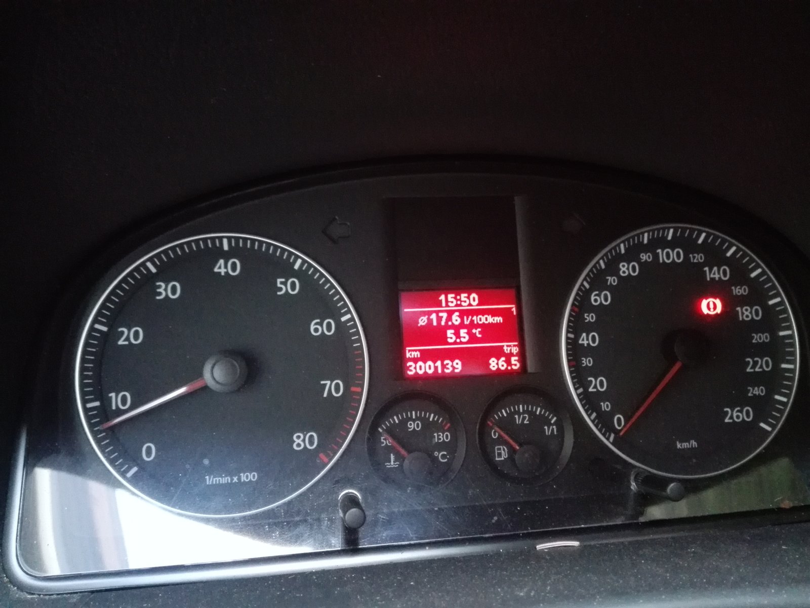

Did a test drive yesterday and here is the economy figure (kWh/100km).
It was like 80-100km/h mostly flat back road driving

is that trip meter accurate? At 176wh/km doing 80-100 km/h is very good for such a big car.
- Posts: 391
- Has thanked: 49 times
- Been thanked: 10 times
Thats about the same what I get with driving 100kmh on the Nissan Leaf @1460kg. So looks really good.
How is the weight of Touran now?
- Posts: 5824
- Has thanked: 162 times
- Been thanked: 1044 times
Yes it should be. It is fed by an upcounter. The faster it upcounts, the higher the consumption. It is linear, I checked. So if you count up by 28 per 10ms it will display 10l/h. If you start driving it will convert that to l/100km. So I just take the power reported by the BMS in kW, multiply by 2.8. Now if I pull 1kW it will display "1 l/h".
Wow, thats almost too good. Maybe because I have no auxiliary drain right now. I don't have any equipment to weigh the car, so will have to wait for the TÜV visit.

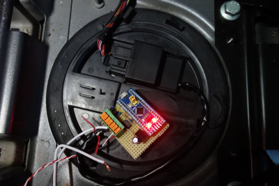

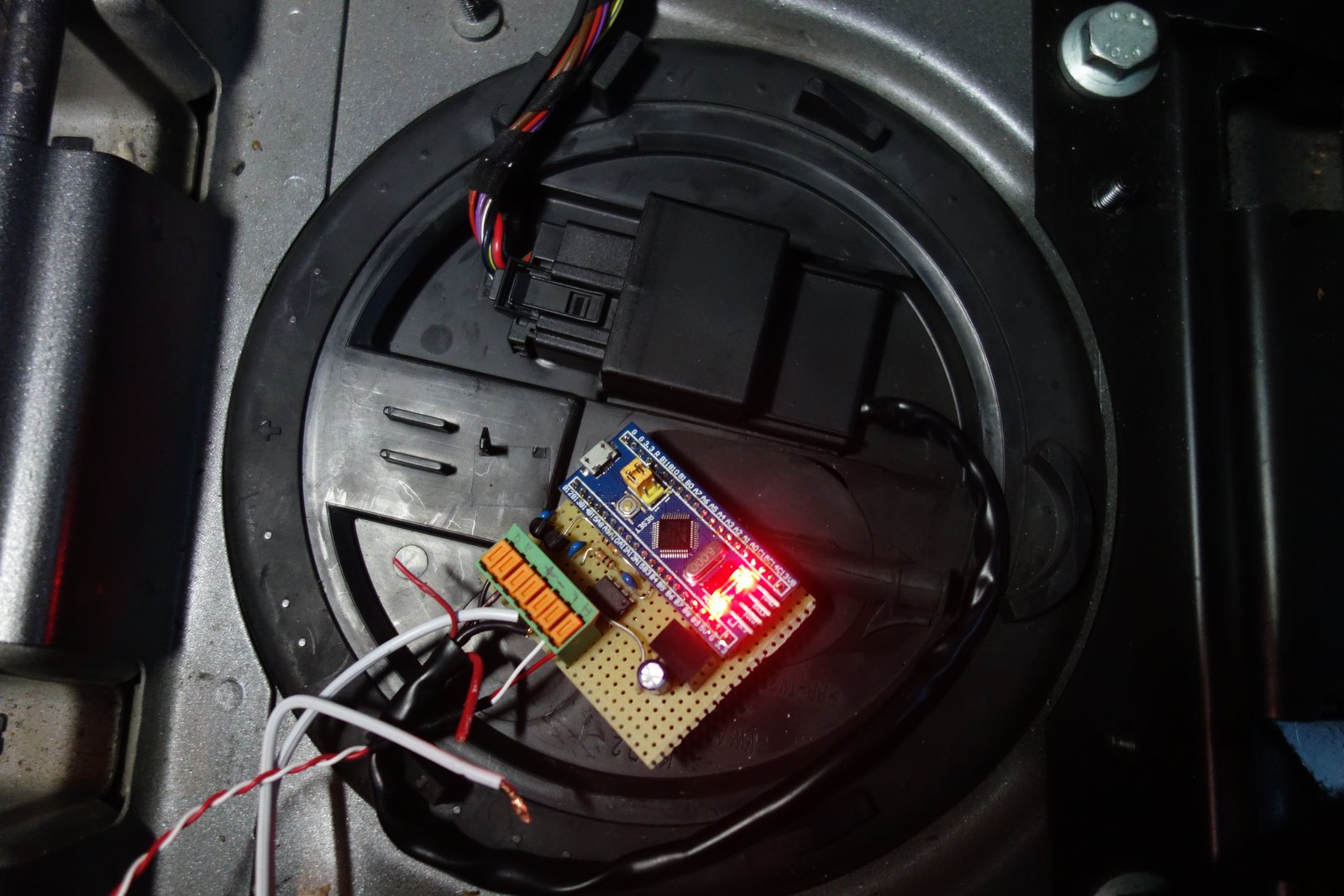

Sorted the fuel gauge today.
Blue Pill+MCP2562 CAN Transceiver+ 2 BC547 transistors
So at 50% SoC we output 36% duty cycle on both transistors. As SoC increases we decrease duty cycle on one channel and increase it on the other one by a certain amount per % SoC. Perfect analog pot simulation.
Then mapped SoC from the Nissan BMS to it, done. Still took me all day
Idle duty cycle and SoC gain are configurable so I hope it will work for other cars with a similar setup.

Ah J where were you last week!!! I was just banging my head at my fuel mapping and wonder why I can't go past 50% indicated.johu wrote: ↑Tue Nov 12, 2019 4:17 pm Sorted the fuel gauge today.
Well my SOC probe uses single Fet driver to move needle in mazda. But here single pwm doesn't go beyond 50%.
Can you show a circuit to get single pwm signal to move needle full range?

I final-mounted the fuel gauge driver today and put all the trim and seats back in.
But oh no, as soon as I spin the motor all warning lights go crazy Seems my CAN bus extension from BMS to gauge driver causes a problem. After all it's routed on top of the batteries so will see a fair bit of EMV. Maybe it's a termination issue. Still haven't measured total bus resistance.
So remove seats and trim and try again
