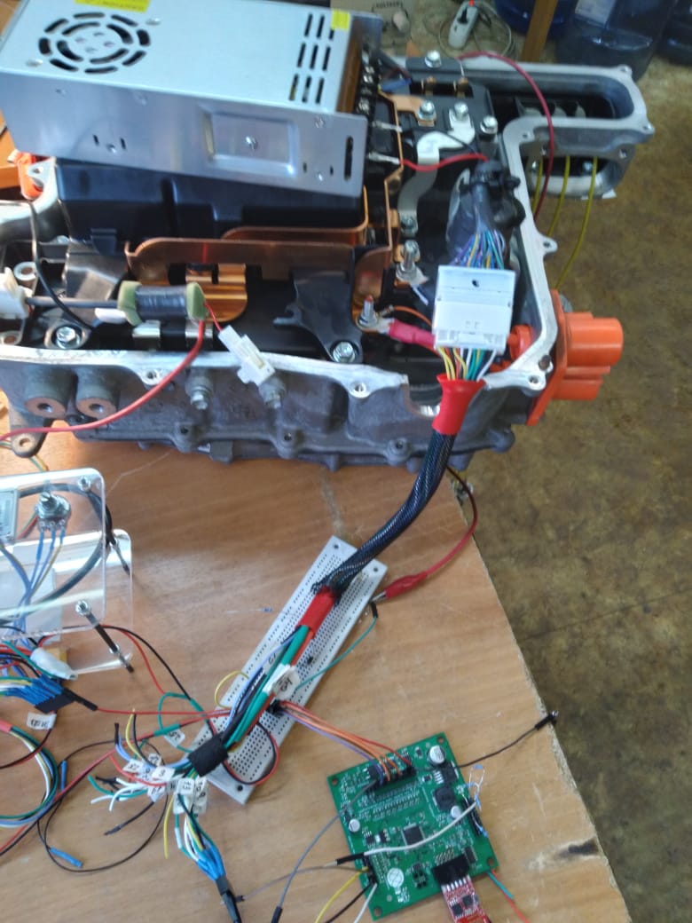

Manual Mode is not working
Post by EvPrud »
I have Board Rev.3 and Prius Gen2. Supply 12 V on all devices, but an oscilloscope does not show frequency on PWM1_any outputs in Manual Mode. Writes 'Invertor started', with no errors. Boost is 37813, ampnom 70 %. IN_MPROT, IN_START, IN_FWD are connected to 12 V. The red LED on the plate is blinking.

Additionally, I got [15]: STOP - OVERCURRENT .

EvPrud wrote: Sun Feb 05, 2023 11:18 am Additionally, I got [15]: STOP - OVERCURRENT .
It means it drops straight out of manual mode again. Either connect current sensors (recommended) or supply around 2.5V to the current sensor inputs

Il_1 and Il_2 have 2.23 V potential.

How can I define that the inverter is working itself or not ? I see 0V on 7 and 12 its terminals instead of 2.5V .

Please post a picture of your exact setup. Are you using the square mainboard instead of the Prius board with Gen2 inverter?

Yes, I 'm using the square board Rev3.

As I understood UN2003A must be added.
