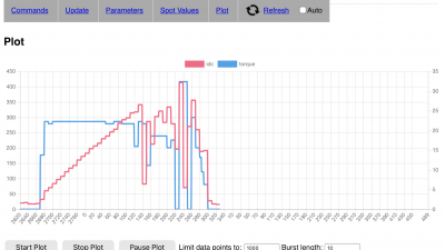

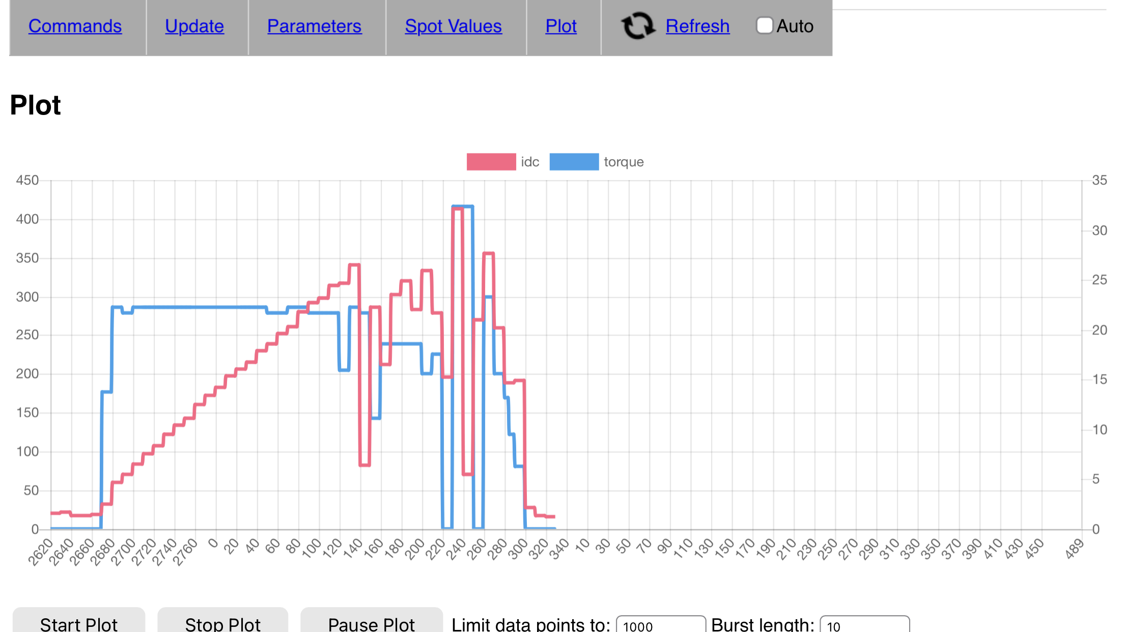

I'm happy to test in the e65 superyacht but neither myself.of Damien have noticed either if those issues, I would assume it relates to a bad shunt value being supplied by the ivt shunt or interference or a battery setpoint that is being adhered to. If you have any specific things you want me to test let me know
Re: Zombieverter or Lexus GS450h VCU that is the question.
Thanks for the offer paaa.
The age old problem of installation or software issues. It is very hard to say in a lot of cases which is the issue.
As far as bugs are concerned I can only quote "crasbe" as saying on 14th December 2022,
"The bug in the idc limit handling is known but as of now not yet fixed and it's known that the torque limiting due to overcurrent/overcurrent/overspeed can be too hard".
I assume that crasbe is of sufficient level in the development of the "zombieverter" to make that statement. Please can you confirm if crasbe is correct or not?
The only thing I noticed with the land yacht is that it has a 24Kwh power pack and mine is 52Kwh, perhaps the extra power available is the issue!
also the throtmax setting was at 10% on the parameters that Damien posted late last year. I could stop the Torque cut by setting my throtmax to less than 16% but the car was very sluggish.
Regarding the torque dropping off to 0, I think it is the fact that when the power comes back in it is back to max again so the transmission is going from load to no load back to load again.

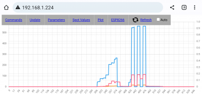

I still experience what seems like a hard cut on idcmax - causes hard juddering once you reach the set limit, totally smooth if you stay below it. On GS450H, 1.11.A. Is this to be expected, or am I on the wrong version or wrong setting?
Example behaviour with idcmax set to 25A - throttle held steady as speed increases.
