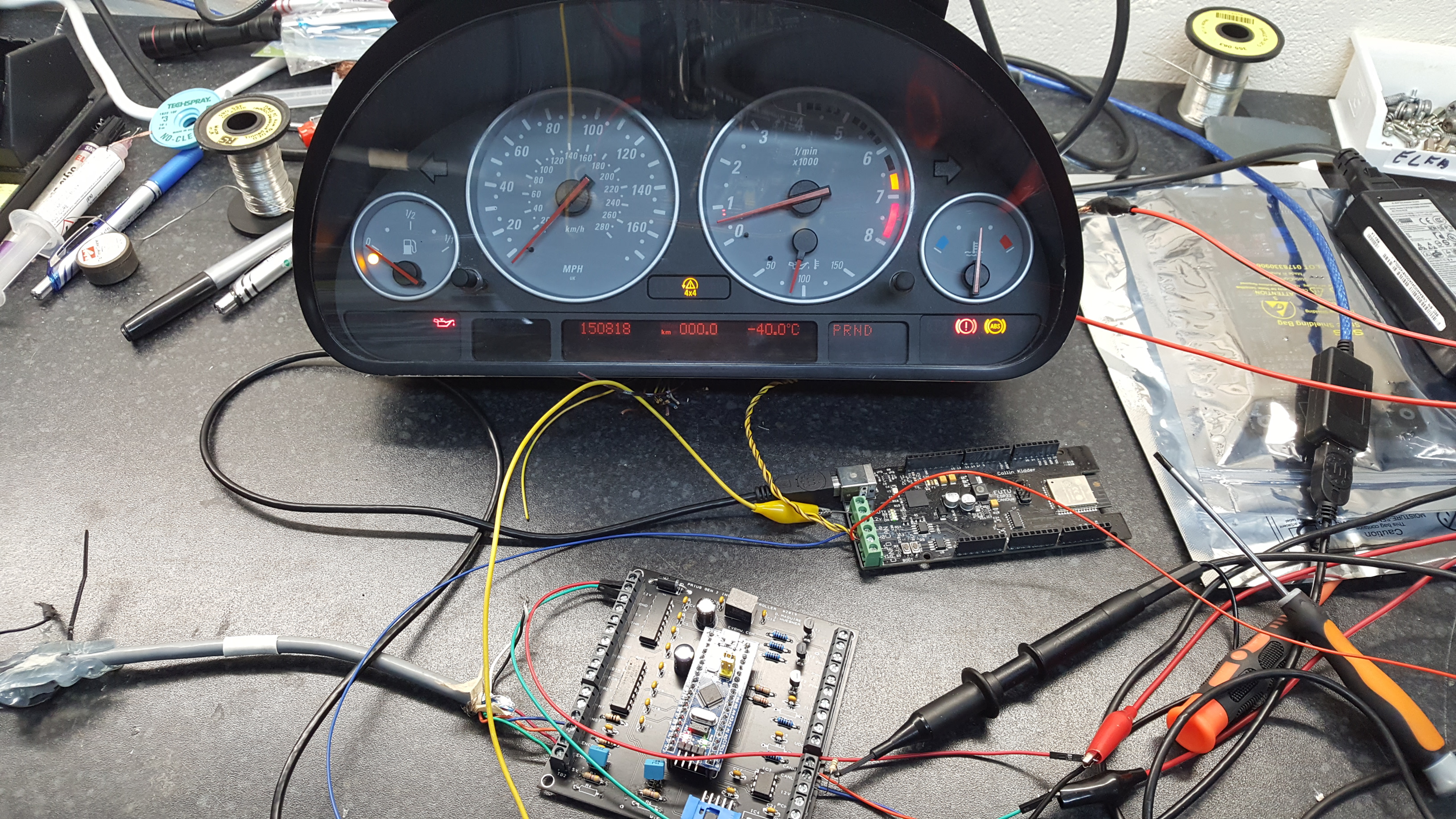

So one problem I have had with my E39 since the AC motor swap are the warning lights on the dash for traction control and abs. With the annual inspection coming soon I figured I had to do something. Also want to swap in an M5 instrument cluster. Initially thought I'd just use a CAN bridge between the inverter and the car but decided to put my almost non existant high level programming skills to the test to see if I could modify the firmware to send some BMW style CAN messages. Worked out very well and learned some interesting things like using unions for swapping between data types. Long way from 6502 assembler:) RPM and temp display working as of now. Mapped the temp to a fixed value for testing but plan to use engine temp for heatsink temp and oil temp for motor temp.
Attached modified stm32_can.cpp for those interested. Probably much neater ways of doing it but works for me:)

Aha, I see a need for "speedmod" as I had the same issue on Touran. Below about 600rpm there is now power steering
I'm also thinking about a generic way for cycling counters, again same thing on Touran ABS.
Are you sure (Param::speed)*6.4 works? I believe you want FP_TOINT(FP_FROMFLT(6.4) * Param::GetInt(Param::speed))

I just wrote you an email as I was crashing the processor and banging my head off a wall until I relaised I was multiplying and int with a float and the STM32 dont like that:)

And here is an actual working version. Tachometer driven from motor speed and engine temp driven from heatsink temp.

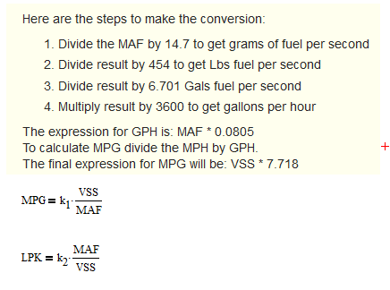

JB, Since you are on a BMW roll, wonder if you have thought about the fuel efficiency meter. Equation is something like:
cheers.
so just need car speed, and manufacture CAN message for MAF, -which becomes the inverse of say battery energy consumed per km.
you have probably already thought of this.
cheers.

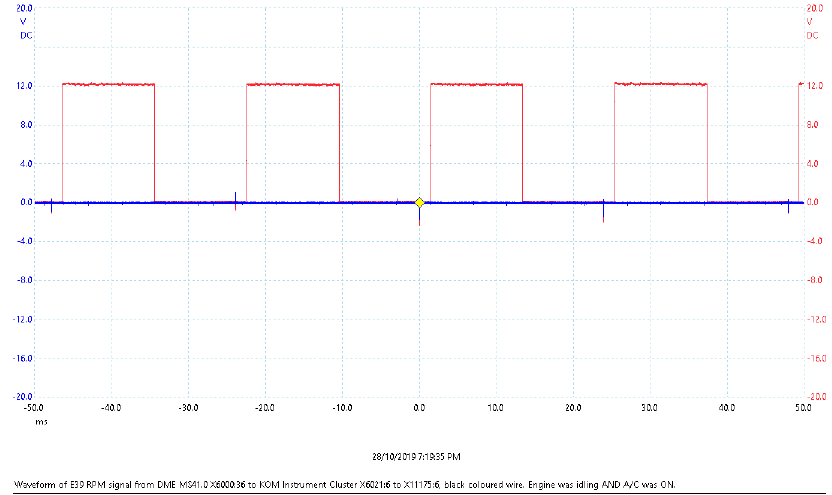

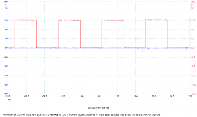

I have looked at the A2 KOM instrument cluster of my BMW e39. I can't find CAN messaging going to this. Instead I have found an RPM signal. I measured that today with a Picoscope and obtained the following signal. I understand this signal goes from the DME MS41.0 ECU to the A2 instrument cluster, so i think i will have to simulate this signal from the inverter.
