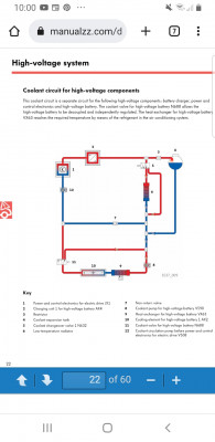

I've disabled regen at the moment, but have charged at a lower rate below 0.
At 4A charging my pack still didn't get above 0°C. As far as I'm aware, the leaf has no battery heating in the UK? and I don't think the VW GTE that I've got modules from also doesn't have a battery heater. I searched forums, and apparently the GTE still does regen up to 30kw down to -10°C so maybe I'm overcautious here too.

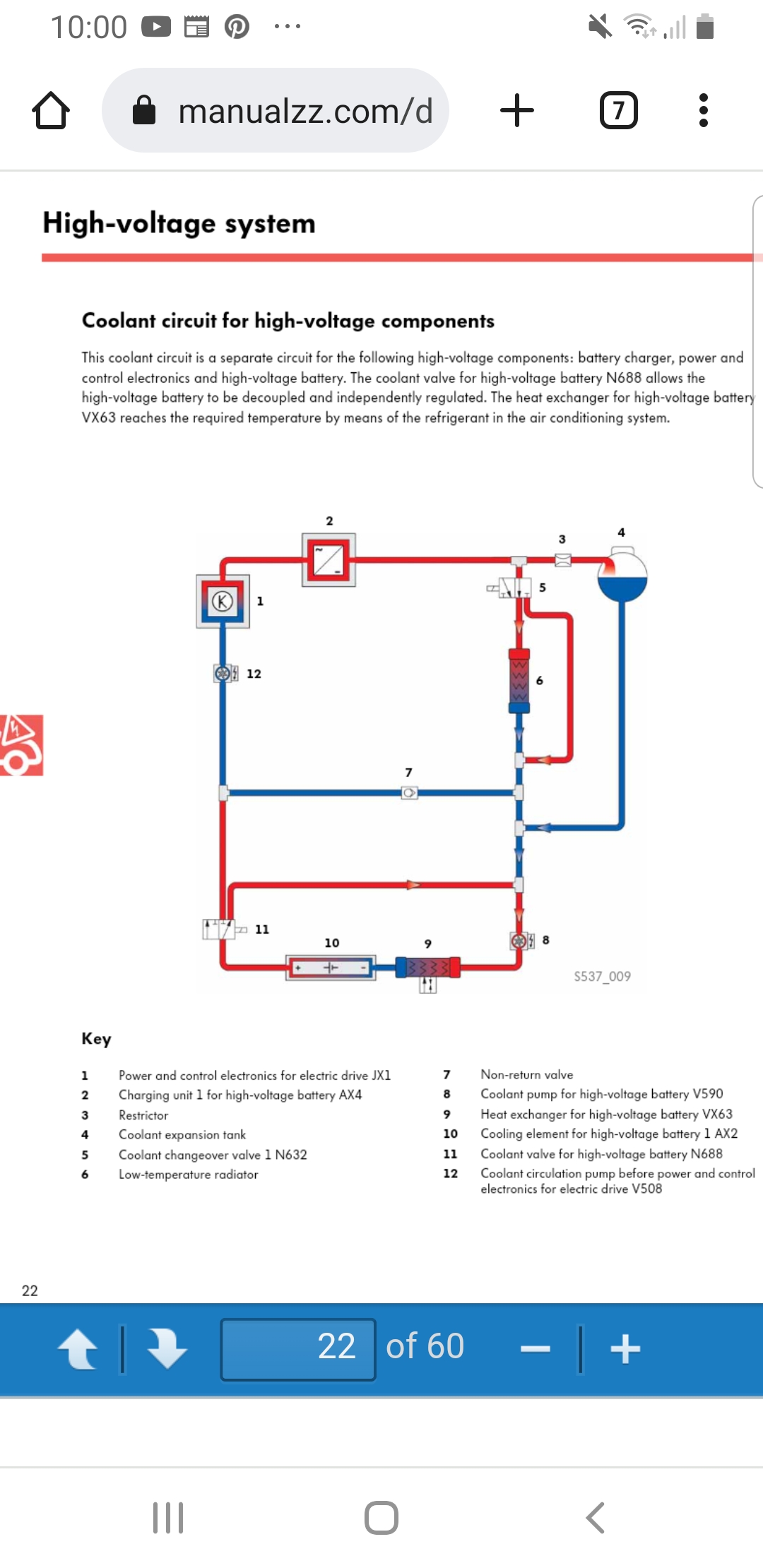

Bigpie wrote: Fri Dec 16, 2022 4:32 pm I've disabled regen at the moment, but have charged at a lower rate below 0.
I have Passat GTE cells at home and they have liquid cooling and persumably heating too. It would be foollish not to have both with that cooling plate.
Passat GTE is using the same kind of PTC heater as Golf EV.
I wouldnt keep cells below 0. Maybe you could remedy that by using 12V camper heater foil under the cells. I have that for now but i keep the car inside and cells never went below 3deg. I charge them at 8kw rate from AC.
I find the mass of the cells is slow to heatup and also slow to cool down. But really dont let them cool down too much.
I am thinking of adding a plate between two stacks of 8s cells but cell terminals make it difficult to connect silicon hose and secure it to the tube. Have to find a solution...

Re: Charging in subzero
The GTE doesn't appear to have any way to heat the battery, other than using waste heat from the charger/inverter.
