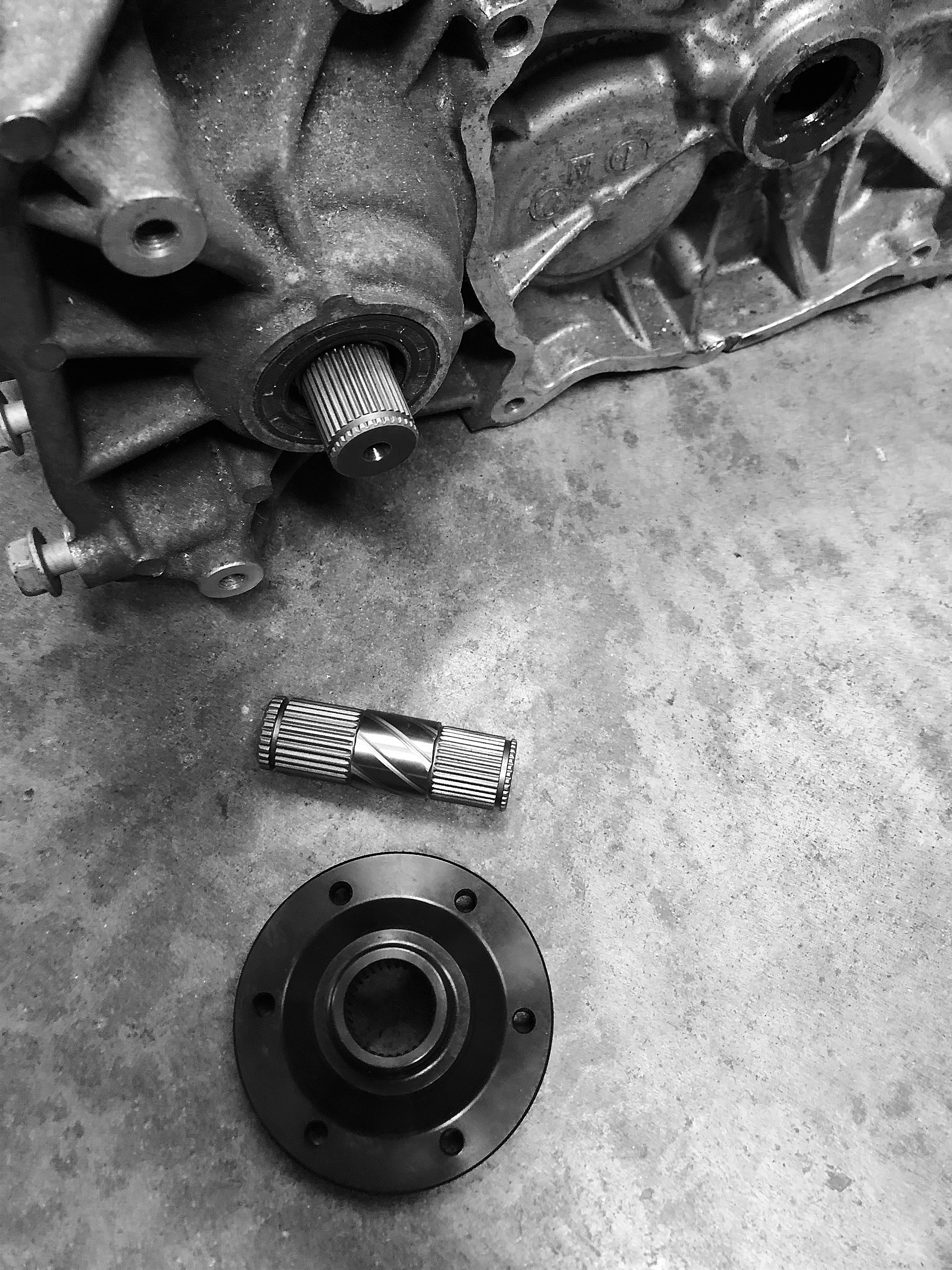

after months and months they are finally here!

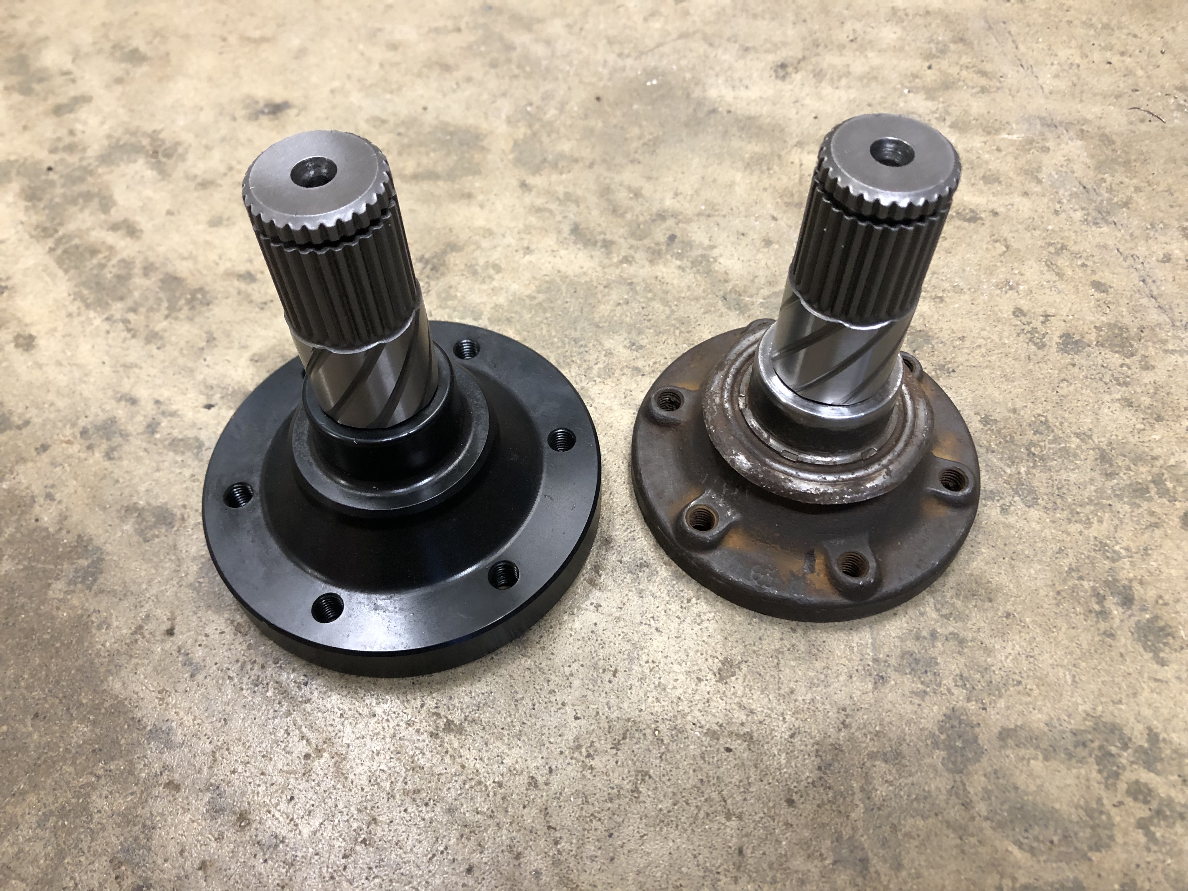

drive shaft adapters for the nissan leaf gearbox, the outer end has a 33vw beetle spline, so a variety of axle flanges fit, such as
  • vw type 1 (90mm) flanges
  • vw type 2 (100mm) conversion flanges
  • porsche 930 (108mm) conversion flanges

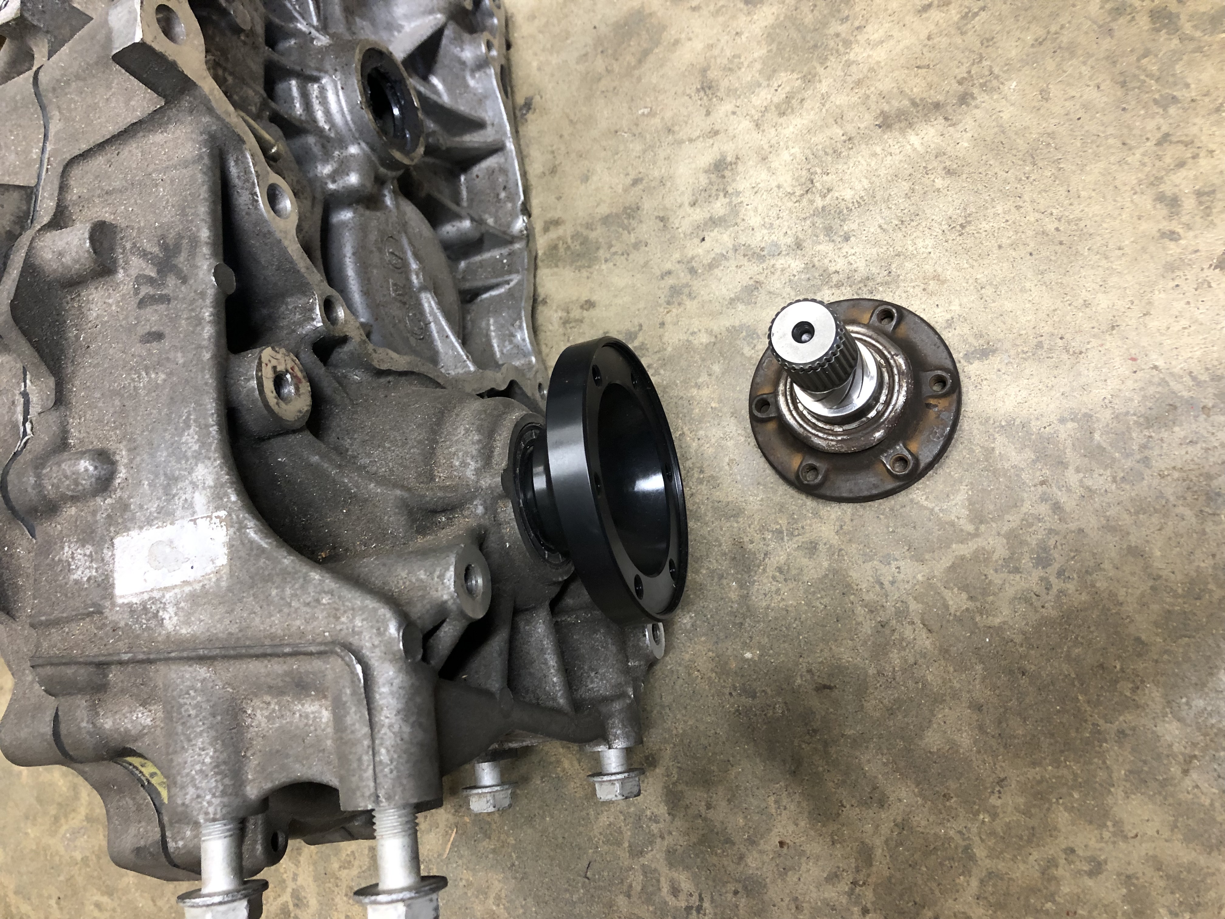

requires replacing the drive shaft seals on the leaf gearbox with 36X56X10 shaft seal.
they are made from cold rolled(not cut!) 4130 chromoly steel. this makes them much stronger, they're about 35% stronger than the OEM part.
450$ cad
