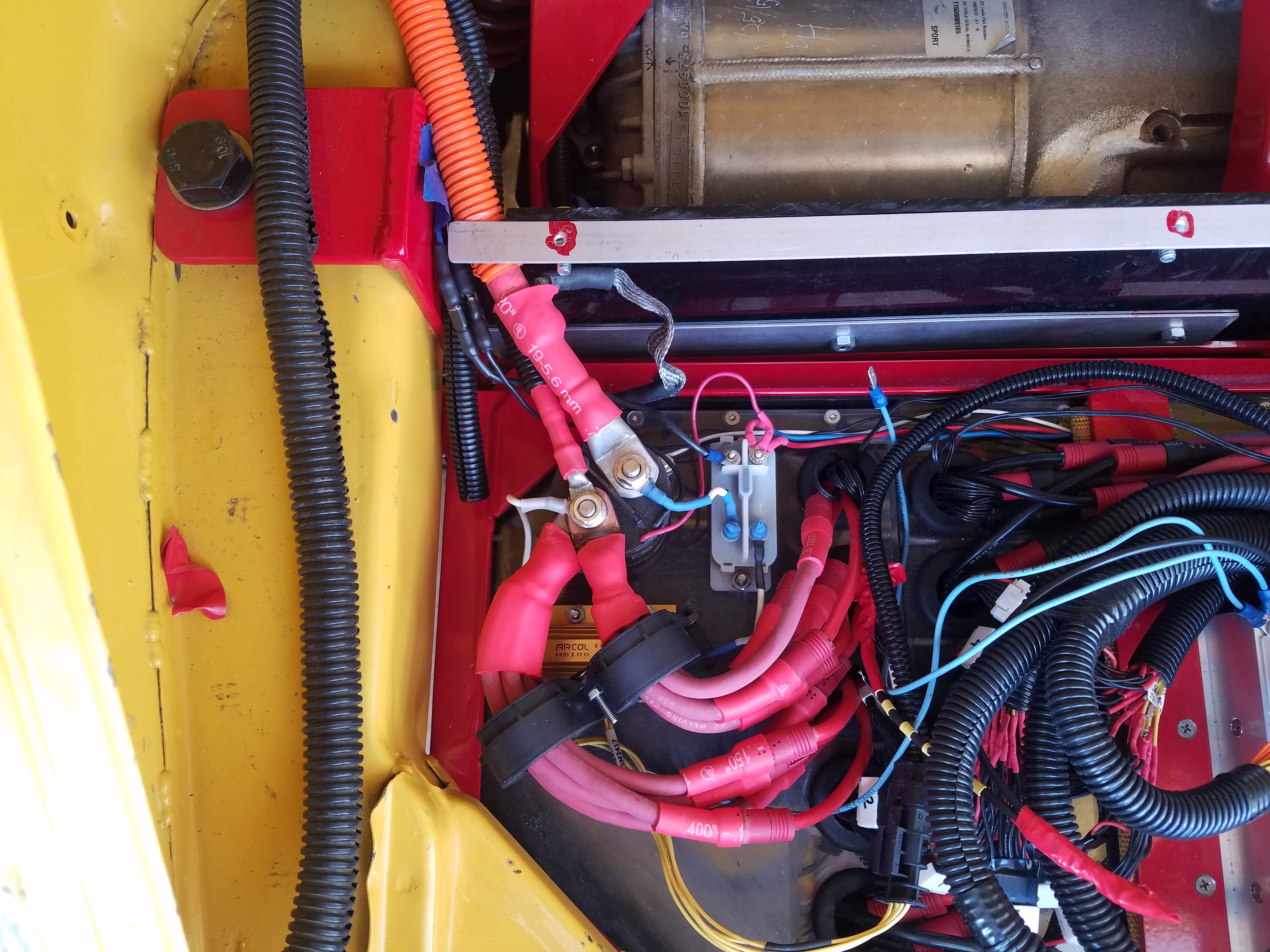

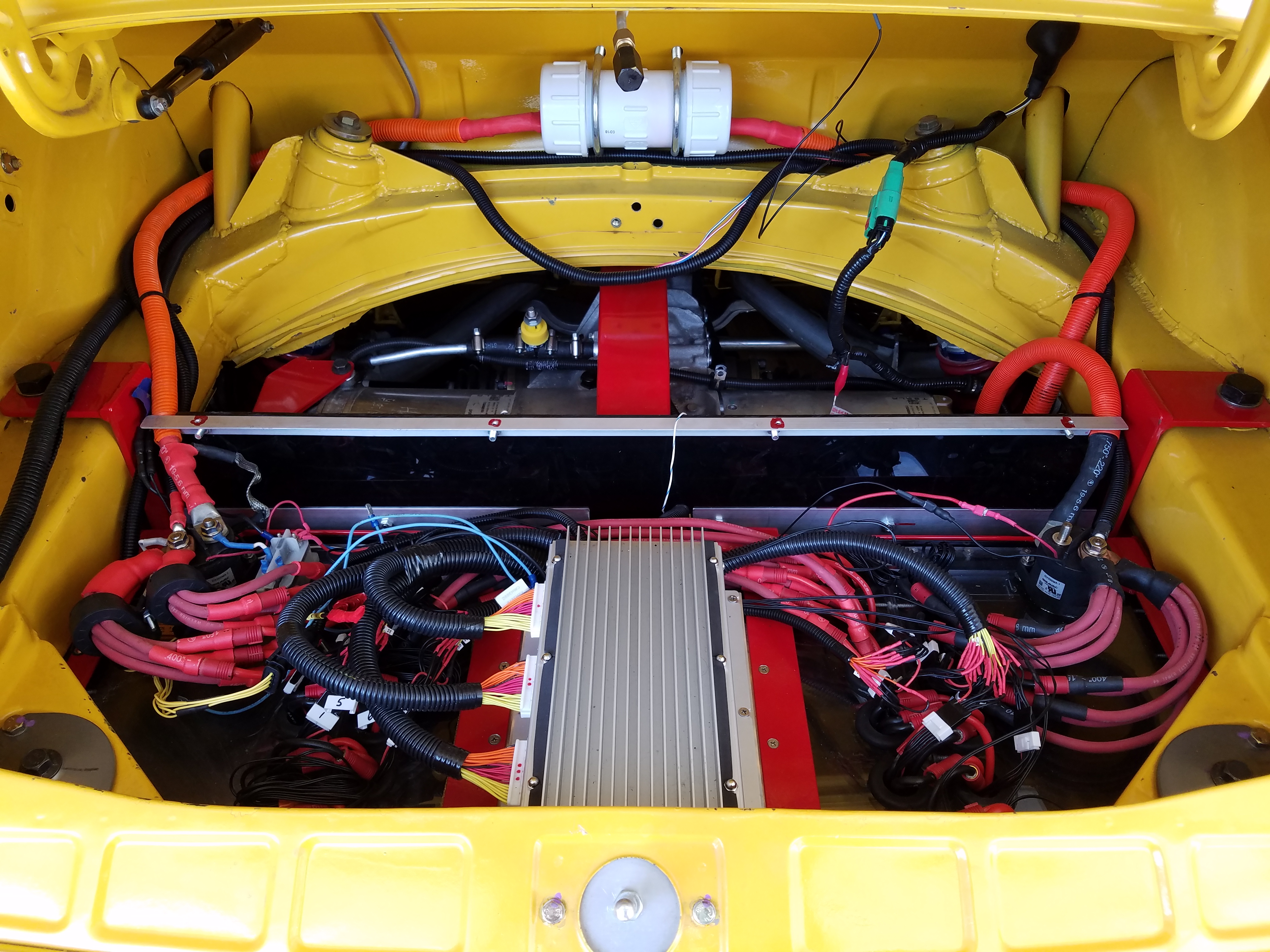

why I am asking is because I have come across an EV with 168 x 6s packs @ 4.1 (+- .1 ) volts each ( high capacity ) , making up a high voltage of 350 volts , 20kw battery pack . Would you use this type of HV battery for the race track driving for more than 40 minutes at a time without any type of cooling for the batteries ? . The best part is this person made the battery box out of plexiglass and the batteries are stacked 42 batteries in each group and there are 4 groups of batteries with plexiglass dividers and fully sealed with no ventilation . The owner bought the battery assembly from a guy in Texas USA * http://www.ampahaulic.com/ * . This battery configuration is screaming Danger to me !

This setup is screening death and fire !!! This is the car I am speaking about
The fuse is 3 feet of cable away from the battery and the charger is directly hooked up to the battery without any type of fuse . The charger is located inside the car 6 inches from the driver.

Yes the biggest issue using 'hobby RC' lipos is the making of the parallel connections.
The only 'Clean' 'professional' way of doing this would be single cells paralleled with a busbar before making the series connections.
Remember every connection is a potential issue, and the above example is a minefield of problems.

tom91 wrote: ↑Thu Sep 26, 2019 3:10 pm Yes the biggest issue using 'hobby RC' lipos is the making of the parallel connections.
If one of the cells has a problem and starts to vent or goes in to thermal runaway this whole pack is a bomb ! The battery assembly has a second layer of metal around the sides and bottom with no pressure vents . The people that thought this setup was a good thing should stay away from E.Vs .
