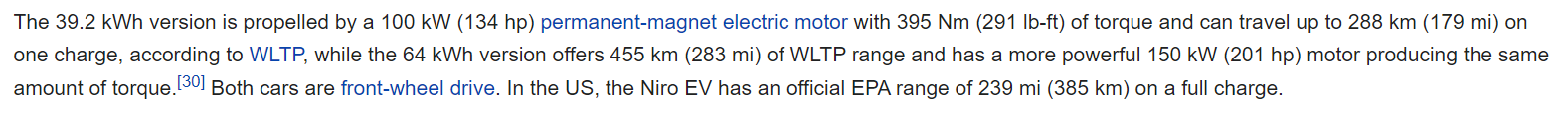

How much do you think you can squeeze out of the Kia Niro ev 150kW engine? How much can you overload it? I assume that its nominal power will be about 70kW.

I think i'd be checking on the differences between the 100kw & 150kw versions. If they are the same motors - then Kia may already be 'eating' into the headroom?
