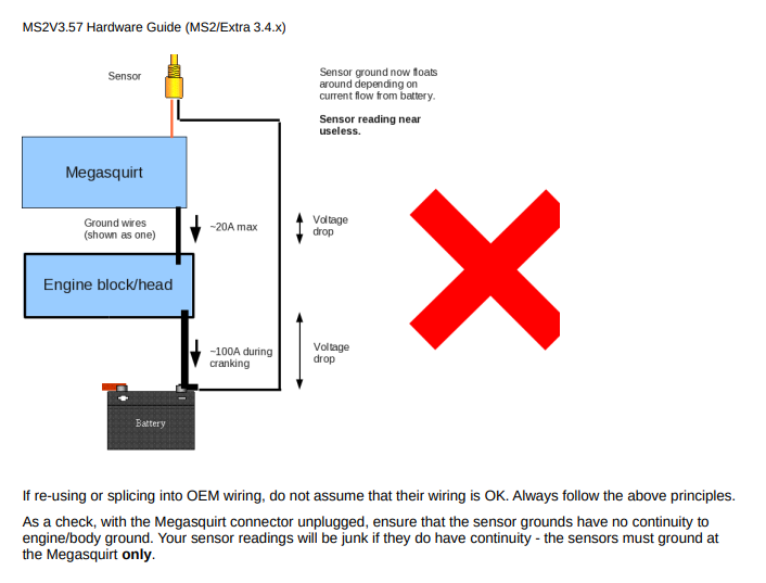

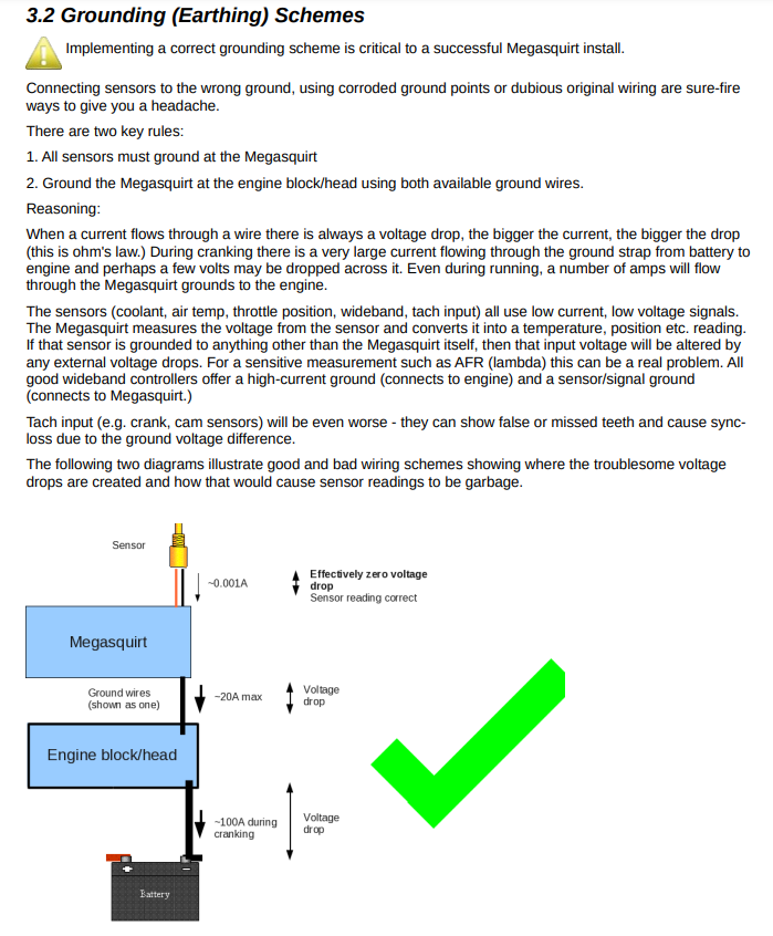

What is your sensor grounding like?
I have had issues with interference in previous ICE DIY ECU projects which was caused by poor grounding.
Maybe you can use the same principles?
From here:
http://www.msextra.com/doc/pdf/MS2V357_Hardware-3.4.pdf
From here:

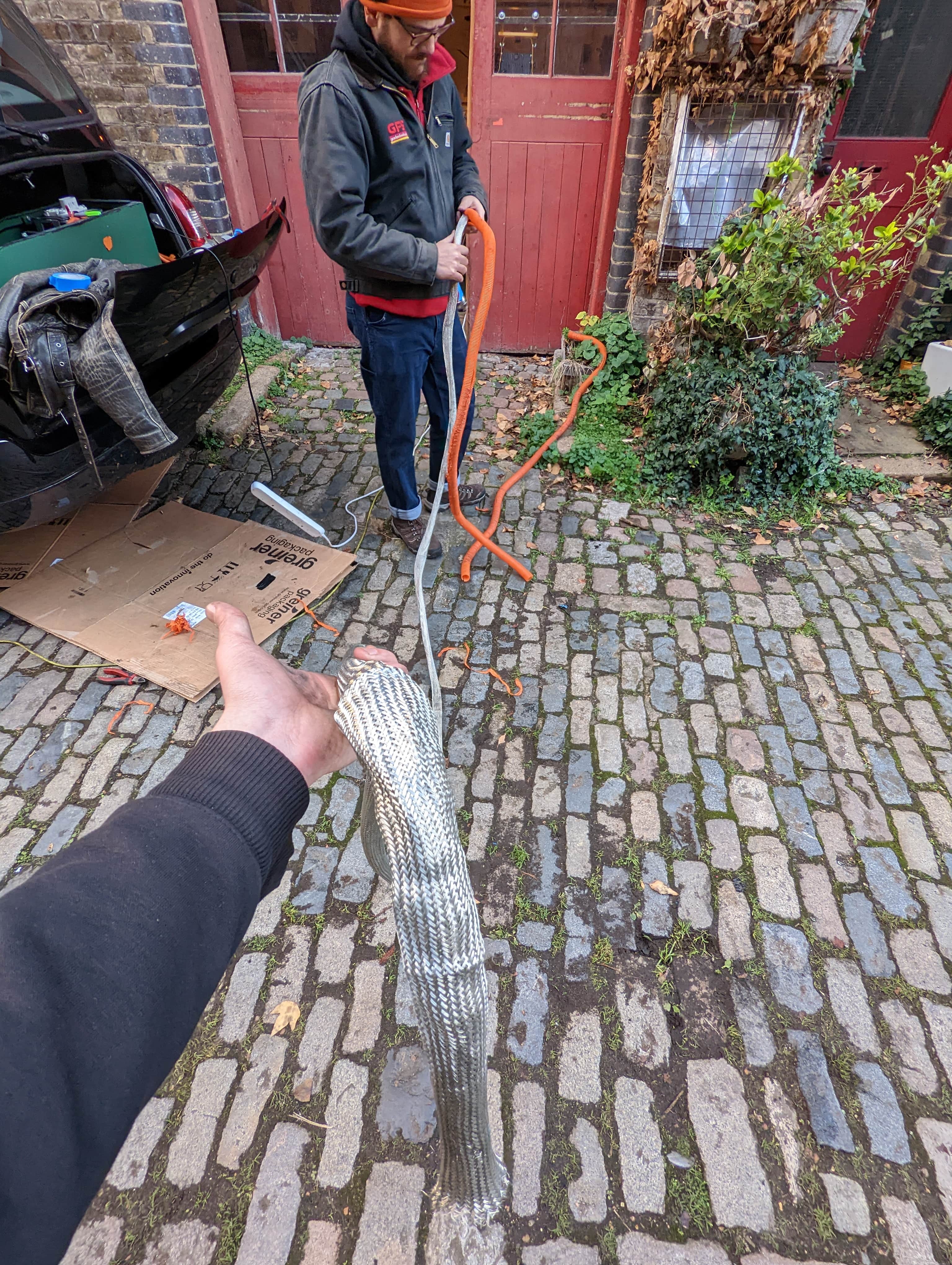

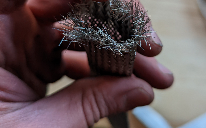

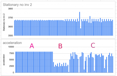

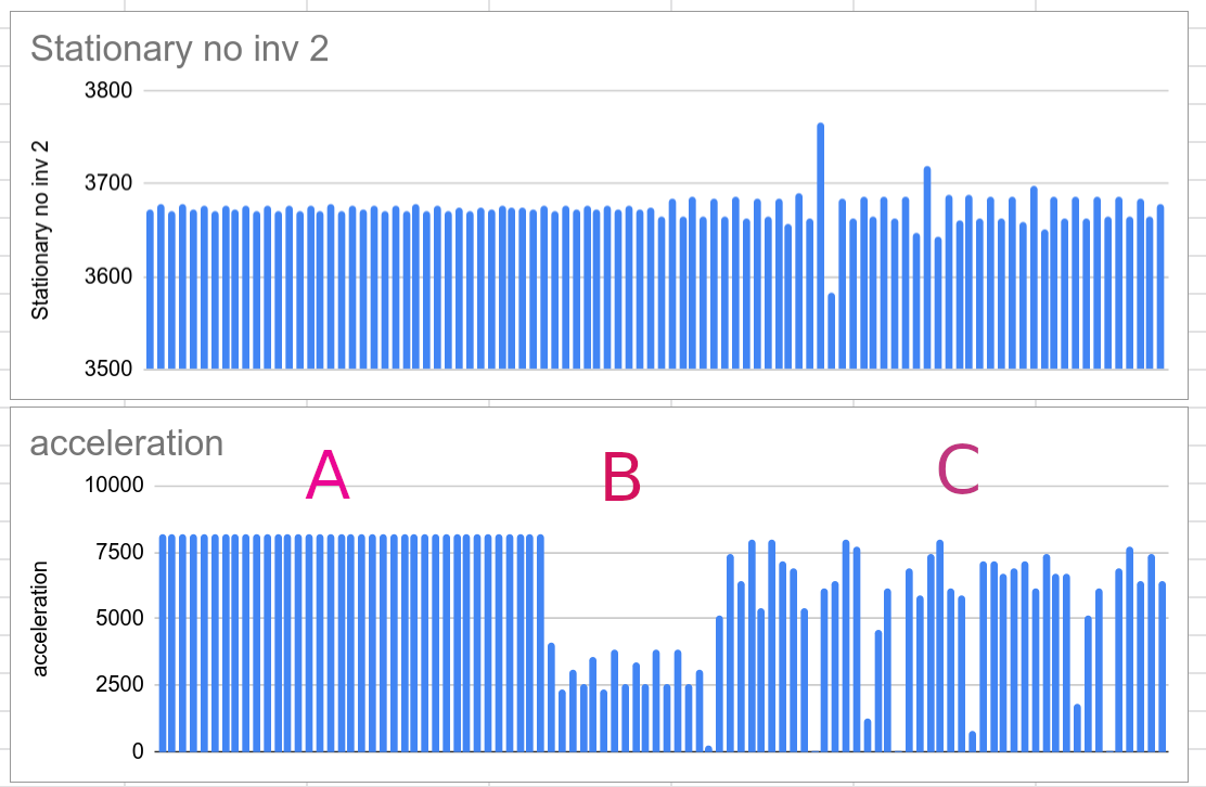

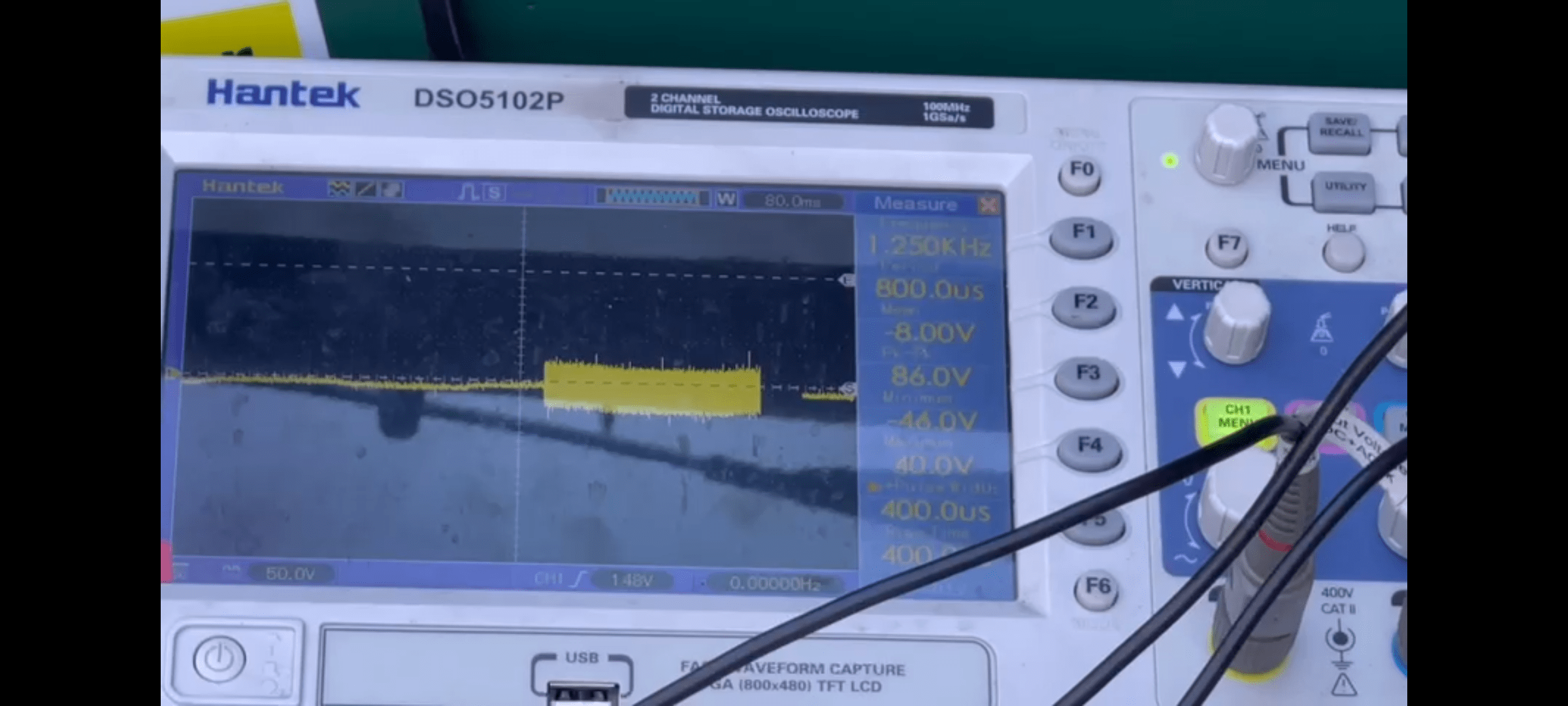

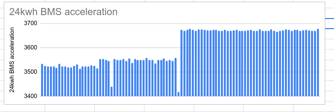

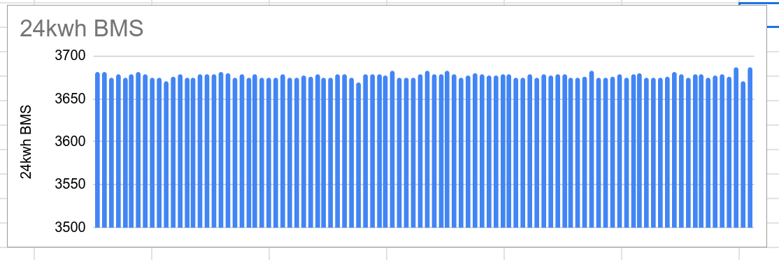

Ok, update on this:
Got the sensing wires out of the car, shielded them with a braided sock, faffed them back in, unfortunately same behaviour as before.
Now measuring at a HV sensing wire as close to the BMS as possible (rear), as opposed to on the 12V system above:
I now wonder:
- noticed the noise here is 1.25kHz, which doesn't match the 17.6kHz I measured before on the 12V system! very curious
- the noise only happens when the inverter is actually working (hard)
- adding ferrites seems to have made no difference
- shielding the long stretch of sensing wires seems to have made no difference (connected either end, gaps of ~20cm in front, ~10cm back)
I now wonder:
- is the noise being picked up inside the battery boxes where HV bus and HV sensing meet?
- why would I measure 1.25kHz noise when the inverter works hard and not 8.8kHz? Briefly even wondered if its the DC converter
- all the way back to the initial question (although today measuring on HV side), if I had some visibility to where it is coupled in I could try more.
- considering a load test on the sensing wires with an incandescent bulb to see if I can spot a weak one (measuring voltage drop across the wire), laborious with 48 wires though, but not impossible

I'm wondering if the problem is actually due to the split pack and the voltage drop across the HV power cable running between the two. The longer cable run will cause a much higher noise voltage to appear across this cable and so across the BMS tap for the cell next to the split, and the BMS won't have been designed to cope with this. This would fit with it only occurring at higher load = higher current = higher voltage drop.
If it is this then the screening you have added wouldn't do much. Increasing the gauge of the HV cable between the two packs might help though?
On the measurement I wouldn't suggest trusting the scope automatic measurements too much, they can often be wrong unless everything is set up just right (and I can't see the 1.25kHz periodicity in that screen shot).
Edit - on measurements like this is is also worth saying what you were using as the earth reference on the scope as that can make a big difference to the measurement (the BMS and the scope could easily be seeing totally different things).
Edit2 - forgot to ask, is it always the same group of cells or is it random? The former would suggest the above especially if it is a group next to the split. The latter still could if it is always groups on the same side of the split.

For the HV sensing measurement above we used the vehicle chassis (which I know is not ideal as HV (-) is not connected to chassis.
I should re-measure with HV (-) as GND!
And yes, we ought to use a master/slave BMS really, but here we are, I am band-aiding these to work as intended before moving onto a redesigned v2 or v1.1
Thicker gauge wires is a good idea, but it doesn't appear when rapid charging at 120A. Only when the inverter is on, so Amps don't seem to be the main problem here (I think).
On the 12V interference a few weeks ago I used 12V (-) as GND for the scope.Pete9008 wrote: βTue Nov 29, 2022 3:16 pm On the measurement I wouldn't suggest trusting the scope automatic measurements too much, they can often be wrong unless everything is set up just right (and I can't see the 1.25kHz periodicity in that screen shot).
Unclear, currently the BMS just gives MAXINT for all cells, so I don't know which cells specifically are giving problems at the moment, but I have previously measured MAXINT for most of the front box and okay-ish values for the rear.

The fact that fast charging doesn't cause it would suggest that it could be more the volt drop due to high frequency noise currents. If this is the case then cable inductance could be just as important as resistance (not good as increased gauge cable then wouldn't help that much). One way to test it would be by trying to reduce the hf current and the only way I can think of doing this is to add capacitance. Is there any way you could temporarily add another hv capacitor module between between the inverter and the battery to see if it helps?
The scope earth reference is not an easy one, I wouldn't trust any of those for these types of measurement , as they are all likely to introduce extra noise, and so would be wary of drawing conclusions purely from scope data The important earth reference is the one the BMS is using its but not easy to access or safely use (and definitely not to be recommended doing with a mains powered scope!).
Btw - I'm assuming it is a Leaf bms is being used, is that right?

Regarding this, I have not actually measured the whole bus HV (+) to HV(-).
I have measured:
- 17.6kHz on the 12V system
- "1kHz" noise between cell tap and chassis GND.
Pete9008
- Posts: 1801
- Has thanked: 102 times
- Been thanked: 351 times
Re: Interference: How to measure and fix it?
Wouldn't take any risks with the scope. For this type of measurements there are so many ways for the scope readings to be invalid its just not worth the risk. For problems like this, where it is either difficult or dangerous (or both in this case!), the best approach is often to try to come up with theories for what the problem might be and then come up with a fix or test to see it helps. Even if it doesn't work it often gives you another clue to what the real problem might be.
Got to say that this is the type of problem that I always used to dread (although having said that, there was also a large sense of satisfaction when they were finally fixed). Good luck with this one!
One other thought. There must be one cell tap wire that is one one side of the split but that is actually feeding bms modules on both sides. Would it be possible to add a duplicate sense wire to avoid this?
This link might also be usefull although not sure whether its applicable to you modules? https://www.mynissanleaf.com/viewtopic.php?t=17470
Edit - My guess is that you will see the 17.6kHz just about everywhere, regardless of what ground reference you use
Curious what the 1.25kHz source is though?

yes the pack is split right through the middle where the service disconnect is.
Just reading through that thread now, one thing to note is that from the 24kWh pack to the 40kWh pack they changed the sensing chips, I was just mulling their datasheets to see if I can interrogate one of them individually, but that is getting into quite a level of detail that I would like to avoid for now: https://www.maximintegrated.com/en/prod ... 7823B.html
