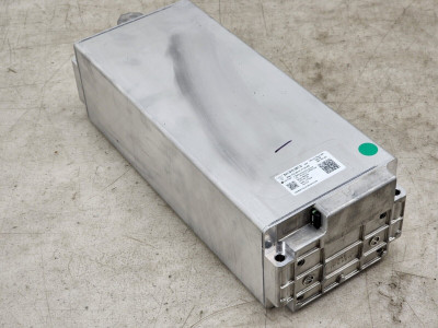

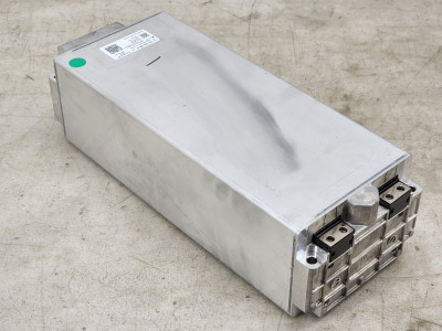

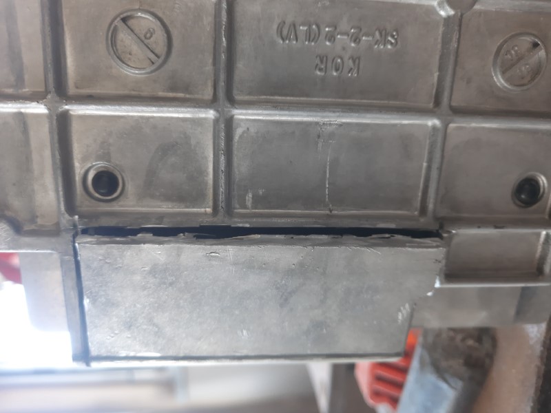

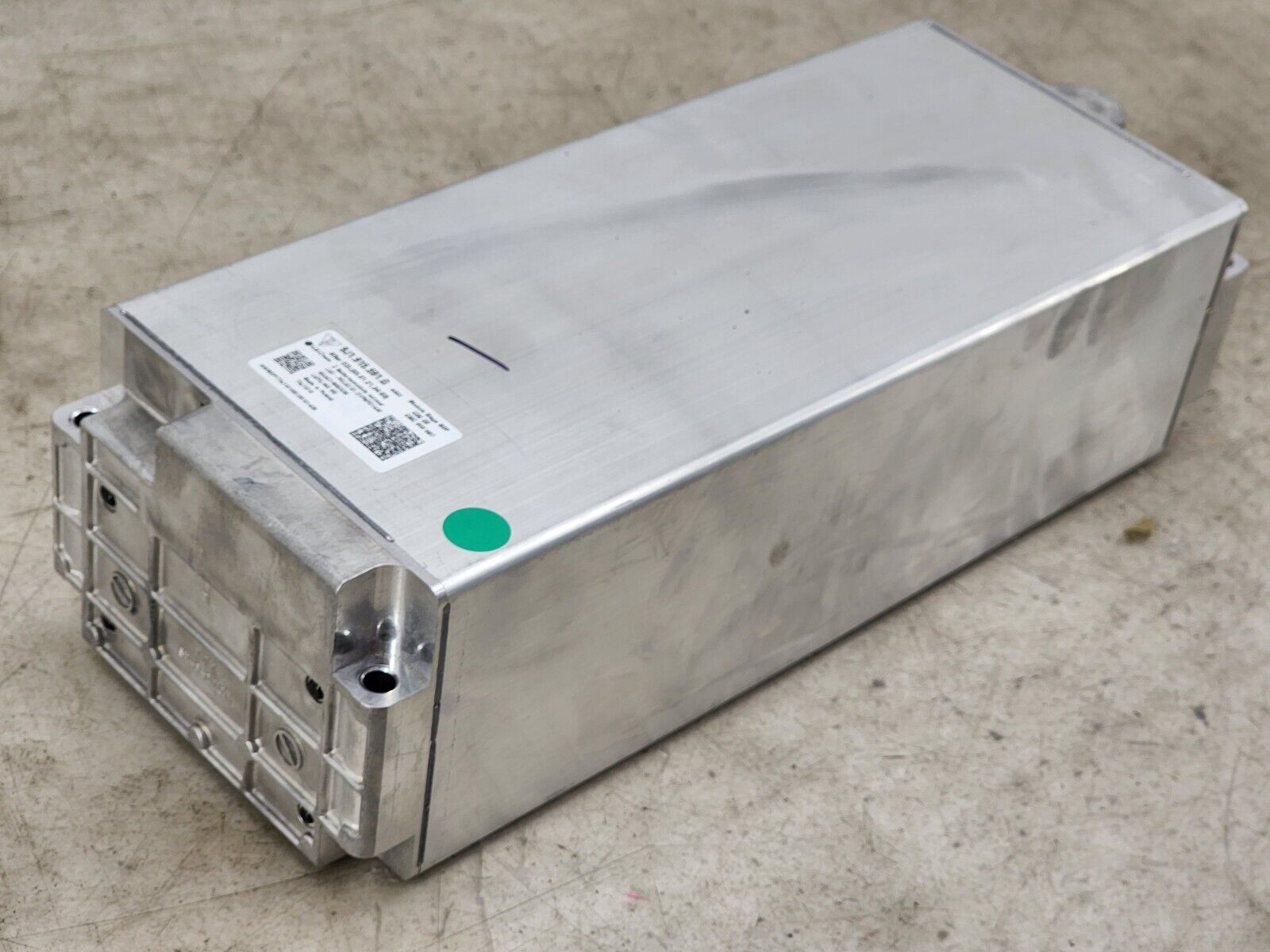

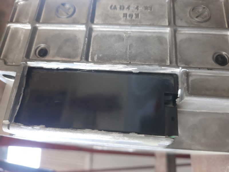

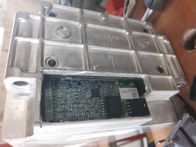

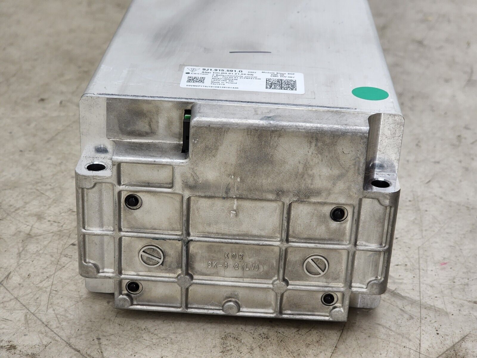

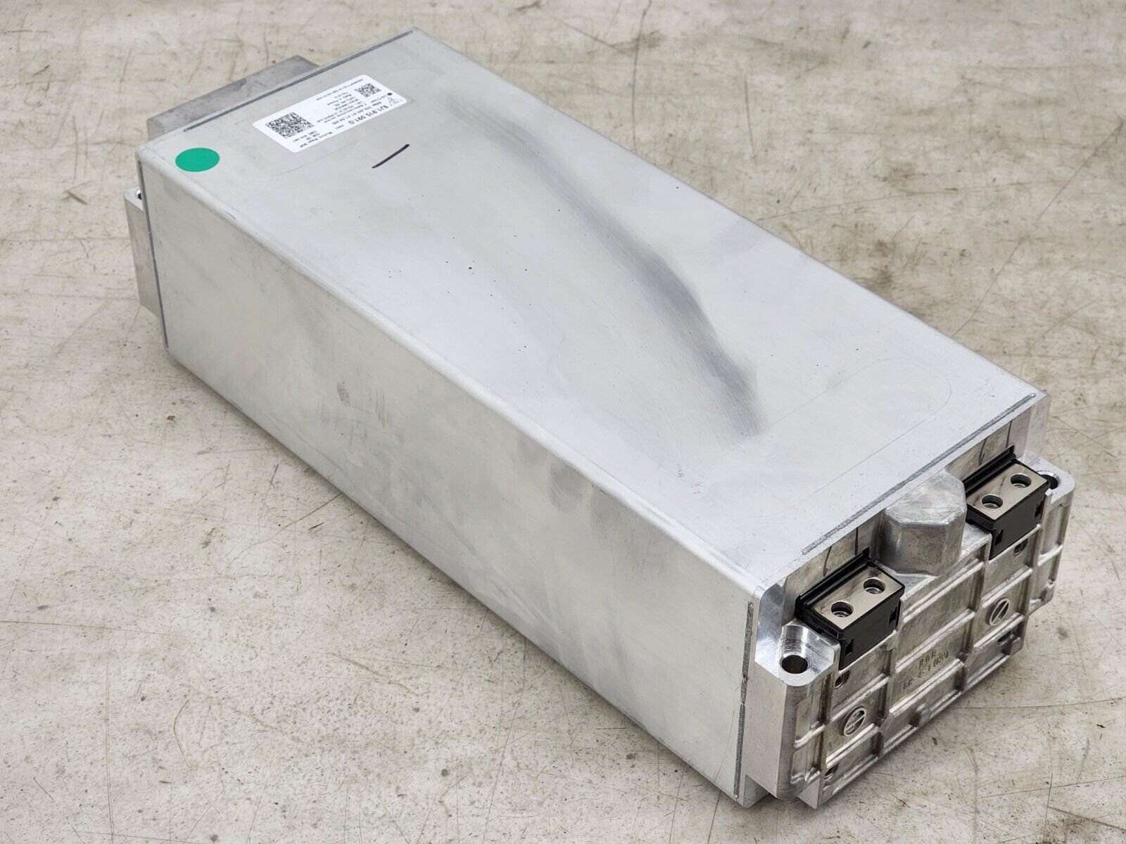

I am thinking of buying some for my car, but because of the bms they need to be cut with a grinder to access the individual cell voltages.
A small window may be a better alternative to cutting the complete side of the module.
What is your experience with these modules?
6S2P 120Ah

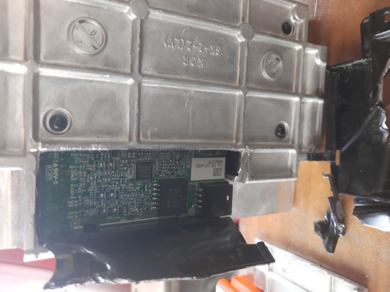

This is just horrible to open, i understand why people just cut the complete side panel...

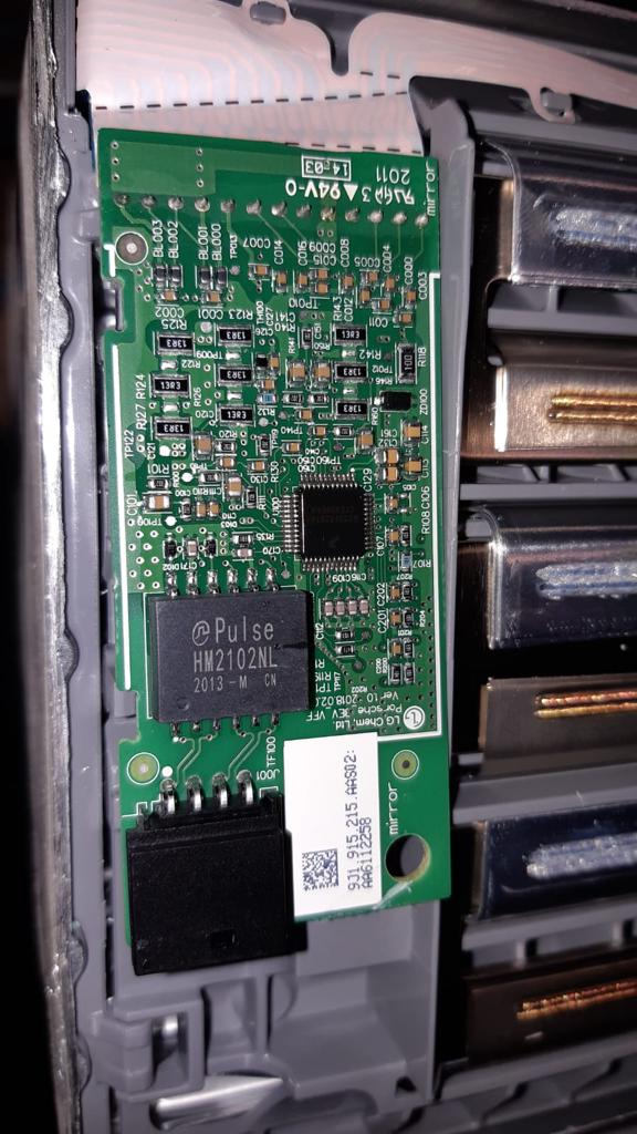

If there's a slave BMS module in there, you should 100% use it. This will be much more reliable and much safer than trying to wire in your own cell taps.
Unfortunately a lot of people do seem to discard OEM slave modules though, because they want to use Orion BMS for CCS system compatibility, but unless you have a very good reason, you're better off not cutting them open!

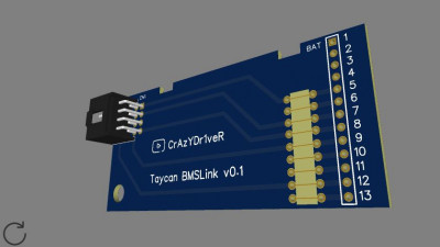

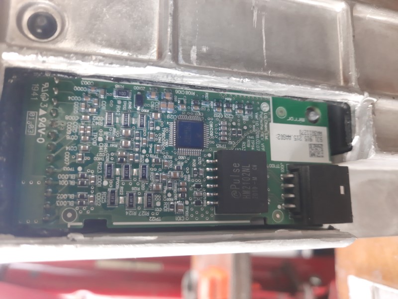

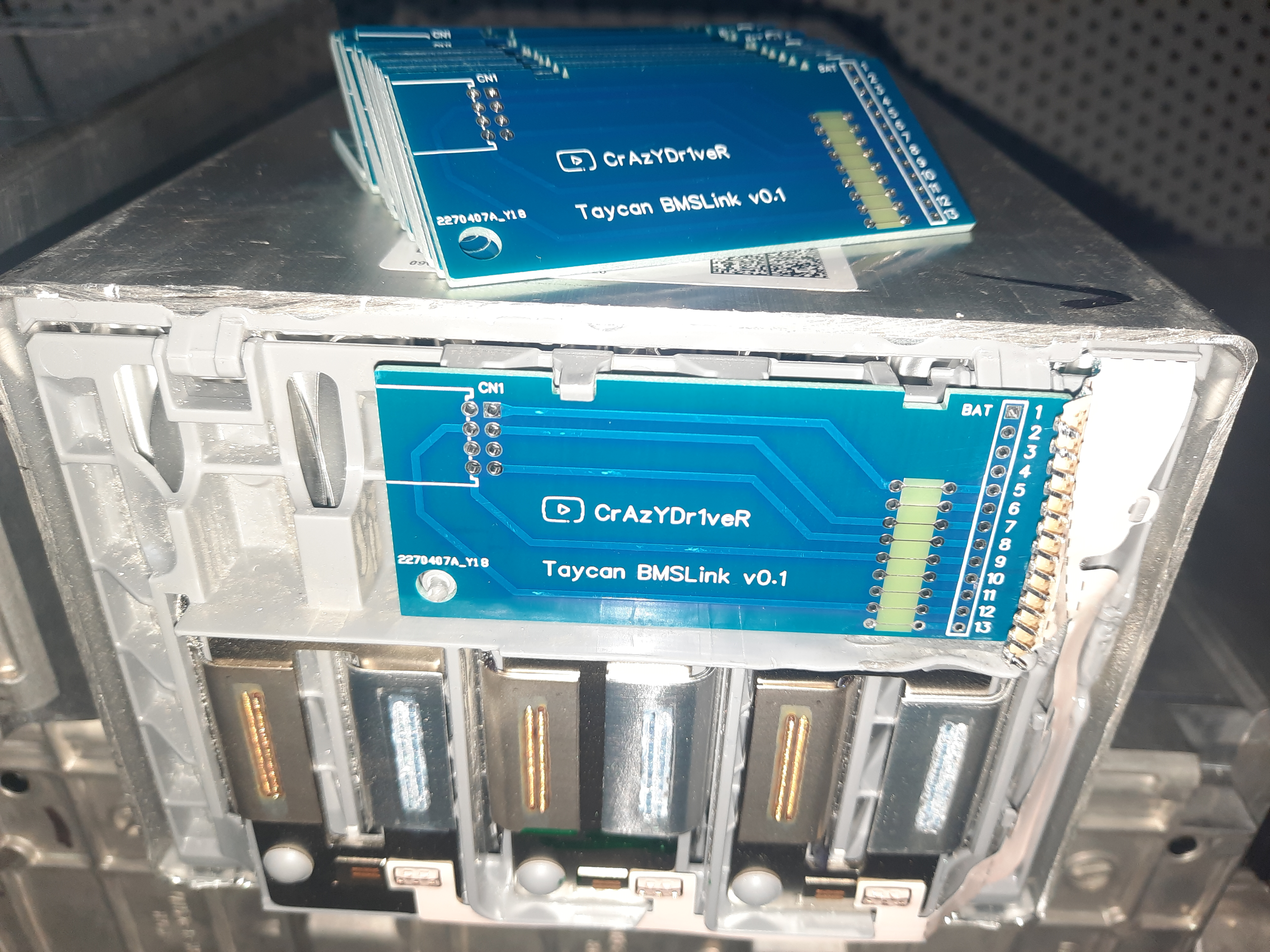

I think a little slave board inside each module should work, and with fuses because Damien said so.
If i'm wrong at least i learn something.

CrAzY_DrIveR wrote: Sun Nov 13, 2022 5:40 pm ZombieVerter will work with your bms and leaf charger but no leaf power steering and power brakes.
Ok, but its possible the lead BMS complains about the increased size of the battery.
And soldering those wires to your ready made board is quite the act so to speak!
Nice board btw!

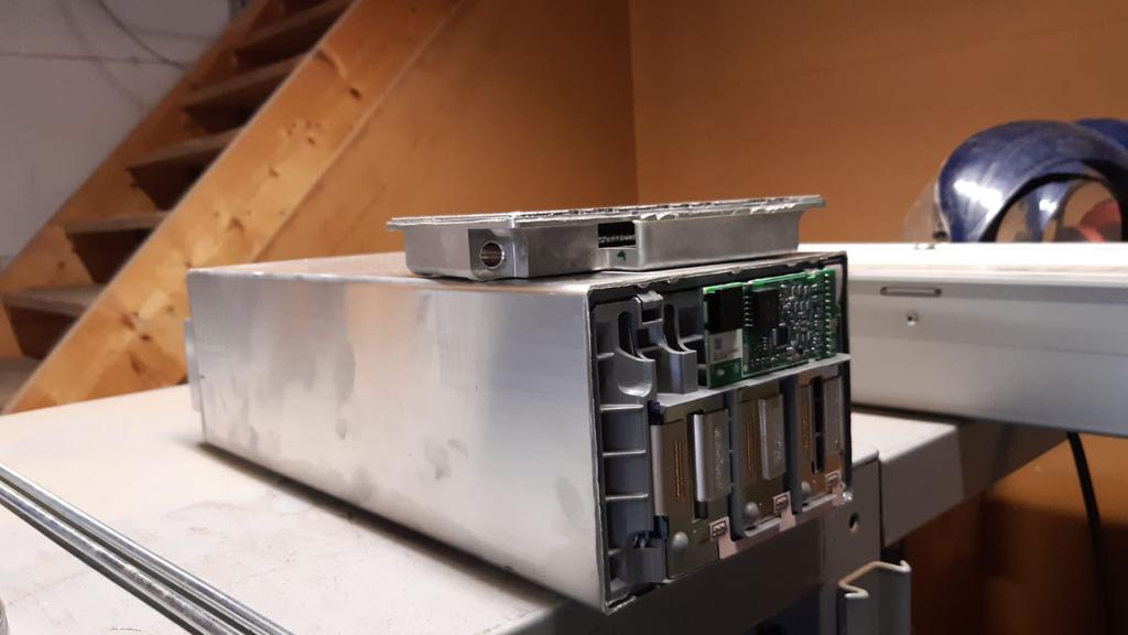

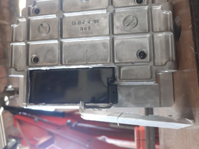

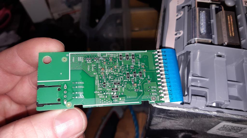

soldering is easy, desoldering was not a joke with the small window i almost destroyed the battery because the heat
travelled through the aluminium tape that i used to protect the cells.
That is why i had to cut the complete side and it was very easy.
The board is just a little easyeda pin to pin conection, let's hope it fits.
