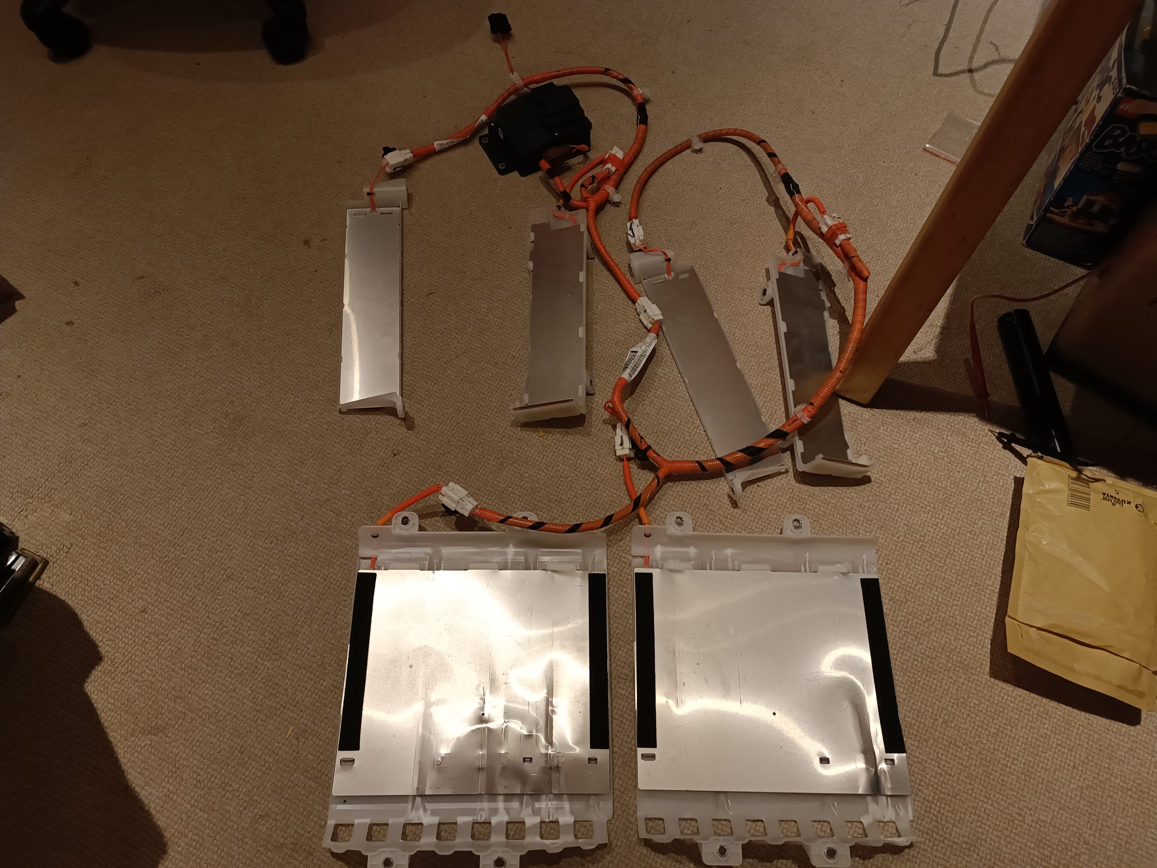

Hmm.. i noticed up there most cars use diesel webasto coolant heaters to keep the engine warmed up. Mind you the legislative reason for webasto is to keep the engine at optimal temperature when it starts - ecology, not driver comfort...
You could setup a y junction and take some of the coolant to the batteries and setup some alu tubes under the cells to prewarme them for charging.

Wow, that sounds terrible. Nissan BMS allows full power up to 52°C or so and then derates power so 57°C is never surpassed. Longest trip we completed on one day was Malmö to Kassel, I think 700 km and 4 charging sessions if I remember correctly.
I will install Nissans "cold climate" heating pads if we decide to use the car.
