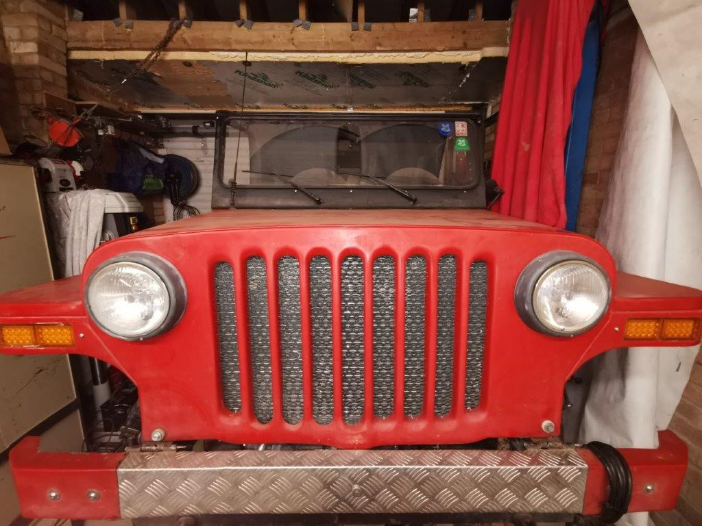

EV conversion Grandin Dallas Jeep Base on Peugeot 205 running gear
Post by snelly »

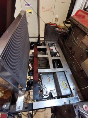

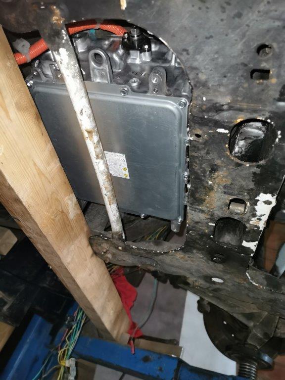

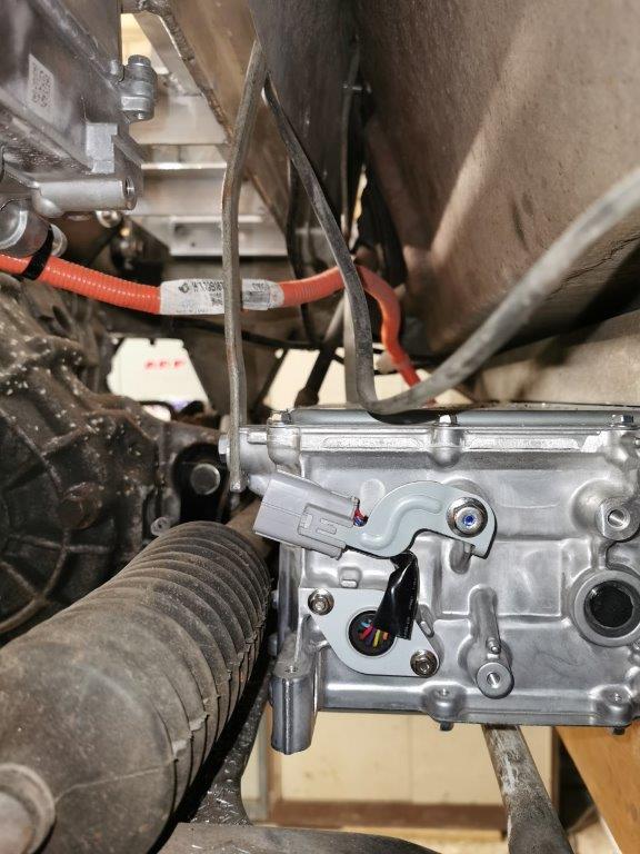

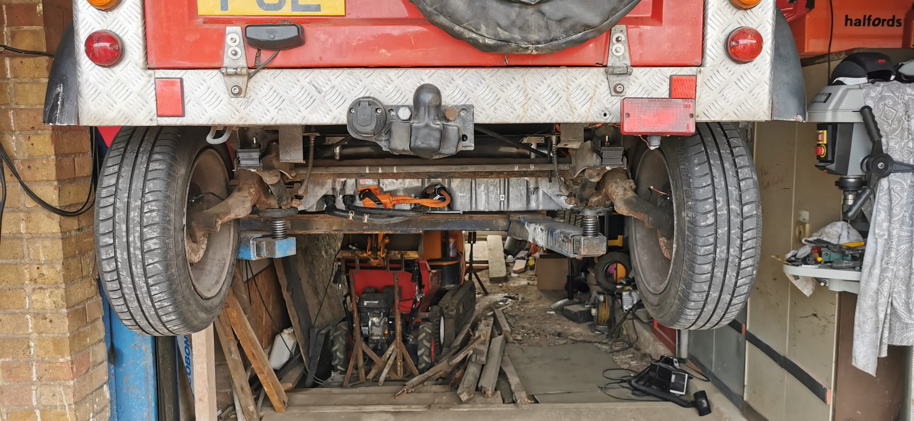

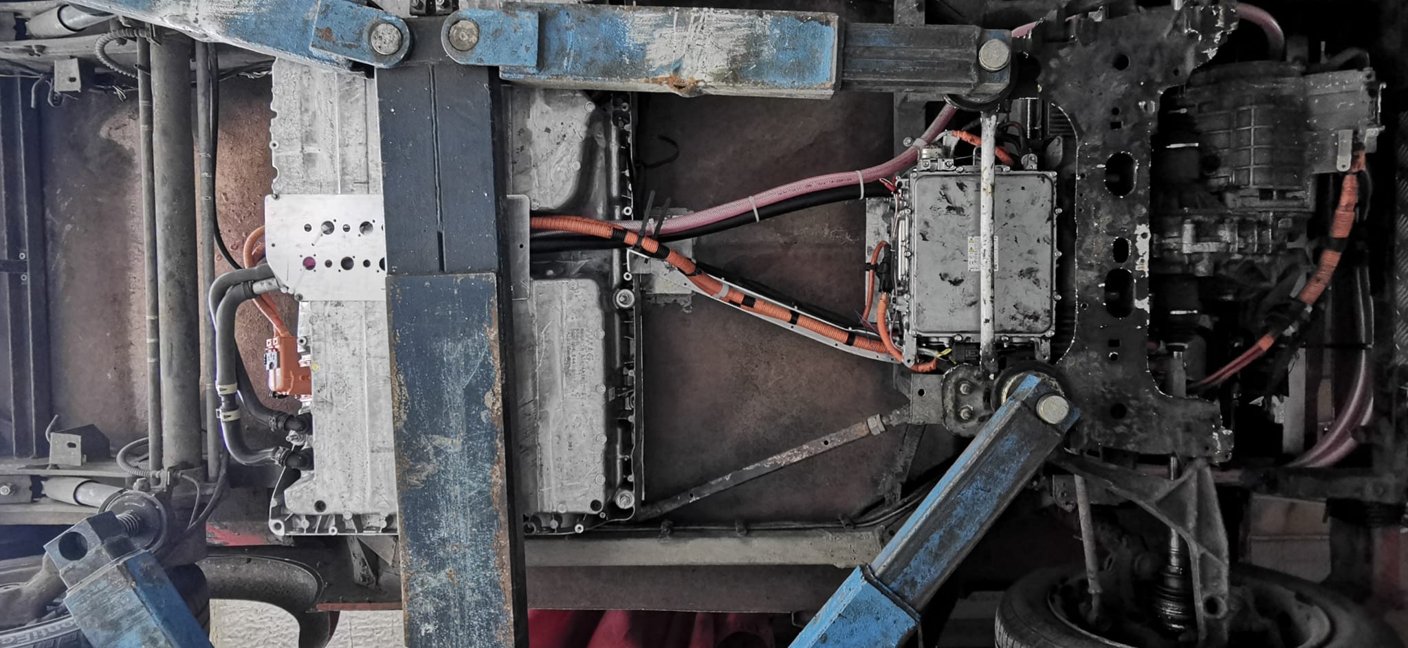

Using Outlander motor, inverter and charger.
With Golf GTE hybrid battery pack
https://en.wikipedia.org/wiki/Dallas_(jeep)
https://www.jeepdallas.fr/jeep-dallas/j ... en-detail/

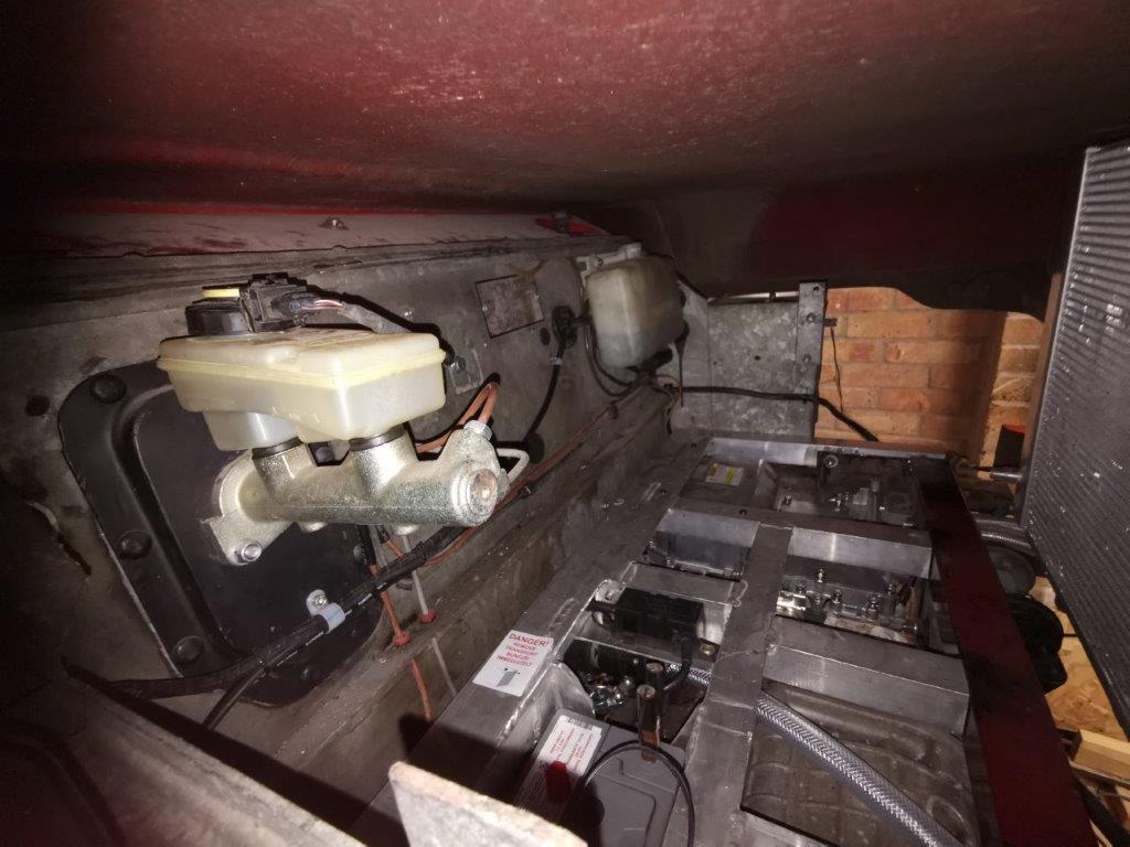

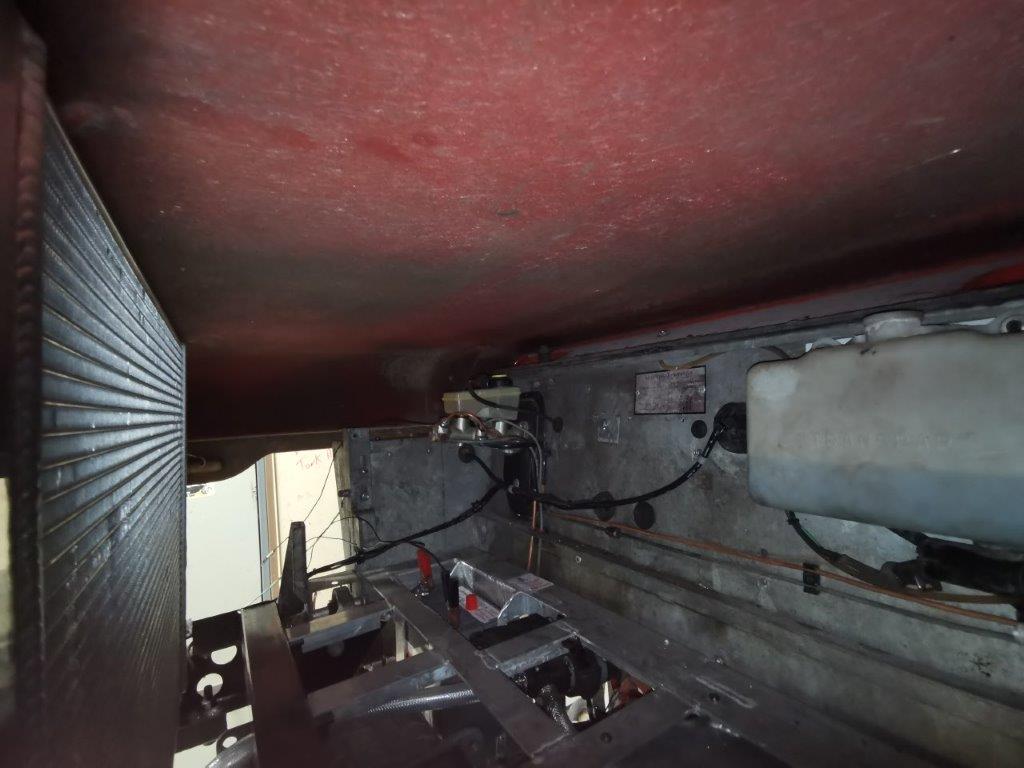

more pics

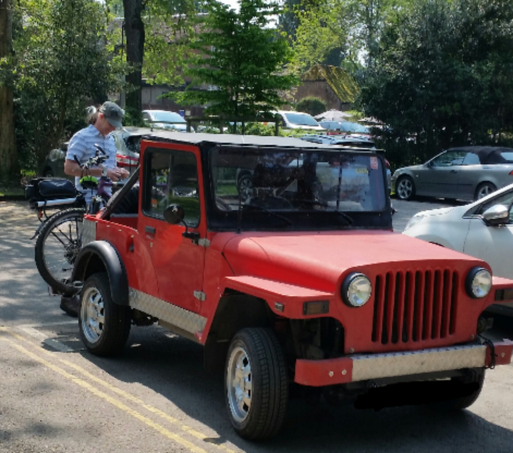

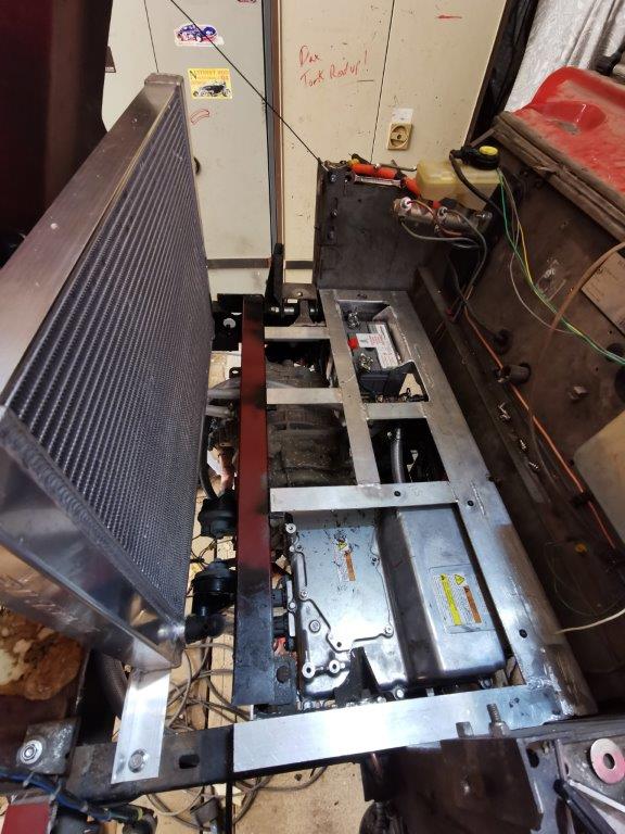

more pics

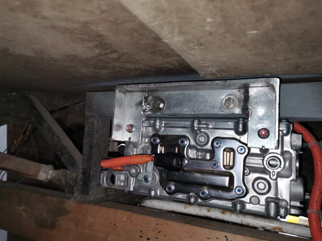

Posts: 1884
Has thanked: 91 times
Been thanked: 517 times
Re: EV conversion Grandin Dallas Jeep Base on Peugeot 205 running gear
That's a Passat GTE pack by the way.
snelly
Posts: 74
Joined: Sun Dec 26, 2021 11:54 am
Been thanked: 12 times
Post by snelly »
thanks i think it use in the new golf now ?
Posts: 1884
Oh, not sure on that one, looks very much like the Passat but they might have changed to the new golf.

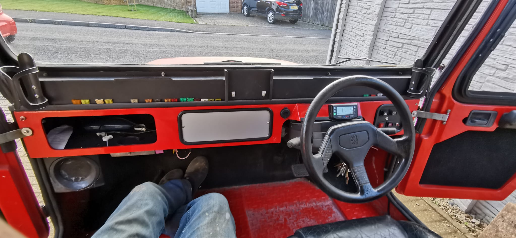

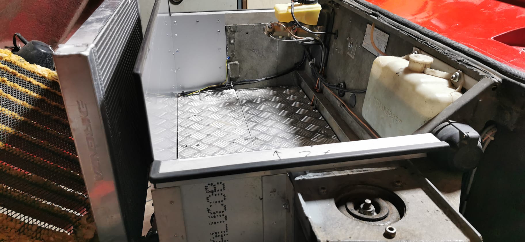

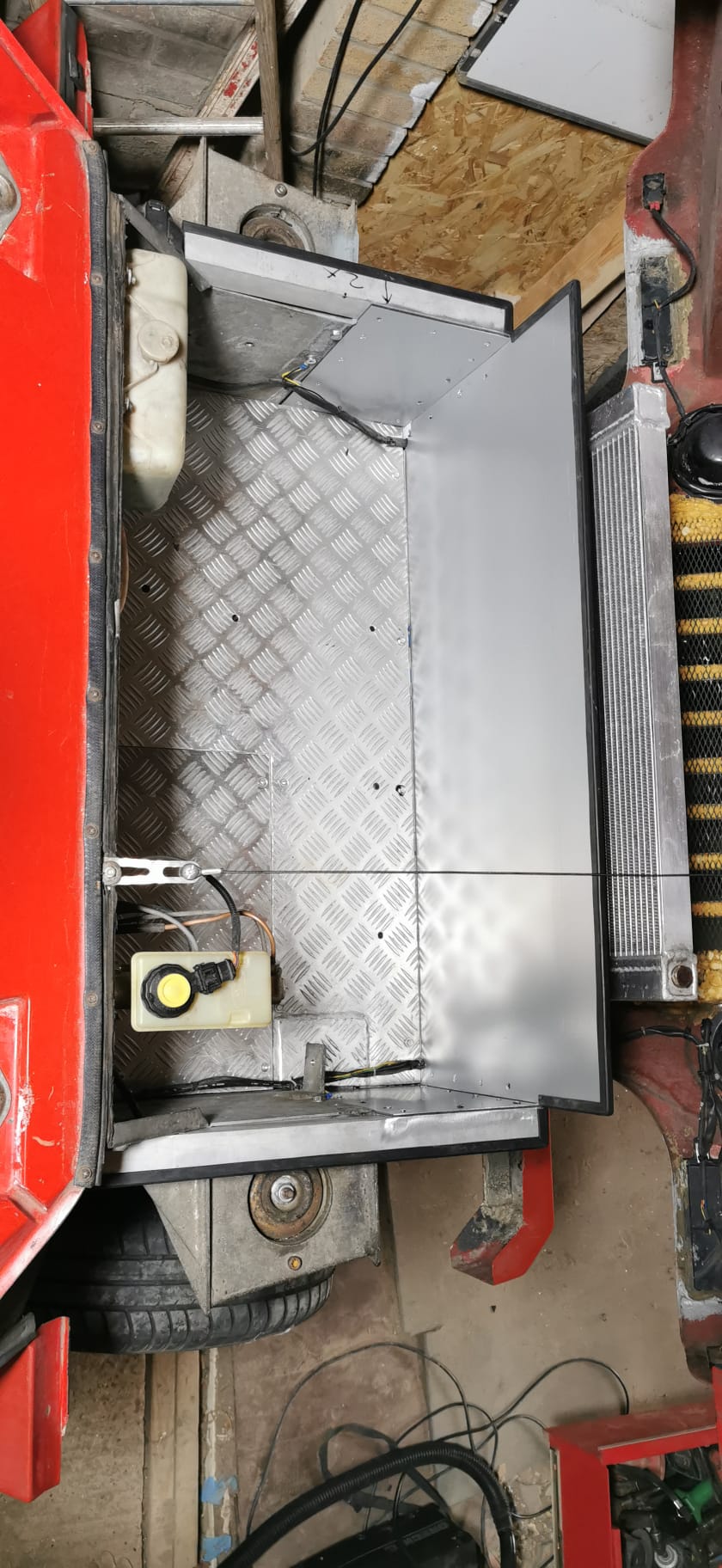

updates need to make boot floor :)

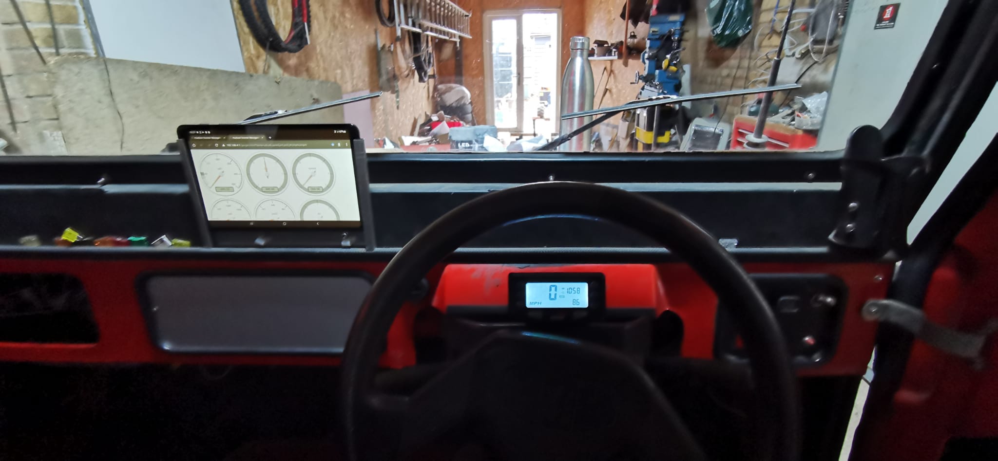

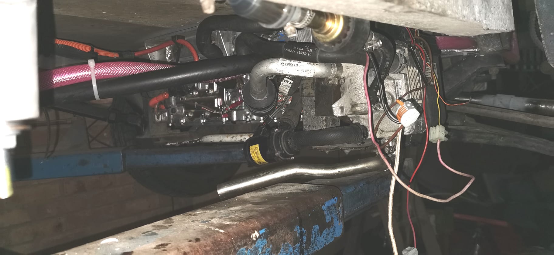

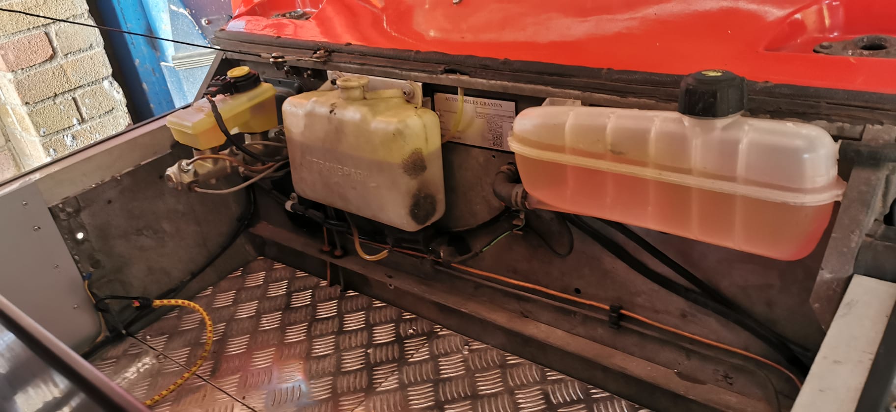

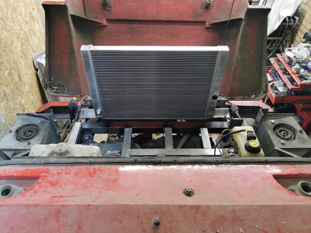

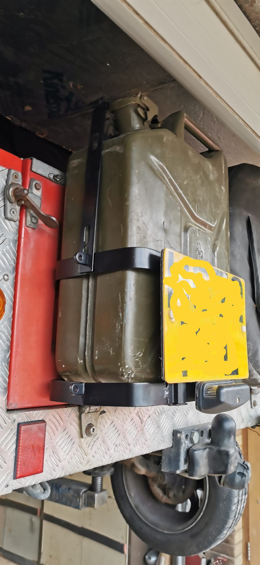

[WIP] DVLA Registered as EV conversion Grandin Dallas Jeep Base on Peugeot 205 running gear
Post by snelly »

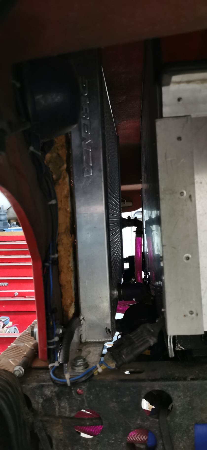

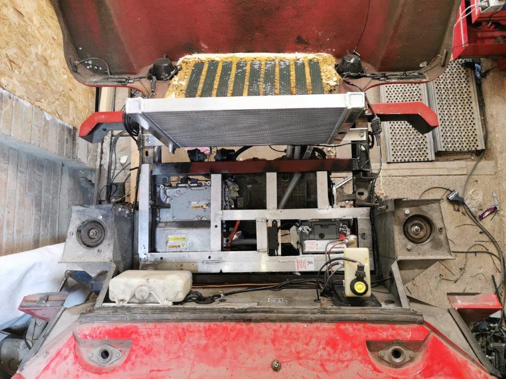

big rad for passive water cool

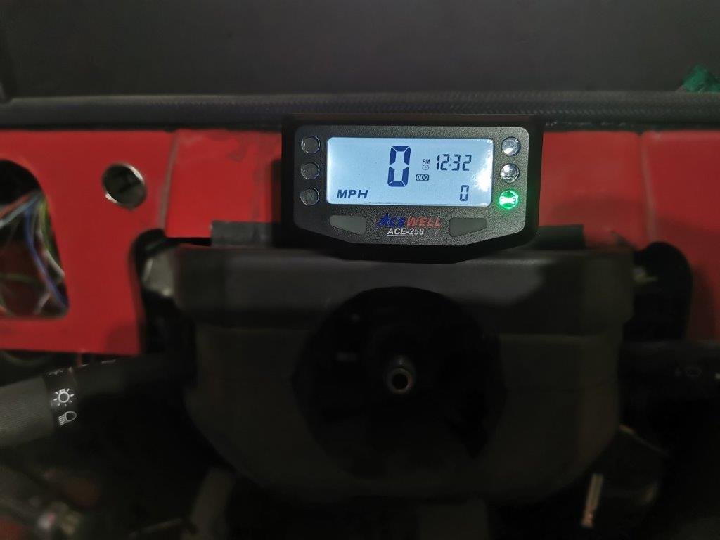

New Speedo

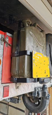

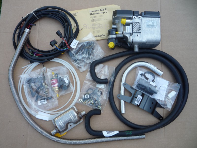

12V Webasto diesel engine block running of home heating oil

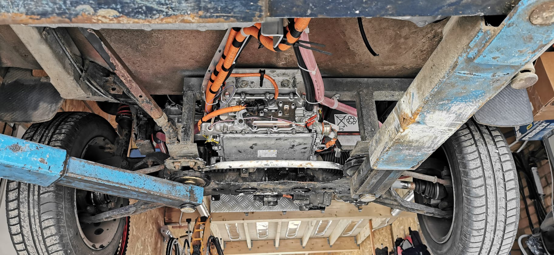

Now DVLA registered as Electric

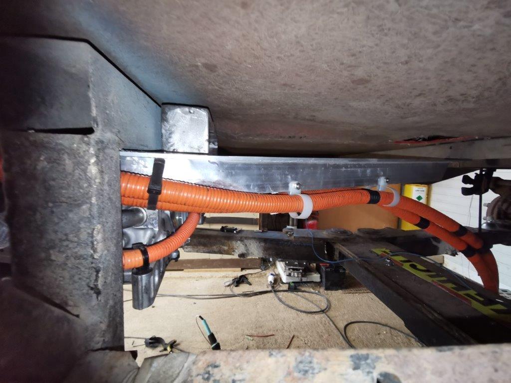

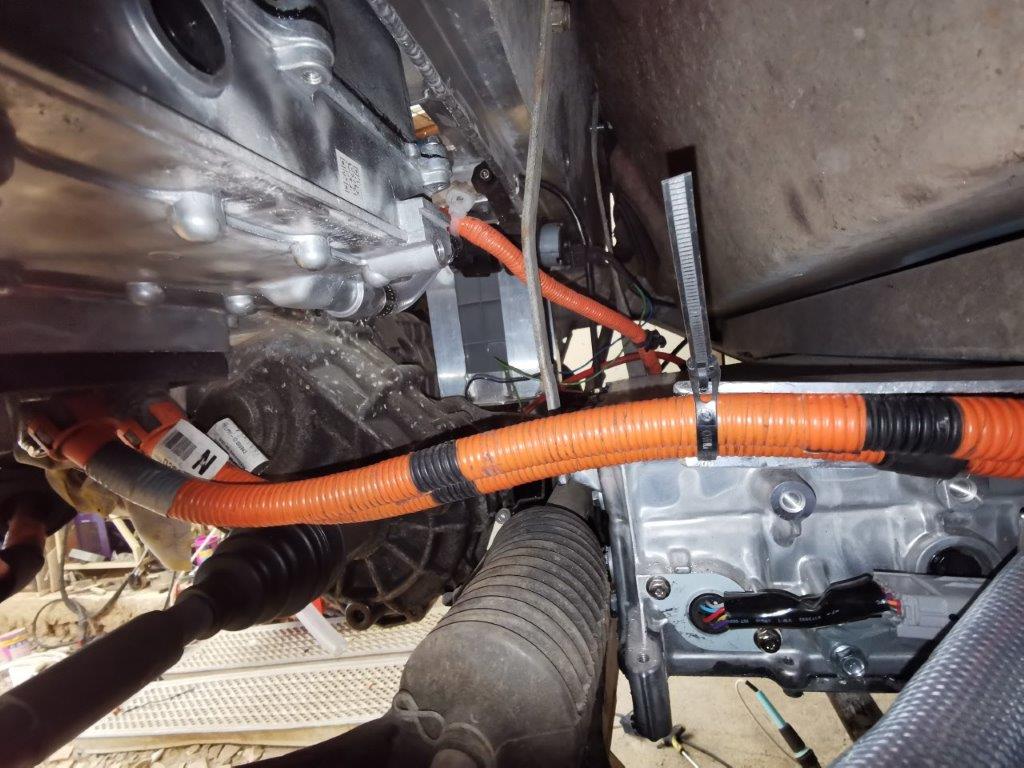

[img][/update
