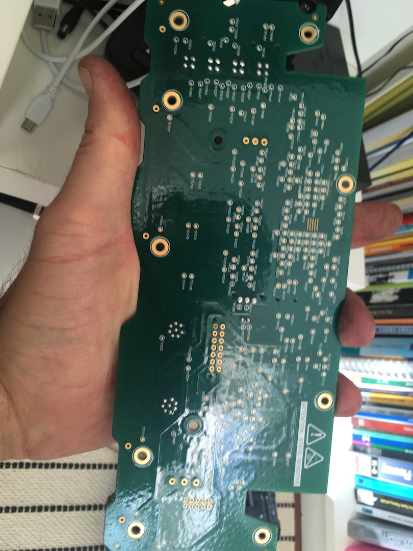

It's a 2014 Brammo Empulse R. The battery was having various faults and making the bike unusable for the previous owner. I'm very much a DIY person, love tinkering and love bikes so I thought I would grab it and have a go at repairing it. I narrowed the fault down to a balancing issue. The onboard charger stops charging if it detects one module out of limits, tries to balance the cells by bringing down the high cells then commences charging again. The problem was that the high cell wasn't coming down so the charger refused to charge anymore.
The module out of balance was no 1 of 7 and after pulling apart the battery I found out why. The battery has 4 internal heaters that are used for heating (obviously) and also for balancing when commanded to. Due water ingress part of the module's controlling PCB had some corrosion and component damage which has stopped the heaters from working which is why the charger couldn't balance the pack. I've cleaned up the corrosion with some vinegar which seems to have worked. I now need to identify the damaged components and replace them and hopefully get this bike working again.

I may need some help identifying some of the components on the PCB. I've also managed to source some faulty modules from another bike which I can use for spare parts. I think I should be able to de-solder the components from the damaged battery and put them on mine to make it work.
