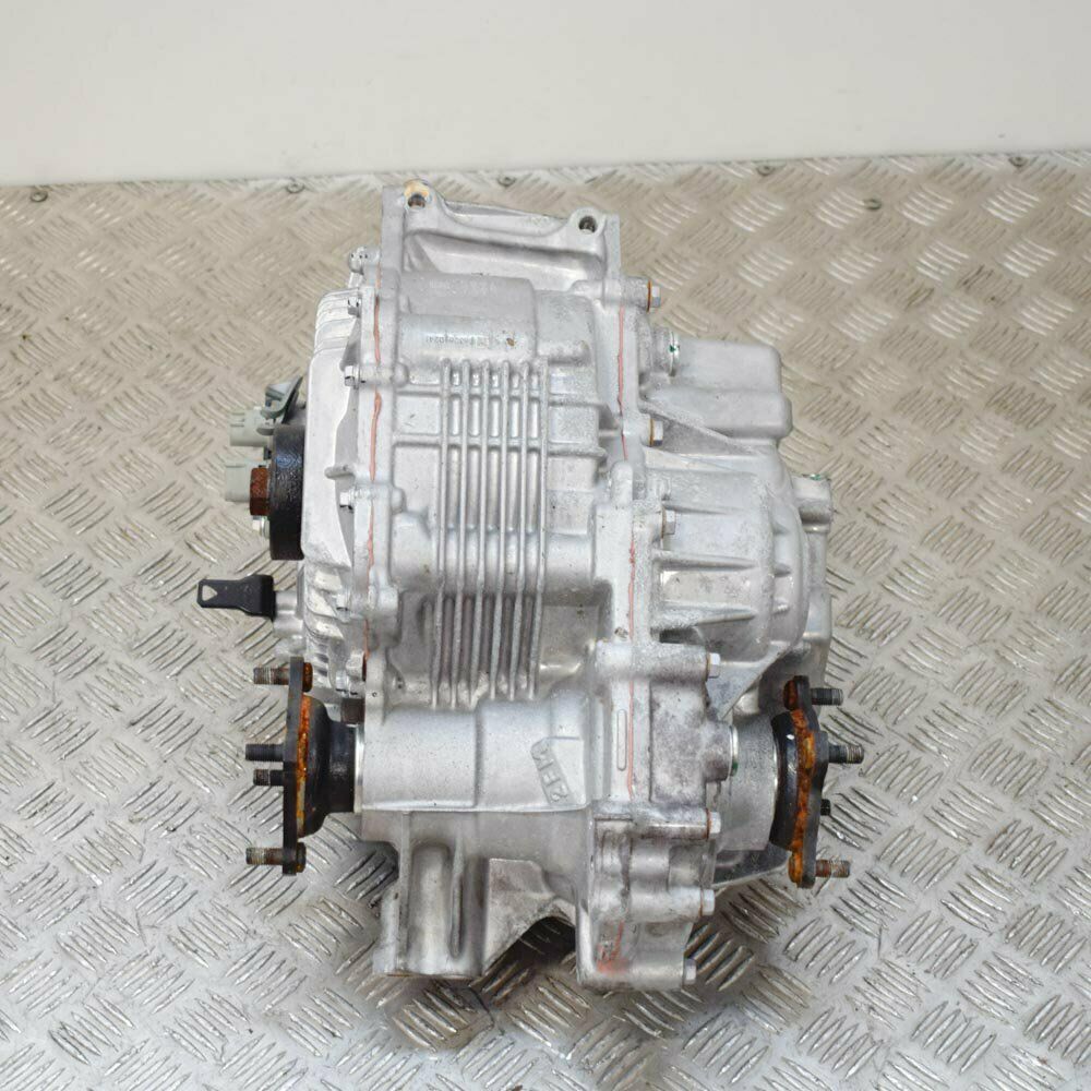

Has anyone looked into this beauty?
good power, compact, but only passive cooling?
Seems to be used for several toyota models according to ebay search on partno

Just been looking at options for Toyota inverters and NX300H wikipedia page https://en.wikipedia.org/wiki/Lexus_NX indicates the rear motor is only 50kW (the front being 105kW).

Aaah, may be so, explains the lack of cooling, maybe you kan make a bit more power with oil cooling then.
or convert a awd-car with two of these :)

Shame though as it's a nice compact unit. The trouble with the cooling the oil is that it's the motor that really needs cooling the oil would only cool the gearbox.

There have been a couple of threads trying to get the earlier version of this Q211 to work and looks like they all have pretty much failed.
I think here viewtopic.php?t=1683 and here viewtopic.php?p=27545
Also I believe the later generations actually reduced power ratings instead of increasing. But the motors might be different enough for new exploration.

Pete9008 wrote: Thu Sep 22, 2022 5:08 pm Shame though as it's a nice compact unit. The trouble with the cooling the oil is that it's the motor that really needs cooling the oil would only cool the gearbox.
Yeah, I gues the oil would cool the casing where the windings are screwed, but question is if it does any difference...
