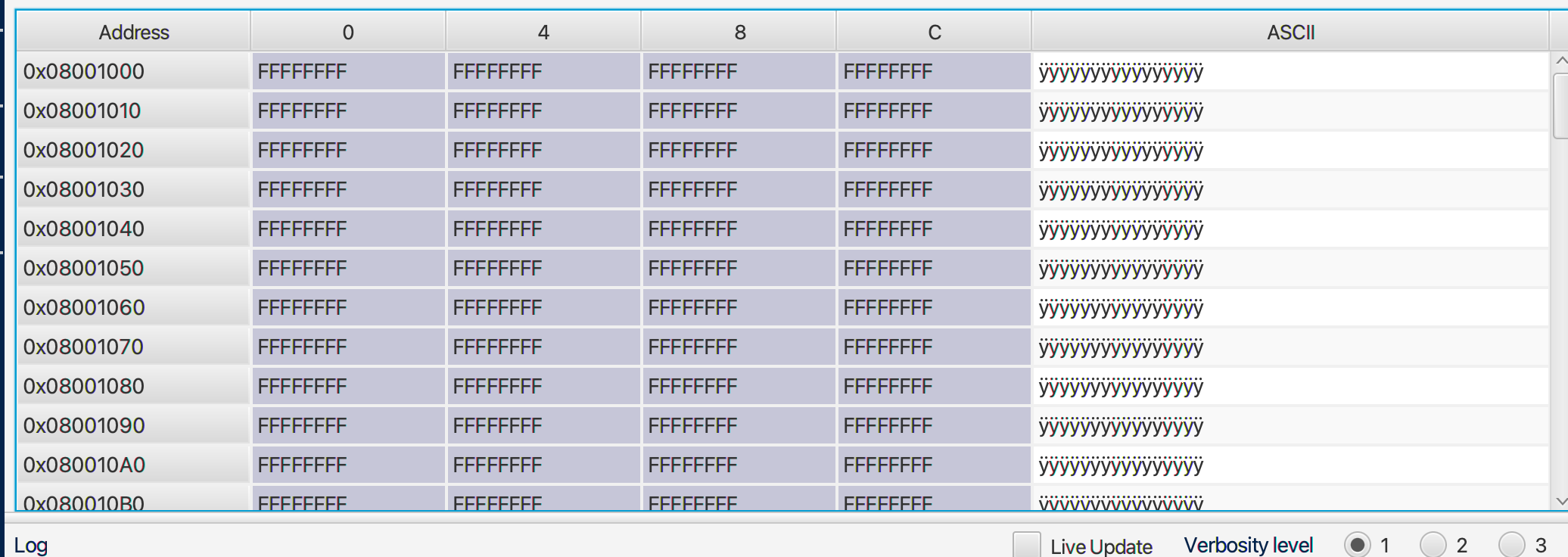

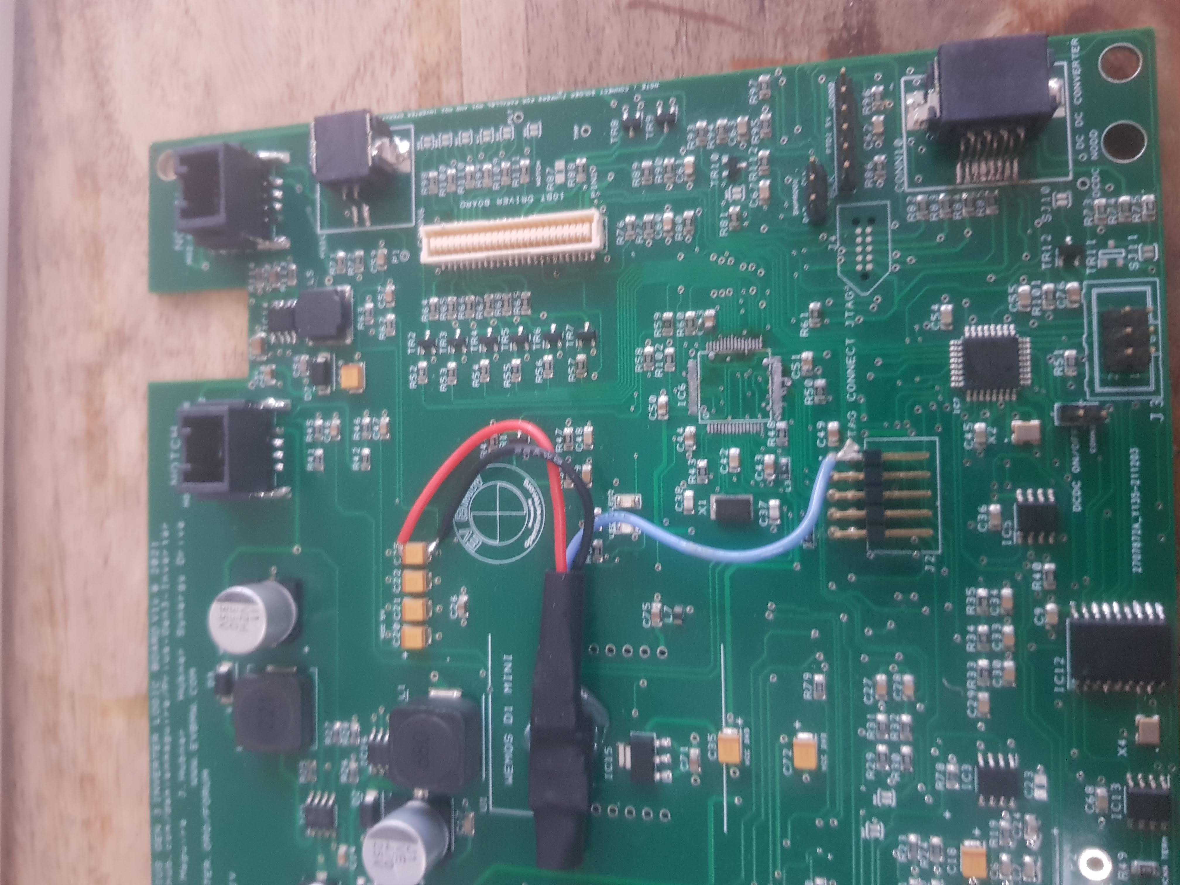

I've got FFMans V1C board from Damien with me to try him get it going, but it's behaving a little off.
I can upload the bootloader with stm32cube, then on the UART I get 2D2D2D recurring. (Version 3)
If I them upload a hex file of any version via stm32cube, it runs that firmware.

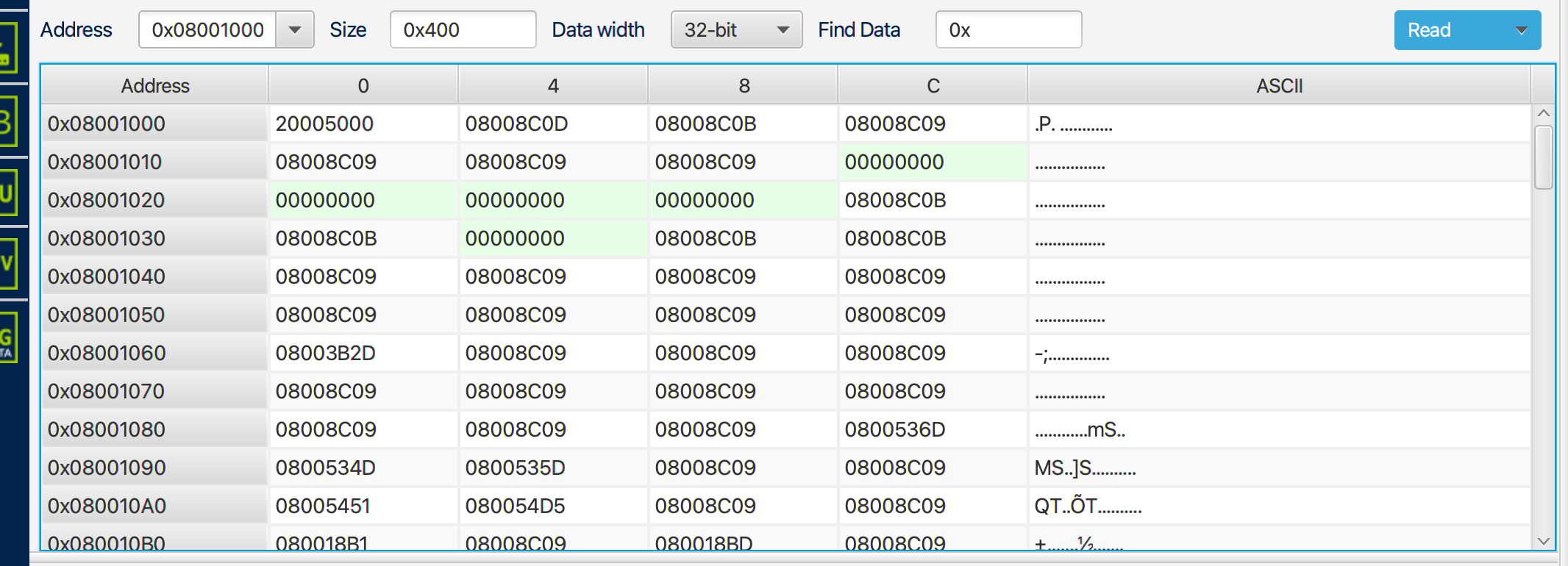

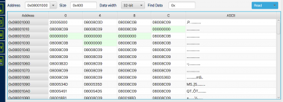

Any attempt to upload via uart leaves the flash empty after 0x0800100

Re-attempts at UART again doesn't help.

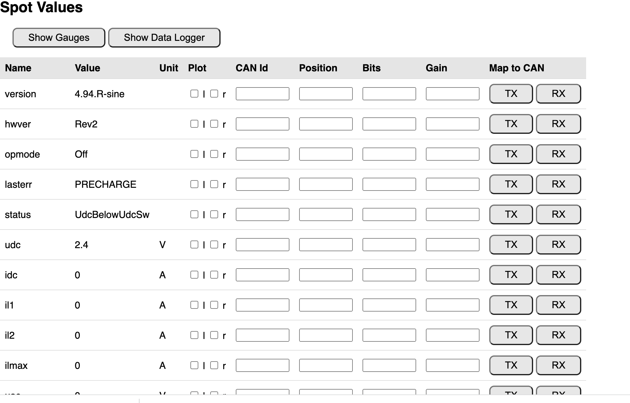

UART must be working in general, when the firmware is running the web interface populates correctly
Any one seen this before?

Seems very odd, does the CRC correct just mean the updater received it correctly or programmed it correctly?
Have you tried a full chip erase on the ST tools? (bit suspicious that lock bits might have got set.)

Yea, full chip erase works as expected. Reuploading via stm32cube works also, different code can be run etc. Just anything via uart upload. Quite weird.
Stm32cube uses swd not uart, so I'd not see anything on there. Uploading via web interface also has the same issue.

Thanks, just had a look, CRC correct means it made it all the way to the bootloader and back without problems - so it looks like janosch is right it's not the serial comms.
The bootloader does not verify the flash write though so it looks like it is the flash write that is failing. What STM32 chip variant is on the board?

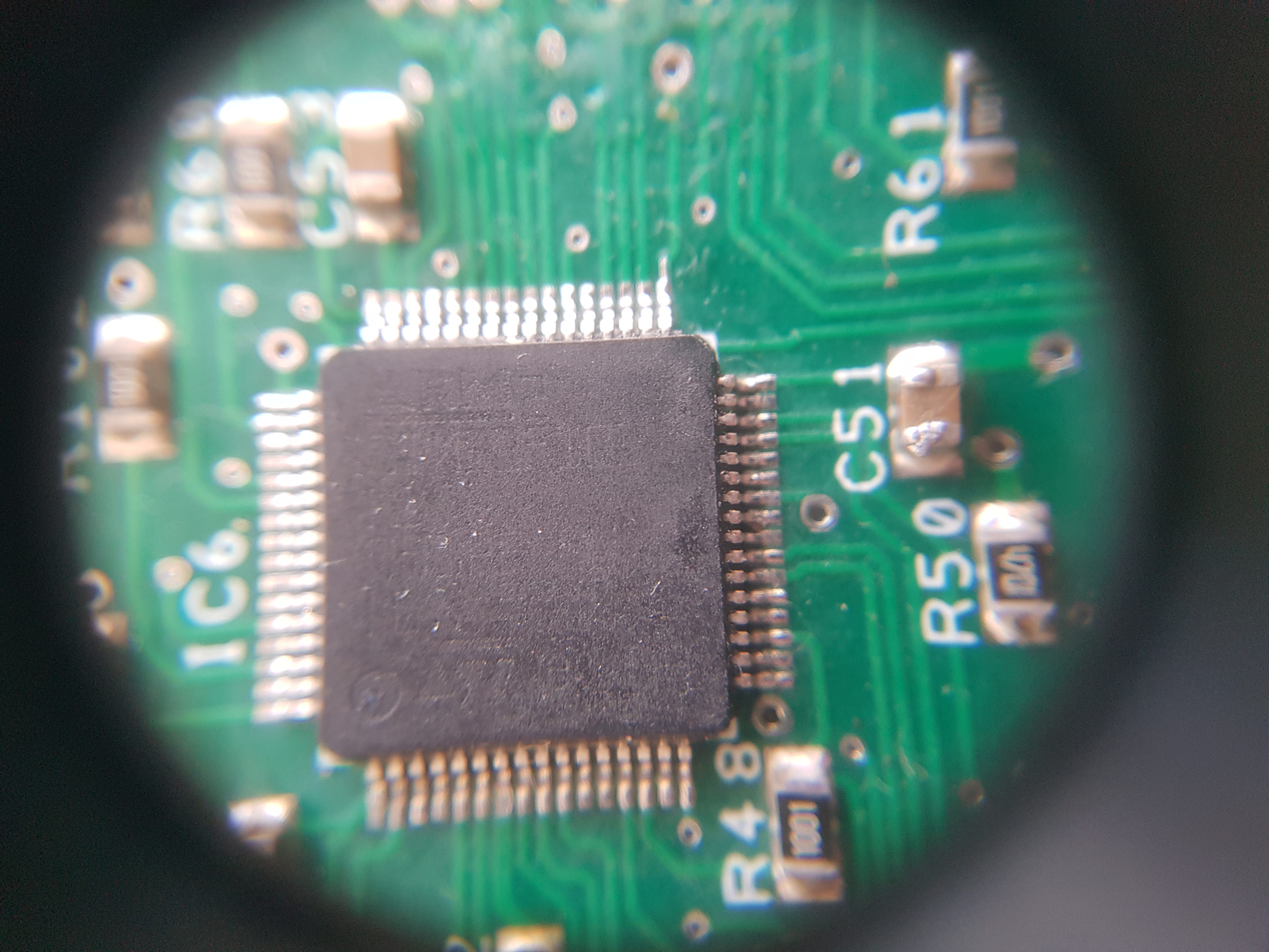

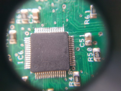

UART seems absolutely fine. It's supposed to be STM32F103RBT6, looking at it though, looks suss.

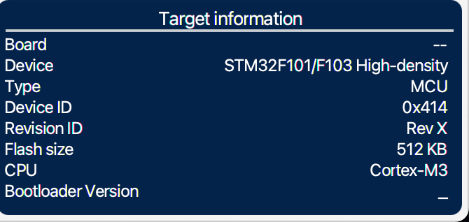

Good news on UART. On the chip I'm wondering whether something else is actually fitted, the ST tool can read the ID and cope but the bootloader doesn't?
Did the ST tool say what it thought the chip was?
Posts: 1884
Has thanked: 91 times
Been thanked: 517 times
Re: UART Firmware updating not working.
Not really an expert with these things :D It seems to recognise it properly

That doesn't look like a real one to me :(
Some of the copies aren't bad, the giga ones in particular are getting reasonable reviews (and are faster than the real ones!).

Bigpie wrote: Wed Sep 14, 2022 3:04 pm Screenshot 2022-09-14 at 4.02.35 pm.png
But that claims it's a high density part, I think it should be medium for the RBT6
Edit - it should also be 128k, that's why it doesn't program, different flash block size!

Fairly sure that's a fake part :(
Not really sure what to suggest, it will probably work fine but then again???
Edit - I suppose it's possible it's a real ST high density part. It's the device marking that doesn't look right though, I've never seen one that looks like that.

*EDIT* Spoken to Damien, it was high density. Looks like the bootloader maybe doesn't work properly uploading to these.
It's now awaiting at new brain.
