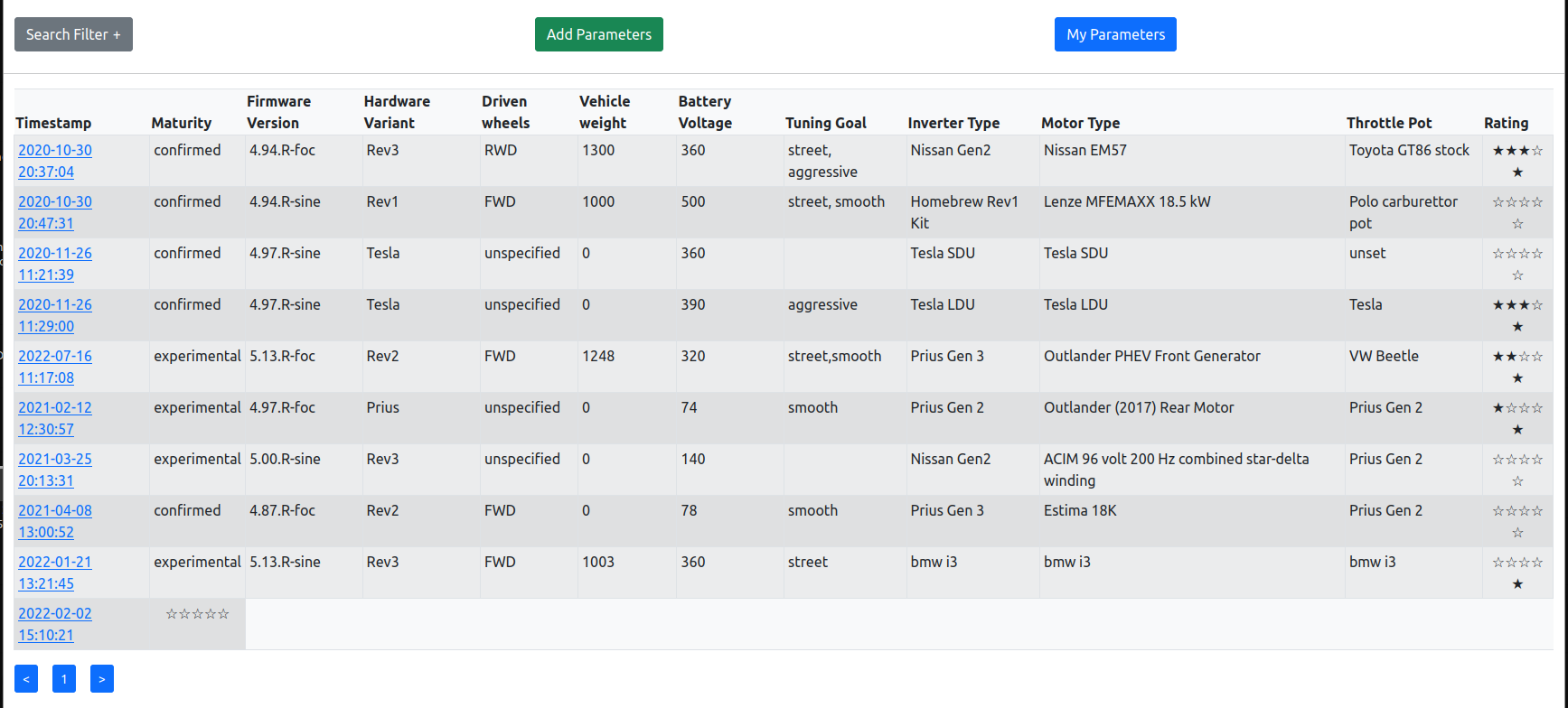

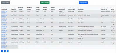

I'm not sure if this is my browser (Linux Firefox), but the parameter database is quite broken for me.
1) The pagination doesn't seem to work properly. I only ever see one page.
2) I uploaded a parameter set for Tesla SDU, but when filtering by Tesla SDU, only the default parameter set shows up.
3) Some entries in the list seem to only have a star rating and no other data shown.
Is it just me, or is this broken? In any case, I'm happy to help debug it.

It works for me but I also see the entry with only stars. Weird.
Source code is here: https://github.com/jsphuebner/parameter-database
I can attach an SQL dump later if you want to work on it on your local machine. Right now it is a bit too much javascript for my taste, most content could be server generated with php.

At a glance I believe I can see why the pagination doesn't work well, and why some entries are showing with missing data. This is largely caused by the code assuming that each entry has 10 fields, when in fact they have 11. I'll write some fixes but it would be very useful to have the SQL dump.

I have replaced the parameter set listing with the old server-side script. That is a bit less functional but it works. Please check it out.
https://openinverter.org/parameters/
EDIT: now submission needs a workover. Right now existing parameters are not updated. So if e.g. an enum is extended that won't be reflected in the database. Also I think deleted parameters don't go away.
