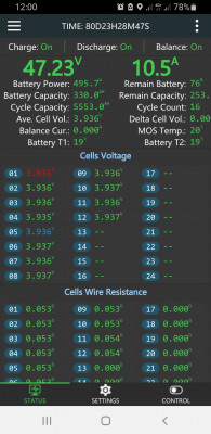

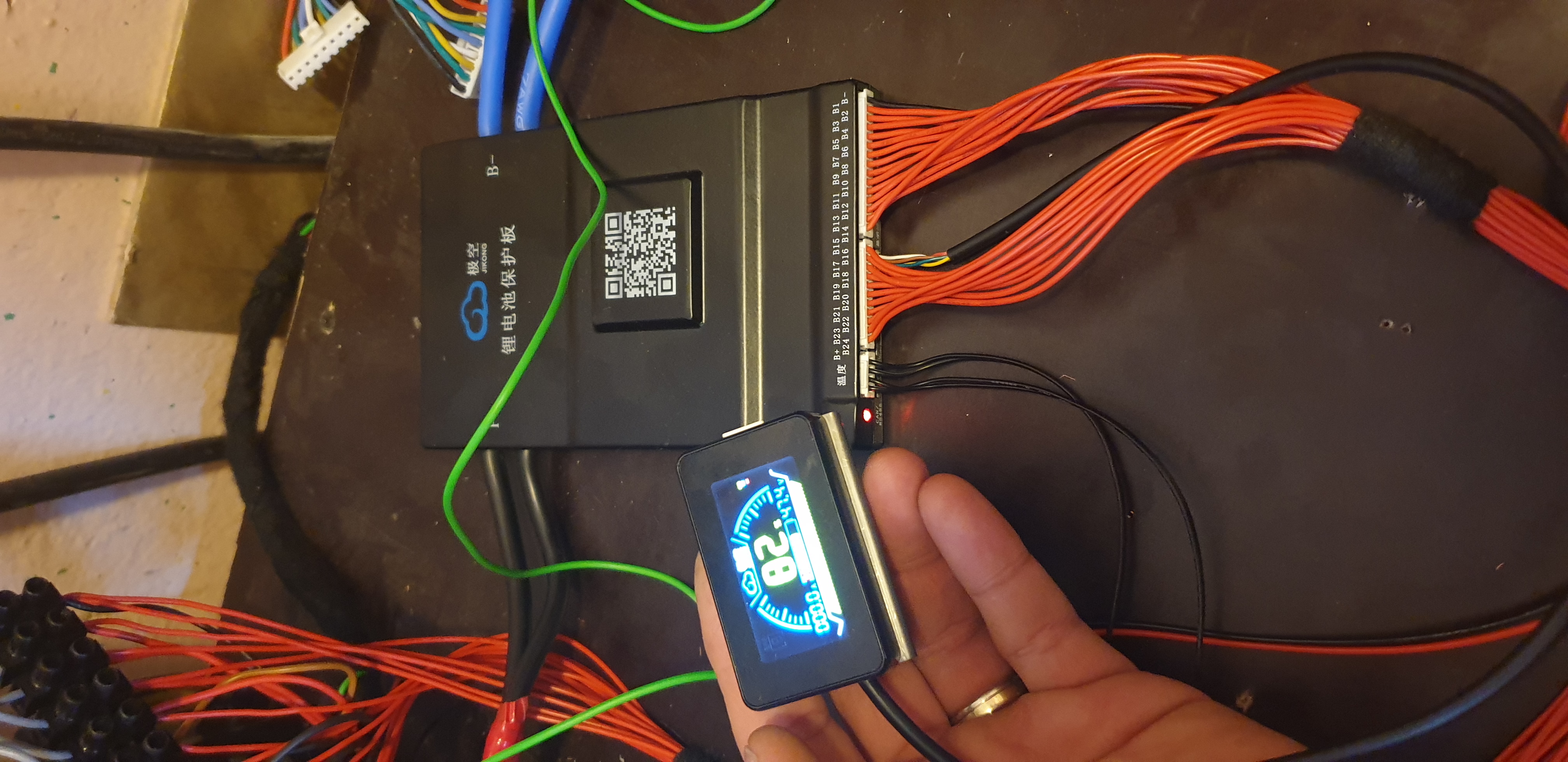

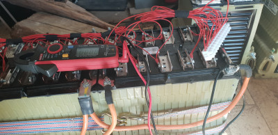

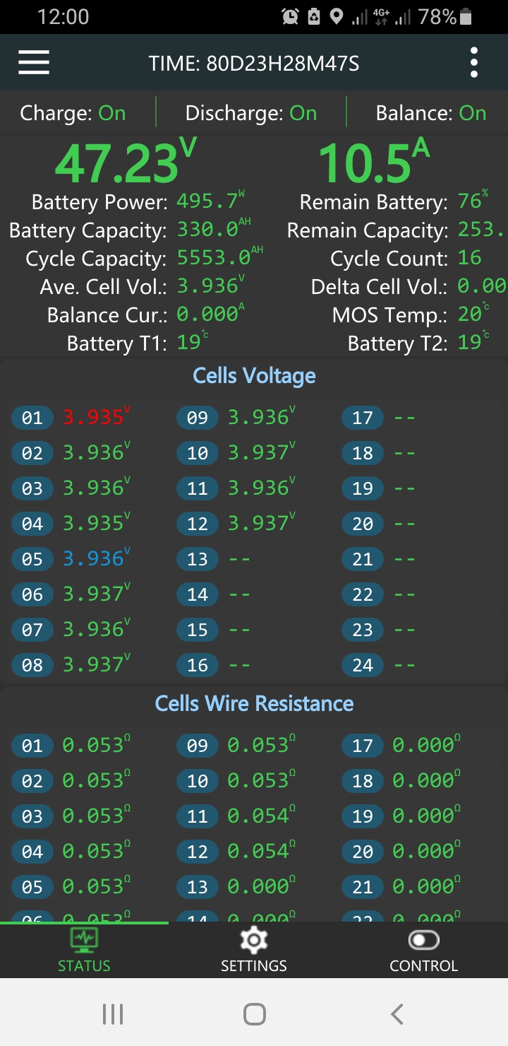

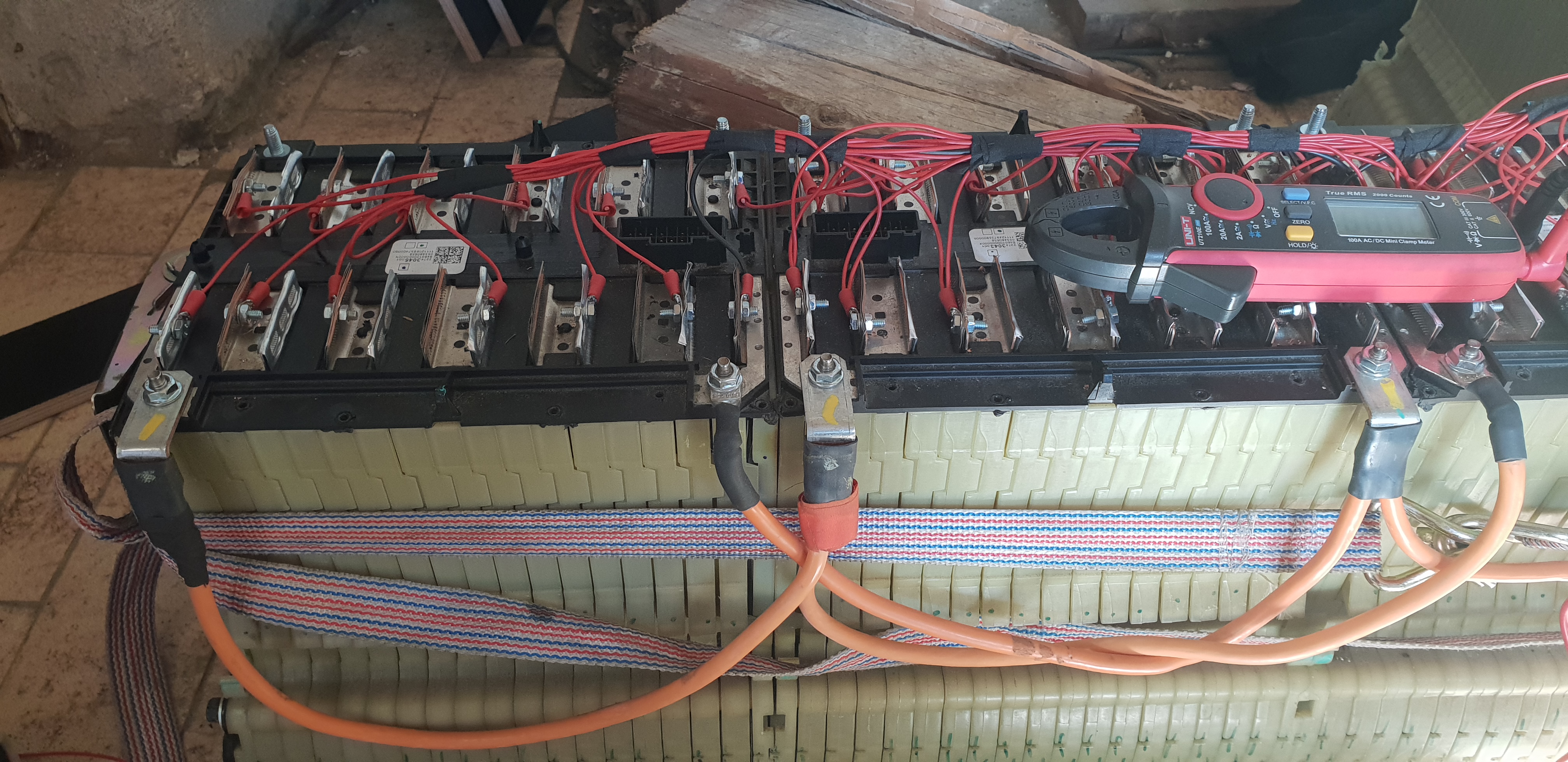

I am usng JK BMS for up to 24S;
https://www.jkbms.com/products/active-balancer-bms/
For solar application I normally wire them up to 16S for 48Vish solar battery
I have tested it and i am using this BMS now in my LiPo battery from Mazda.
I tested it with Opel Ampera modules wired in 12S and VW Golf GTE 12S modules.
The trick of using a single BMS with multiple parallel modules is to parallel individual cells and connect each (parallel)cell to BMS by a ingle output wire. That way allows direct control over batery output. JK BMS allows for bluetooth interfacing and regular inspections without multimeterand opening of the box.
Some photos...
