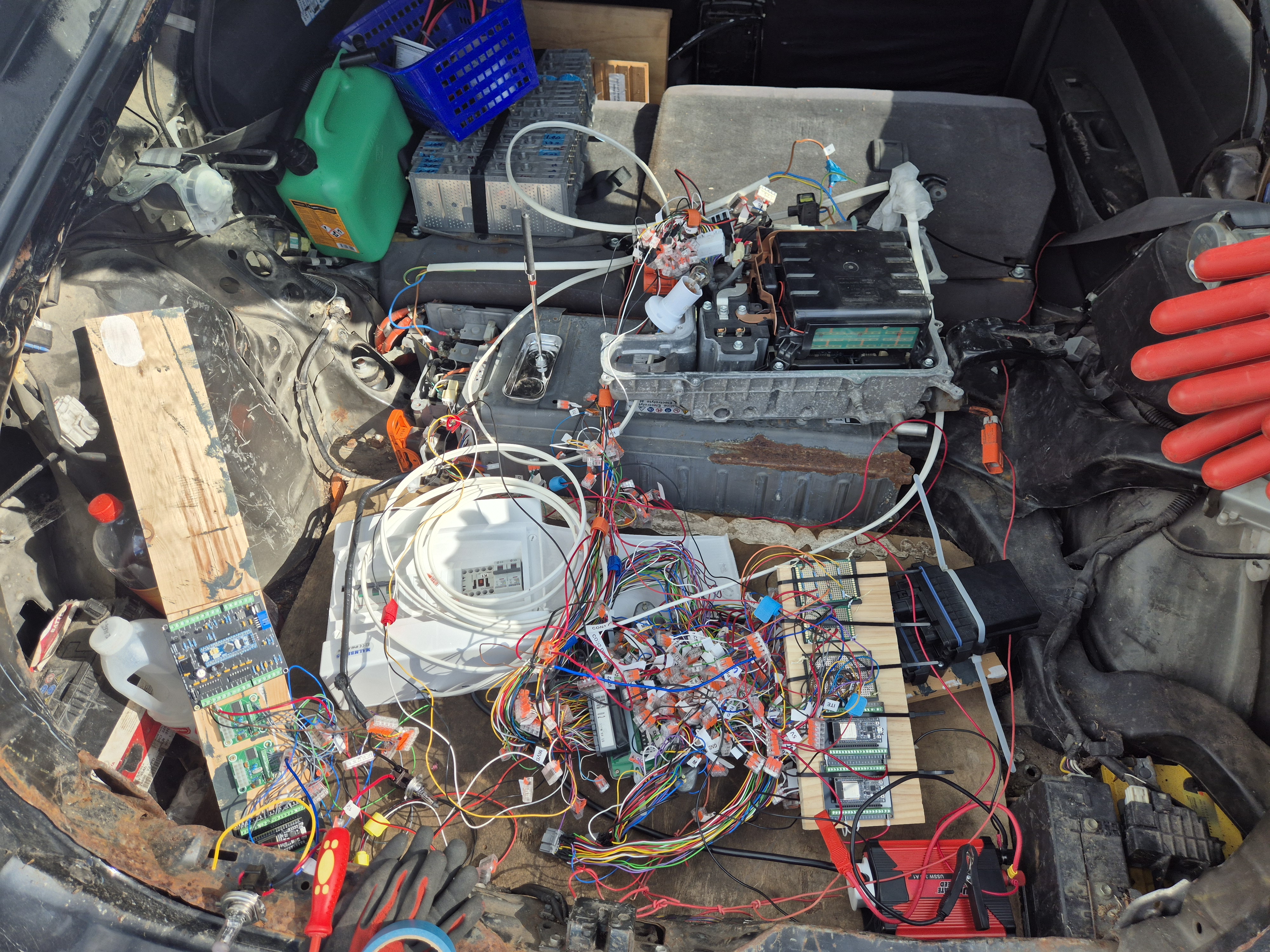

So while testing my updated stm32-car code, I've realized that the Toyota hybrid control ecu is not sending the can bus information I'm expecting because the ecu/car is not in ready mode.
I knew I would have to deal with this eventually but seems that time is now...
That leads me to two options:-
A) Spoof the inputs to the Toyota hybrid control ecu
B) Implement the functionality from the Toyota hybrid control ecu needed in stm32-car.

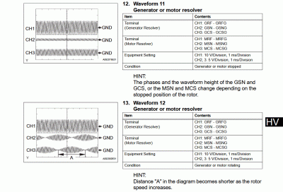

I'll start with spoofing resolver/inverter. I've had a go at this in the past, but not successful
see [viewtopic.php?p=44241#p44241]. To trick the Toyota hybrid control ecu to stay in ready mode and drive, it has to get feed back from current sensors and/or resolver.
I've seen in [ Latula EV test his SDU card using a signal generator
I think my options are
I) By any chance is the Toyota hybrid control ecu sending any information over CAN that Open Inverter ecu can use as resolver information to drive the motor
II) Can Open Inverter ecu hw/sw be modified to use the resolver information generated by the Toyota hybrid control ecu
III) Update Open Inverter ecu to create spoof resolver information for the Toyota hybrid control ecu
Attached Toyota resolver information

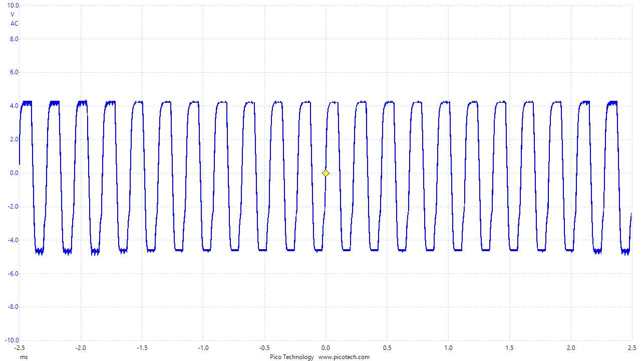

noI) By any chance is the Toyota hybrid control ecu sending any information over CAN that Open Inverter ecu can use as resolver information to drive the motor
OK, so this is the plan...
First attempt:
Use external excitation from Toyota VH ecu in OI
IO excitation is 9v peek to peek and 4.4 kHz Toyota excitation is 20v peek to peek 10 kHz. Plan is:-
HW:
1) Get Toyota excitation and resolver output down to ~3v peek to peek.
2) Get Toyota excitation in to stm32 (can I use "START" PB6/TIM4_CH1 see [https://github.com/jsphuebner/inverter- ... 2-v1.0.pdf])
SW:
1) Set OI excitation to 10 kHz (can this be done?)
2) Get Toyota excitation edge
2) Compare Toyota and OI excitation edge and add/subtract to resolverSampleDelay [https://github.com/jsphuebner/stm32-sin ... ncoder.cpp]?
20231120 updates removed OI resolver pico scope output (this was old data not OI resolver), both resolver output are kHz.
20231121 got an OI resolver pico scope output confirmed 9v peek to peek

Wow I would imagine trying to keep the oem hv ecu happy while driving with the inverter controlled by OI would be a massive task possibly requiring generating appropriate current and motor position signals possibly proportional to the pwm of the phase driver outputs from the hv ecu, I suspect a fixed set of values would cause errors,
I’m starting to think that taking over contactor contol ect and cutting the hv ecu out of the equation is going to be an easier route,
On a separate note, I’d really appreciate a capture of the a/c comms,

See my options/resoing in post above. Car runs and drives with the hv ecu out of the equation but I ran into probelms to integrate OI with rest of car when not in ready mode e.g hv ecu happy. In the past I've been able to run OI sin software open loop with oem hv ecu connected.Ev8 wrote: ↑Sat Nov 18, 2023 8:24 am Wow I would imagine trying to keep the oem hv ecu happy while driving with the inverter controlled by OI would be a massive task possibly requiring generating appropriate current and motor position signals possibly proportional to the pwm of the phase driver outputs from the hv ecu, I suspect a fixed set of values would cause errors,
Re a/c comms I hope to try johu's idea to use the a/c as changer unmodifed (maybe making sure the gates are permanently low achieves the same)

No luck so far changing the OI resolver excitation frequency.
If I comment out line:
https://github.com/jsphuebner/stm32-sin ... r.cpp#L471
gpio_set_mode(NORTH_EXC_PORT, GPIO_MODE_OUTPUT_50_MHZ, GPIO_CNF_OUTPUT_PUSHPULL, NORTH_EXC_PIN);
My assumption was that the interrupt frequency that sets the resolver excitation frequency was set some where above in the InitResolverMode function but I haven't figure it out yet.
- Posts: 6751
- Has thanked: 381 times
- Been thanked: 1572 times
Re: [FIRST DRIVE] Toyota Prius gen2 plug and play
Changing the excitation frequency is hard as it is indeed half the interrupt frequency of 8.8 kHz.
Not sure what you're trying to achieve on a higher level but if you want only excitation disabled you can switch to SinCos mode

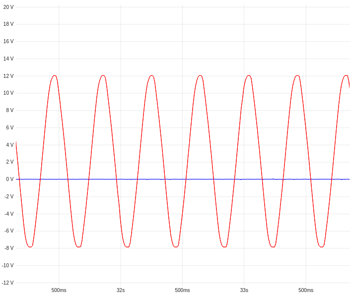

Working on setting up boost charging, using a Denso 13140-0050 current sensor. Converting the Denso 13140-0050 output 5V to 0V (0A at ~2.5V) to 0V to ~2.5 for the gen2 board using an esp32:

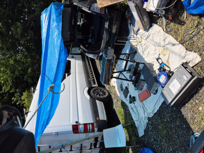

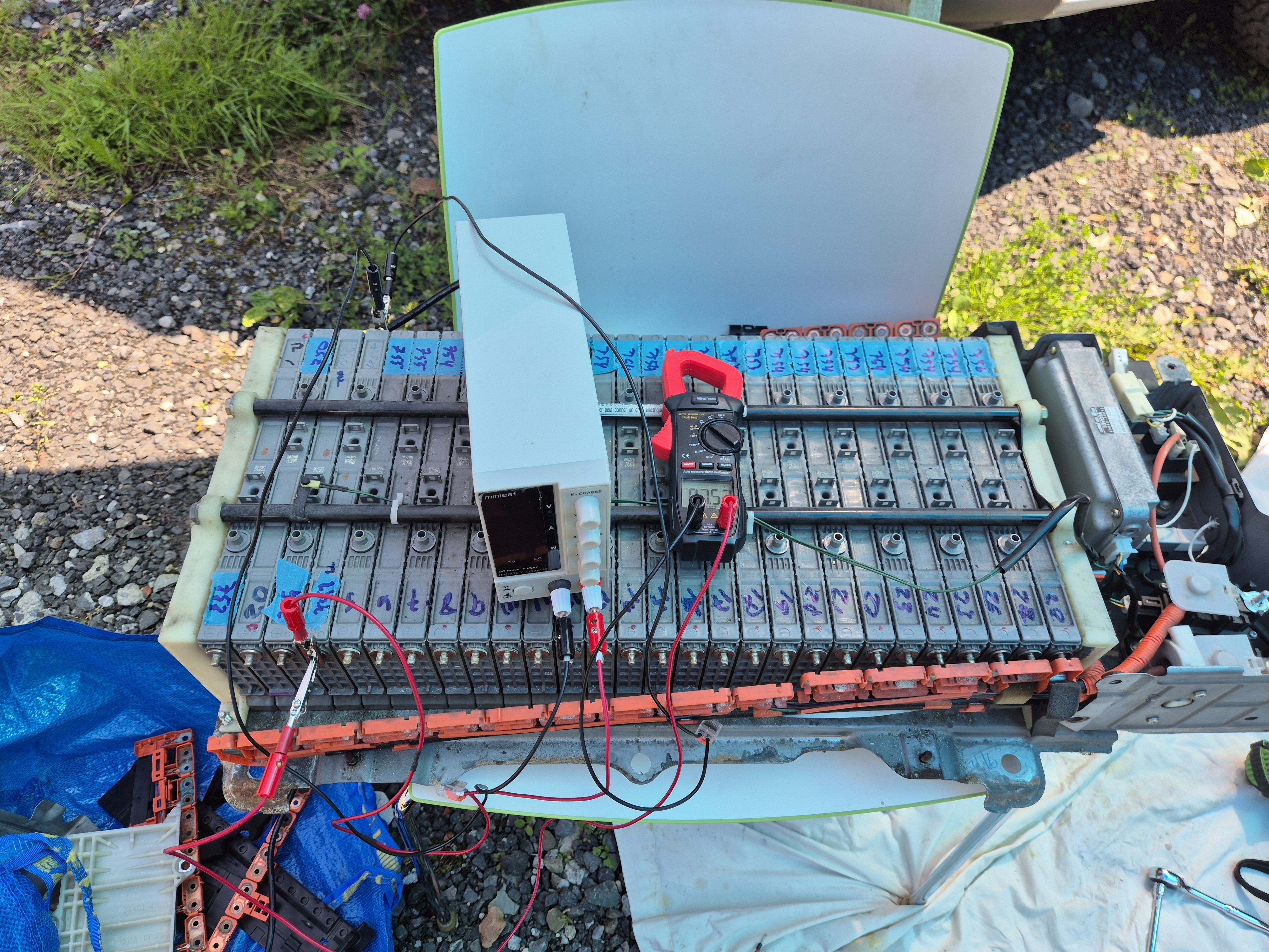

Had a busy couple of days working on the project. I replaced and balanced the cars original battery pack with some used ones I picked up. With the rest of the modules I started rebuilding a 2nd pack. I worked on the test setup for boost charging using the A/C inverter. I got as far as contactors closings and inverter and OI board in boost mode but ran into a issue. I was expecting the buck/booster converter to let power thought to the A/C inverter. I only have V1.1 cards and Johannes mentioned in a thread that the V1.5 will give you power to the A/C inverter and DCDC alt least in drive mode. I need at least 50V for the A/C inverter to start up or I fear it will just blow gates like it did for Johannes. Any ideas how I can get power to the A/C inverter to activate the gate? I also made a rudimentary web interface for the Battery ECU. The Current sensor setup also need some tinkering or maybe just use same setup as Johannes but that requires mods to the OI board.
