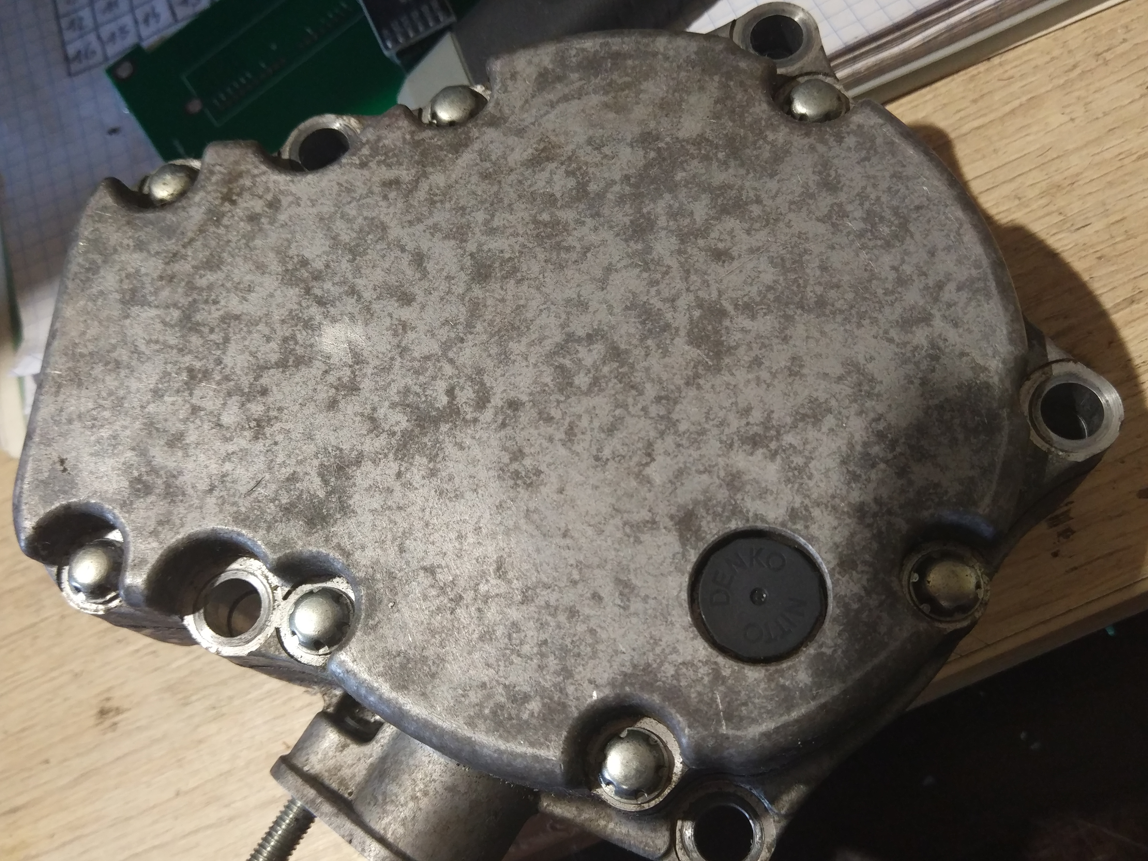

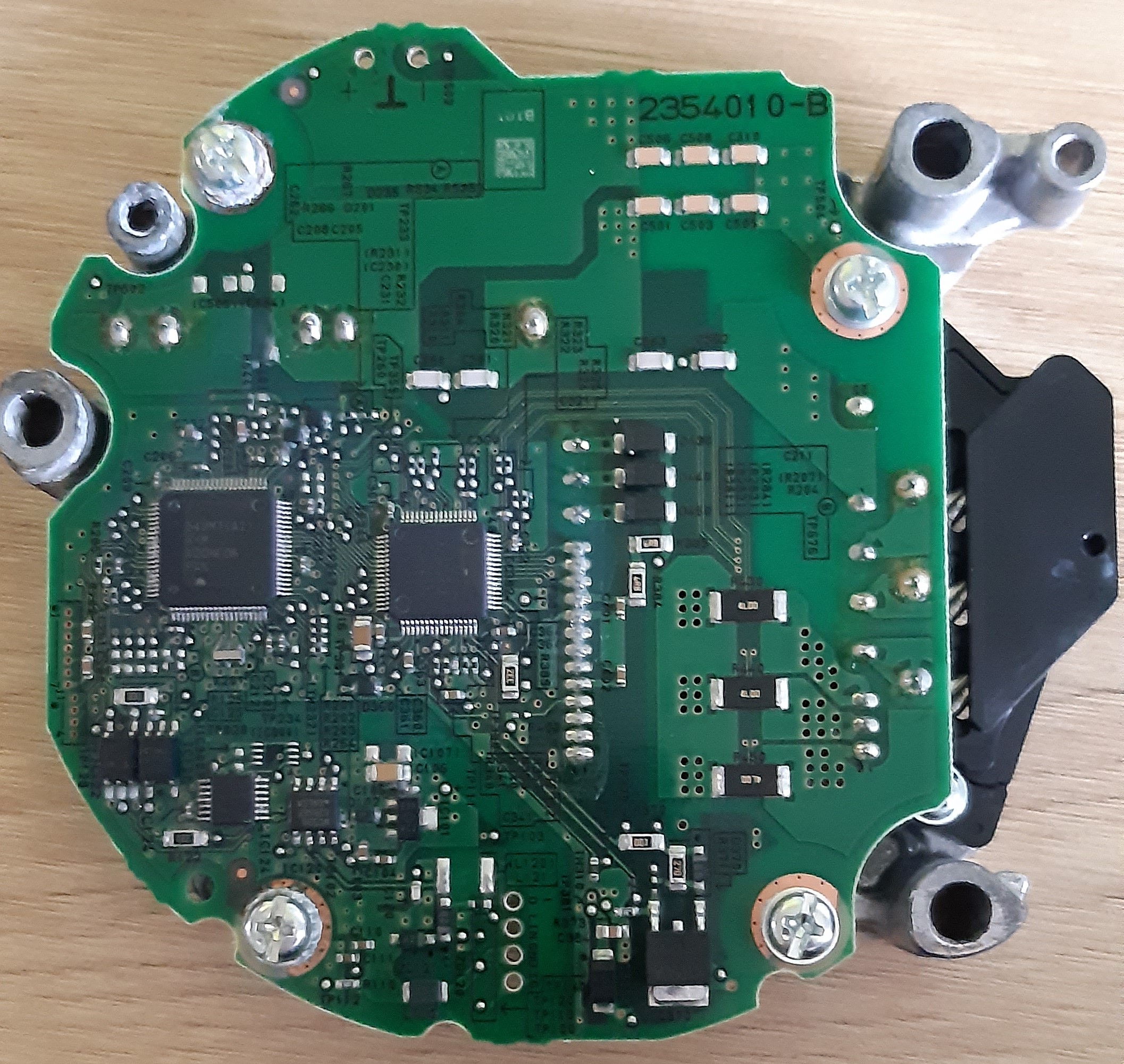

A quick detour from my current Lexus projects, a Denso ES27C arrived in the mail today, I set about building a controller for it.

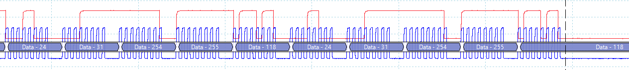

These were the first packets pulled from the car when it was started. There seems to be an initialization and then repeated packets.
Byte 9 is a checksum. It's the LSB of the sum of bytes 3 thru 7, subtracted from 254.
The data is sent as a clocked serial signal, looks very much like SPI, but is far too slow to function with SPI transceivers.
Each clock cycle is 3.2ms, each byte of data takes 26ms to receive, and each packet of 10 bytes is received over 315ms, with a 80ms gap in between. So less than 3 packets per second.

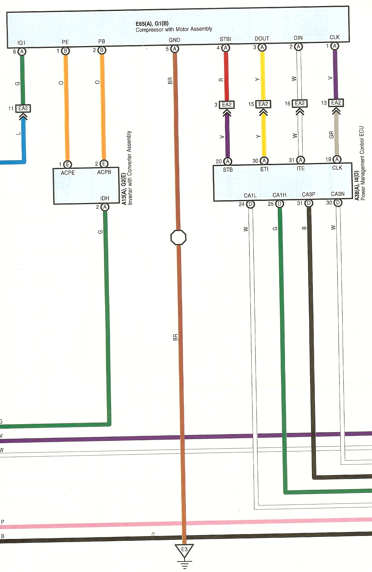

My plan for the 3 switch inputs is to just put an "if(all switches closed){run the compressor}" in the main loop. The serialdiag() functino will be replaced by a CAN transmit function, if the AC compressor is found to produce any useful data.

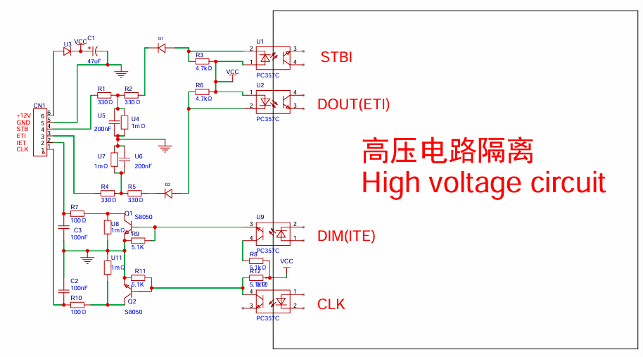

I've attached a schematic of the circuit I used. Note the pain numbers have changed - I've freed up the SPI pins so I can add a CAN controller in the future. I'll get this board fabricated when I next place an order.
I'm currently facing two issues:
1. The AC compressor pinout. I believe it is:
1 - CLK
2 - ETI (data from HV ECU to compressor)
3 - ITE (feedback from compressor to HV ECU)
4 - STBI
5 - GND
6 - 12V
However, the service manual contradicts itself over which pin is ITE and which is ETI. From metering the two, pin 2 has the same specs as CLK, while pin 3 is pulled up when pin 6 is connected to 12v via a 1M resistor. I am going with the assumption that my list above is correct.
To activate this unit, the STBI line needs to be connected to ground. Doing so causes the unit to pull 14mA from the 12v line. This isn't enough to power the unit, I believe that the unit is disabled until it sees voltage on the HV DC connector. I opened the unit, there is a sensing circuit connected to these lines. Likely the inverter is shutdown until it receives adequate HV voltage. I tried 12v. Nothing happened.
So, I'm about 10 hours in and have made plenty of progress already. I'll likely put this project on hold until I have access to a 288V DC source to try this again. I've posted this now in case anyone else wants to use my work so far to attempt to control a compressor of their own. These are widely available AC compressors, and if they can be controlled, it would provide a cheap source of AC for electric car conversions.

schematic
schematic
Here is the schematic for a Toyota Camry Hybrid AVV50L/R.
it has
DIN instead of ETI
and
DOUT instead of ITE
So pins are:
1 - CLK
2 - DIN (data from HV ECU to compressor)
3 - DOUT (feedback from compressor to HV ECU)
4 - STBI
5 - GND
6 - 12V (IG1), via 7.5A fuse.
Toyota Camry Hybrid AHV40 is identical, except pin 6 is fed by 12V via 10A fuse.

The Lexus compressor has the pins labelled as DIN and DOUT on the PCB inside (I don't recommend removing the cover, it's rather sticky in there), the ETI and ITE are from the service manual. DIN and DOUT are referenced in other parts of the service manual as well. So it looks like Toyota couldn't decide what to call them!
The service manual does contradict itself on which is data to and from the compressor. I think it's established now that pin 2 is data into the compressor.

forgot to add the picture XP, kind regards.
xp677
Posts: 441
Location: UK
Been thanked: 15 times
Re: Denso ES27C AC Compressor control (Lexus, Leaf, etc)
Post by xp677 »
That picture is very useful. I don't have a copy of it in my GS450h service manual so many thanks for sharing.

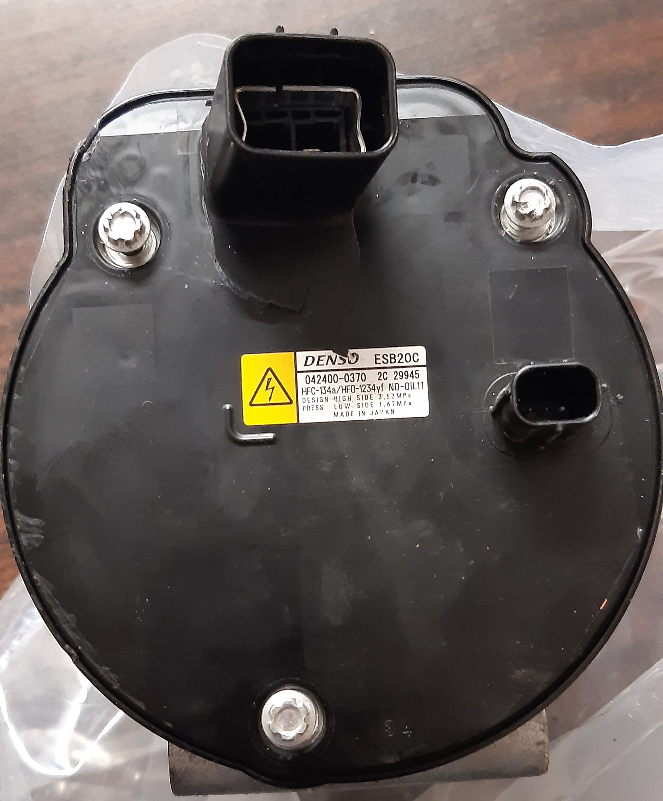

The signal connector is a Sumitomo TS-series 6189-1083.
The power connector I don't know, mine came with the connector and cable.
The pinout is written on the PCB under the cover. Sorry, I don't have it written down. There is a clock, data in, data out, and "STBI", which is either an enable, chip-select, or data request line.
Edit: I found this in one of my old documents, not sure what car it's for, I think one of the generations of Prius:

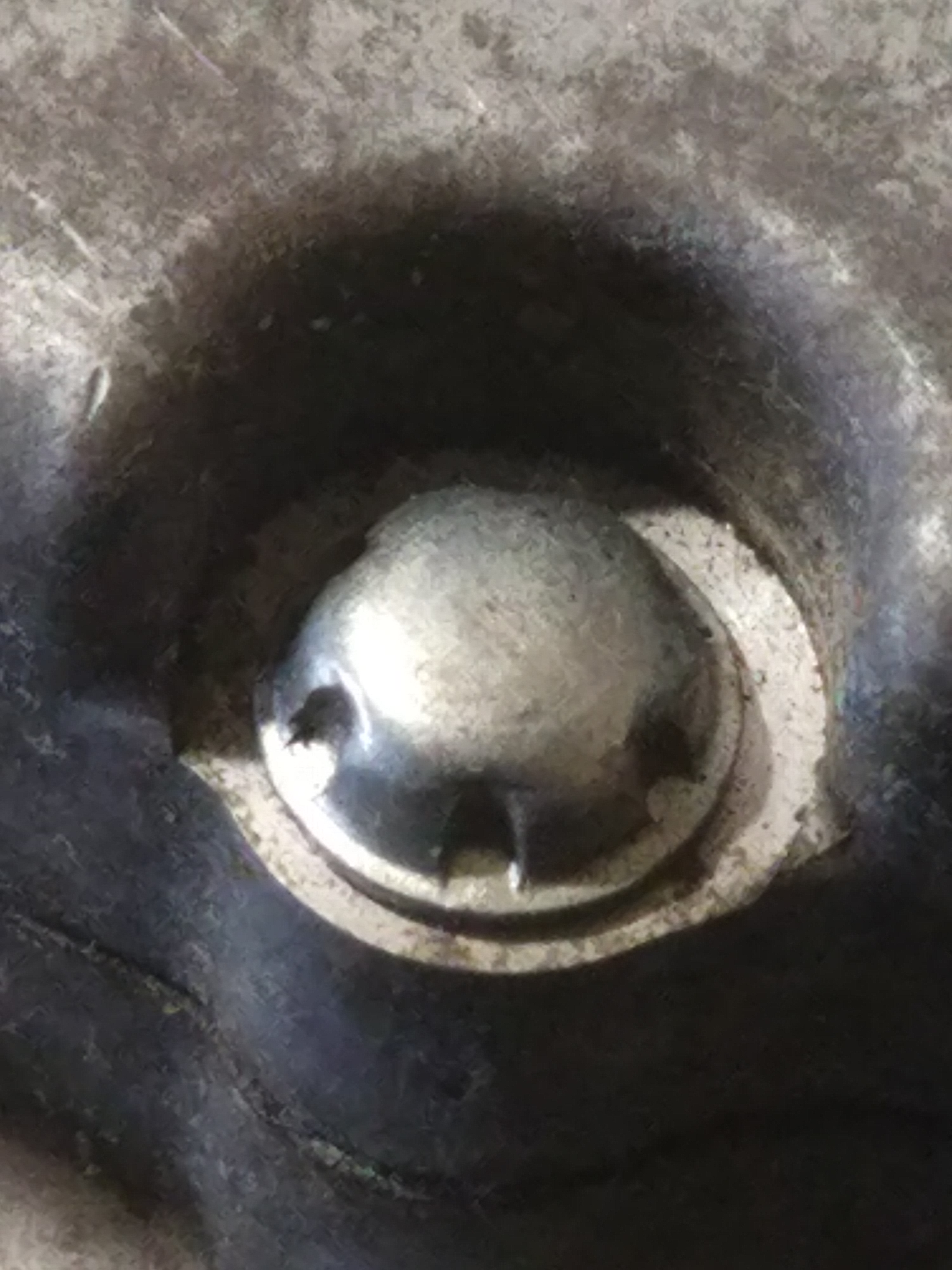

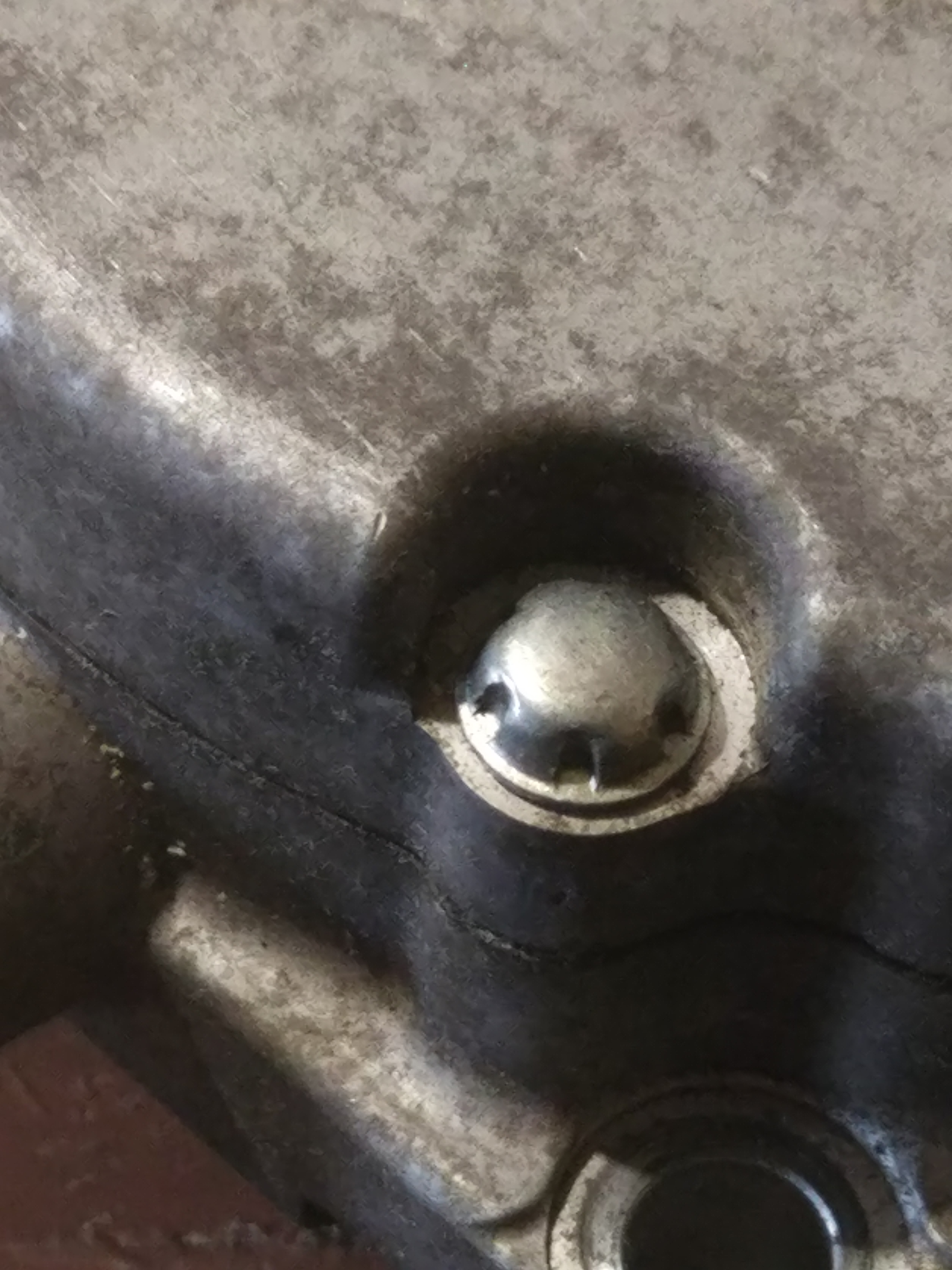

How did you undo the cover? I see some strange pattern bolts holding the cover shut on Leaf AC compressor inverter. I dont have the tool to take them off.... Any idea?

I don't remember it being a challenge, mine must have had regular phillips or torx bolts. Either that or I just gripped them with pliers? Sorry, I forget.
There is a sealant around the cover as well but a craft knife can sort that out.
Edit: I just did a quick google search and the first one I saw had phillips screws. I guess mine did too. https://www.aliexpress.com/i/32851143490.html
Looking at the pictures, the Leaf seems to have the same pump/motor as the Lexus RX and GS, but a different inverter housing.

Well this is the inverter cover. Bolts are strange and i cant even grip them with pliers since their heads are rounded.
Leaf compressor has inverter from the side not on top.

You should be able to remove those with a hammer and chisel to push them round.

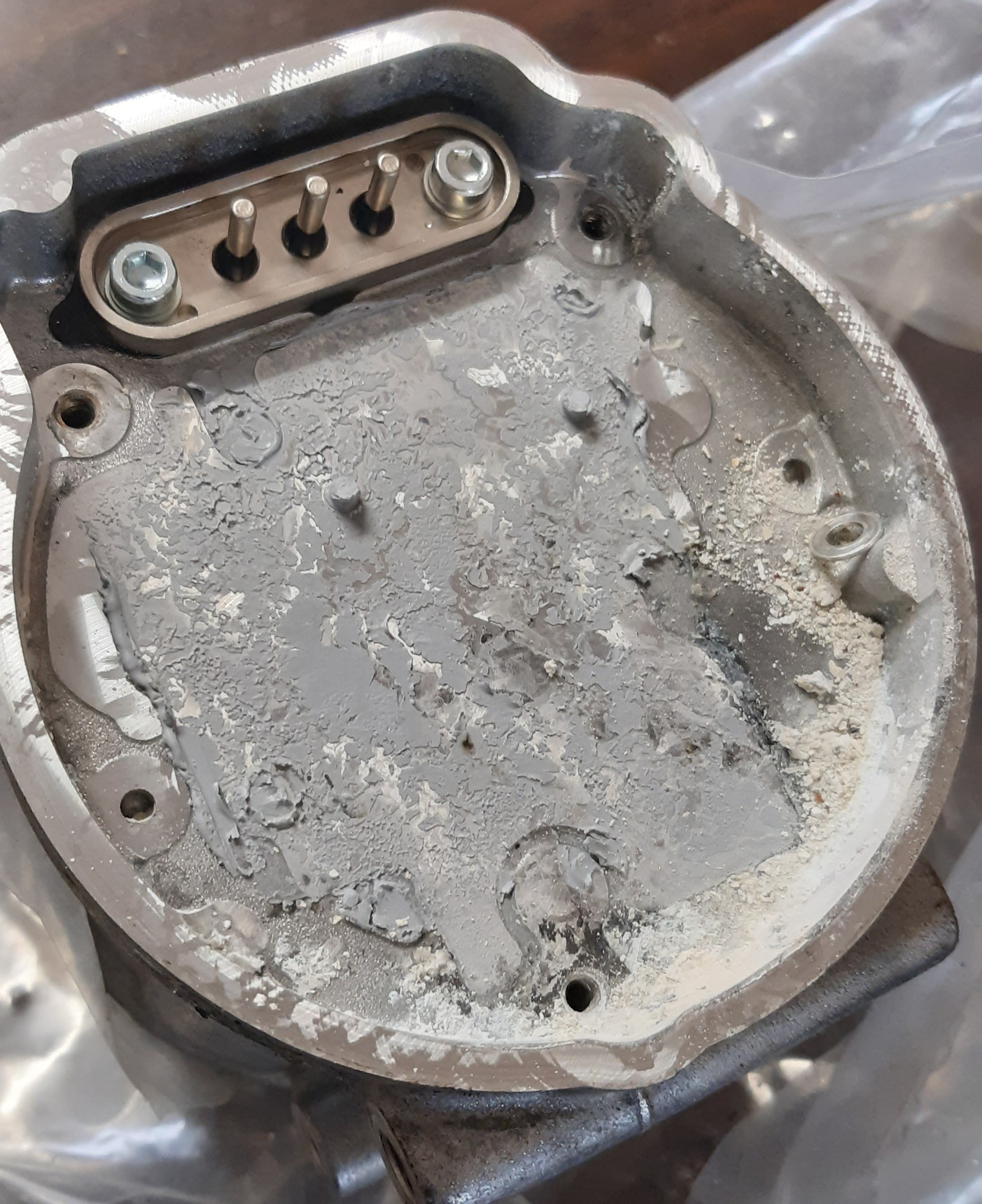

xp677 wrote: Mon Apr 20, 2020 8:55 pm You should be able to remove those with a hammer and chisel to push them round.
Yes, i did. But now i see the IGBT chip is soldered and bolted in from below. There is no way to get the PCB off.
Also i just got the Prius compressor. It is a little smaller unit, but it only has 3phase cable. And i got it to work so i wont be messing with Leaf compressor anymore.

xp677 wrote: Thu Apr 16, 2020 7:34 pm The signal connector is a Sumitomo TS-series 6189-1083.
1: "CLK" green to DA1:19 to PMC:19 "CLK"
2: "DIN" yellow to DA1:20 to PMC:31 "ETI"
3: "DOUT" red to DA1:21 to PMC:30 "ITE"
4: "STBI" white to DA1:22 to PMC:20 "STB"
5: "GND" white-black to DA1:17 to ground point A4
6: "IG1" violet to DA1:18 to share a 10A fuse in (IG)
Definitely not for GS450h as they use white/yellow/black/green for the 4 "data" wires.
Edit: and johnspark posted the same on page 1 of this thread. So there you go.
Hello, thank you for your information and I find the correct connector finally. So I did some easy test on my compressor, but there are still some problems.
I give a control signal voltage between the pin IG1 and pin GND (12V, 1A),and a high voltage between pin PGND and PBAT (I changed the voltage from 180V, 30mA to 285V, 30mA). Consider about the safety, I don't want the compressor run when I test it, so I make the STB pin keep a high level volatge during the test. I want to see some signal form the clk or the ITE, but when I connect the signals to the scope, I cannot see and useful signals. The pin2 and pin1 keep a low voltage (about 70mV) and the pin3 keep a high voltage (about 11.5V).
Do you know more about the communication protocol of the compressor? A document says that the communication protocol is the PWM communication and it means I only need to give a PWM to the ETI and when I change the duty cycle the rotate speed will be changed. And the pin CLK is used to check the fault signals by give different pluse number. For my test, I give the correct signal voltage and the right high voltage, but the STB is high level, the fault signals should have 6 pulses. So as my expect, I will see 6 pulses when I connect the CLK to the scope. But as I said, I saw nothing :cry: :cry: . I think maybe the document is not for the ES27C.
Do you have any ideas about the test? If you have some suggestions, I can do other tests to learn more about the compressor.

I've attached some files from my testing, these were made using Sigrok PulseView, so you can open them in there and see what the communication looks like.
testing.zip
(4.27 MiB) Downloaded 946 times
I think the CLK needs to come from your controller. Maybe try sending a clock pulse to the CLK pin and see what comes from ITE?
From the service manual, these are not PWM, they are serial communication.

Erika wrote: Wed May 06, 2020 6:20 am Hi, I saw your testing documents. But there are too many files, I cannot understand them well. Could you provide some explainations if it is convenient ?
I don't really understand many of them either. The filename is the description of what was happening, and the traces in the documents indicate the CLK, ITE, or ETI signals. Some of the documents do not have all 3, because there was an issue with the signals grounding through my logic analyzer.

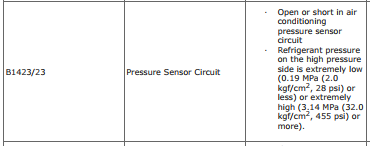

Erika wrote: Wed May 06, 2020 6:20 am And as you said that from the service manual, the communication mode is serial communication. I think if we want to make the compressor run, we should know more information about the serial communication such as the data format (the address and something else). Do you find any more information about the data format in the service manual ? I will be very appreciated if you could send the service manual to me.
Visit lexustech.eu, you can pay EUR6 for 1 hours access to the manual. I only have a few pages which I saved. See here for everyting I have:
Service Manuals.zip
(4.01 MiB) Downloaded 1128 times
The file "ac compressor.html" should be useful. You will need to extract all the files for the images to load.
In the document, it mentions the trouble code "P3108 Serial communication malfunction".
That, and the fact that it has TX,RX and CLK, tells me that it is a synchronous serial communication.
You can look at some of the waveforms to see the data format.

Look at the file "compressor data.xlsx", that seems to have some of the information decoded.
