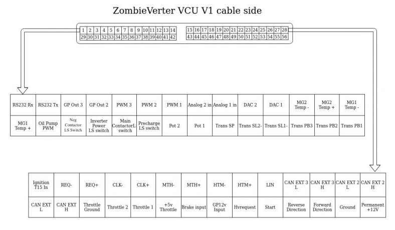

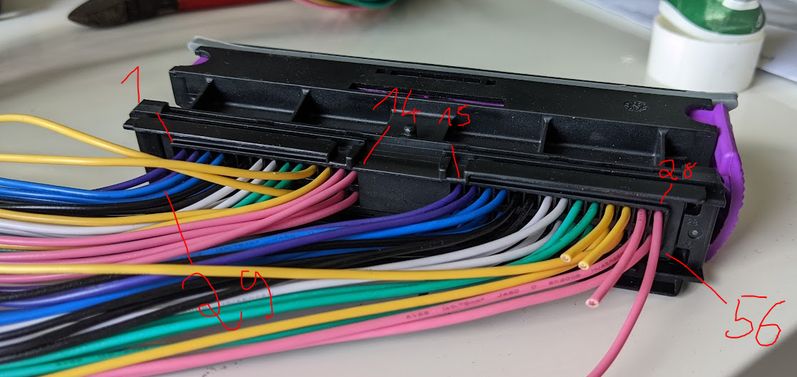

Hi, i'm about to wire the Zombieverter and i was wondering what exactly cable side means. I see it the way, when i look at the cables when they are plugged in:
Is that correct???

Yes, that's how I've wired it and get power and CAN etc ok
