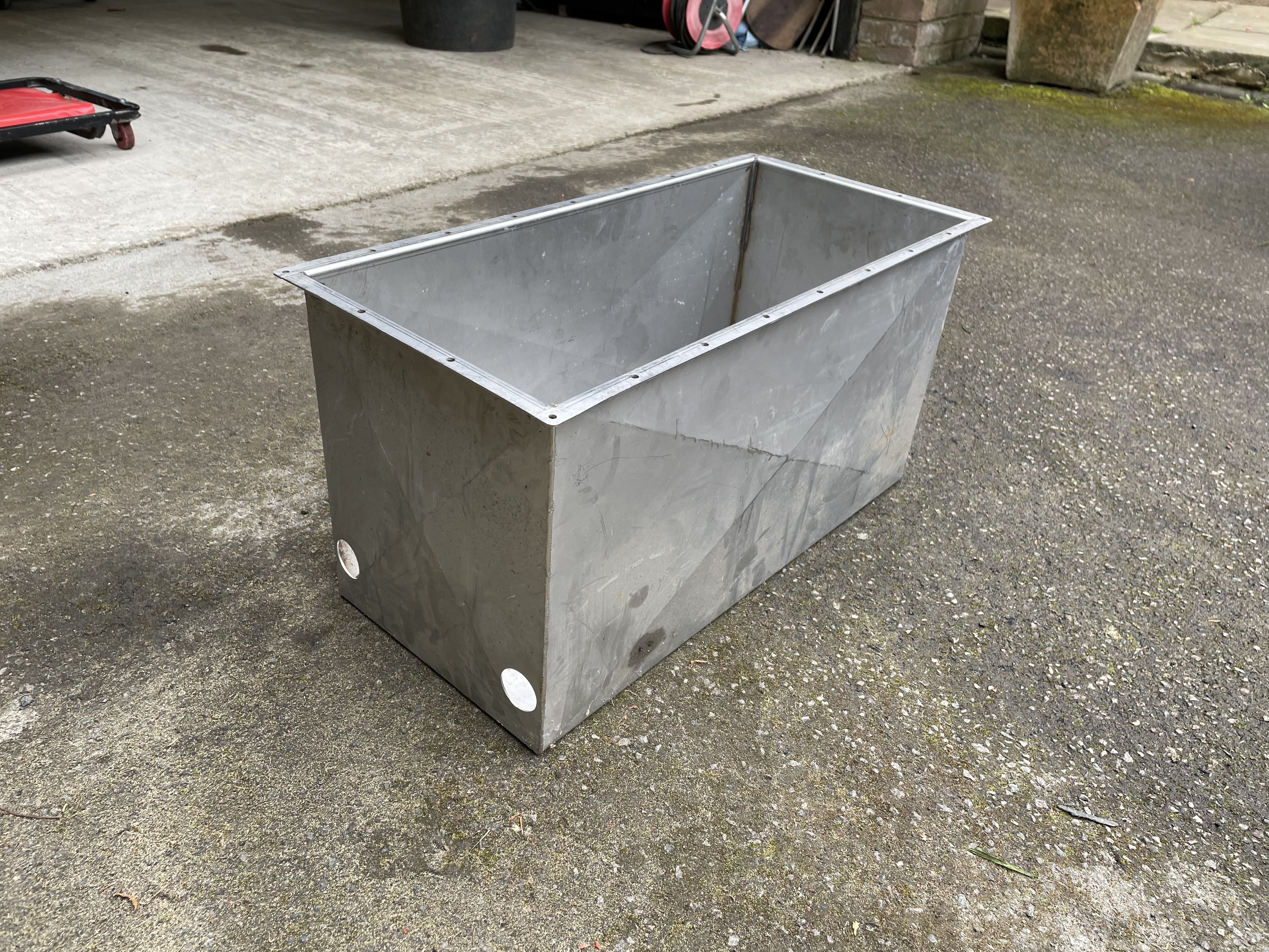

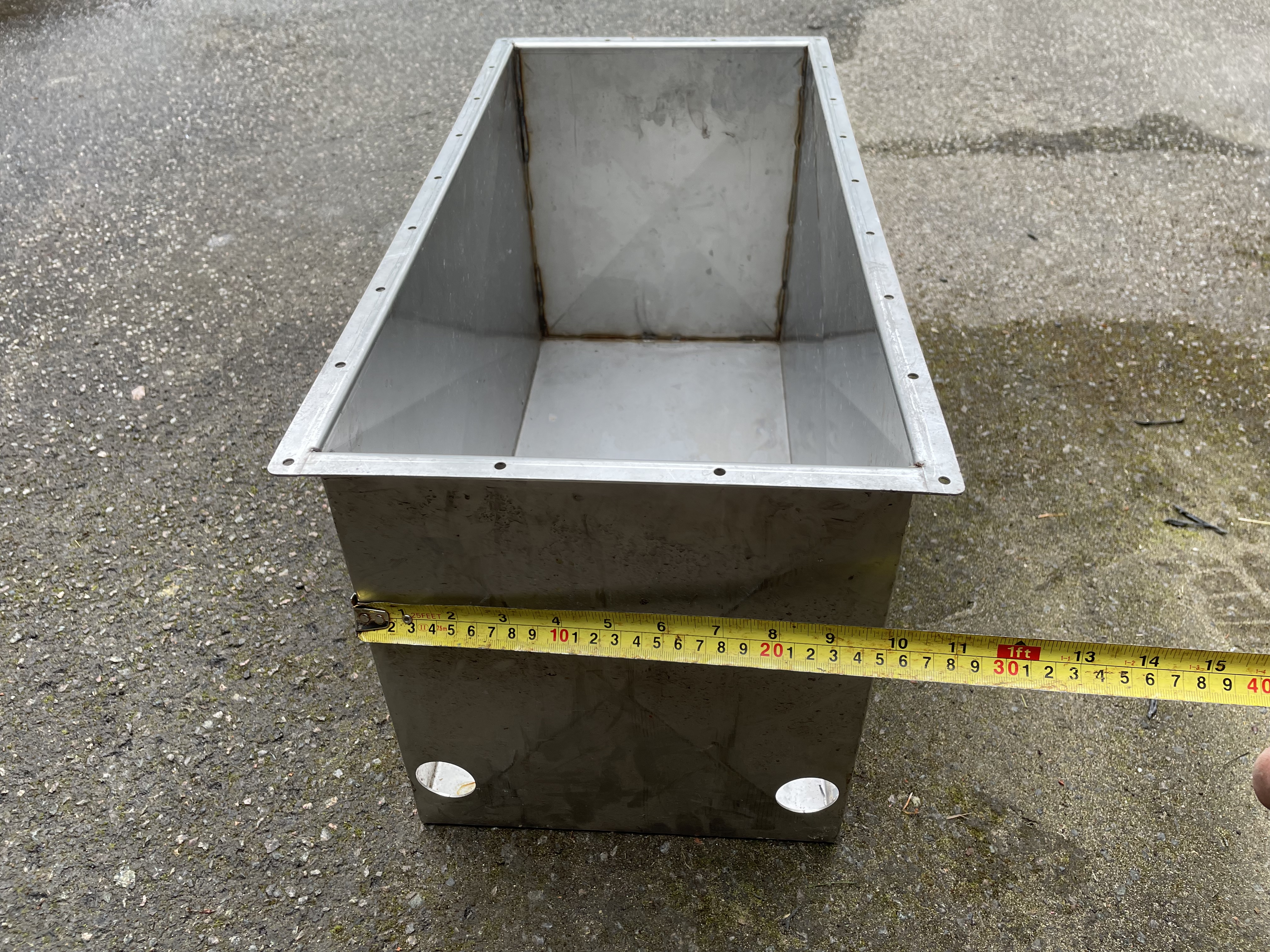

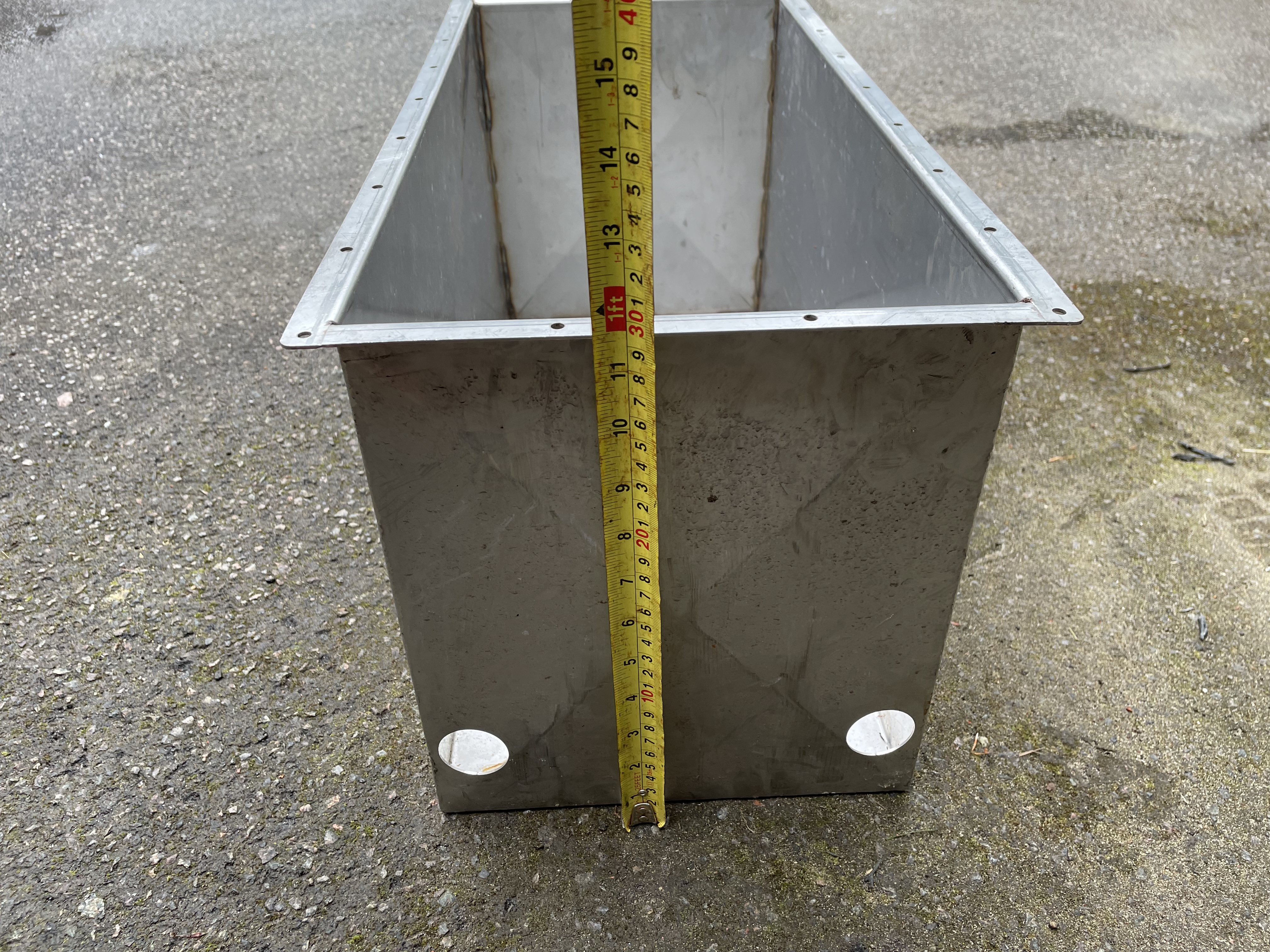

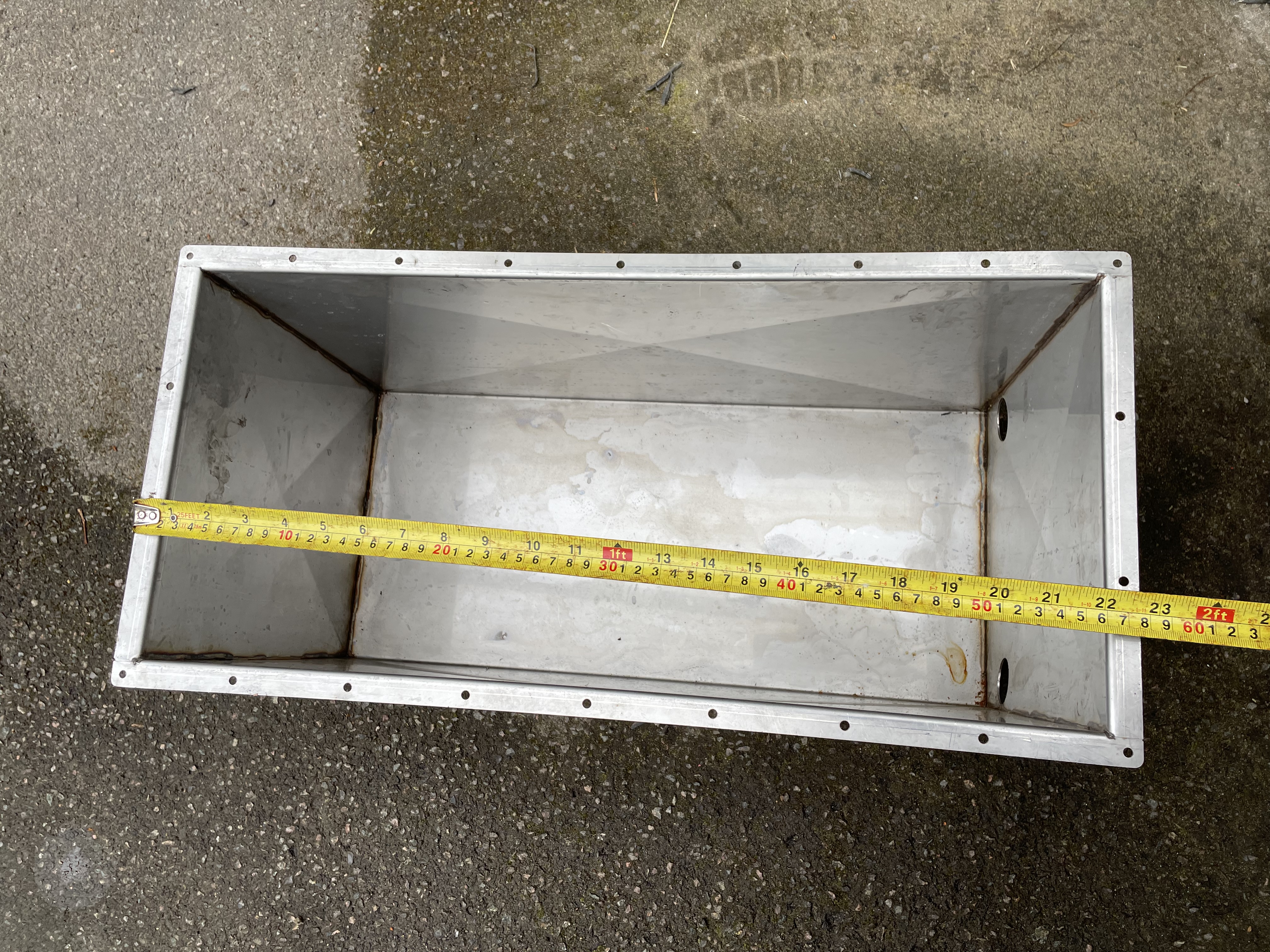

This is for the Opel/Vauxhall/Chevy Volt. It is designed to take the smaller of the three modules.
Might be useful for an alternative pack too.
Of interest to anyone?
Stainless steel battery box

Am curious how you X-creased the walls?

They were made on hydraulic press. I have those made into my box too. They are suppose to strengthen the wall a bit so it doesnt wobble. No Omega profile welding required.

The house HVAC guys do it as a regular course, but it's a much thinner gauge that they work with. Which is why I asked.
