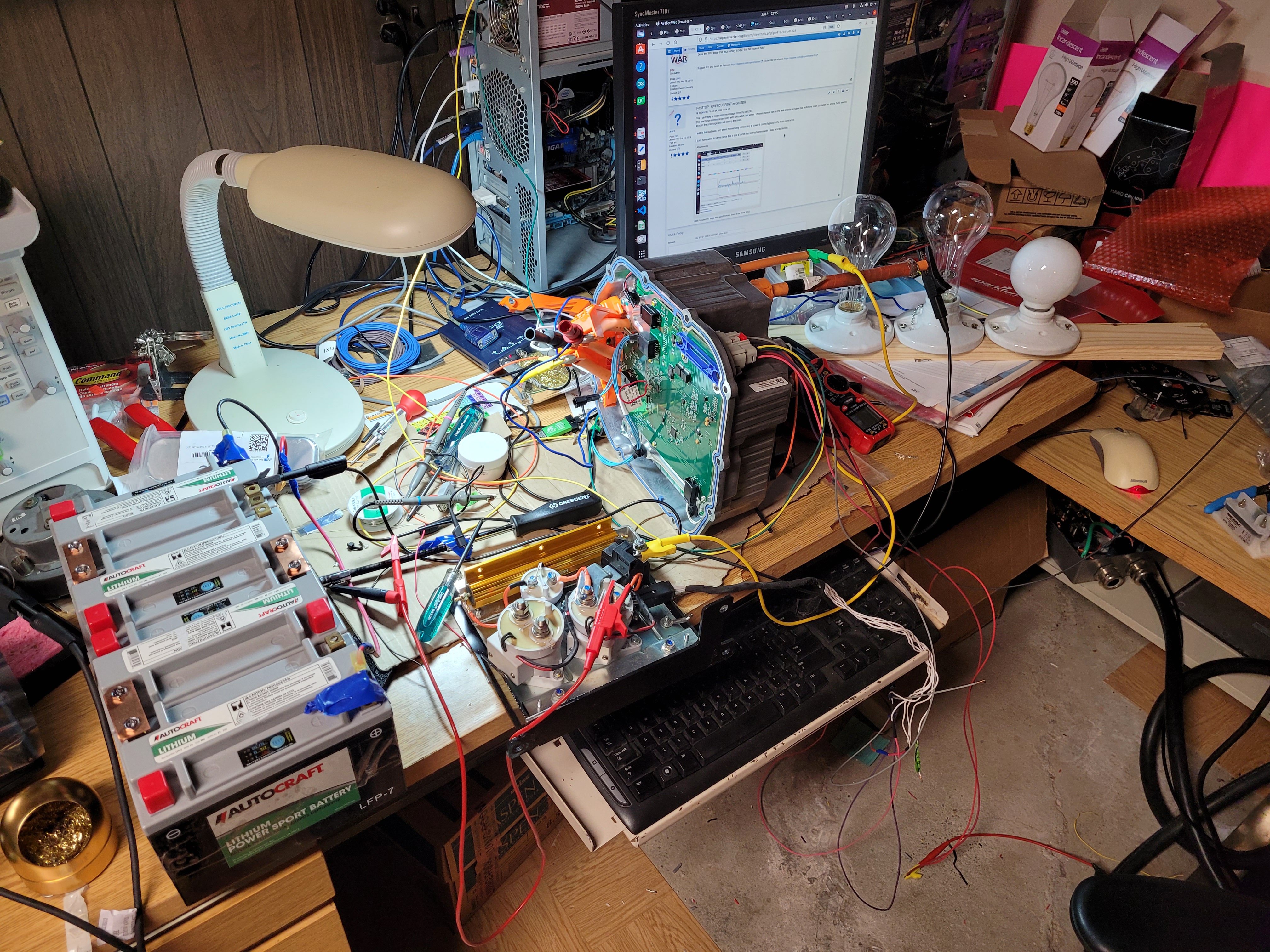

Thanks Johannes,
I got the new board installed in another drive unit. I replaced my welded contactor and burned precharge resistor with a new and a 100ohm precharge R.
I'm starting off at 48V DC with 3 60W mains lightbulbs in a delta configuration connected to the 3 motor phases. the precharge controlled by the SDU is working fabulously (53 Volts measured as UDC by the SDU) but the main contactor doesn't close when I press the start button. no errors on the web interface, and it goes into manual mode just fine when choosing start on the web interface, but since the main is not closing the capacitor just discharges in a second or so. I checked the wring and everything looks good. The contactor works fine when grounding pin 3 of the harness...
any thoughts on debugging.

Ok that makes a lot more sense. I was tracking what I thought was bad wiring that turned out to be fine.
I was able to use the start switch to get into run mode, then choose manual run on the web interface and everything looks good.
but I'm not lighting the bulbs that I connected to the motor phases wires in a delta configuration. I've got HVIL jumpered and there are no errors aside from "warn throttle 1" (its not connected).
following the Wiki
https://openinverter.org/wiki/Open_Inverter_Testing
I set fslipspnt - 1 ampnom - 70%, but not lights. basic ohms law saws the bulbs should draw about 3A at household mains current. since Im down at half that current draw should be only an amp or so.
I have the nominal voltage parameter set to zero, does this impact the ampnom (or boost?) in mannual mode?
following the Wiki
