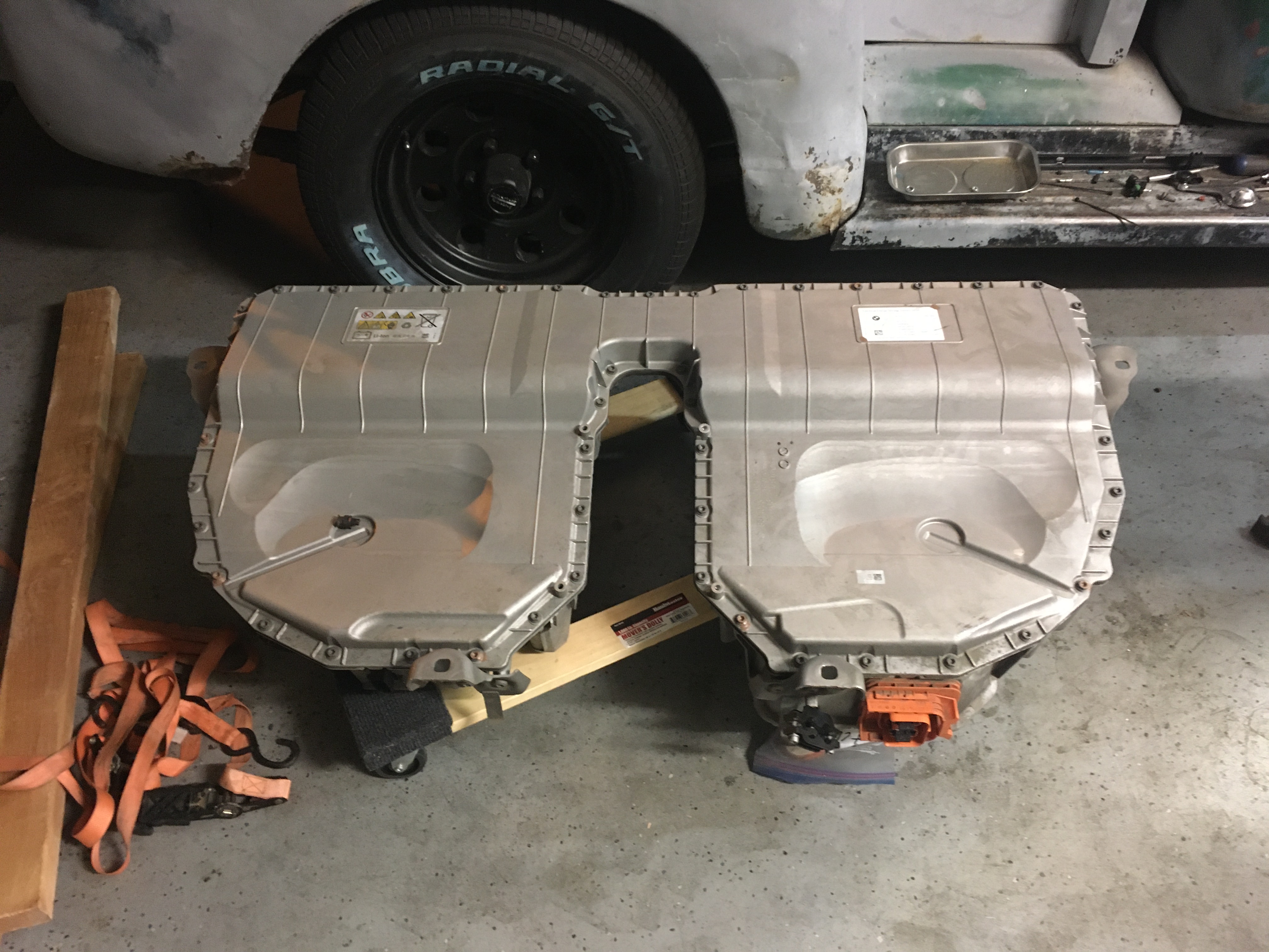

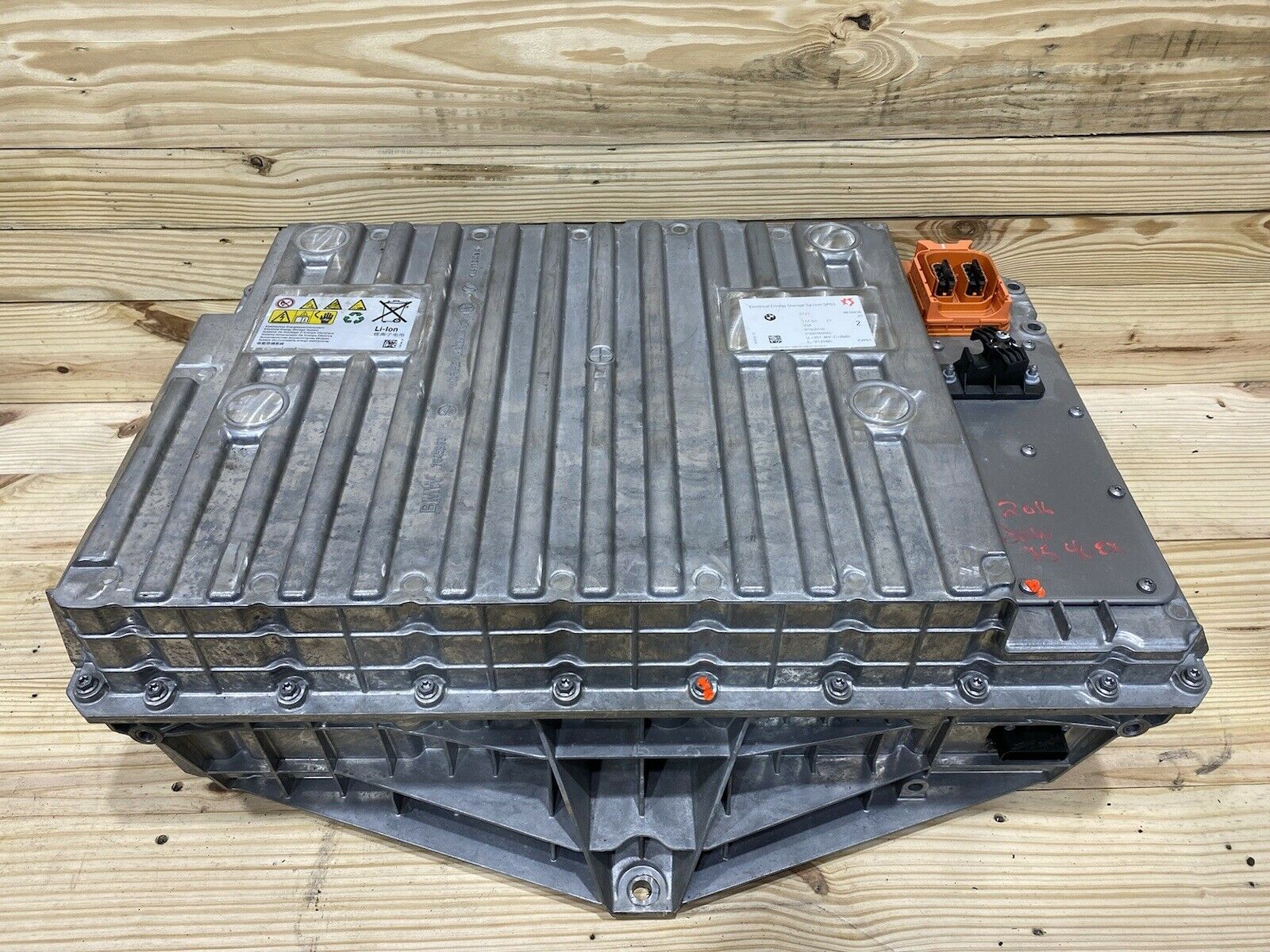

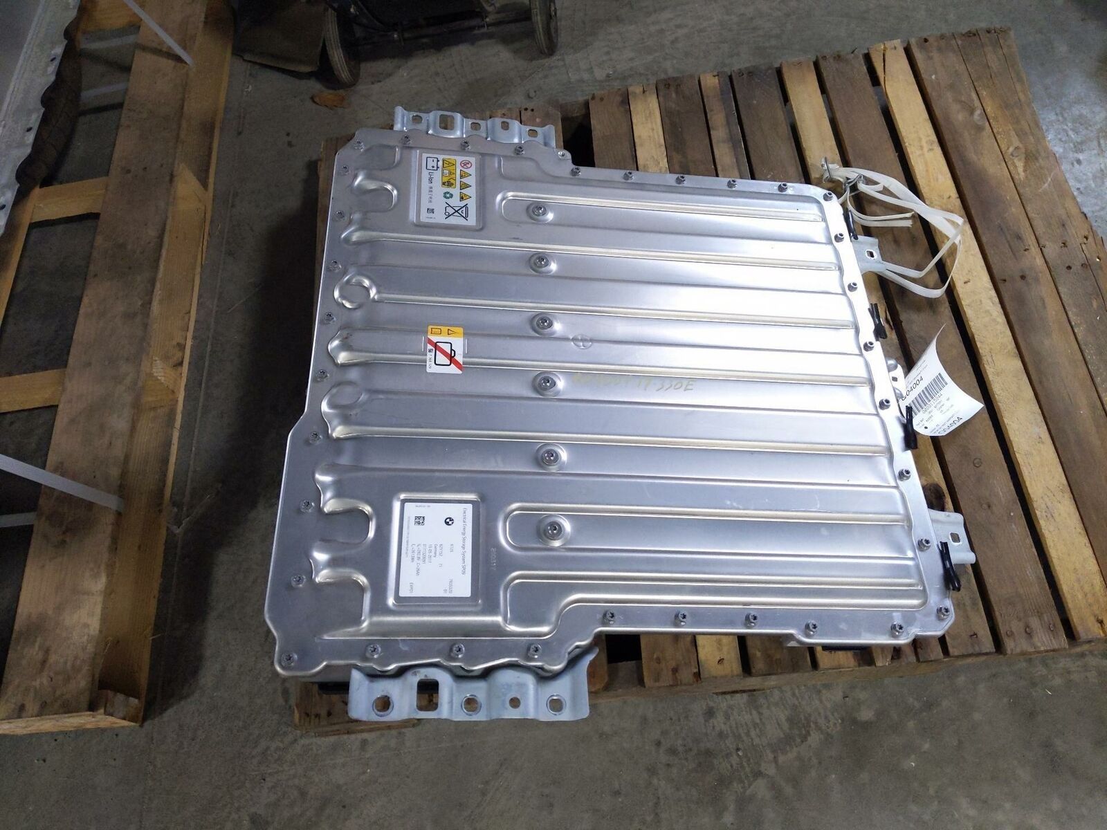

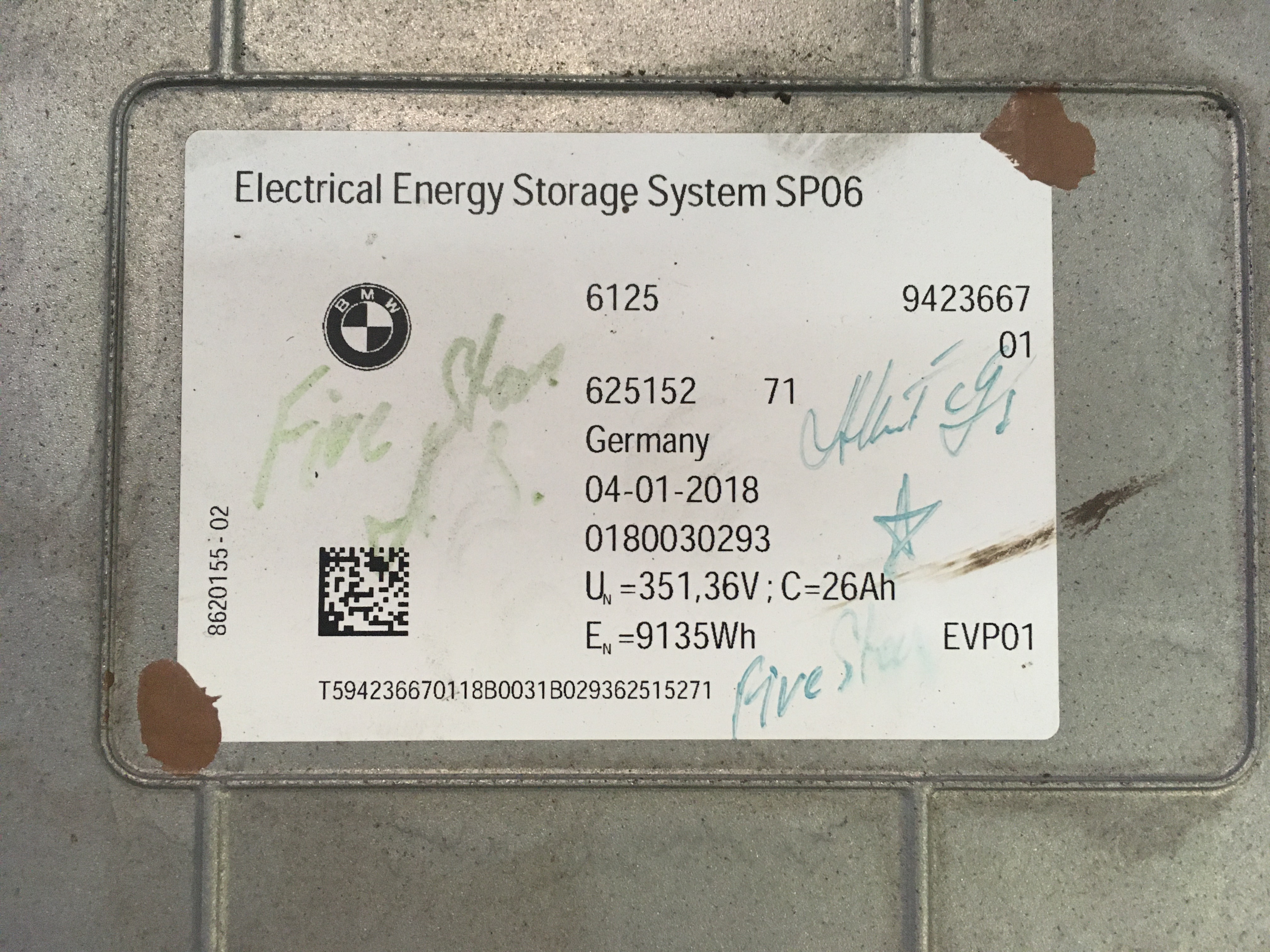

So a little background: I bought a 2018 BMW 530e battery pack for $900 bones on eBay last year. I know nothing about BMWs but I think that's something called a 5 series, anywho that car comes with a six pack of these modules like so

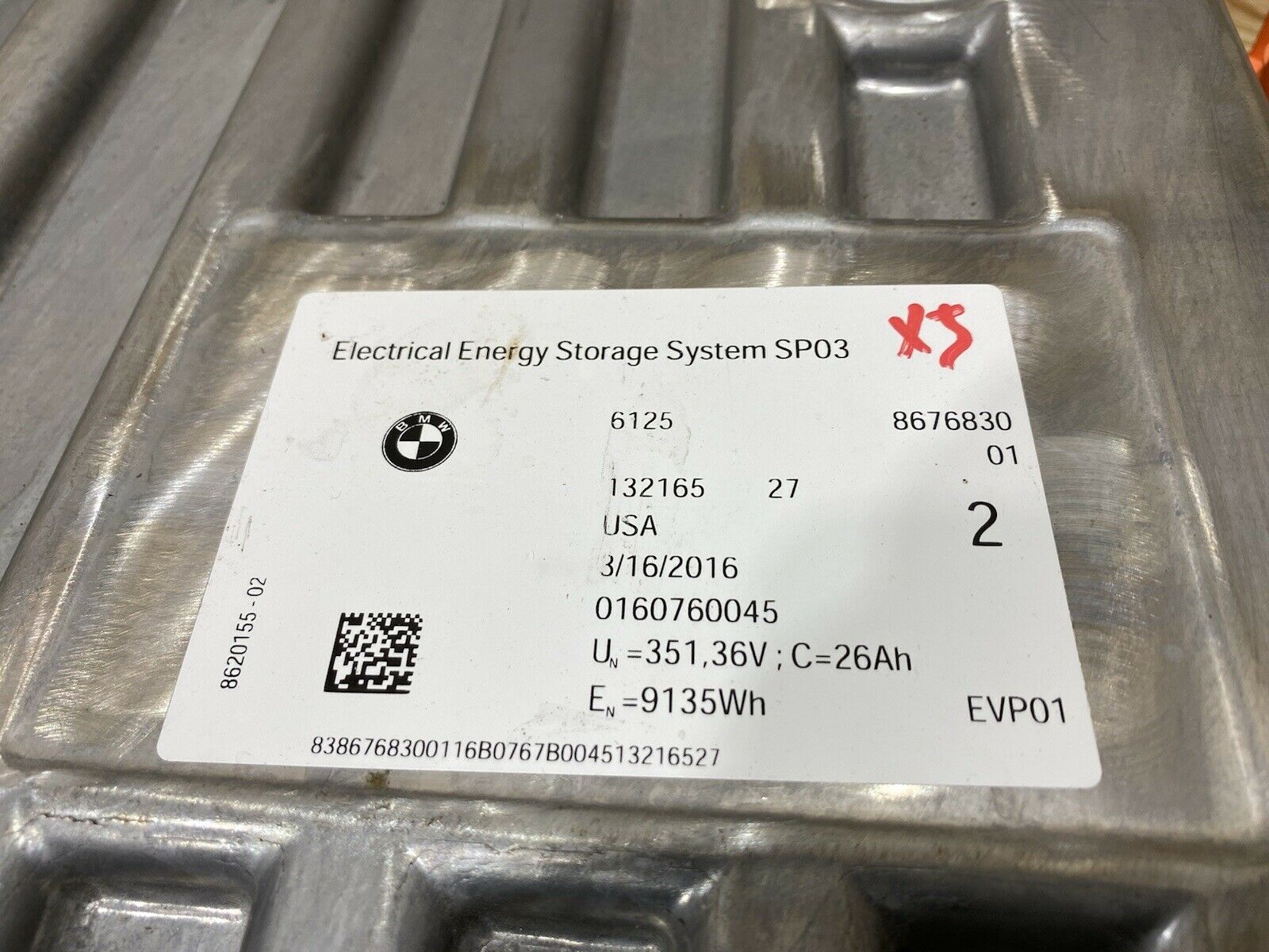

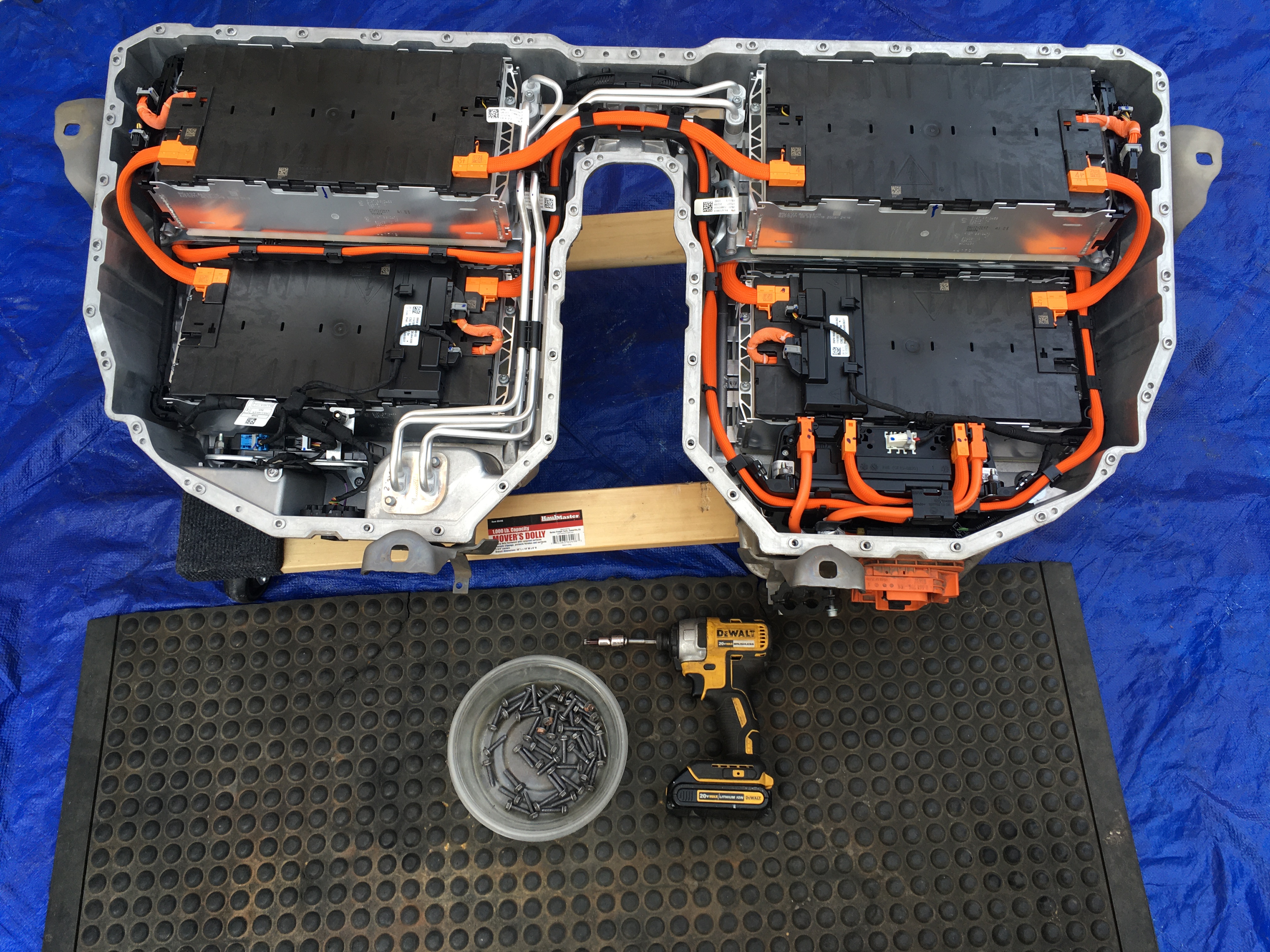

We can source a similar pack from the 740e and the X5, the 330e aka it's little brother comes with the same modules but only five of them
X5 pack
330e pack

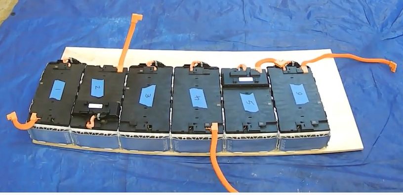

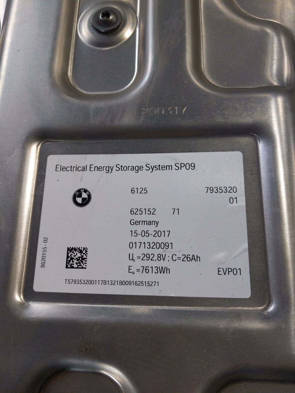

alright, enuff of the Captain Obvious, so as per the sticker two posts up, my back ie the 530e six module one states it is 351.36 volts, we do some quick maths here (take that number and divide it by six modules) giving us 58.56 volts per module
and just to level set on the naming convention, right or wrong (and please correct me if I am wrong)
the big box I call the battery pack (our larger unit of measurement), inside of it there are six cell modules, inside of these modules are cells (the lower unit of measurement as far as I am concerned)

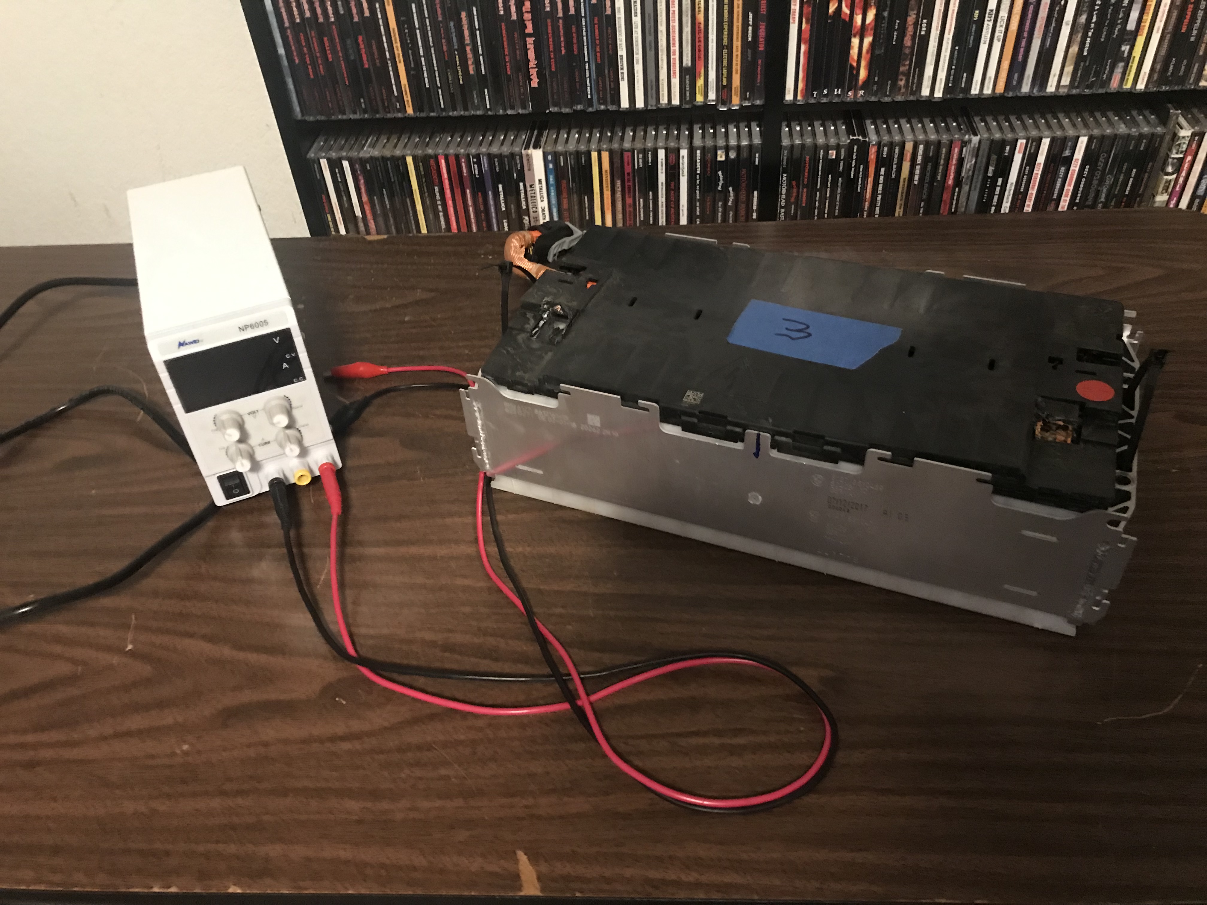

Now I have two different bench power supplies (trust me I'm not bragging) they are both 300 watts, however one is 30 volts and 10 amps and the second one is 60 volts and 5 amps. So, can anyone chime in and tell us why we couldn't or could we use the 30 volt 10 amp bench power supply to charge one of these modules, I mean they are both the same power rating? are they not

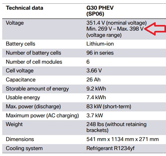

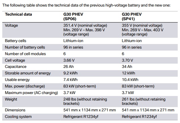

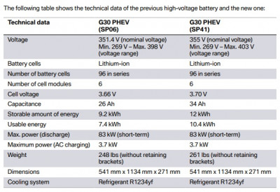

alright time for some homework, there are two generations of this battery pack up until mid 2019 it was the 3.0 technology version called SP06 and starting in July 2019 it was replaced with the next version called the SP41, we will focus on the SP06 in this thread (because that's what I have) I wish I had the other one

more maths, so per the specs above (you can take it or leave it, ha ha) we can charge the entire pack up to 398 volts, so if we divide that by six modules, we get 66.33 volts per module, good to know, but keep in mind our bench power supply only goes to 60 volts
ok now lets compute the lowest value, so we take 269 volts and divide that by six modules and we get 44.83 volts so that's our floor, now something I learned a while back using a regular acid car battery that first of all although we call it a 12 volt battery it is really made up of six cells of about 2.1 volts each so it's really 12.6 volts and just Googling around to confirm, at 11.9 volts it is considered dead, (yes I know we are comparing apples and bowling bowls here in terms of battery technology) but the point I am trying to make is that a battery is not dead when it reads 0 volts, regardless of what kind it is
so...
66 volts = fully charged
45 volts = kaput

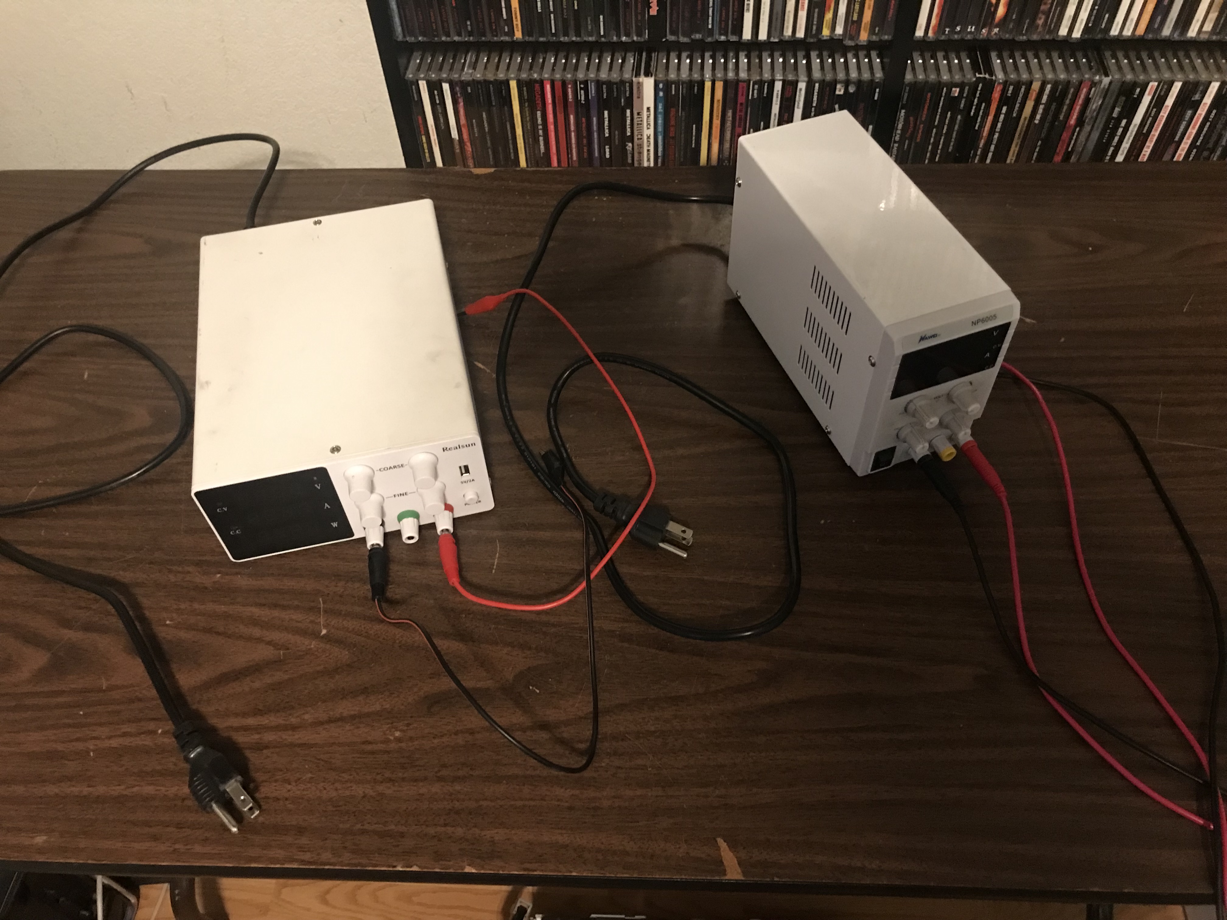

There is a way to up the voltage my padawan, though it lies on the edge of shadow.... :twisted:
If you wire TWO yes TWO power supplies in series, your battery will see it as a single source. PSU1+ to battery+, PSU1- to PSU2+ and PSU2- to battery-. If you have two PSUs of the same rating is the best, but not limited to. As long as you set the current under the level of LOWEST rated unit.
I wouldnt recommend it though since those PSUs output PWM and that can have unpredictable results. Allways supervise that kind of twisted application!

assuming nothing we begin with a gently PSU tutorial

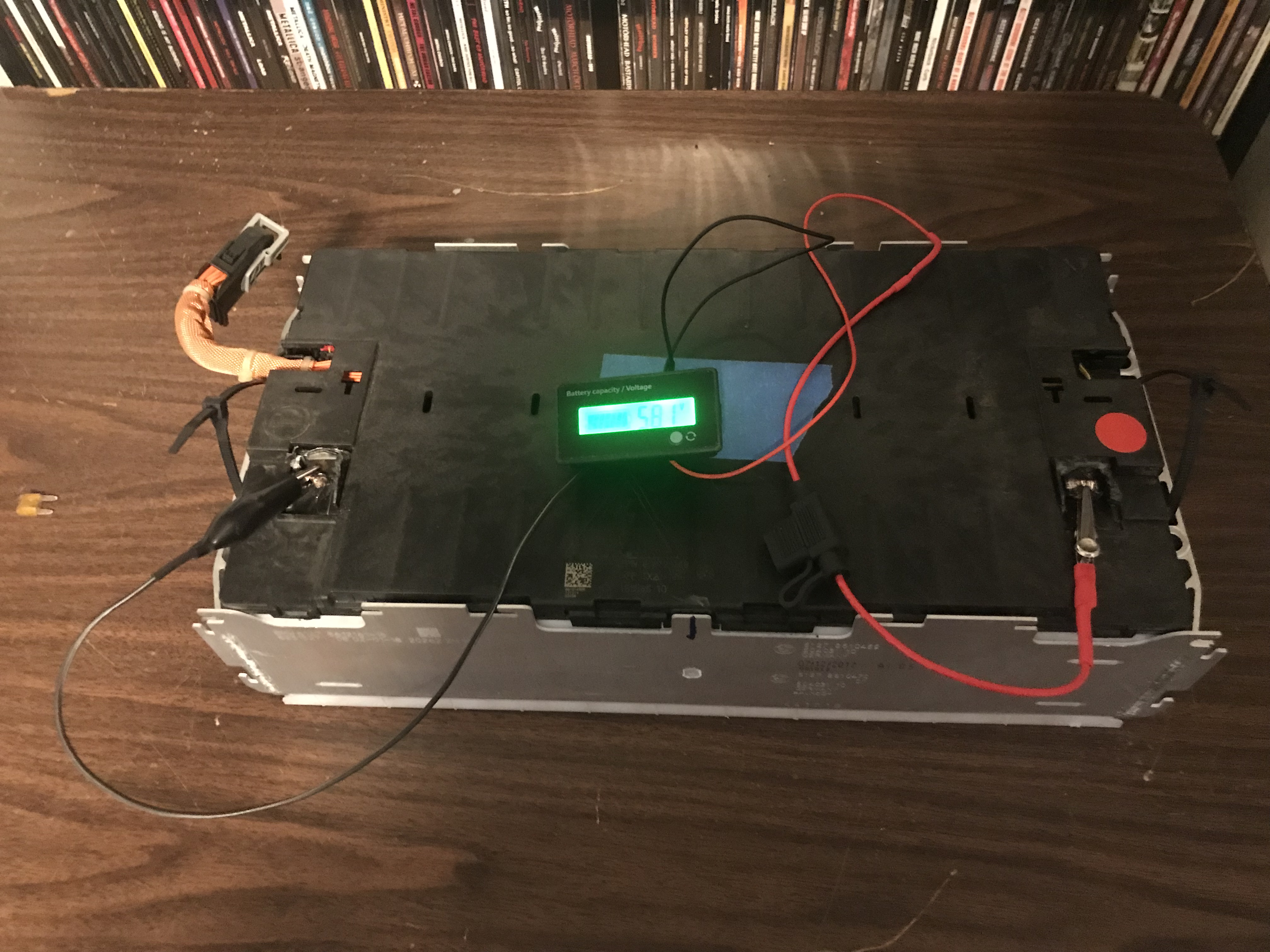

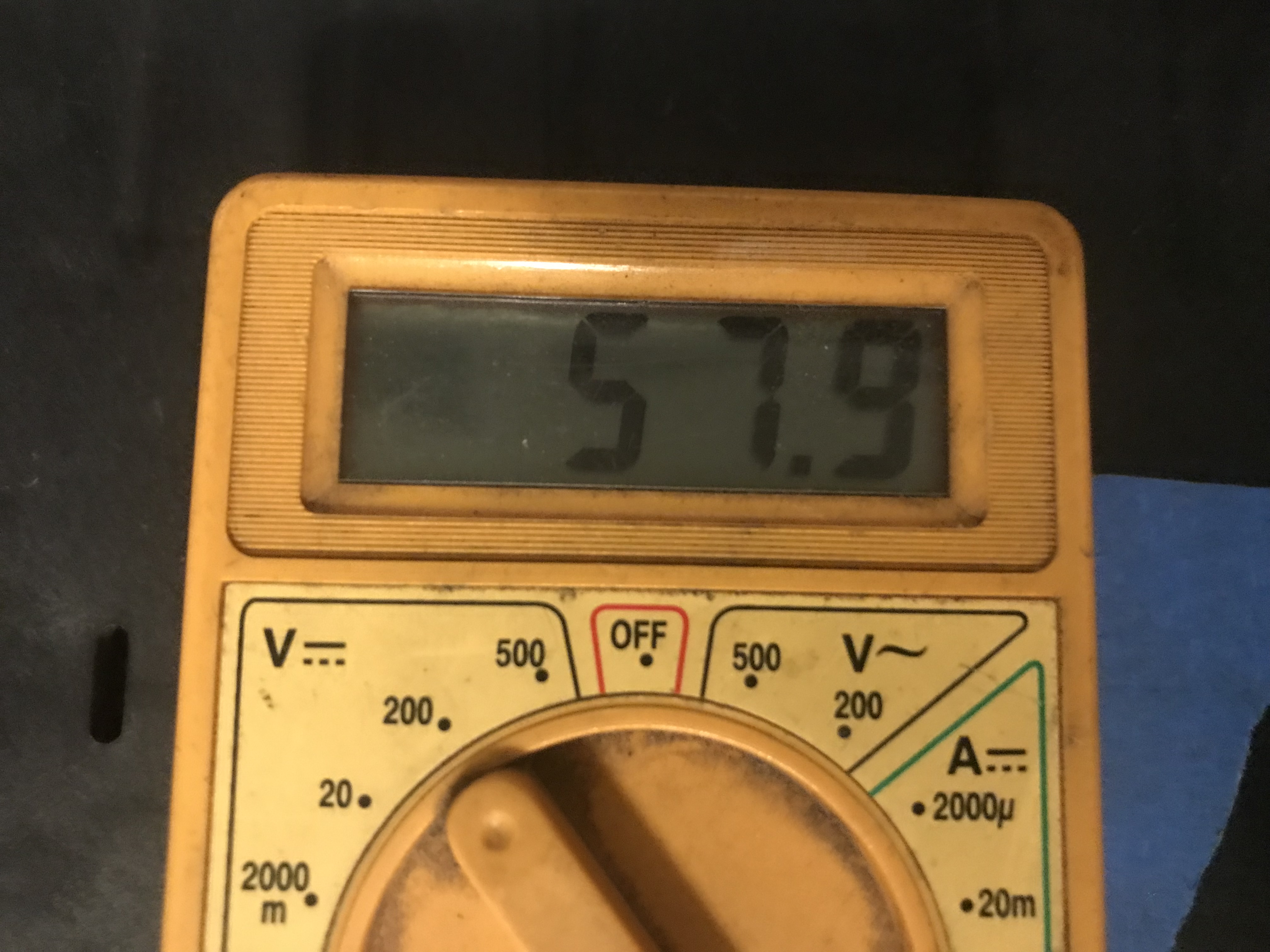

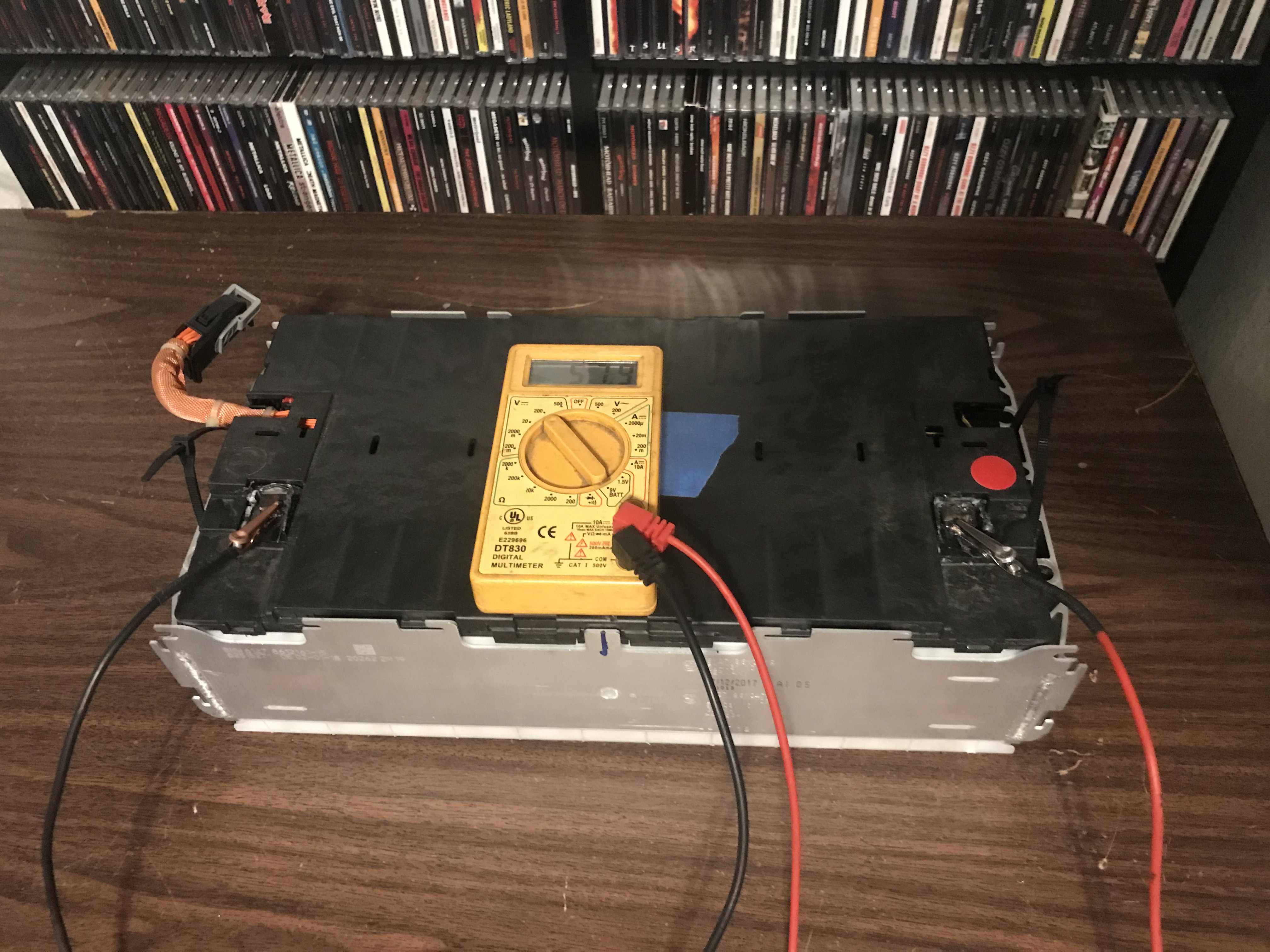

alright so lets baseline this cell module aka "shoebox" ha ha
57.9 volts
do some quick math 57.9 times six modules puts us at 347.4 volts for the entire pack

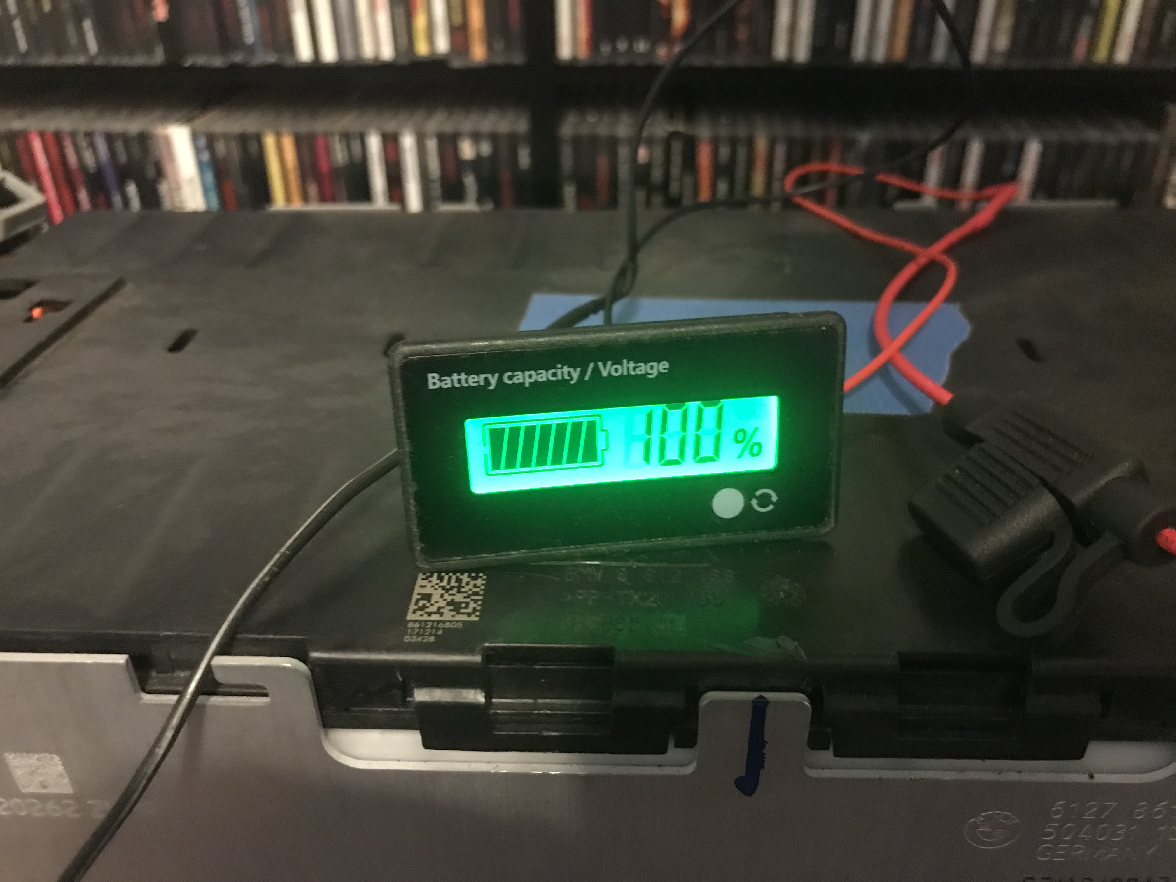

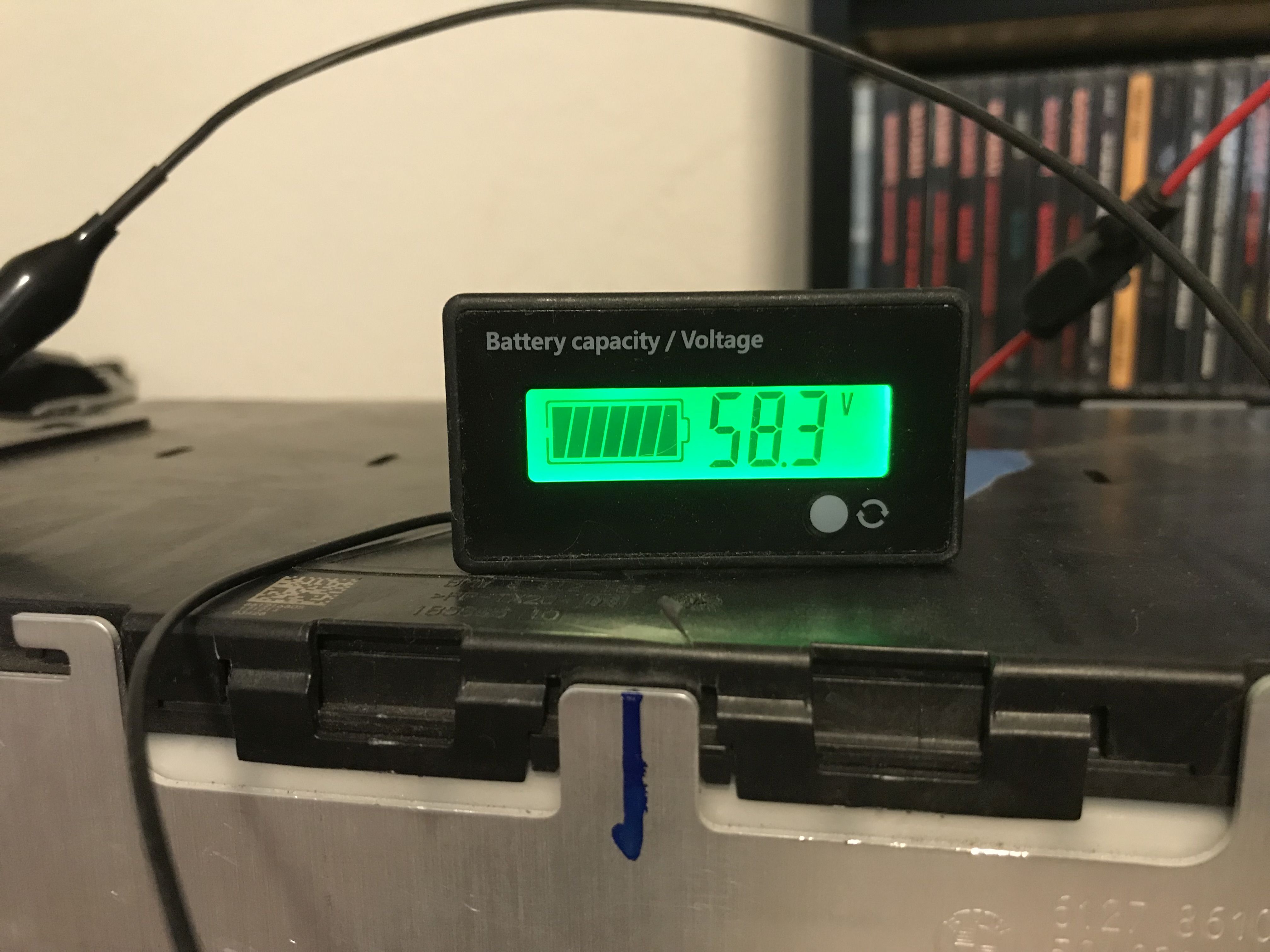

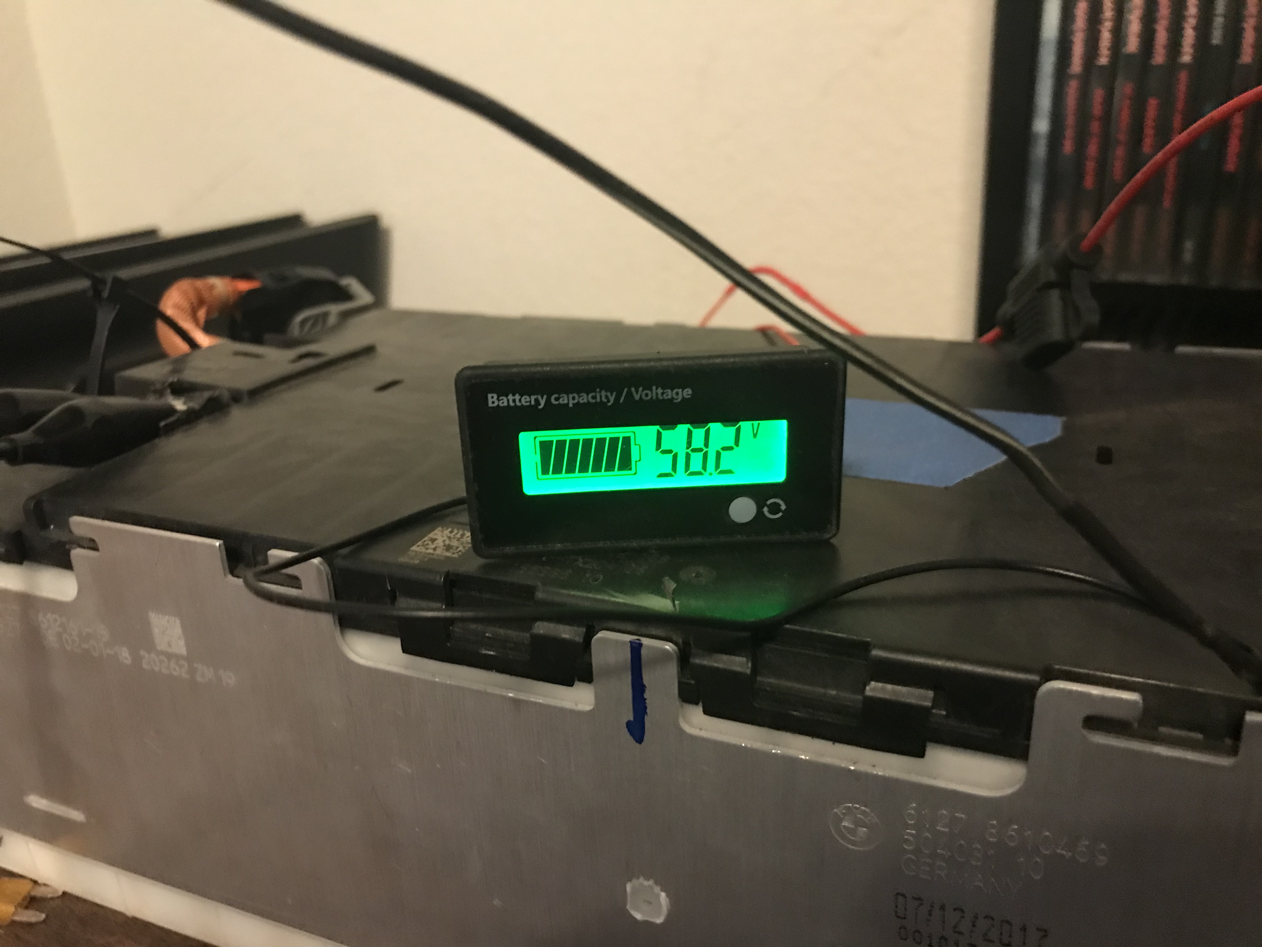

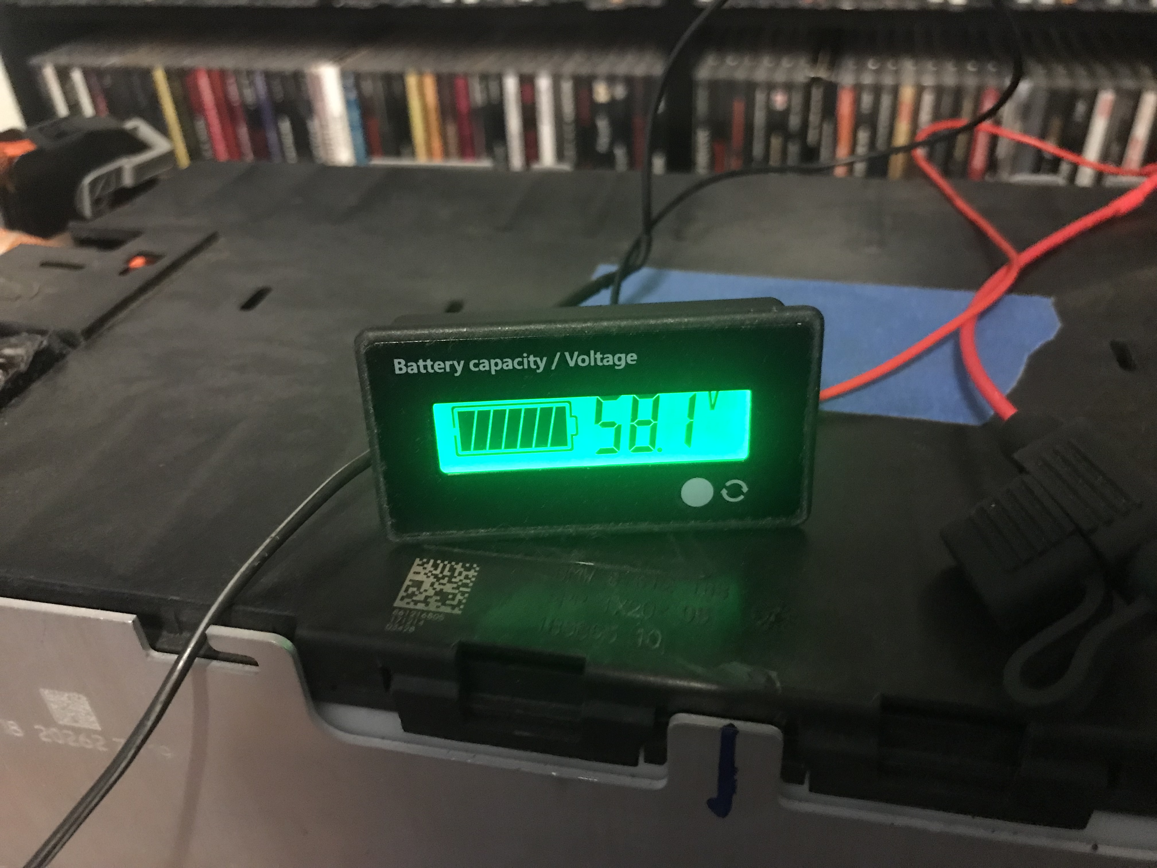

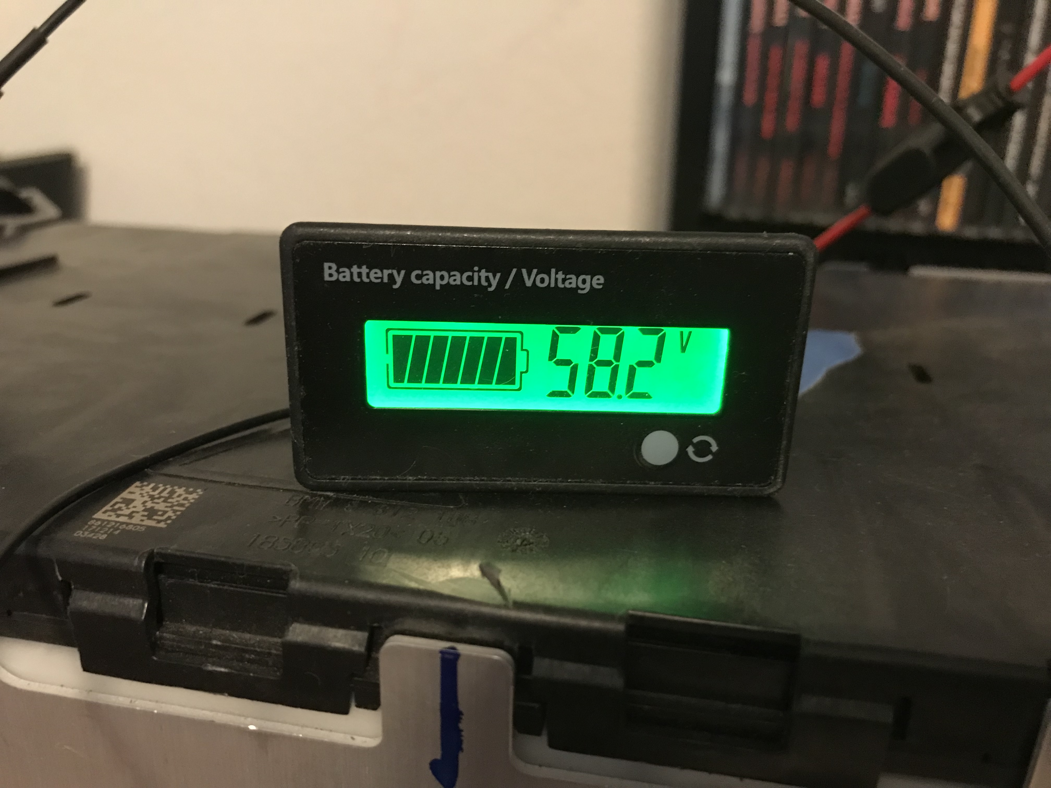

now this is where things get interesting (pronounced: confusing) I hooked up one of them cheap Chinese DC 12V 24V 36V 48V 72V Battery Meter, Battery Capacity Voltage Monitor Gauge Indicator, Lead-Acid & Lithium ion Battery Tester, for Golf Cart RV Marine Boat Club Car Motorcycle - With Alarm, Green
it read a bit higher at 58.1 volts (but that's not the issue/concern) the part that it thinks it is fully 100% charged is since that only puts the pack at 348.6 volts not even at the 351.36 nominal???
FYI I did not go out and purchase this monitor for this battery it's just something I had laying around from a solar panel project.

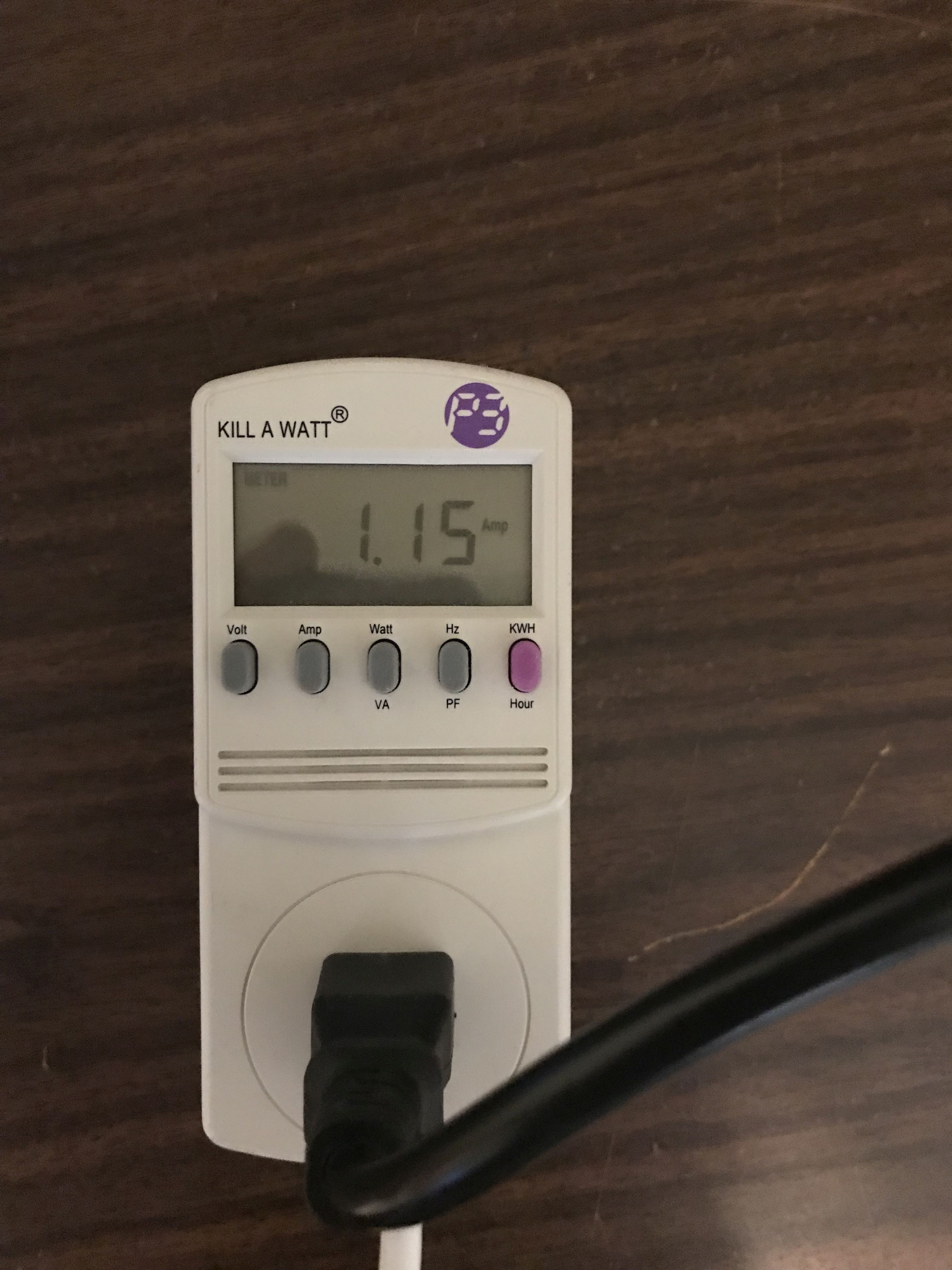

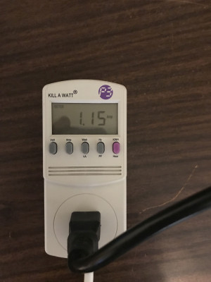

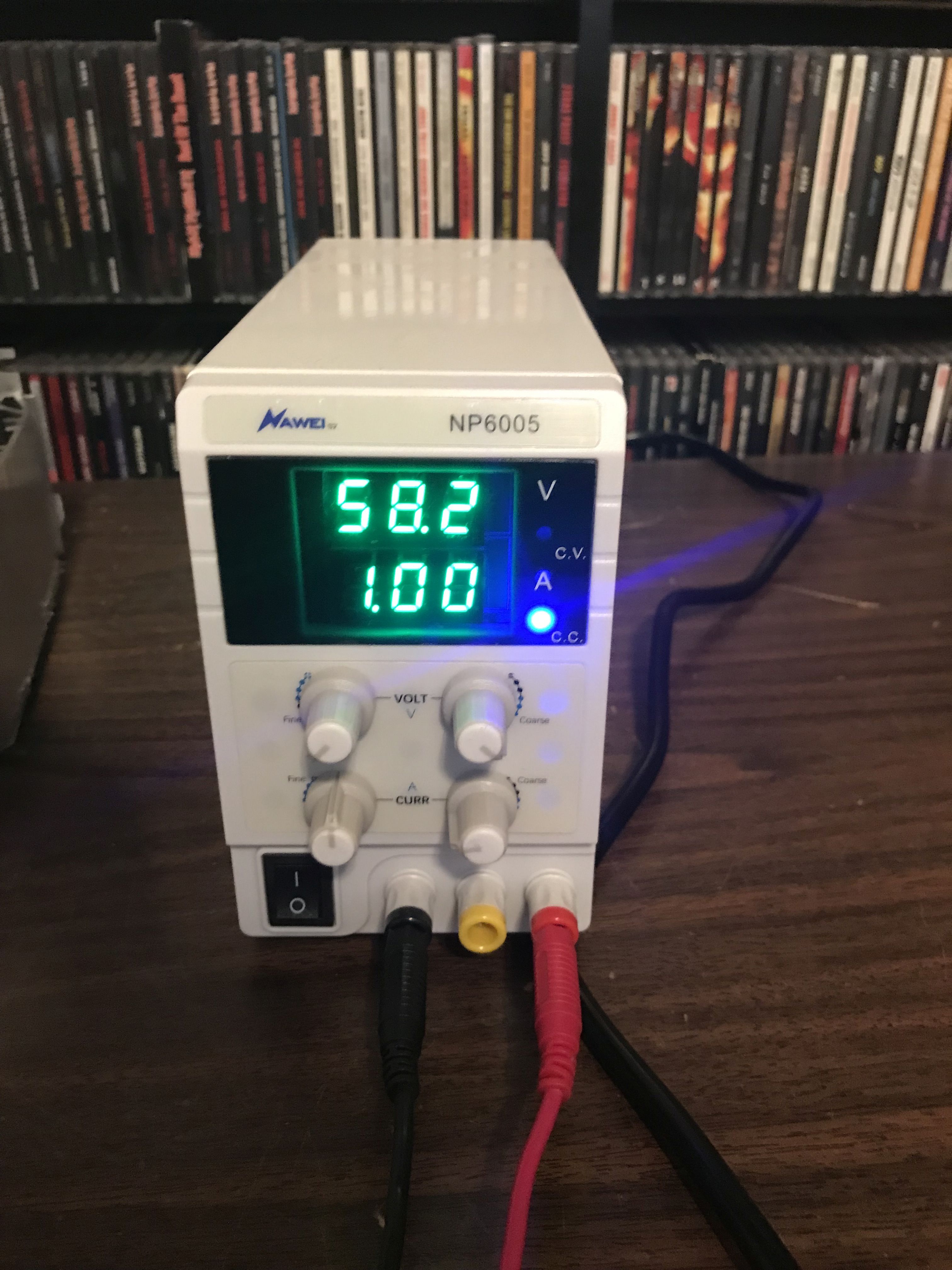

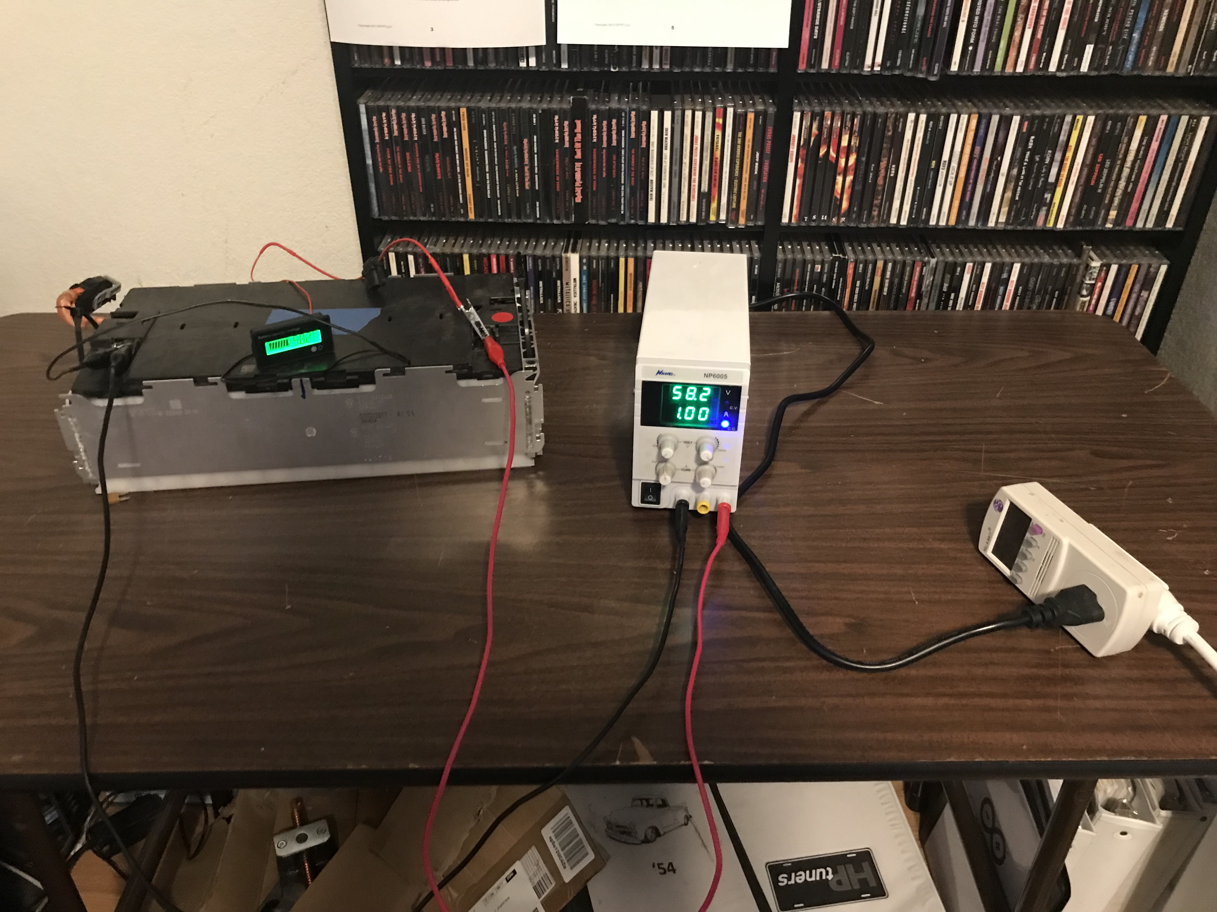

commencing the experiment, charging at max voltage with Constant Current capped at 1 amp (baby steps)
I love these Killer Whale as I call 'em inline Alternating Current meters and I prefer the genuine KILL A WATT units over the generic knock offs with multi buttons where you have to press the same button over and over to toggle through a function, I'm a simple man I want Volts I press the Volts button, I want Amps, I press the Amps button, etc. (I wish I could find a US 240 volt version of one of these, holler at me if you know of one)
so here we are pulling 1.15 amps AC at 120 volts from "the wall"
this translates to 1 amp DC at 58.2 volts (via the power of the flux capacitor I guess)
looks like my Chinese power meter decided to play ball and report the same voltage as the bench power supply, nice going little guy, nicely done

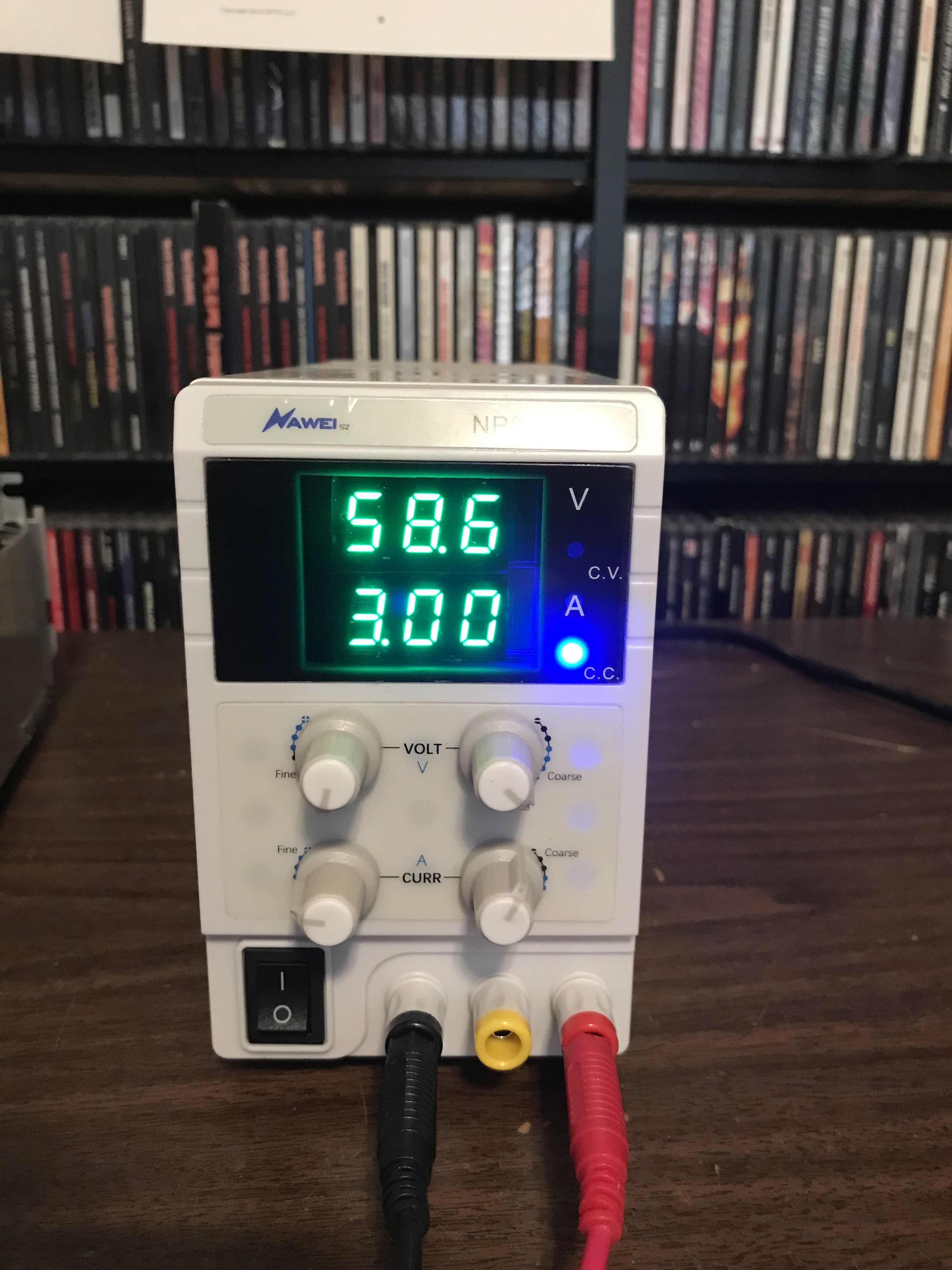

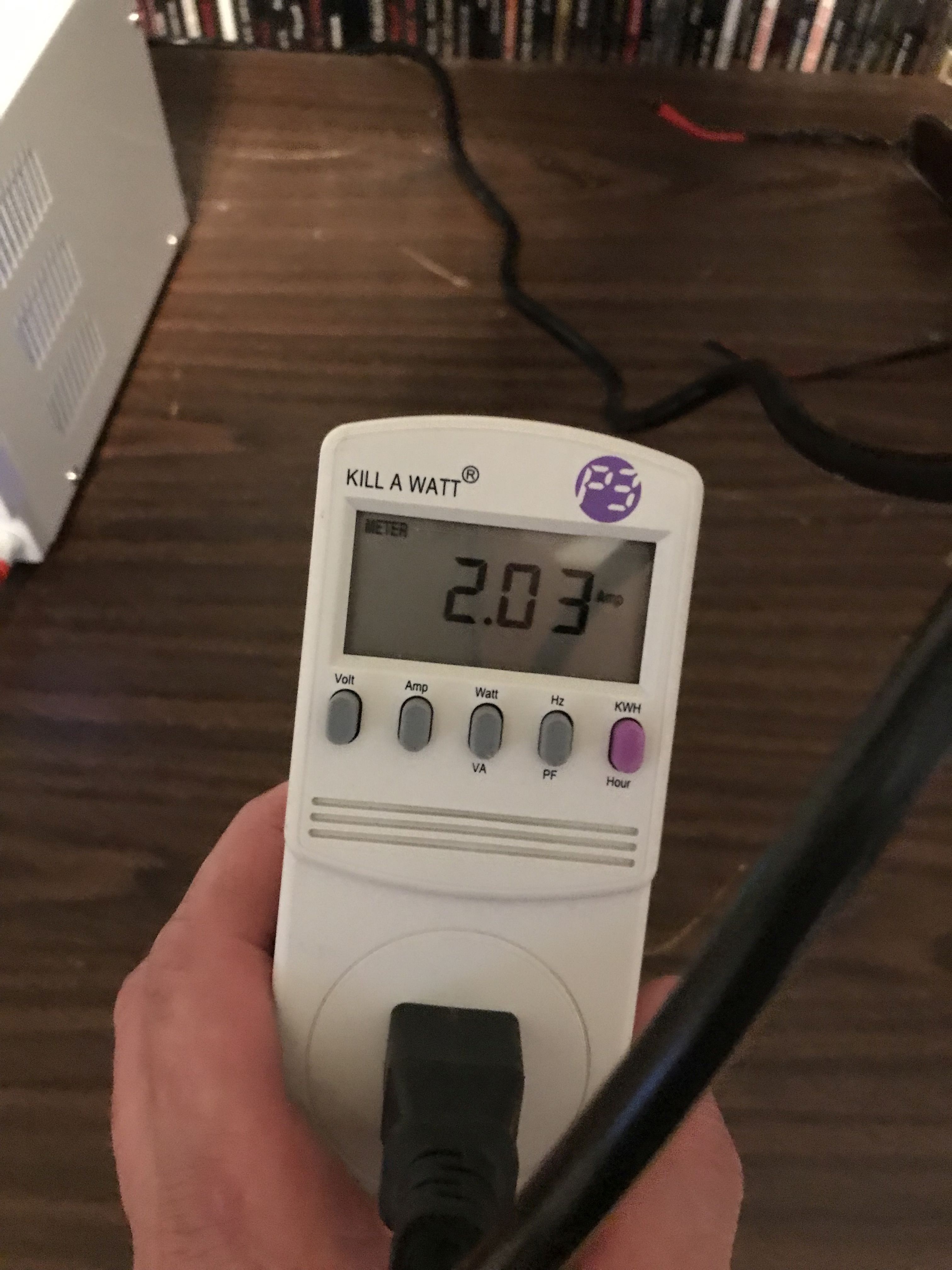

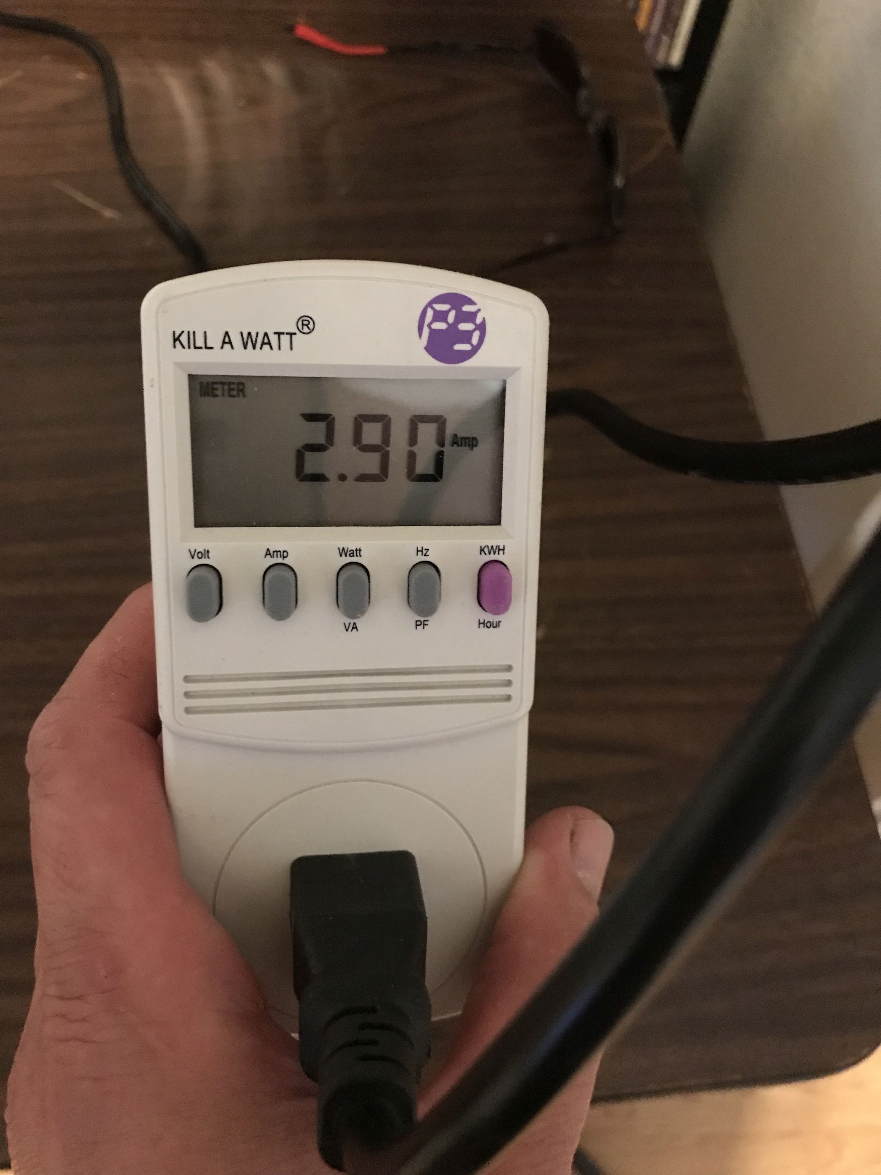

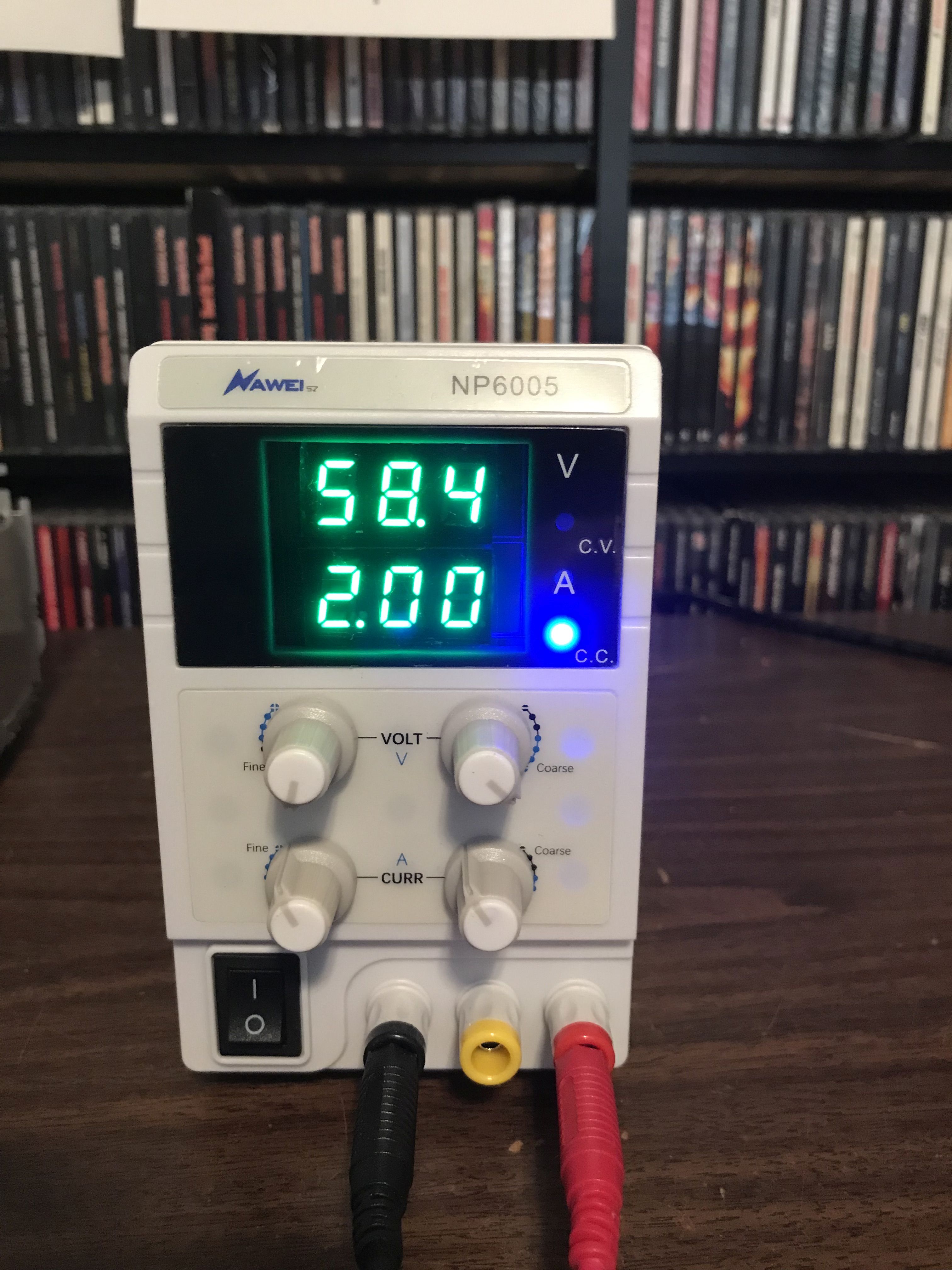

what do you say we go crazy and double our amperacis input
so this is interesting, from what I watched on YouTube (and we're talking minutes of research...) I expected the volts to drop as the current went up, I mean did Georg lie to us or what I thought a law was a law
ok so now we are pulling 2.03 AC amps from the wall

and here's what the numbers looked like at 3 amps DC
so we were pulling 2.9 amps AC (from the wall)
and the battery voltage read 58.3
