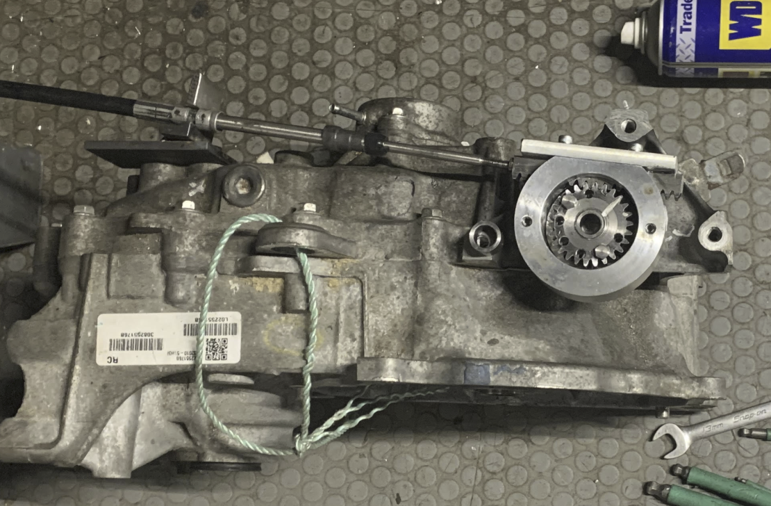

Hello,
Ollie and Alex built a manual lever for the P-Brake on the Nissan Leaf gearbox. Fits the pulley of our shifter perfectly.
This is how it also works in the eNV200.
Custom made cogs and everything. See below.
See it in action:
https://youtube.com/shorts/3WwhyRCg_es

Very cool, so that's how little travel is needed to engage it?

Yes, thats it. I am not very involved with the mechanical side, it's about a quarter turn.
The eNV200 has a mechanical actuator, because they kept a mechanical shifter.
Same for our taxis, we keep the shifter and it only goes back and forth.

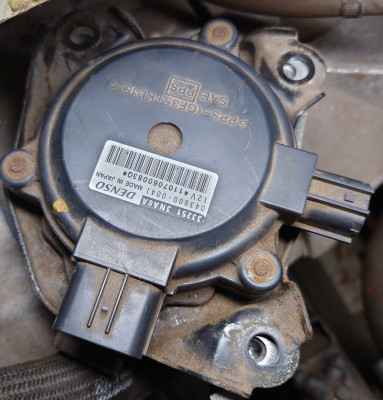

This is from EM61
Nissan EM61 P-brake actuator assembly.

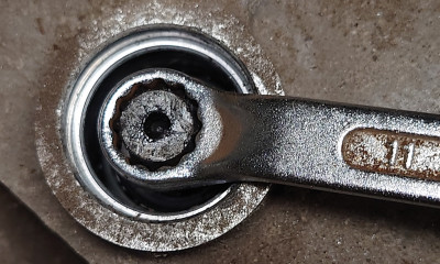

Nissan EM61 P-brake operational lever and 11mm spanner

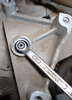

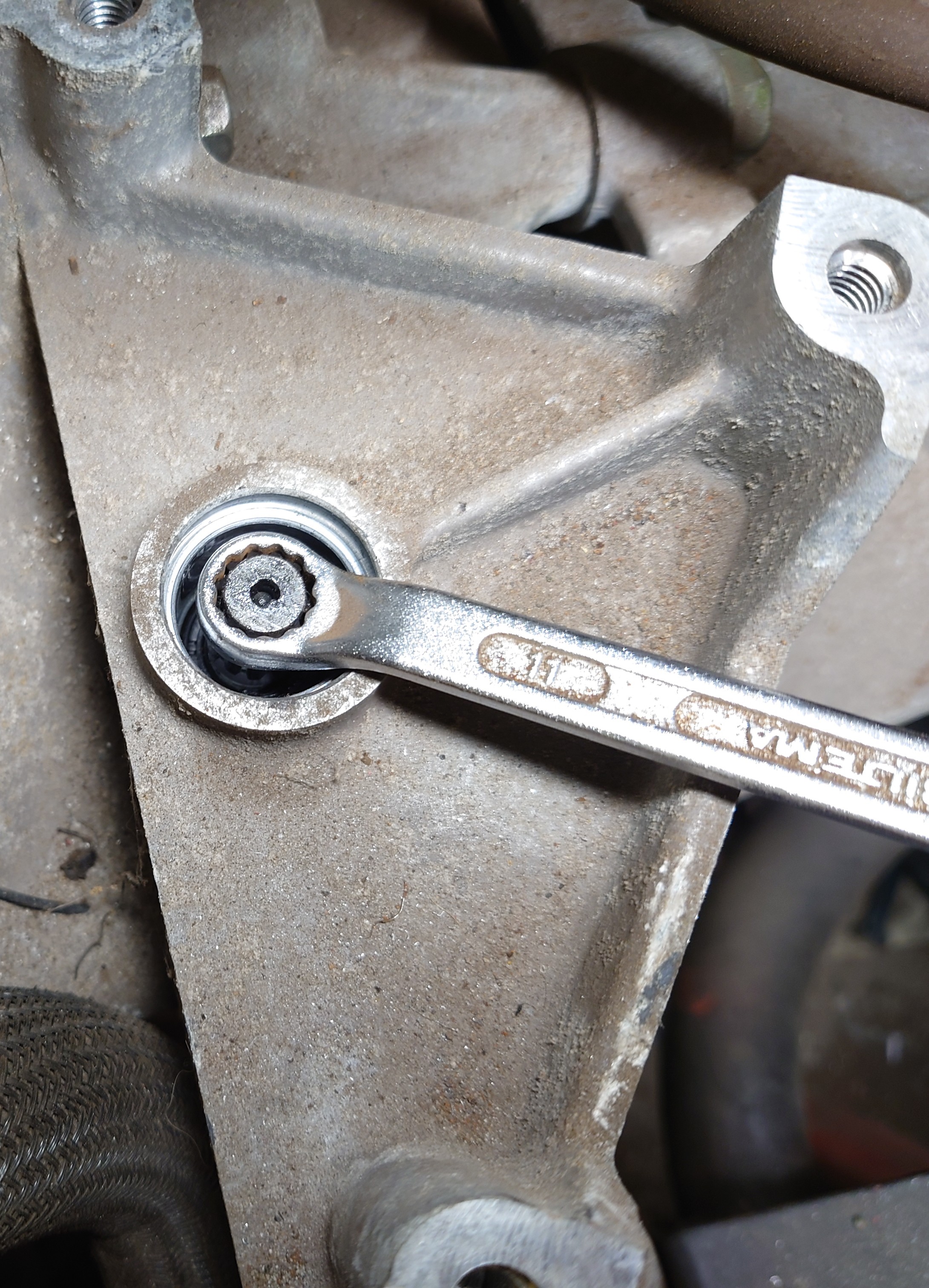

When removing the nissan assembly, it is possible to just change The P lock with a 11mm spanner.
Here is pictures of the 2 positions it goes to:
D = DRIVE
EM61 DRIVE
EM61 DRIVE
_-_-_-_-_-_-_
-_-_-_-_-_-_-_
P = PARK
EM61 PARK
EM61 PARK

Yeah exactly, and the spanner turns ... 90 degrees? maybe only 45 even.
