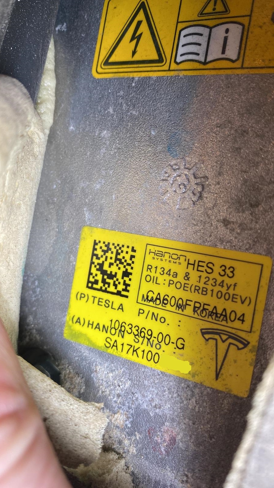

Anyone gave this one already a go?
Part nr: 1063369-00-G
Pin 1: 12VDC
Pin 2: CAN+
Pin 3: CAN-
Pin 4: GND
Connector = Molex 33472-0401 Update:
CAN ID:
0x223
0x233
0x363
0x223:byte5 higher nible bit 0 toggles on reception of 0x28A;
0x233:byte0 & byte 1 contain HV voltage (45 02=60VDC, 7A 01=40VDC)
0x363: Firmware info/data;

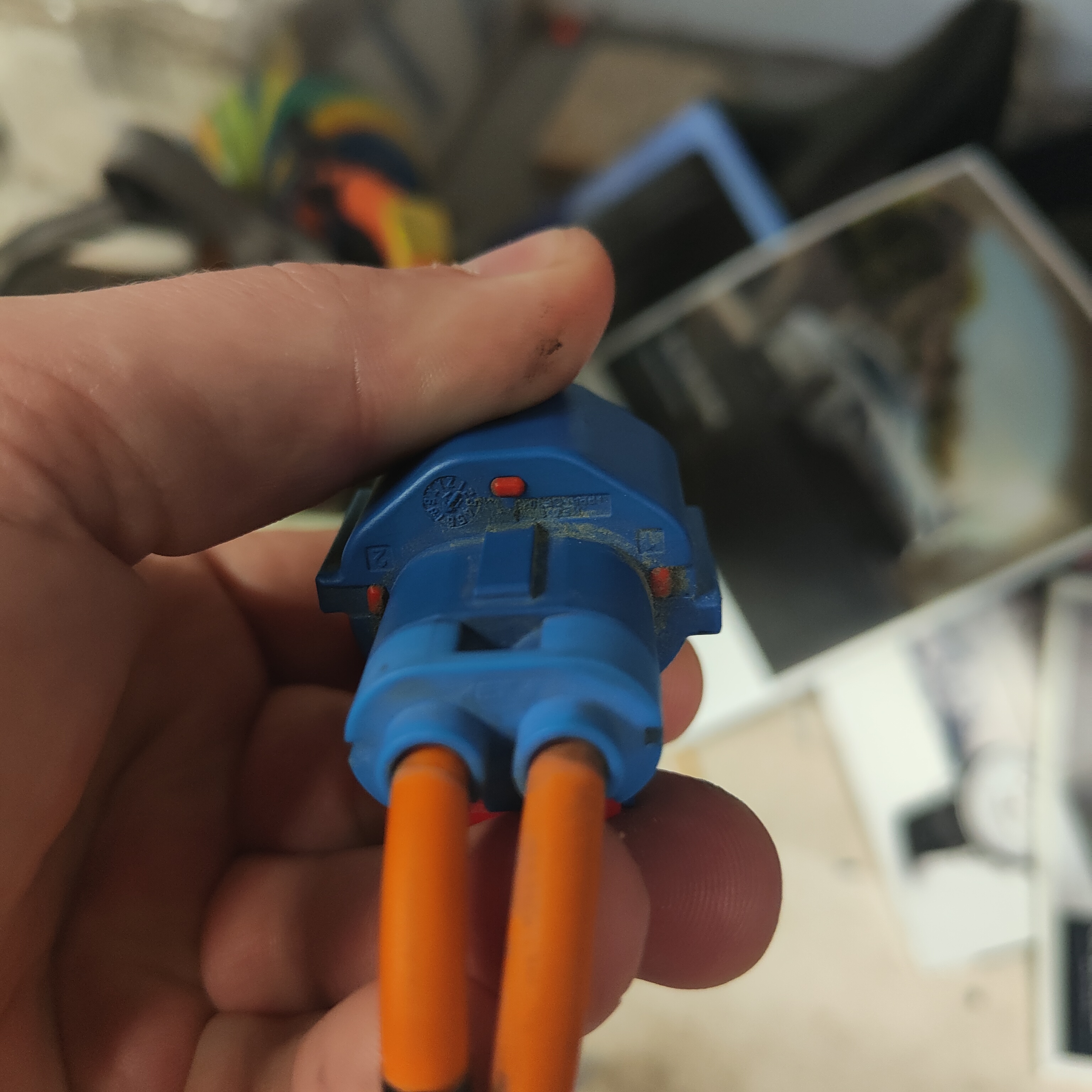

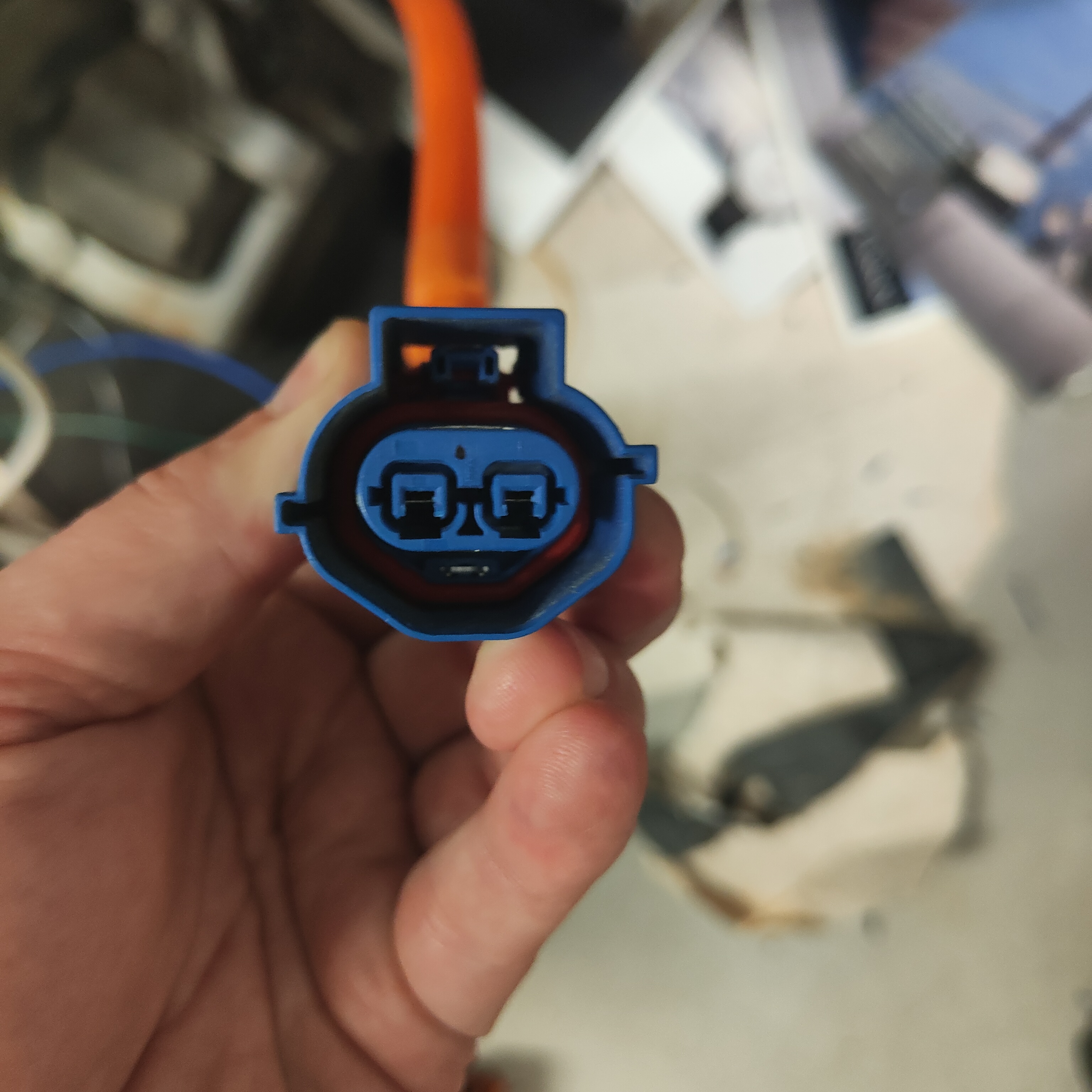

I'm looking for this connector someone can help?

Hi All, I have a 2019 model 3 write off that is still running and in working order including a functioning AC system. I am interested in trying to assist in reverse engineering some of the ancillary devices like the AC and the coolant pump as a way of contributing to this forum. Ultimately I would like to use as much of the car as possible in a conversion project.
I have done some can sniffing on the can bus connected to the AC compressor, so far with little success. I could not identify any messages changing in a consistent way by turning the AC system on and off via the control screen.
If anyone has any suggestions or specific tests they want run on a working system please send a reply and I will endeavour to assist.
